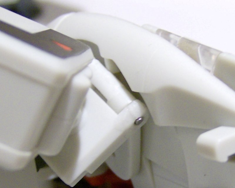

m0n5t3r Posted January 8, 2010 Posted January 8, 2010 (edited) ...completely smooth ones would be more likely to fall out. nope, they don't. there's enough tension between the pin and the inner part of the hinge assembly(the one attached to the backplate). an easy way to find out if the pin has knurling or not is just to swing the arms/shoulders... if the pin DOES NOT rotate w/ the outer part of the hinge(the one connected to the arm/shoulder assembly) then they should be perfectly smooth... and vise versa. Edited January 8, 2010 by m0n5t3r Quote
David Hingtgen Posted January 8, 2010 Posted January 8, 2010 If the knurling is in the middle part, not on the ends, that shouldn't be a problem. (that's how it should have been in the first place). IMHO it's been a design error since the beginning---a knurled pin shouldn't rotate, the plastic piece should rotate around it. That's how it is in just about every pinned joint in every Gundam, Transformer, and Valk toy ever. Except the V2 VF-1, where the parts are too stiff or something, and the knurled pin rotates inside the joint, chewing the ends apart from the outside. Quote
Chronocidal Posted January 8, 2010 Posted January 8, 2010 (edited) Well, bit the bullet and took apart my 1D and Hikaru 1J to check on them both out of curiosity. Wound up leaving the pins in on both, but I can tell the ones on the 1D are knurled to some extent, since the edges of the ridges are just barely visible at the edges of the hinge (no idea about the 1J). Now, this may not be a problem at all. There are no stress marks, the hinges rotate just fine, and nothing is cracked. I think for the time being we shouldn't panic on these. It doesn't look so much like they went to entirely smooth pins as it looks like they reduced the size of the knurling. Really, removing the knurling entirely wouldn't work so well, because the pins would gradually work themselves out of the joint (at least, the hand-made ones I used to replace them do a lot ) What I do know is that there is a noticeable difference in these smaller knurled pins compared with the ones on my VT-1. The original knurling can be seen clearly from the end of the pin, so these are like version 1. The newer version 2 pins are smooth capped pins with smaller knurling that you can't see unless you push the pin out. So far, I don't see any stress from the version 2 pins. For now, I'm going to try not to worry about the 1D pins, or any other ones without obvious knurling. They may break, they may not. I'll wait to bomb that bridge until I come to it. Anyway, onto the pics. These worked out better, I forgot to tweak the ISO last time, and I maxed out the resolution. These are my first two V.2s, Roy, and Hikaru 1A. All four shoulders were stressed, and two were cracked. I superglued them all, and replaced the pins, but you can still see the cracks a bit. The stressed hinges don't show up at all on camera after I worked on them. Btw, I checked the pin rotation, and yes, even the smaller pins rotate with the outer shoulder piece, not the inner joint to the fuselage. EDIT: Oh, one last thing. One thing I learned to do while taking these things apart is to loosen the main shoulder joint that is screwed to the back plate. If you unscrew it too much, the shoulder joints will slip around and not stay above the support tabs in battroid, but loosening it a little (maybe a quarter to half a turn) gives you more room to raise the shoulder joint over those nubs, and reduces the stress to that joint during transformation. Edited January 8, 2010 by Chronocidal Quote
m0n5t3r Posted January 8, 2010 Posted January 8, 2010 Btw, I checked the pin rotation, and yes, even the smaller pins rotate with the outer shoulder piece, not the inner joint to the fuselage. well, then those definitely still have knurled ends. my VF-1S Max and VE-1 shoulder pins DO NOT rotate w/ the outer shoulder part, so i'm pretty sure that they have the new completely smooth pins. Quote
Chronocidal Posted January 8, 2010 Posted January 8, 2010 (edited) I wonder if there are actually 3 types of pins then.. early heavy knurling, completely smooth, and later light knurling.. Actually, considering how knurling is done, the difference between the two types may be somthing as simple as changing a single setting on the machine that does it.. maybe these smaller knurled pins are a stopgap that was introduced before the smooth pins went into production? Maybe that's what Yamato meant when they told their quality control people to be more careful.. not necessarily during assembly, but during the knurling process for the pins. I almost can't imagine they'd actually use manual knurling for something mass produced like this.. but then again, it was put together in China.. Heh.. I wonder. If local Japanese customers get the stuff made in Japan, and the foreign-made stuff is used for export, that might explain why Yamato didn't hear of these breakages from within Japan. Edited January 8, 2010 by Chronocidal Quote

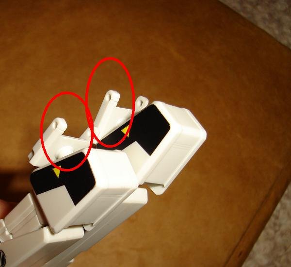

MACROSSF Posted January 8, 2010 Posted January 8, 2010 (edited) Here's my VF-1A. Has crack on both arms. I think replacement shoulder parts should be offered free from Yamato! Edited January 8, 2010 by MACROSSF Quote

m0n5t3r Posted January 8, 2010 Posted January 8, 2010 Here's my VF-1A. Has crack on both arms. I think these broken replacement shoulder parts should be offered free from Yamato! fixed it for ya! Quote
MACROSSF Posted January 8, 2010 Posted January 8, 2010 fixed it for ya! Stupid me, thanks for the correction. Quote

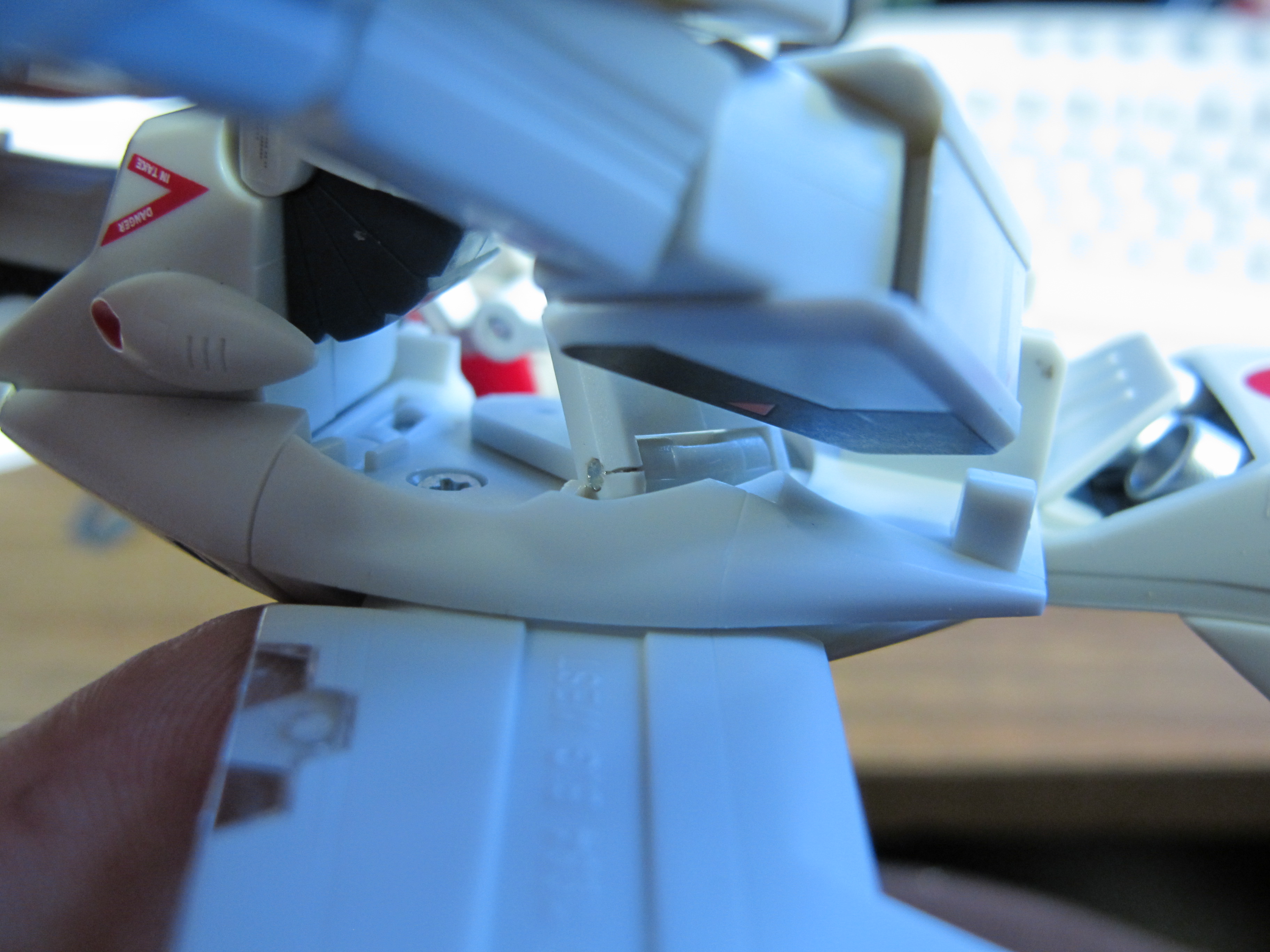

logos Posted January 8, 2010 Posted January 8, 2010 Here is from the VF-1A Hick that I just bought. Both Pins are Knurled but only the right shoulder is cracked. Quote

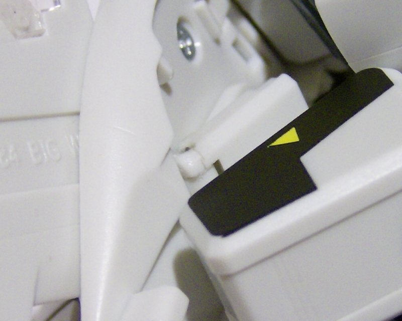

HoveringCheesecake Posted January 8, 2010 Posted January 8, 2010 (edited) CRRRRACK! And I can't display this guy in fighter mode because the cockpit finish bubbled to hell. Roy VF-1S, purchased when it was first released a while back. Never been transformed, so this happened IN THE BOX. Edited January 8, 2010 by meh_cd Quote
