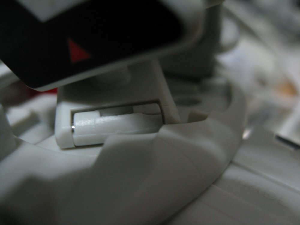

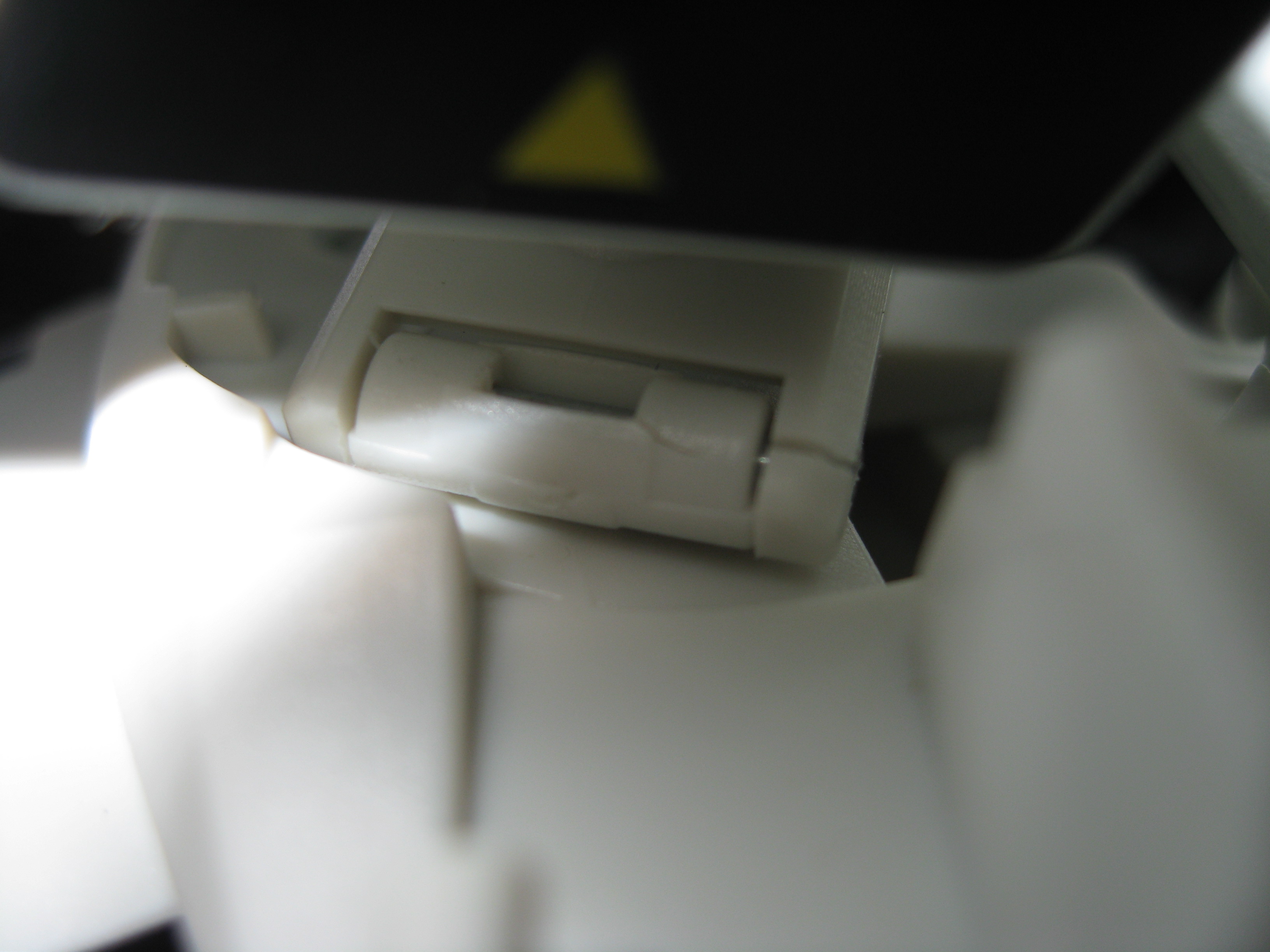

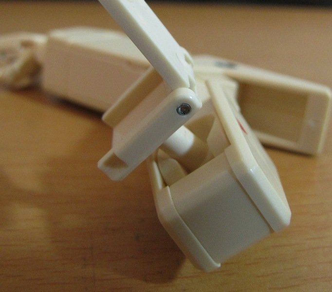

Silvestri Posted January 7, 2010 Posted January 7, 2010 Picked this one up in October when HLJ had their free shipping blitz if you used Paypal and opened it just after Christmas. It's a Fokker with a knurled hinge pin. Quote

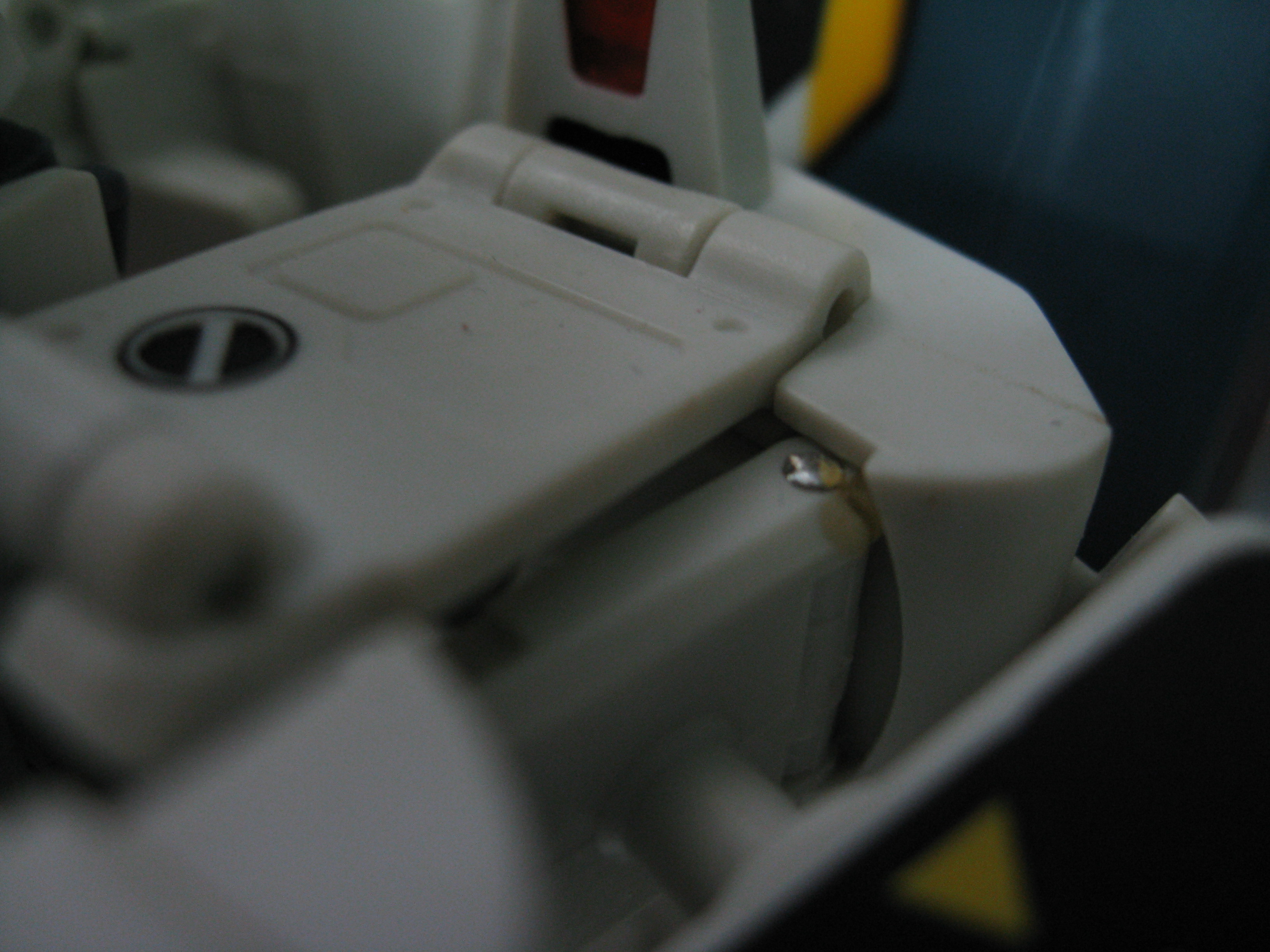

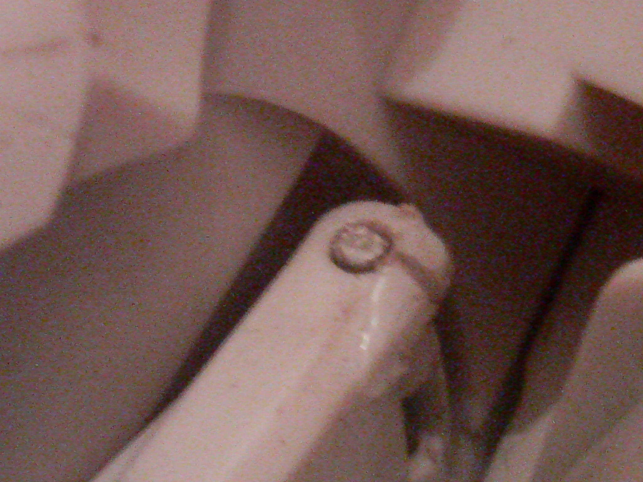

David Hingtgen Posted January 7, 2010 Posted January 7, 2010 We're trying to get as many different pics of V.2 VF-1 toys with broken shoulder hinges as possible, mainly as evidence to Yamato that this problem: 1. Is more common than they think 2. Has many people that still are waiting for replacement parts, months after they broke So----if you've got a VF-1 with a broken shoulder hinge, post a pic of it here. Have 3 valks with 5 broken hinges? Post 5 different pics if you can. Don't worry too much about quality---while clear, obviously-broken pics are nice, we're mainly looking for sheer numbers here. Use your cell phone or web cam if you have to, just post photos of your cracks/chips/breaks. We want as many broken VF-1 photos as possible. LEFT shoulder: RIGHT shoulder: Piece of left hinge: Quote

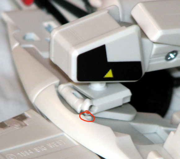

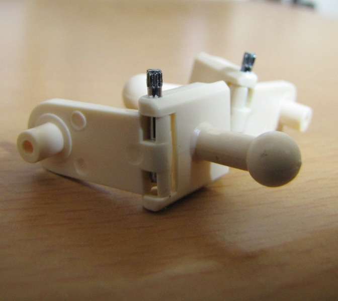

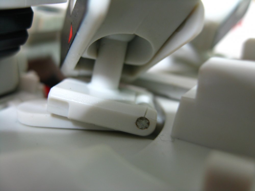

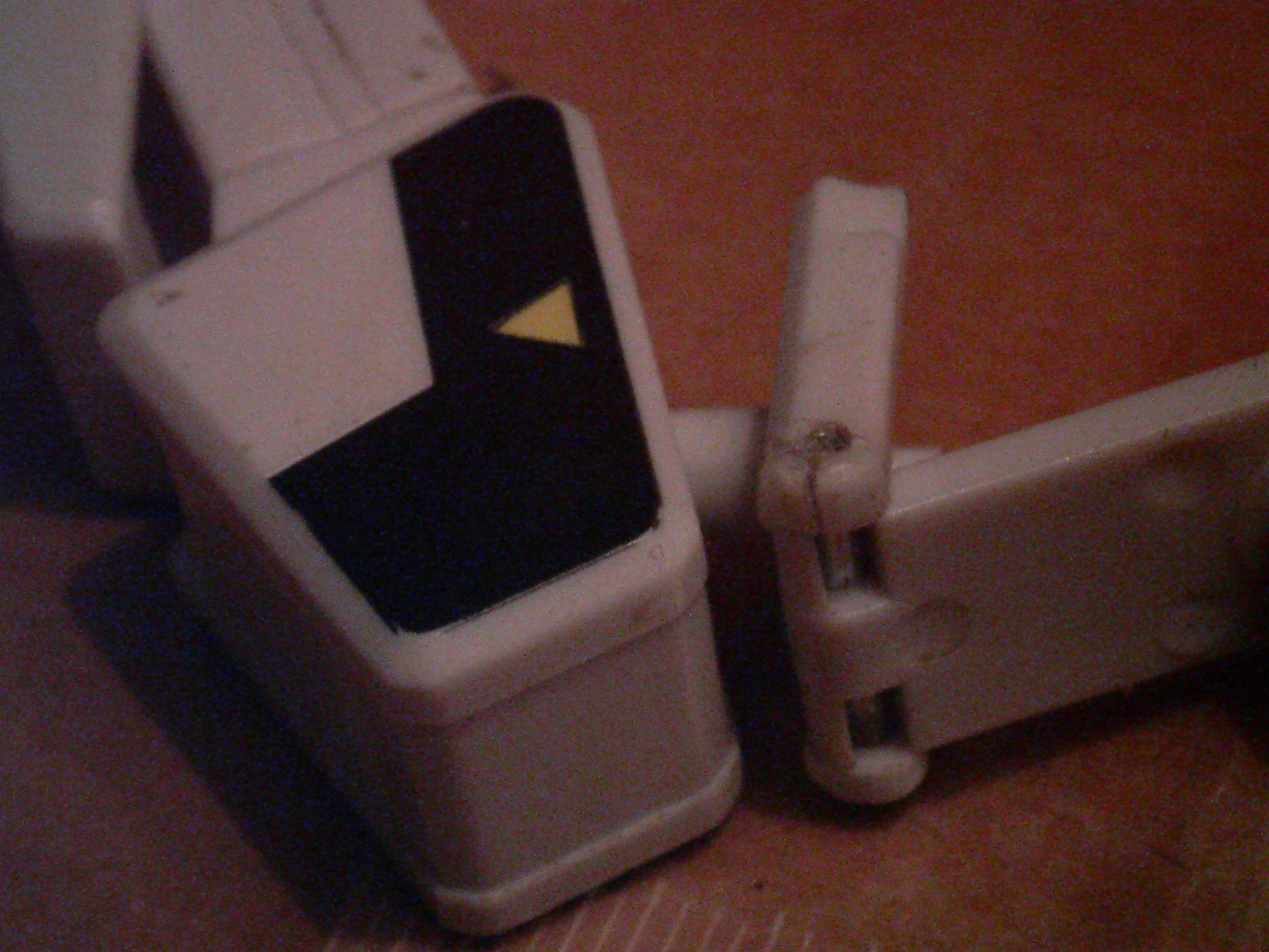

m0n5t3r Posted January 7, 2010 Posted January 7, 2010 (edited) checked my valks... apparently i wasn't able to remove enough of the knurling on one of the shoulder hinges on one of my 1S Fockers that has been on display in battroid for the last year... disassembled it already and i just took a pic before i try to fix it... i didn't notice it at first coz it cracked at the back part instead of the usual place. ...and does this count?... there are still some micro-cracks/stress marks that can be seen even after i had removed the knurling way back last year... ...all the others seem to be fine. Edited January 7, 2010 by m0n5t3r Quote

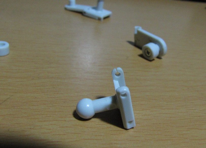

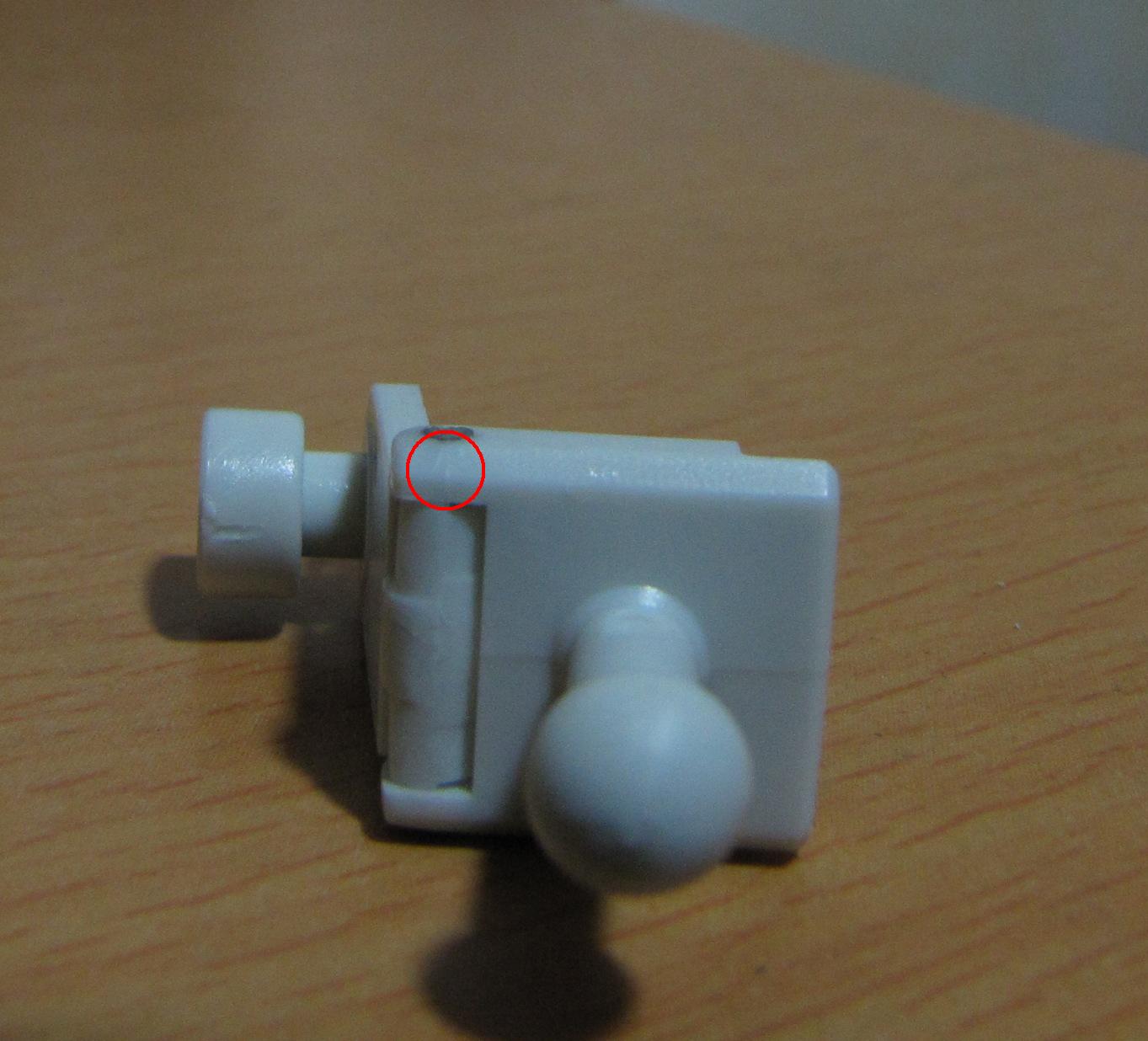

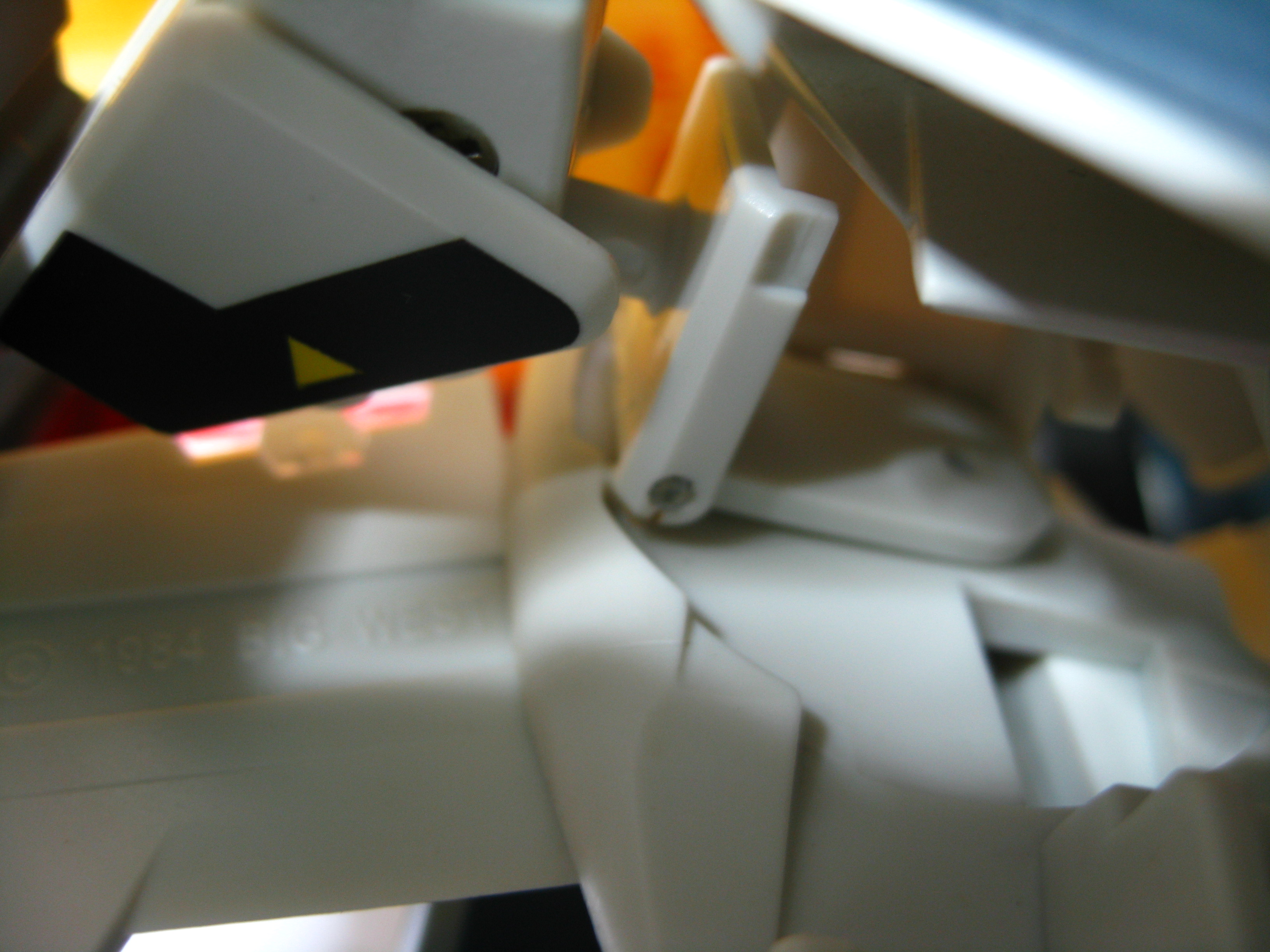

GGemini Posted January 7, 2010 Posted January 7, 2010 (edited) Sorry for the crappy cellphone pic... here are two of the 4 I have replaced: The right arm of a VF-1J and the left arm of a VF-1S. Edited January 7, 2010 by David Hingtgen Tweaked pic Quote

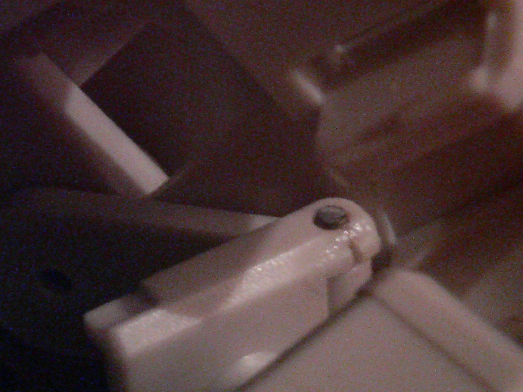

Omegablue Posted January 7, 2010 Posted January 7, 2010 My Millia and Max 1J have extremely floppy shoulder joints. No point posting pics. But can you replace them? As well a Max's wing? Quote

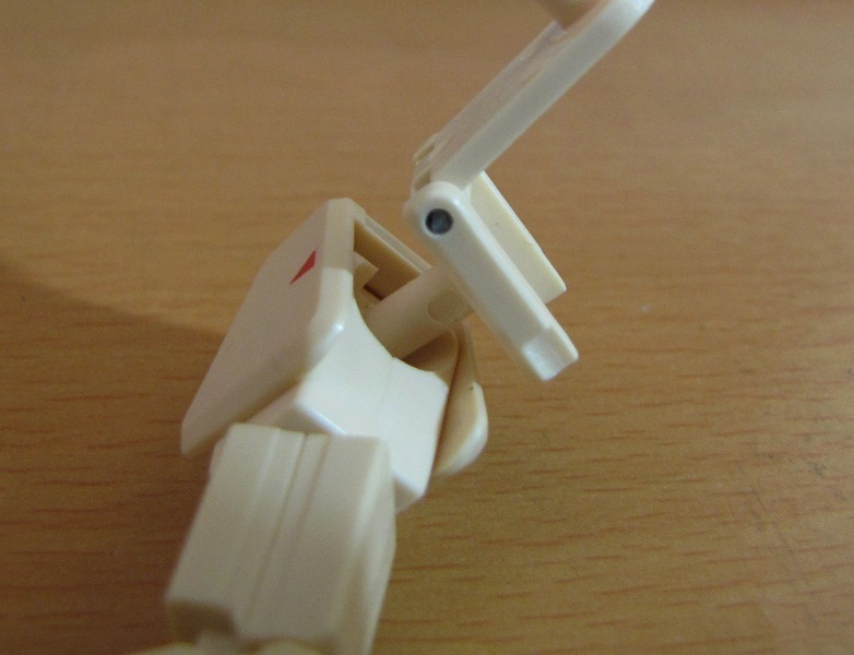

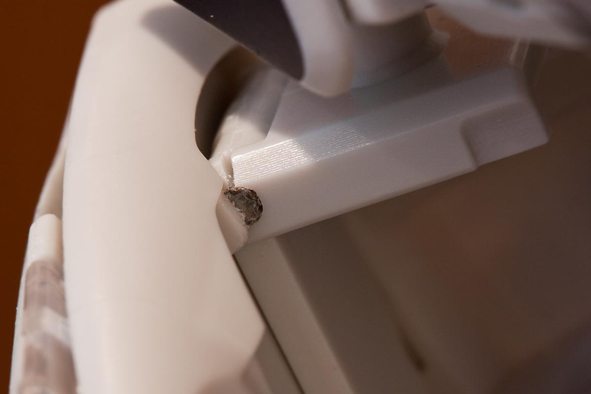

BlueMax Posted January 7, 2010 Posted January 7, 2010 (edited) All except the Strike 1S, which I have known for a long time to have this issue on both shoulders and subsequently fixed with epoxy, were peacefully in their figher modes ever since they were out of the boxes.... but after Graham got Yamatoed and began soliciting for pictures, I figured that I should do my part to get yamato to wake up their f**king idea. I am not even transforming them, I am simply just bending down the leges and slightly swung the arms out to have a better view, and lo and behold: Of the 5 VF-1 V2s on dssplay(Hikky Strike/Super VF-1A, Roy Strike/Super VF-1S, Roy VF-1S, VF-1J CF color, VF-1A CF and VF1D) 3 have broken shoulders (Both the Roys + Hikky Strike/ Super 1A) Both Hikky Super 1A shoulders (with cracks on more than 1 part on one of the assemblies) Both Strike Roy shoulders 1 Roy standalone shoulder Now the even more scary thing is that multiple parts of the assemply has crack rather than just the area at the extreme end of the pin... thus mending is more complicated. Edit: I have all the normal (non limited, non-weathered) VF-1 v2 releases, save for DYRL Max 1A, and I don't have the time to go through each and everyone of them, but i guess I have no doubt that I'll have more cracks to report when I finally get to open all of them up for display when I finally get my own apartment Edited January 7, 2010 by BlueMax Quote

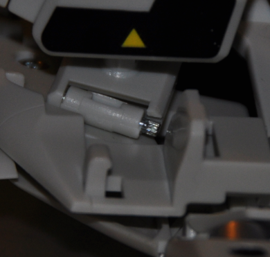

David Hingtgen Posted January 7, 2010 Posted January 7, 2010 Thing is---both sides of the shoulder pass over that nub for every transformation in each direction, but only the side with the knurled pin ever breaks. Also, the shoulder hinges are identical--there is no left/right part---both shoulders use the exact same hinge. Yet they break in almost perfectly equal numbers. So location/use/position has little effect. Quote

m0n5t3r Posted January 8, 2010 Posted January 8, 2010 I just double checked my VF-1D and the pins are the good ones, thankfully. for those thinking that their VF-1Ds have the smooth pins... better check again... they may look like this (no visible knurling on either side) - but there's some little extra metal on top of the knurling that hides it when it's slotted in the hole. <----- paranoid Quote
