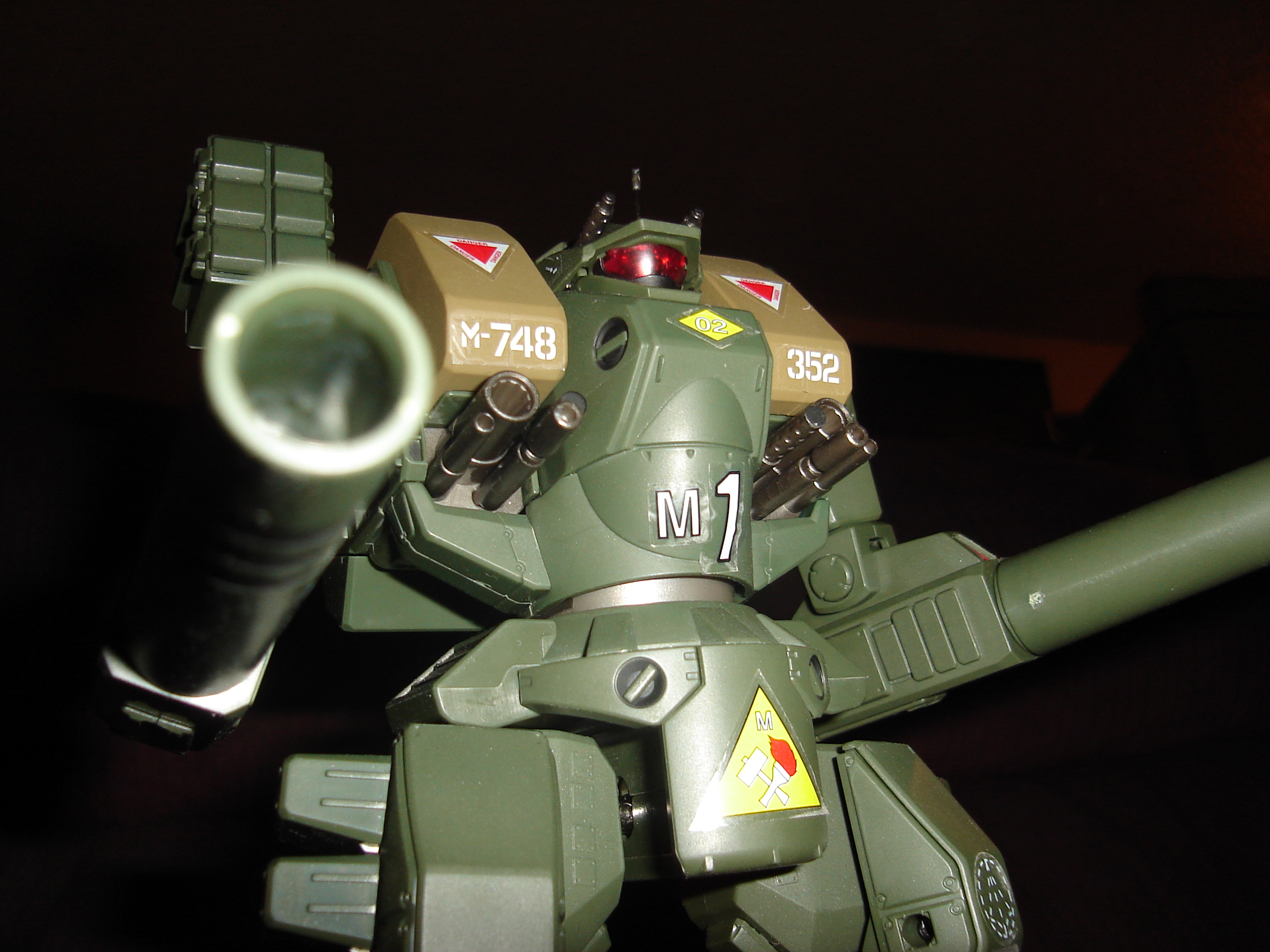

I've got three of Yamato's 1/60 Destroid Tomahawks, and one of them is the Tan 'Special Weathering' edition. Well, the two standard models come with sticker decals, and I've found them to be quite bad, really. Let me show you why.
Now, as you can see, the stickers aren't too good, expecially on the curved dome of the lower torso.
