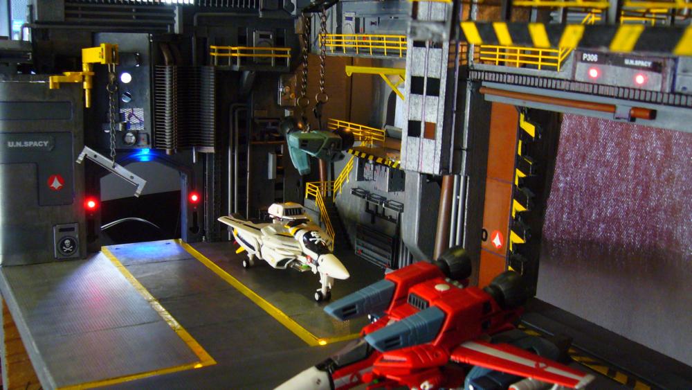

Iceblue106 Posted December 30, 2009 Posted December 30, 2009 Hello all, a handful of you may know me, some have seen my 1/100 scale hanger deck build from another site, however most don't even know of my existence. Regardless of that fact, I have decided to open up a post to ask for tips and ideas as to working with styrene and/or foam board products since I honestly have never worked with either. I am planning on making another hanger diorama (this time on the 1/60 scale) for a buddy of mine and was wondering if any of you could assist me with ideas as far as details in the fabrication process. I have seen many posts here for 1/48 single bay dioramas and have decided to use those as a reference. Any help and suggestions will be greatly appreciated. Thanks, Blue Note: below picture is one of many pictures of my finished Hanger deck composed of balsa wood, plastic, metal, and computer parts and can be seen on The Lost Universe site. Quote
