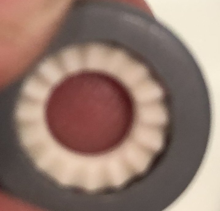

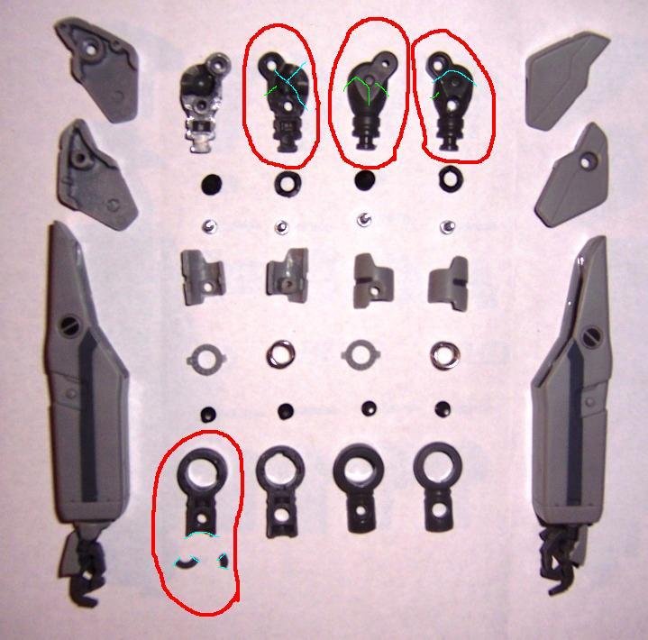

armentage Posted January 2, 2011 Posted January 2, 2011 (edited) I've had a VF-0A for several years, since the original release. About 2 years ago, after not having really touched it for over a year, I was packing it up to move house. I was HORRIFIED to find that the elbow disc joints (that let the forearms spin 360 degrees) had completely disintegrated on both arms. Is there any chance I can get replacement parts for these? Has it happened to anyone else? I have a bad feeling that it was caused by my idiotic use of Endust to clean it Here are some pictures of the damage. The plastic on both ends of the connection looks to have totally crumbled. Edited January 2, 2011 by armentage Quote
Snail00 Posted January 2, 2011 Posted January 2, 2011 I've had a VF-0A for several years, since the original release. About 2 years ago, after not having really touched it for over a year, I was packing it up to move house. I was HORRIFIED to find that the elbow disc joints (that let the forearms spin 360 degrees) had completely disintegrated on both arms. Is there any chance I can get replacement parts for these? Has it happened to anyone else? I have a bad feeling that it was caused by my idiotic use of Endust to clean it Here are some pictures of the damage. The plastic on both ends of the connection looks to have totally crumbled. wow Quote
nightmareB4macross Posted January 2, 2011 Posted January 2, 2011 WWhatever you do, do not use Crazy Glue to repair it. Go it and find Plastruct Glue. I have had great success repairing 0As with problems like these. Quote
armentage Posted January 2, 2011 Posted January 2, 2011 WWhatever you do, do not use Crazy Glue to repair it. Go it and find Plastruct Glue. I have had great success repairing 0As with problems like these. Which Plastruct glue in particular? Looking at their catalog they have: Plastic Weld (bonds dissimilar plastics) Bondene (bonds similar plastics) Weldene (seems like its only for styrene) Weld-On #4 Cyanocylates (I have a variety of zap-o-gap brand cyanocylates) The epoxy's GE silicone II Quote

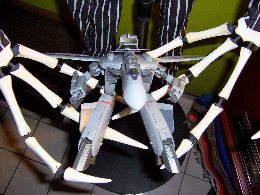

nightmareB4macross Posted January 3, 2011 Posted January 3, 2011 (edited) Which Plastruct glue in particular? ======>>>>Plastic Weld (bonds dissimilar plastics) Before you do anything, read this in it's entirety. Here's what you can do: *Place the PW in front of you where you can see it at all times. If this spills on plastic it will melt it. *MELTS PARTS at the point of contact. Dries quickly when applied thin. **A small application goes a long way. Over applicating will render the parts useless and turn them to goo. ***Use tweezers when making final placements. When your hands make contact with PW anything they touch right after will leaved imbedded fingerints. BROKEN PIECES: 1. Locate all the pieces. 2. Dry fit everything twice, first using you hands, then tweezers. This really helps. 3. Disassemble both biceps and both shoulders. Keep all parts at arms reach. 4. Open your bottle of PW. 5. Brush a brisk light coat on the first surface to be repaired. NOT ALL at parts are to be brushed at once, just the parts to be put together at this time. 6. Re-apply PW while leaving a tiny bead on the contact areas. 7. Re-attach and press the pieces firmly together. Do not add too much pressure, this will lead to warped parts. 8. Repeat steps 5 thru 6 until all parts are bonded together. 9. Allow to dry. 10. Brush a light coat over the exterior of all affected parts, resulting in a glossy finish. DO NOT APPLY PW INSIDE WHERE THE HALVES COME TOGETHER, PARTS WILL BE RUINED. 11. Once the parts are dry, re-assemble everything loosely. DO NOT OVERTIGHTEN. 12. Allow figure to remain untouched and loosely assembled for SEVEN DAYS. Trust me on this. You need the parts to fully dry and not mis-shape while drying. 13. On DAY EIGHT, screw down all parts as normal. DO NOT OVERTIGHTEN THE SHOULDERS or BICEPS. 14. TIGHTEN down on the SHOULDER COVERS ONLY. The pressure applied by these will be sufficient and maintain friction at the shoulder joints. ****Glossy finish can be lightly sanded for a satin finish, but is not necessary. REPAIRING STRESS MARKS - 1. Crack the part off or slightly pry the piece open and brush PW inside. 2. If you cannot open a stress mark, leave it and brush PW over it. 3. Repeat steps 9 thru 14 listed above. Attached pictures: RED - Affected areas BLUE - Stress Marks GREEN - Broken parts Hope this helps. It's worked great for me on various occasions for different Zero Phoenix(es). Edited January 3, 2011 by nightmareB4macross Quote
anime52k8 Posted January 3, 2011 Posted January 3, 2011 (edited) >snip< IS THAT A GIANT JACK SKELLINGTON!?! Edited January 3, 2011 by anime52k8 Quote
nightmareB4macross Posted January 3, 2011 Posted January 3, 2011 OT, but yes he is. 7 and a half feet tall and fully articulate with a stand to help support it. Quote

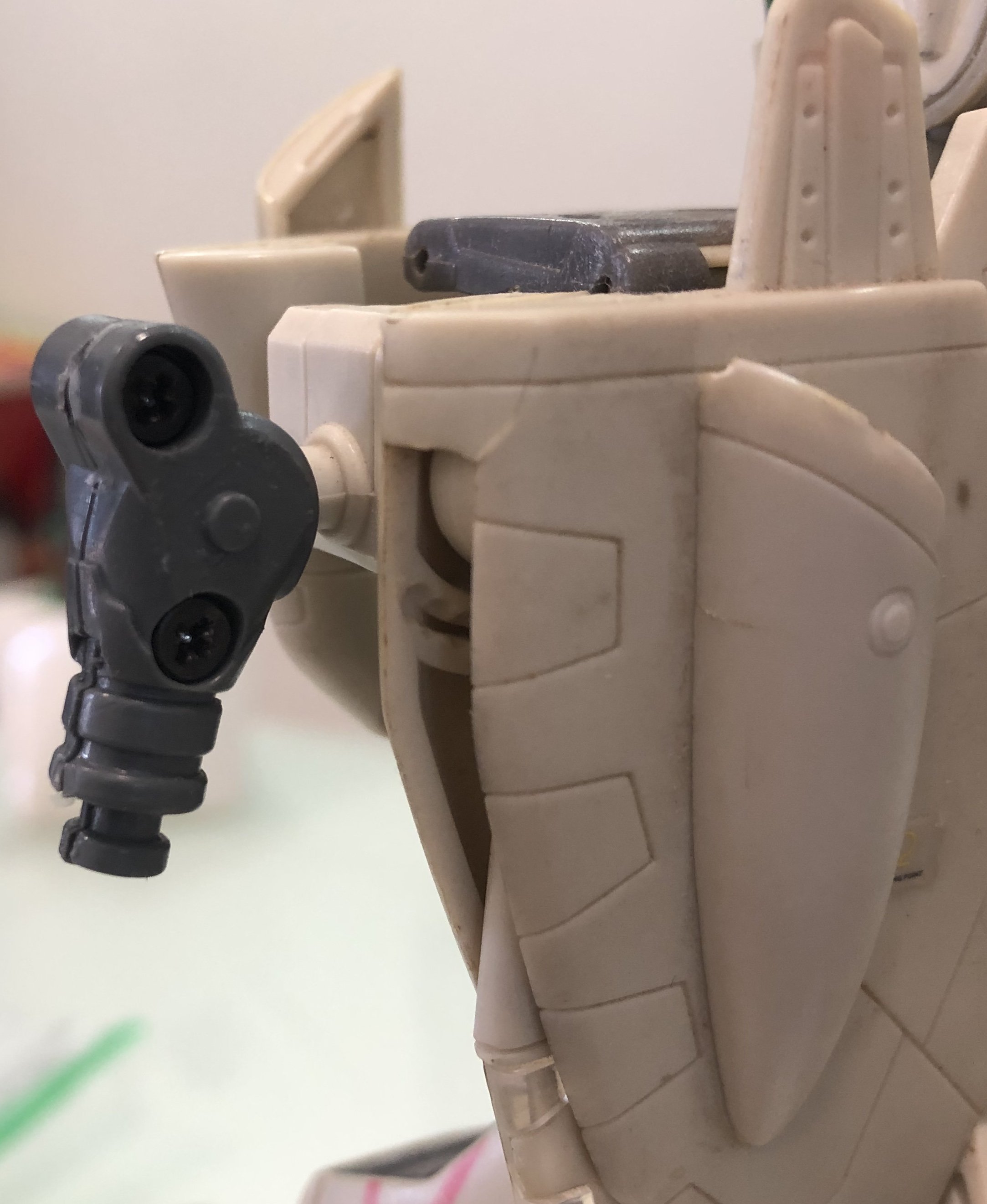

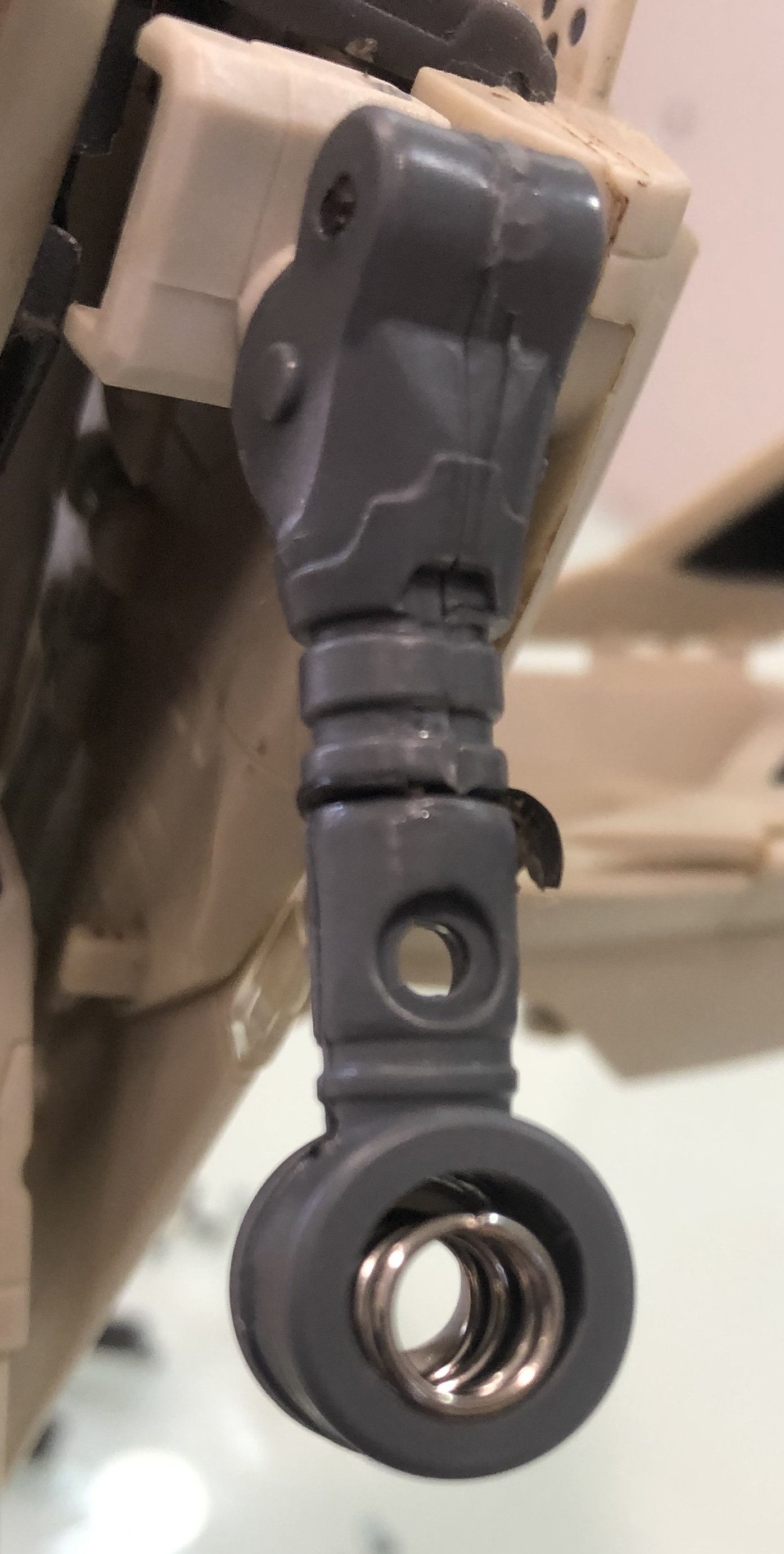

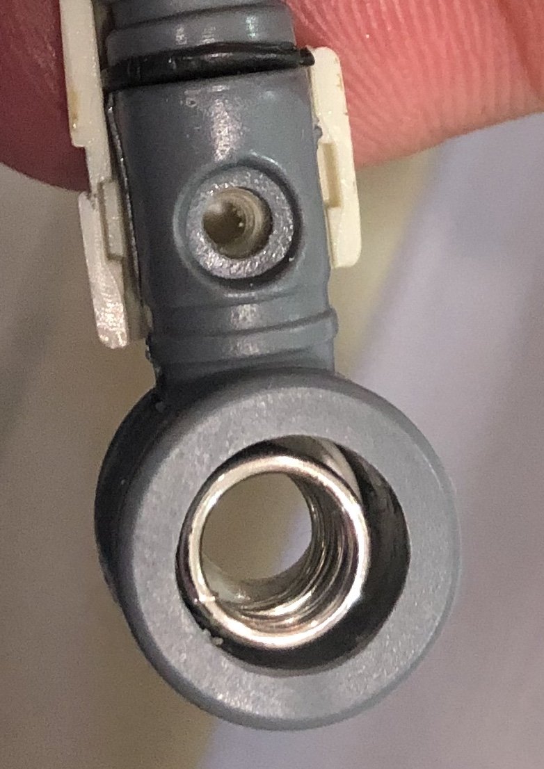

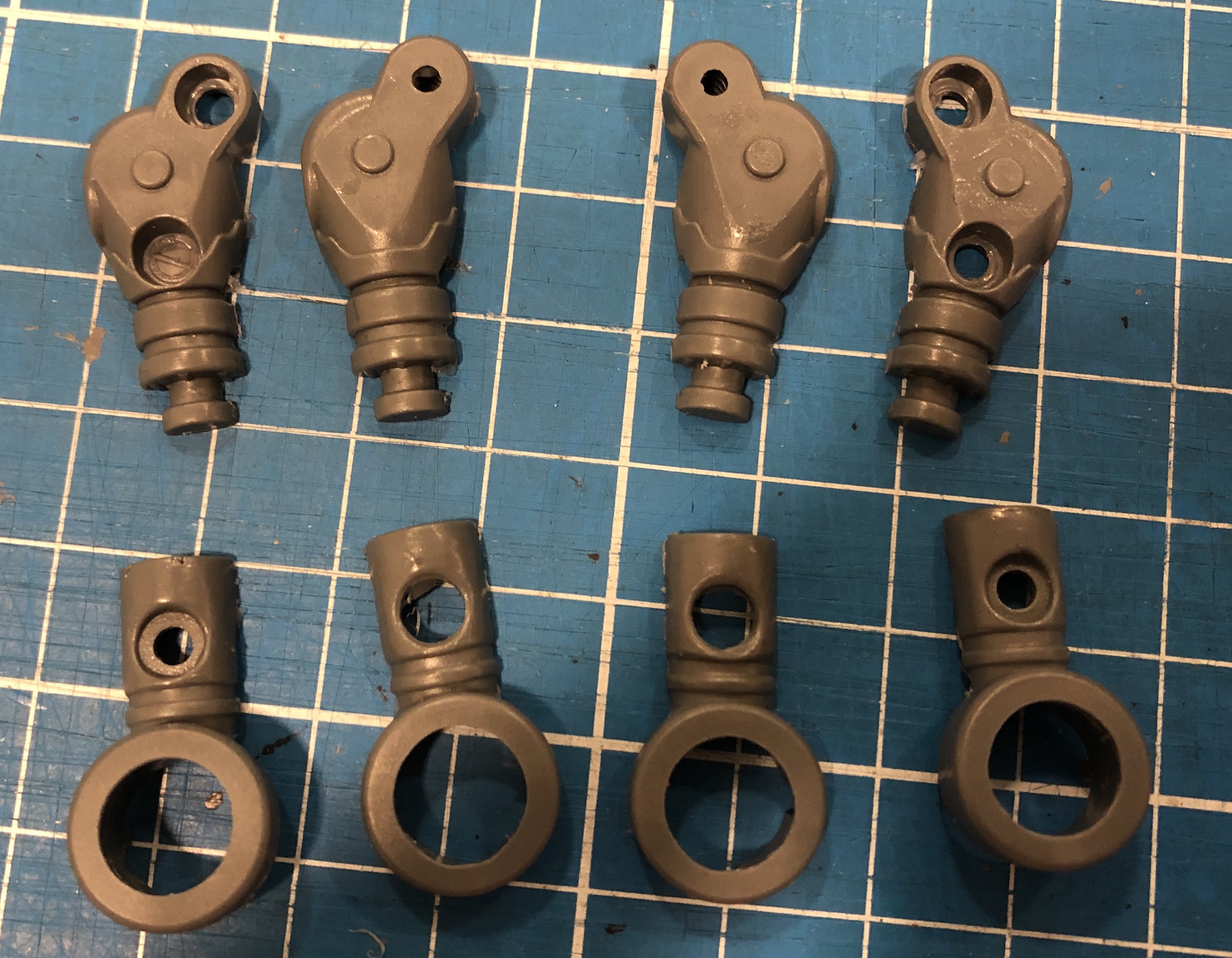

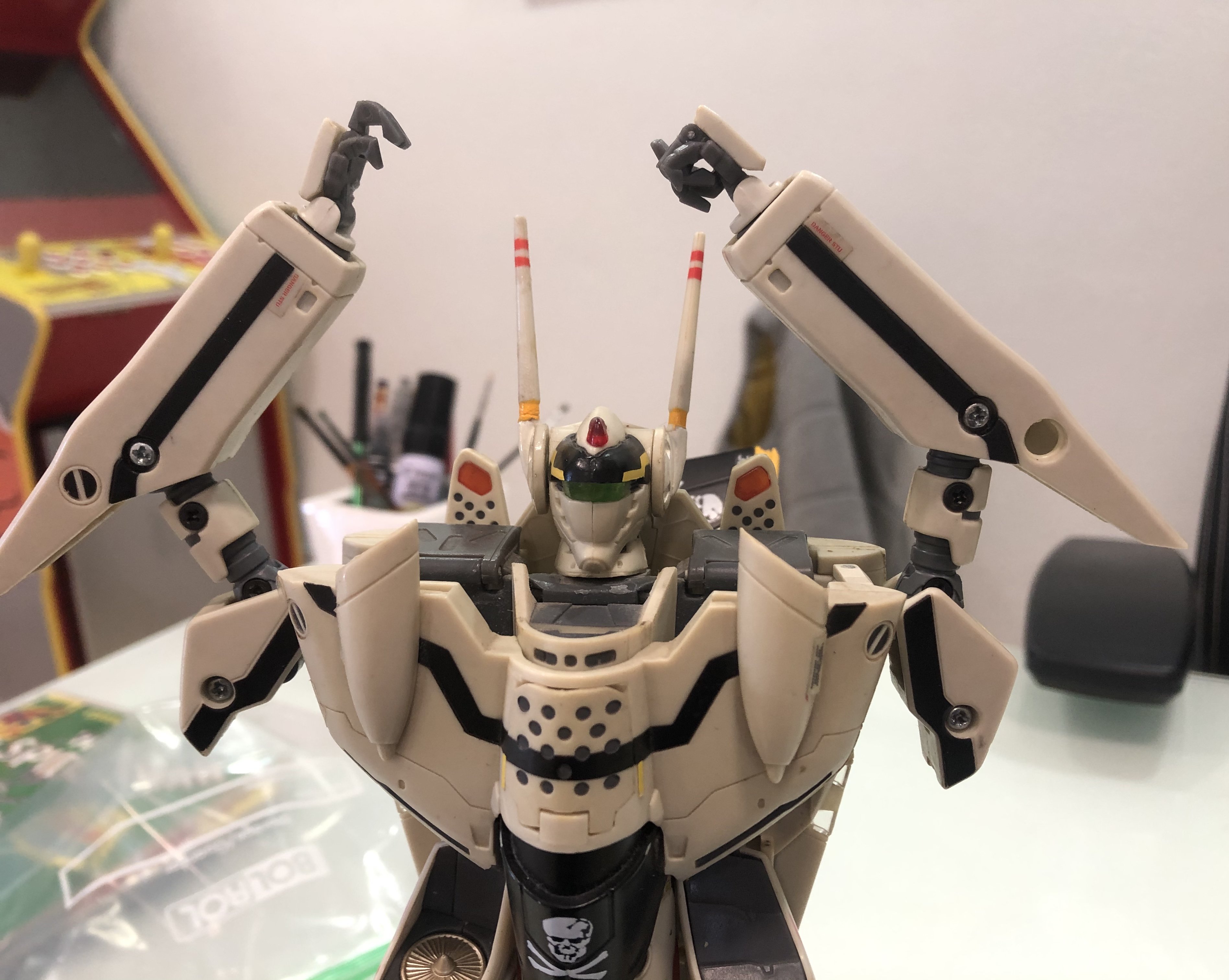

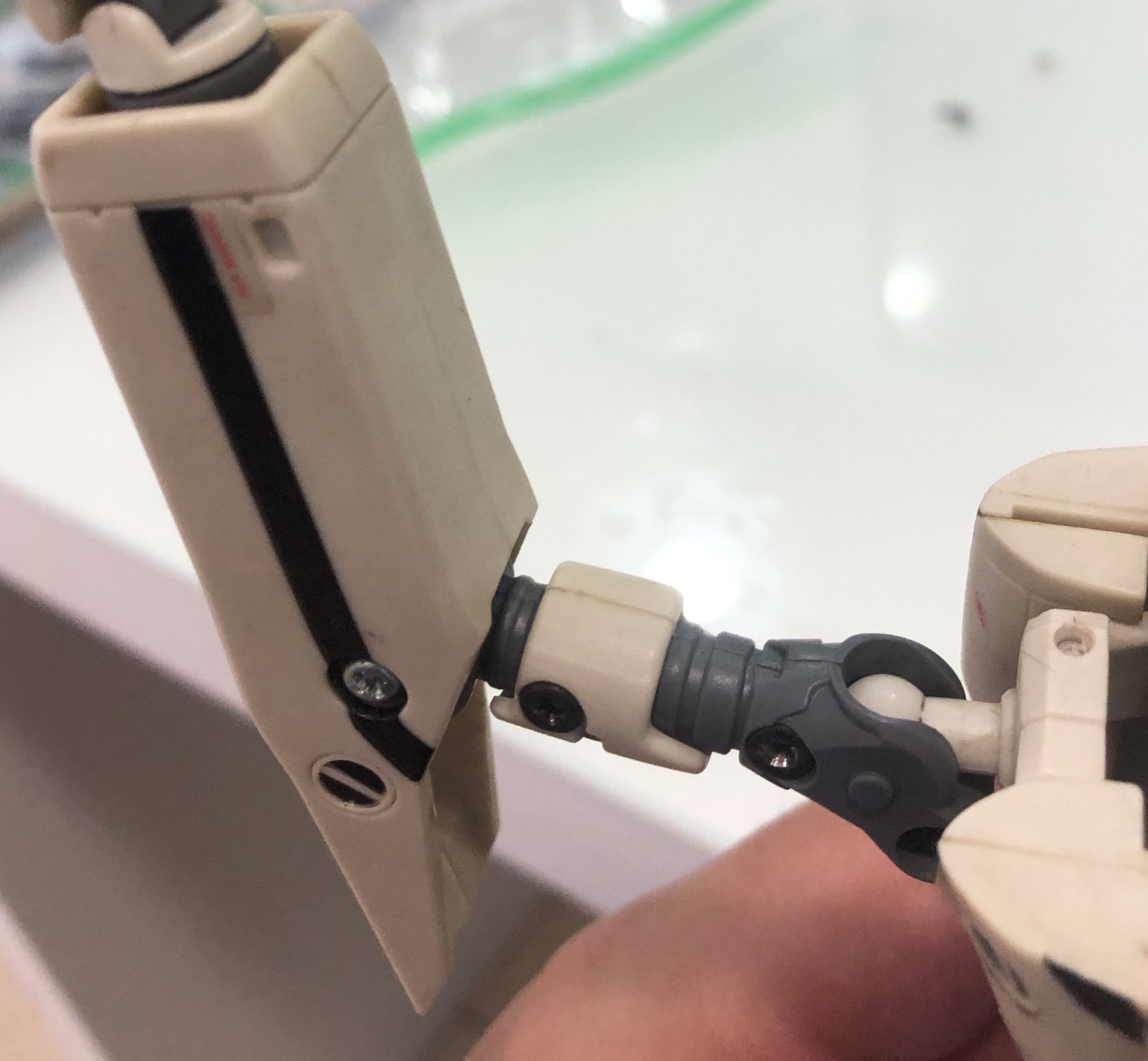

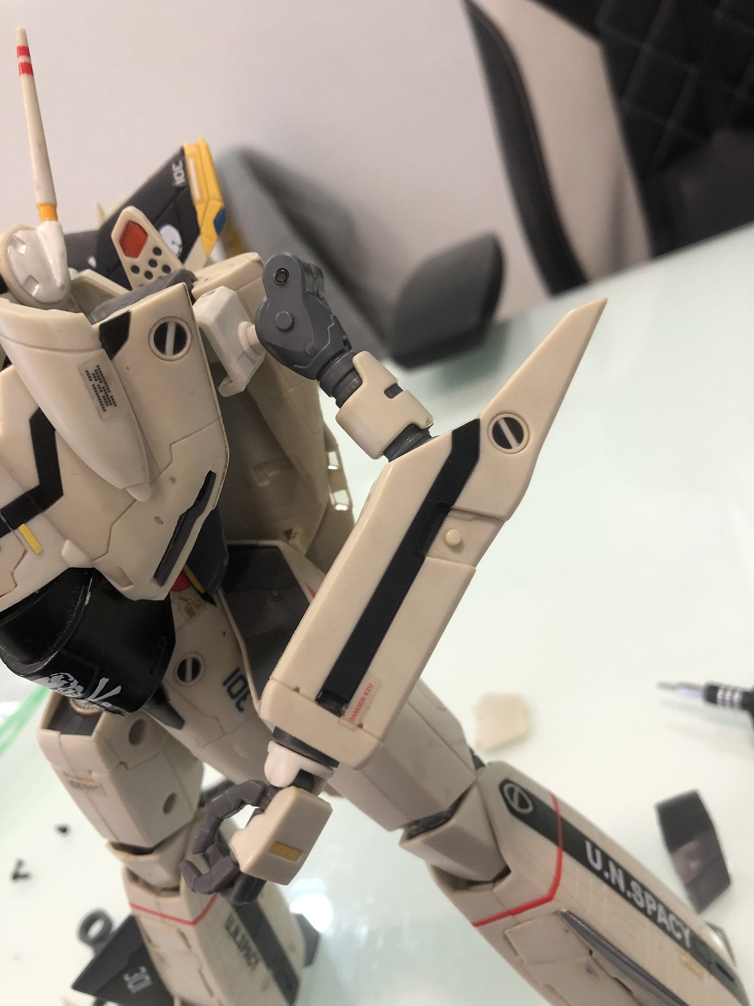

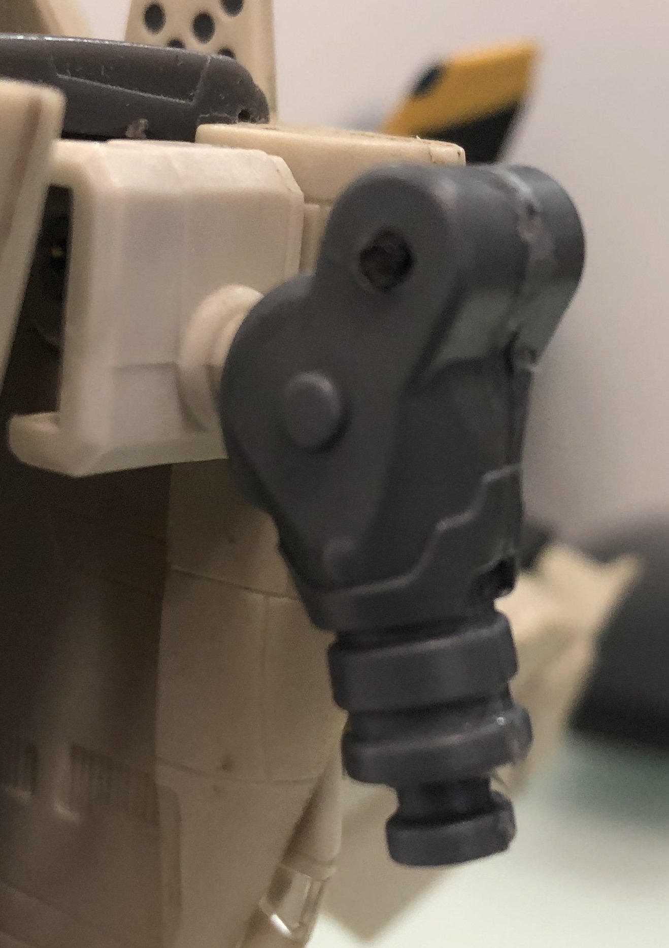

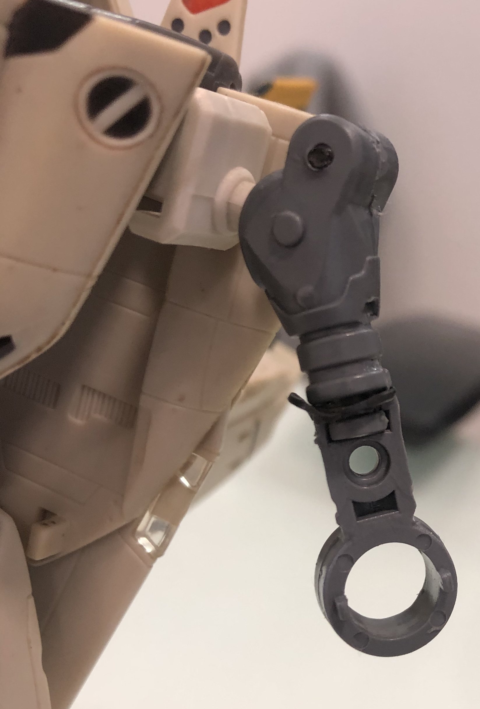

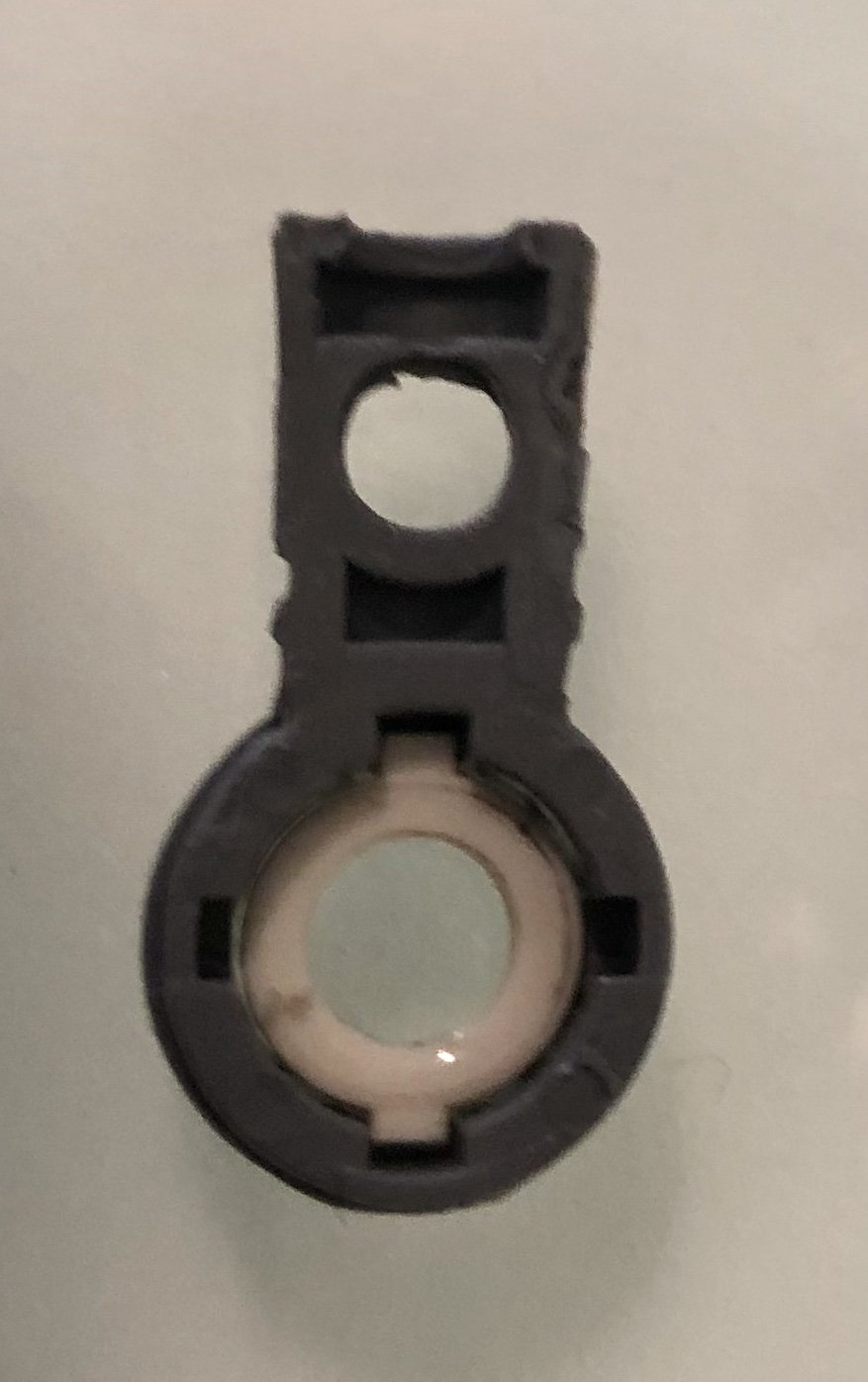

valhary Posted March 17, 2020 Posted March 17, 2020 After several friends has the issue of the explosive biceps and shoulders and dismiss the Shapeways option (too expensive) recast the parts in resin a much more affordable option and seems to work well enough if handle with carefully the yamatos zeros could back to life:) if someone are interested send me a PM Quote
Lolicon Posted March 17, 2020 Posted March 17, 2020 Necromancy! Also, pretty cool fix for those who still want to save their old Yamatos. Quote
nightmareB4macross Posted March 17, 2020 Posted March 17, 2020 13 hours ago, valhary said: After several friends has the issue of the explosive biceps and shoulders and dismiss the Shapeways option (too expensive) recast the parts in resin a much more affordable option and seems to work well enough if handle with carefully the yamatos zeros could back to life:) if someone are interested send me a PM Nice!! What type of resin are you using to make these? I remember using various types of resin, but the one that worked best were those that hardened to a plastic finish versus those that seemed to warp over time.  Great work! Quote
nightmareB4macross Posted March 18, 2020 Posted March 18, 2020 10 hours ago, valhary said: Urethane resin What type or classification? Quote
nightmareB4macross Posted March 19, 2020 Posted March 19, 2020 That is good resin. Should last and hold up very well. Awesome work as always!! Quote
