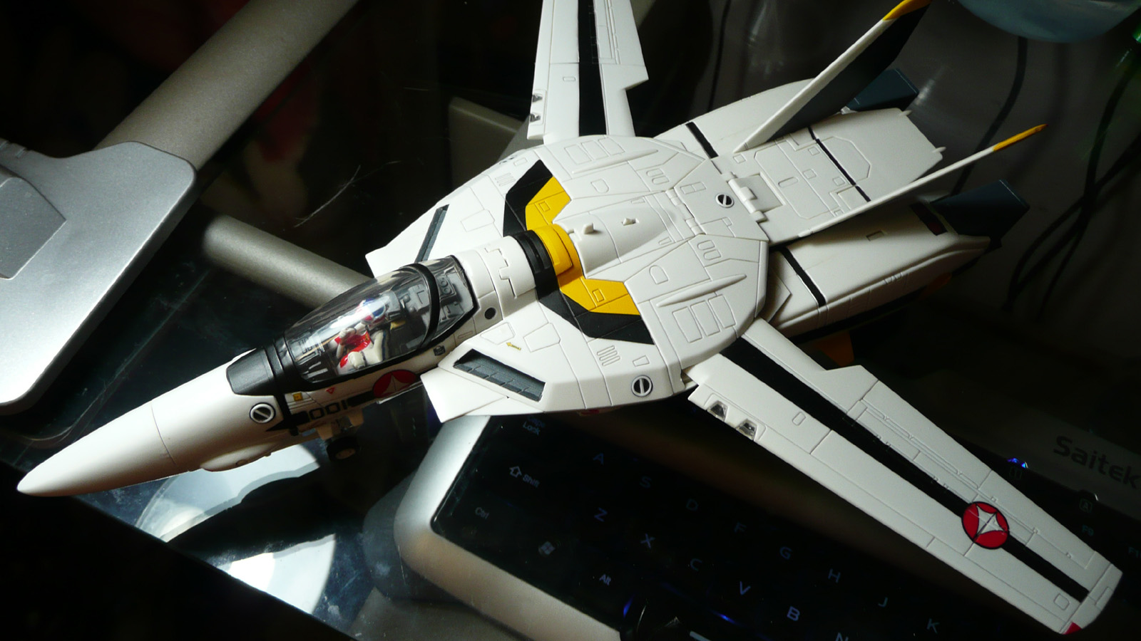

Lolicon Posted December 15, 2009 Share Posted December 15, 2009 Gundam marker is too fat and sloppy for any kind of fine panel line work. I use a 0.3 mm mechanical pencil. Though plain lead works fine, on my Yamatos I used a higher density (2H) lead that's harder and draws lighter; I didn't want dark, sloppy panel lines. Not prone to smudging at all, either. Quote Link to comment Share on other sites More sharing options...
Macross_Fanboy Posted December 16, 2009 Author Share Posted December 16, 2009 Gundam marker is too fat and sloppy for any kind of fine panel line work. I use a 0.3 mm mechanical pencil. Though plain lead works fine, on my Yamatos I used a higher density (2H) lead that's harder and draws lighter; I didn't want dark, sloppy panel lines. Not prone to smudging at all, either. Thanks for the pic, I guess I'll go with a pencil, I got a .7mm pencil so that won't do at all, looks like I'll order one from HLJ since I won't have time to drive to a shop and get one. Quote Link to comment Share on other sites More sharing options...
