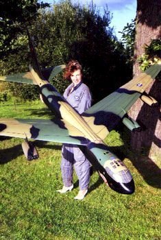

the b-52 is a 5 year goal. i was thinking 4 engines with 4 fake ones for look of 8 engines.
