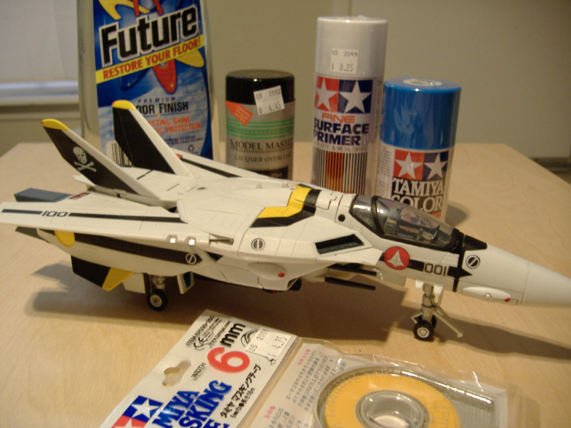

Wicked Ace Posted December 5, 2009 Posted December 5, 2009 (edited) Model Master (spray) paint and flat coat does not harm Yamato plastic (specifically, I refer to the plastic 1/48 scale VF-1 Valkyrie). That being said, I prefer Tamiya brand. Edited December 5, 2009 by Wicked Ace Quote

Wicked Ace Posted December 6, 2009 Posted December 6, 2009 (edited) Thanks, I have never really gotten to use Tamiya much. I think mainly due to most of my early modeling being historical aircraft and local availability. One of these days I may give it a go though. I have a 1/72 VE-1 that I still need to get started on, maybe I will have to pick up some Tamiyas. My biggest gripe is that I've had lousy luck with Testor's brand Model Master sprays clogging up and/or having tooth problems resulting in uneven spray. I have never had an issue with Tamiya spray paints, and the tooth seems to provide a finer spray than the Testor's stuff. There are other brands other members may like better than Tamiya; I started using it due to local availability. BTW, please post pics of what you are working on. Edited December 6, 2009 by Wicked Ace Quote
leading edge Posted December 20, 2009 Posted December 20, 2009 My biggest gripe is that I've had lousy luck with Testor's brand Model Master sprays clogging up and/or having tooth problems resulting in uneven spray. I have never had an issue with Tamiya spray paints, and the tooth seems to provide a finer spray than the Testor's stuff. There are other brands other members may like better than Tamiya; I started using it due to local availability. BTW, please post pics of what you are working on. I've worker with Testors stuff before good color but has some issues wit drying if not careful can rub away if a acid is anywhere near it before it dries. Usually I dry it with a hair dryer and mix a bit of thinner and the right amount of Microscale for strength the combination in an air brush makes for a stronger more even coat of paint. Also I like to thoroughly sand my surface before painting which is extremely helpful. A 900grid give more stick than 1000 grit. Testors is more about economics but if there is a sale try Tamiya for a finer finish. Quote
David Hingtgen Posted December 20, 2009 Posted December 20, 2009 I don't like brush-painting Tamiya, but they have the best spray cans by far. Quote
mrclean08 Posted December 27, 2009 Posted December 27, 2009 Although I haven't painted my Yamato Valkyries yet, I have done a few Transformers customs using Testor's Model Master. I have done other custom work such as McFarlane Sportspicks, and various resin and vinyl model kits, but for something that needs durability, I found that the Model Master paints faired very well. I think Model Master paints will be good on the Valkyries as long as you do a thorough prep job by laying a good underlying primer. As with Transformer customs, there is still the likeliness for paint rubbing especially between tight joints. But with my experience with customs, enamels and lacquers are far more durable than acrylics. Aside from making sure you have a solid prep job, it is equally important to make sure your enamels have a full 100% cure dry time. I go as far as waiting 10 - 14 days for my enamels to cure on my Transformer customs. The biggest thing I notice with waiting this long is that it minimizes paint chipping or scratching. Keep in mind, there are many factors that need to be considered when waiting for enamels to cure: weather/temperature, humidity, etc. I plan on doing a Minmay Guard custom Valkyrie and will definitely be using Model Master Paints. I will say that I don't use spray cans when I paint with Model Master. I strictly use an dual-action airbrush. So others will have varying experiences with this brand depending on medium. Quote
