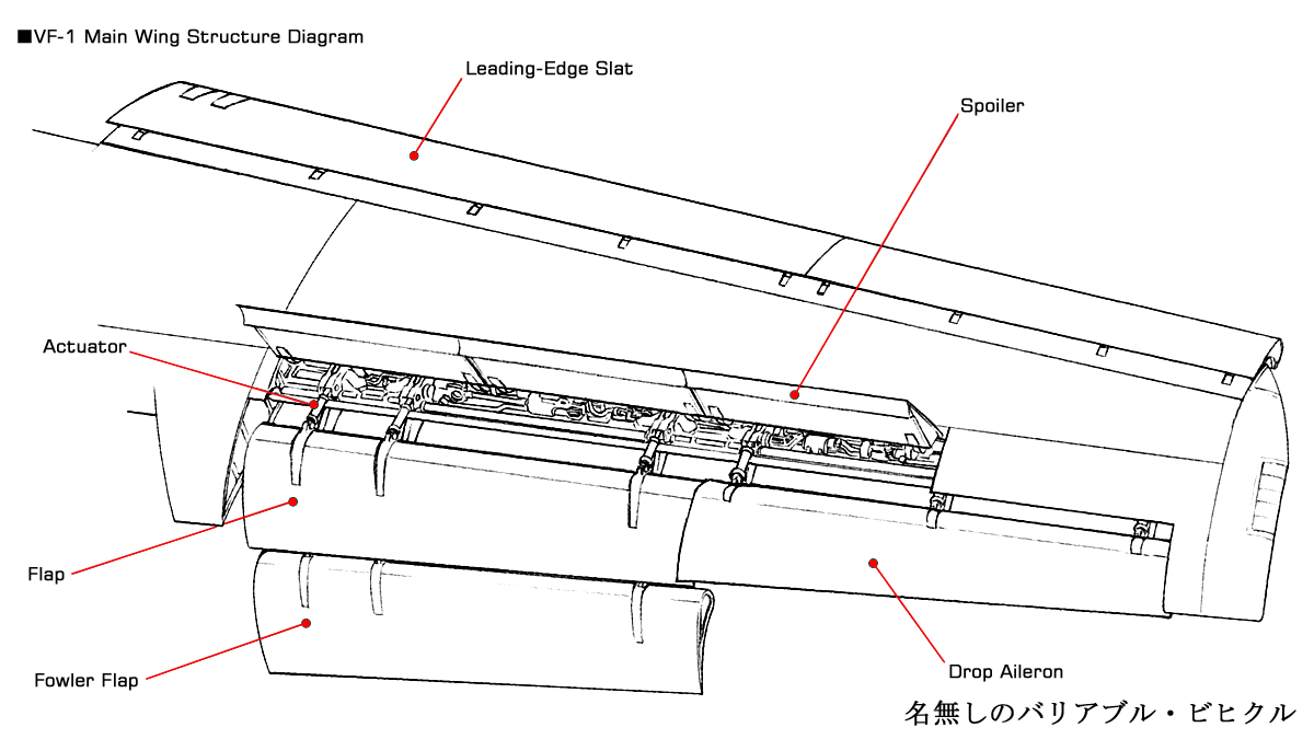

nanashino Posted October 5, 2009 Posted October 5, 2009 While we are on the subject.... Some reference material: Nanashi's Information Group Quote

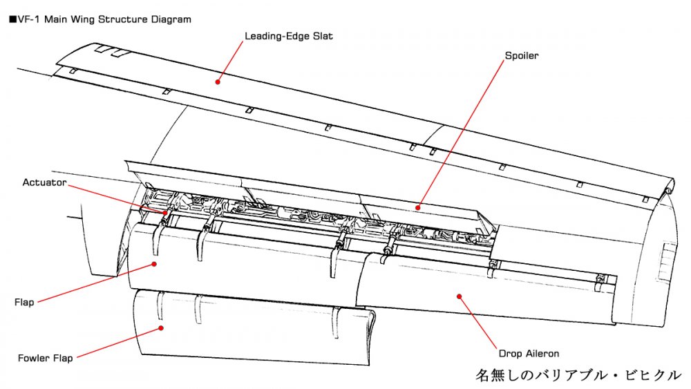

David Hingtgen Posted October 5, 2009 Posted October 5, 2009 I think that should be a "droop" aileron, not drop. Actually, it should be a slotted flaperon IMHO. (you know, do we ever see them move as ailerons at all? DYRL game maybe?) For the flaps---is that exactly how the original is written? Technically you don't have fowler flaps attached to "normal" flaps----the whole area is "fowler flaps", consisting of a primary and secondary (since these are double-slotted) flap segment. Quote
sketchley Posted October 5, 2009 Posted October 5, 2009 (edited) ... which has a link to a handy illustrating illustration: http://www.jal.co.jp/jiten/dict/g_page/g123_3.html (In translation: upper one is "Slotted Flap" and "slot", and lower is "Fowler Flap". Edited October 5, 2009 by David Hingtgen Quote
David Hingtgen Posted October 5, 2009 Posted October 5, 2009 Aw ****, I edited your post instead of my own. (it happens with mod power---blah blah great responsibility) Sorry! Anyways: While that's true (I wouldn't expect JAL to be wrong) that's only because those are single-slotted flaps. Once you get to double (or more) slots, it's all fowler, all slotted. There's no other way to do it AFAIK, and they're not independently labeled. Yes, the upper part is slotted, and the lower part is fowler. But the lower part is also slotted and the upper part is also fowler. It'd be like labeling some lions as "feline" and noting others as "cats"---they're all both, and shouldn't be labeled differently. Quote

nanashino Posted October 8, 2009 Posted October 8, 2009 You are right. How careless of me. Corrected: http://users.fini.net/~ed/vv/vf1/vf1-main_wing.jpg The rest is word for word. Nanashi's Information Group I think that should be a "droop" aileron, not drop. Actually, it should be a slotted flaperon IMHO. (you know, do we ever see them move as ailerons at all? DYRL game maybe?) For the flaps---is that exactly how the original is written? Technically you don't have fowler flaps attached to "normal" flaps----the whole area is "fowler flaps", consisting of a primary and secondary (since these are double-slotted) flap segment. Quote
nanashino Posted October 8, 2009 Posted October 8, 2009 It is from the new Variable Fighter Master - File VF-1 Valkyrie book. - Nanashi's Information Group I know this, but I'm saying I haven't seen that particular image before. I'd seen others illustrating the wing design, but that one notsomuch. Quote
