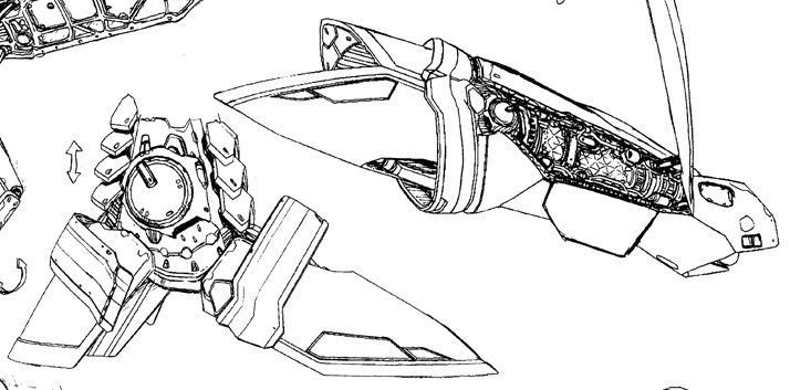

azrael Posted September 17, 2009 Posted September 17, 2009 Interesting thing to note, the vertical "tails" don't appear to have any way of actually moving. I think the reason the legs end up on there sides is that TV is the primary mode of yaw control, and the vertical fins are only there to serve as ballistic shields in battroid mode and to provide lateral stability. IIRC, the VF-17 has horizontal thrust-vectoring and the VF-171 inherits this feature. Quote
hobbes221 Posted September 17, 2009 Posted September 17, 2009 (edited) Here's a shot of a -171 using it in action Edited September 17, 2009 by hobbes221 Quote
anime52k8 Posted September 17, 2009 Posted September 17, 2009 IIRC, the VF-17 has horizontal thrust-vectoring and the VF-171 inherits this feature. That's my point. The VF-17 has horizontal TV which effects yaw. Since the tail fins don't appear to move, in an atmosphere TV is most likely the primary way of controlling yaw. Quote
SchizophrenicMC Posted September 18, 2009 Posted September 18, 2009 Well, see, my issue with that theory, Mike, is that the sweep of the control surfaces is really deep. I'm no expert (Not even an amateur, admittedly), but it would seem they'd be pretty insufficient at that angle for a lot of aerial maneuvers. Let's ask the engineering student. Dex? What's your take? Quote

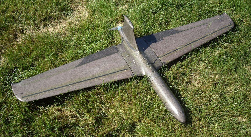

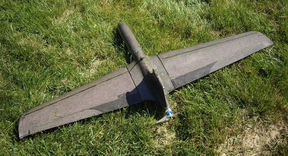

IAD Posted September 18, 2009 Posted September 18, 2009 I don't see why the VF-1 can't be considered a flying wing, plain and simple... I've been building autonomous UAVs for the last couple years, and I've been using plank-type flying wings the whole time... (See attached.) Unswept wings, with elevons along the back. With the correct airfoils and CG, they have neutral pitch stability, and are a lot of fun to fly in manual mode. (In autonomous/FBW mode, they're completely stable, of course... You just stand there while the flight plan executes, watching a laptop for system messages/faults. "Don't take your eyes off that monitor!") I've also flown more conventional swept flying wings, which work well, too... Basically, these configurations bracket the range of sweep the VF-1 exhibits. By extension, the VF-1 doesn't need thrust-vector, verniers, or even FBW in order to be controllable/flyable, as long as the CG stays within the required range during wing actuation. (FBW becomes necessary if you move the CG back, to optimize combat maneuverability... Same for thrust-vector; not needed, but it makes it fight better.) ~Luke Quote
