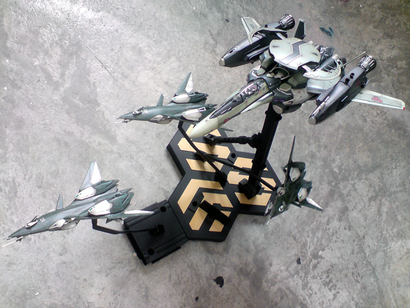

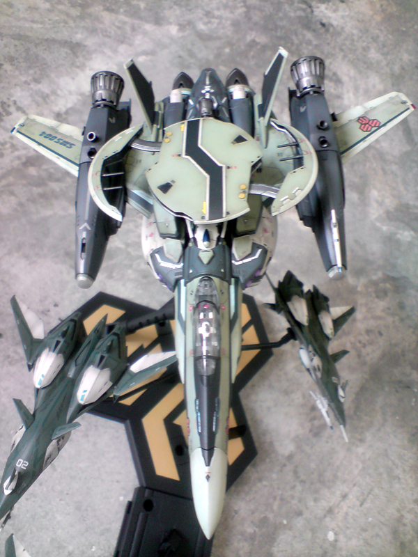

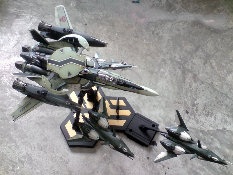

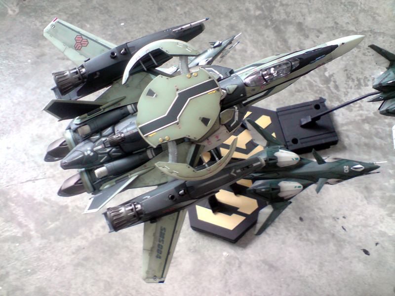

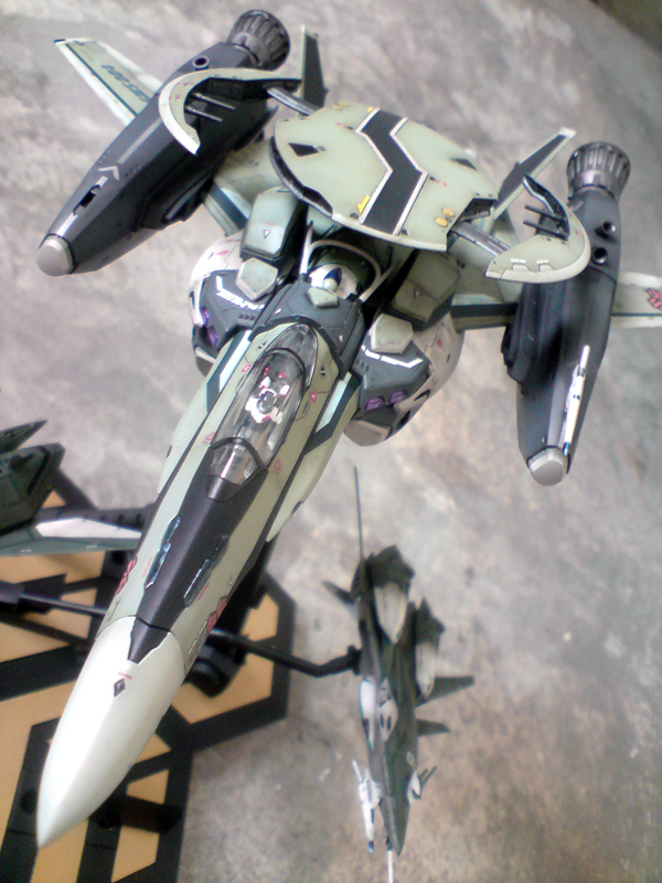

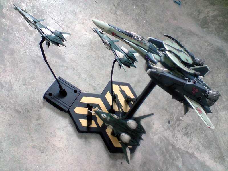

my first macross frontier model kit....thanks to all (WM Cheng, Petar B, Cool8er, denversaur, kyekye and others) who inspired me to finish this kit. still have a little bit touch up work here n there, before completing my rvf-25 supermessiah...guess i'll post the pics first since i'll be outstation for a while. pictures taken using my camera phone....sorry for the crappy pictures. will try with better quality camera after the final completion of the kit.

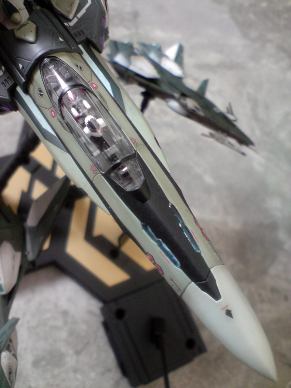

one question: does the RVF-25 still transform?

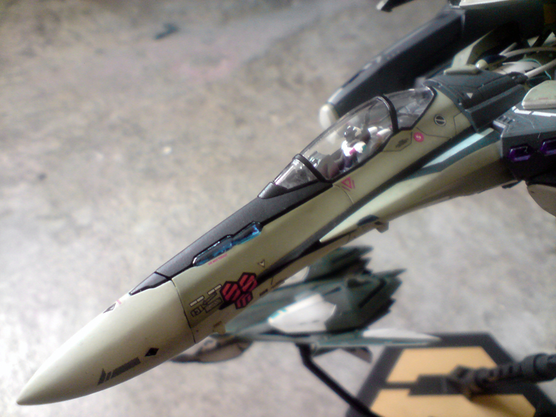

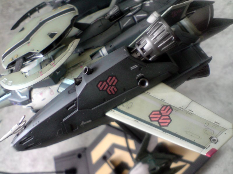

one request: can we see closeups of the ghosts?

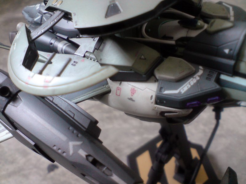

Excellent choice of colors, we need more of these "real" looking VF-25s. The subtle shading looks phantastic. You should have gone all the way and cut the mis-matching colors from the decals.

This is how the RVF should be built and painted.. Can you change the background color so we can see the contrast a bit better? and another questions; What are the color mixes of green that you used?

Fantastic work. The Colors are perfect. The plastic unpainted is too bright. This one though looks realistic. I am totally jealous!
As someone striving to get one of these to look "real" I'm just blown away by how well you did on yours! I never thought the RVF was all that great. But yours looks amazing! Would love to know how you went about doing your shading (pre, post, colours). If you wouldn't mind sharing that is.

This is one of the better looking Frontier models I've seen. The shading and more realistic colours do wonders for making this work. Well done... I would have liked to see bigger pics, though. But thanks for posting, and now you've got a fantastic display piece.
thanks all for all the kudos. firstly this modelkits from bandai was a pain to built.....it took me almost 3 months to complete the assembly....but it does give me a whole lot new experience and a very useful learning process in modelmaking
regult, i use my sonyericsson k850i camera phone. i built the rvf-25 non-transformable (sorry to dissapoint u), i glued everything so the flimzy parts of the modelkit especiallly the legs to be in place. with the superpack, the designated joints weren't designed properly (i guess and wondered why...)that it wont stick 'tightly' where it shud be compared without the superpacks...u know what i mean...i always wanted my VFs to look sturdy and rigid. i'll post the closeups of the ghost later when i'm back home...(currently outstationed... :mellow: )
electric indigo, yeah i too think i shud painted those mismatching colours of the decals, will see what i can do.... ;)
007-vf1, those pics weren't taken properly, even without a proper background...was out of time since i was going outstation for a while. for the colour, i cant recall the exact colour code and mixture...

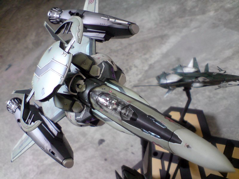

micky G, for this kit i did post shading using thinned tamiya smoke 1:6 mixture. i did the shading i learned from master cheng's build-ups posts :p ...nothing special. basically using 0.3 airbrush with the smallest nozzle opening. then sprayed 1 layer of tamiya clear, let dry for 1 night. after that is the weathering process using tamiya weathering master.....errr i think the B set...i just use SOOT for the shading. lastly 1 layer of flat clear...will describe further details plus the colour mixture later(when i'm back that is....) :D .

So did you apply the Tamiya weathing powders to the gloss coat after the smoke post shading? I haven't really used much of the Tamiya weathering stuff, but have one set which I experimented on the Atmospheric Booster Launch Rail, and found out that it only applied well over a flat/matte base.
