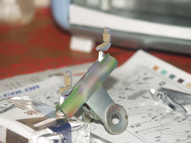

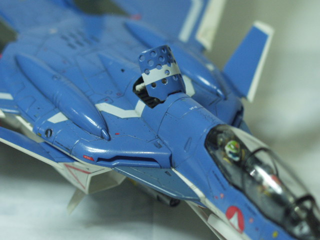

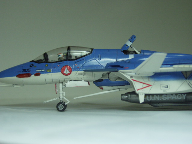

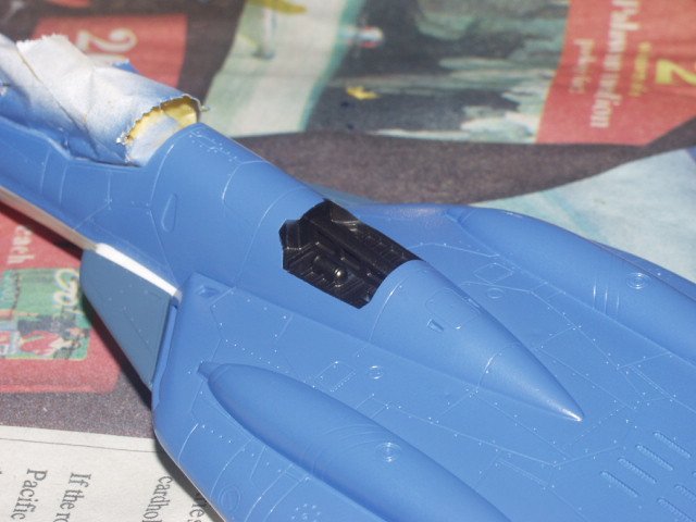

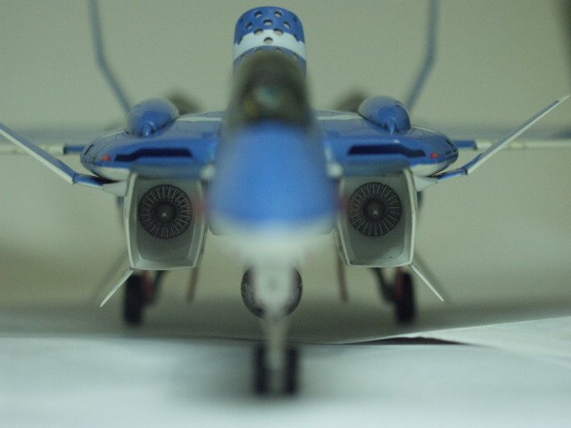

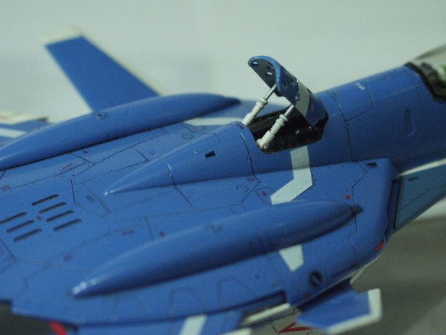

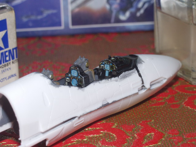

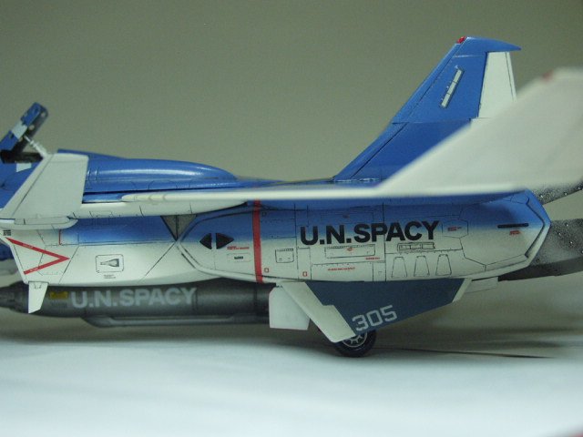

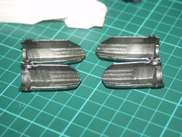

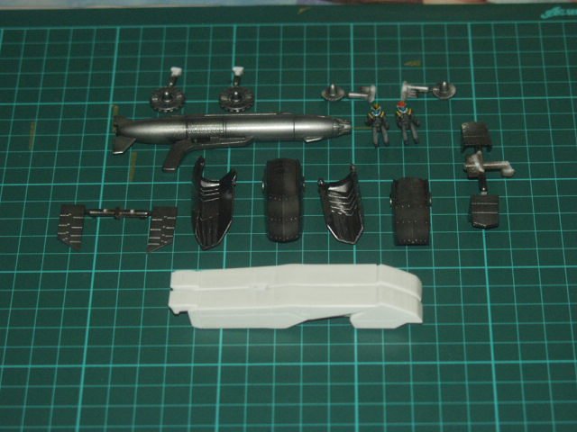

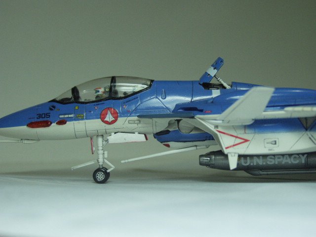

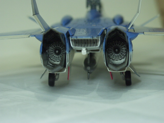

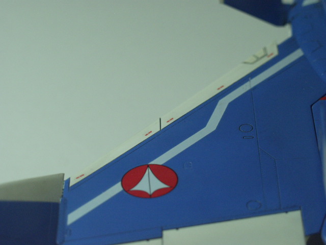

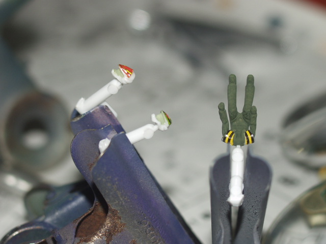

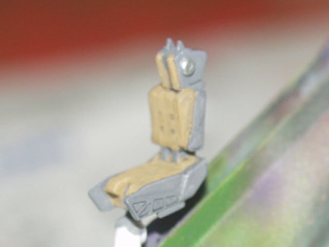

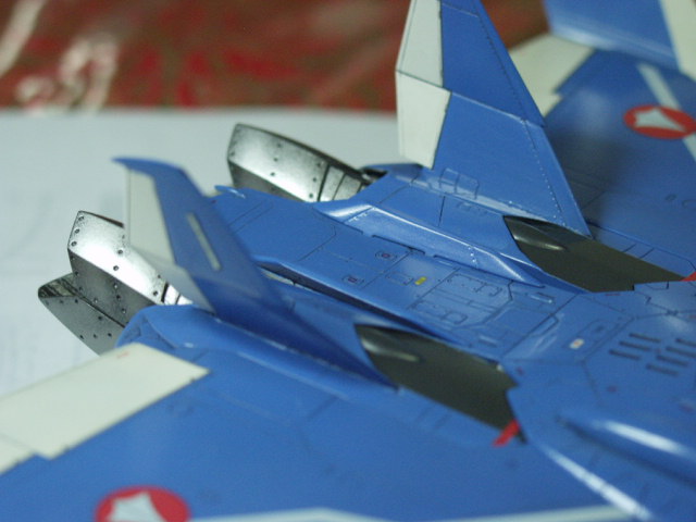

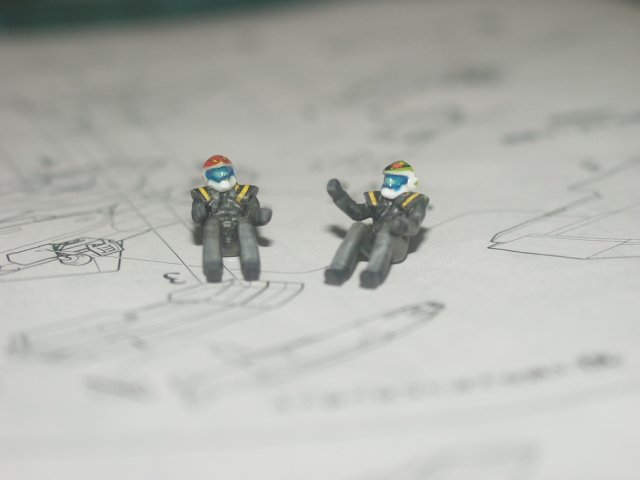

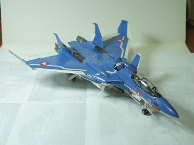

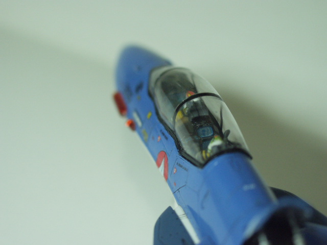

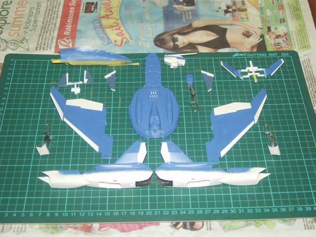

nickster Posted June 25, 2009 Share Posted June 25, 2009 Greetings! This is my first time here and here is my contribution for the forums. 1/72 Hasgawa VF-0D from the Macross Zero series. Here is how I did it. Most of the interior details like the ejections seats, control panels pilot figures were handpainted. Added a small minus mold on the seats. The main parts were painted in combination of two shades of blue + white from GSI Creos for the blue part and aircraft white. Metallic parts were painted with steel and highlighted with silver+steel. Added 4 strips of styrene each on the inner part of the foot nozzles. Drilled holes on the airbrake and painted the insides with steel. Placed the decals with the help of microsol to conform on panel lines. Sprayed overall with gunze sangyo's semi-gloss clear. polished the whole plane with micromesh. The wash was made with black artist oils thinned with zippo lighter fluid. Wiped off excess with tissue paper. That's about it. Comments welcomed. Nickster Quote Link to comment Share on other sites More sharing options...

nickster Posted June 25, 2009 Author Share Posted June 25, 2009 You've made it seem so easy! Hello Regult, I made the whole thing in 3 months time last year. Its was not that easy, because its my first time to experiment with gunze steel and silver for highlights. My next project will be SV-51 Gamma with twin boosters and that will be posted on a day to day basis starting next month. Thanks for the comment and hope to hear from you again. Happy modeling! Nick Quote Link to comment Share on other sites More sharing options...

PetarB Posted June 29, 2009 Share Posted June 29, 2009 Beautiful work. Good to see you drilled out the holes in the airbrake too! Quote Link to comment Share on other sites More sharing options...
