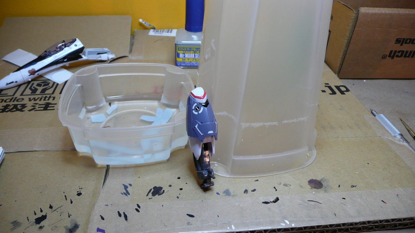

shinagami Posted November 5, 2009 Posted November 5, 2009 micky, i see u have some sort of thingy that closed the openings shown in ur last 2 pics, does that piece comes with the super pack kit? coz i cant find it anywhere in my super pack kit.... Quote
mickyg Posted November 5, 2009 Author Posted November 5, 2009 "Thingy" is exactly right! That's a custom part I made from .3mm plastic sheet. I sort of explained it about 2 pages back, 4th post from the bottom. That's if you've got your post count set the way mine is (for example, this is page 6 for me). Anyway, I think they add a nice bit of realism to an otherwise ugly hole. I cut them out roughly, then sanded them a bit to fit, scribed the lines to match the other two on the boosters and that was pretty much it. Oh, and I think I might have sanded them down a bit to make the piece a bit thinner. .3mm is thin but not quite thin enough. Hope that helps! And when we going to see some of your build pics? I, for one, can't wait to see how yours is coming! Quote

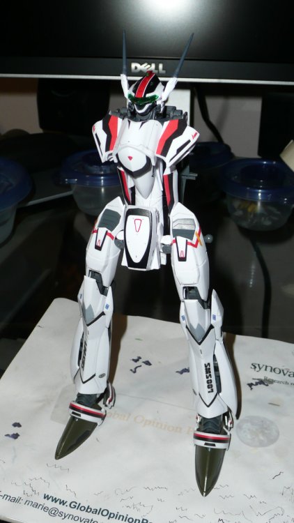

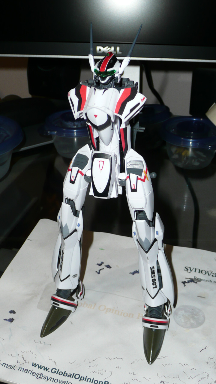

Darth Mingus Posted November 5, 2009 Posted November 5, 2009 I hate to mention this but the VF-25G should be SMS003 not SMS007. Otherwise, it is looking good. Quote
mickyg Posted November 5, 2009 Author Posted November 5, 2009 CRAP! ...And well spotted! This is what happens when you blindly follow the picture instructions on the back of the super parts manual. I got lulled into a false sense of security, thinking these were for my model, not all 4 variants. I'll be carefully removing the 7 decals today and putting the 3 ones on. Wish me luck! Quote

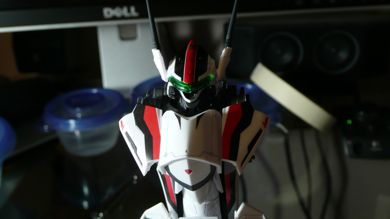

mickyg Posted November 5, 2009 Author Posted November 5, 2009 (edited) I must admit, the news that I'd screwed up the SMS numbers kinda but a dampener on things... But I did manage to get a lot done last night and wanted to post up what I did. I've got a couple of gotchas, for anyone following along and getting ideas. The decals on the super parts, are for the most part, easy to apply and straightforward. There are a few exceptions, of course! The thigh/bottom of the intakes, for instance. These are very irregular shaped parts and asking a decal to conform over them, is a very tall order. I tried quite a few methods, like trimming off all the carrier film to get it to fit snugly into the space, liberally applying mr mark setter, then softer over the trouble spots. In the end, it only made a terrible area almost acceptable. I'll show you what I mean with a few pics farther down. There were a couple of minor alignment problems with some of the small or really long decals but other than than, I'm happy with how it's going so far. I should get a few more parts done today and with any luck, the majority of the super parts will be ready for a wash this weekend. I'm not going to jinx myself by making predictions though! Lower intake parts prior to decaling, showing the irregular surface the black decal needs to stick too. Not shown is the "ledge" that the top makes over the black decal. This almost looks like a vent. The decal didn't make this any more realistic and I'm sure I'll need to fill in the areas not covered with black paint of some sort. Why'd I use a decal again? The next two are right after applying the decal and then the decal after it's been softened with Mr Mark Setter (Hadn't used the Softer at this stage of picture taking.). The next hurdle was getting the vernier decal to line up properly. Not only does it need to sit directly over the round detail, but it needs to be twisted in the right orientation to get the handle detail to line up! Needless to say, it was fiddly and a touch stressful. The pics here show the decals still wet. This morning the black had sunk down pretty nicely. So that's two intake bottoms done! And one booster finished as well: Edited November 5, 2009 by mickyg Quote
Cowpeeler Posted November 6, 2009 Posted November 6, 2009 (edited) I must admit, the news that I'd screwed up the SMS numbers kinda but a dampener on things... But I did manage to get a lot done last night and wanted to post up what I did. I've got a couple of gotchas, for anyone following along and getting ideas. The decals on the super parts, are for the most part, easy to apply and straightforward. There are a few exceptions, of course! The thigh/bottom of the intakes, for instance. These are very irregular shaped parts and asking a decal to conform over them, is a very tall order. I tried quite a few methods, like trimming off all the carrier film to get it to fit snugly into the space, liberally applying mr mark setter, then softer over the trouble spots. In the end, it only made a terrible area almost acceptable. I'll show you what I mean with a few pics farther down. There were a couple of minor alignment problems with some of the small or really long decals but other than than, I'm happy with how it's going so far. I should get a few more parts done today and with any luck, the majority of the super parts will be ready for a wash this weekend. I'm not going to jinx myself by making predictions though! Lower intake parts prior to decaling, showing the irregular surface the black decal needs to stick too. Not shown is the "ledge" that the top makes over the black decal. This almost looks like a vent. The decal didn't make this any more realistic and I'm sure I'll need to fill in the areas not covered with black paint of some sort. Why'd I use a decal again? The next two are right after applying the decal and then the decal after it's been softened with Mr Mark Setter (Hadn't used the Softer at this stage of picture taking.). The next hurdle was getting the vernier decal to line up properly. Not only does it need to sit directly over the round detail, but it needs to be twisted in the right orientation to get the handle detail to line up! Needless to say, it was fiddly and a touch stressful. The pics here show the decals still wet. This morning the black had sunk down pretty nicely. So that's two intake bottoms done! And one booster finished as well: I had the same problem with my super pack Alto and I ended up throwing the decal out and painting it. That oddly shaped triangle intake...that decal was so off. Edited November 6, 2009 by Cowpeeler Quote
