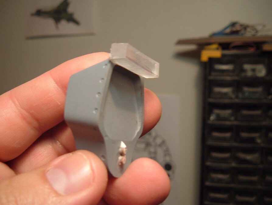

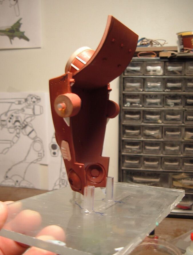

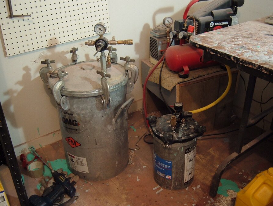

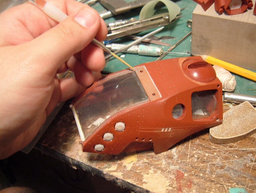

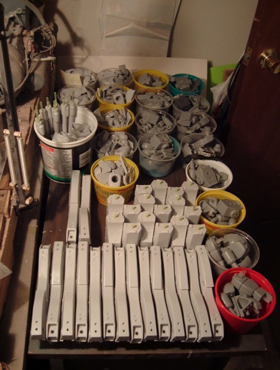

captain america Posted August 19, 2009 Author Posted August 19, 2009 Today's update: Prelude To A Finale!! As usual, I've been up to my armpits with molding and casting, and today, I will touch on some of the more noteable points of the mold-making process. Disclaimer: the techniques I use are those that I've developed to work with my own style & habits for my own particular needs; these techniques may or may not be optimal for everyone. Anyhoo, on to the good stuff... Pic 1: the first thing that needs to be done is the attachment of vents and gates to all parts. This is a very time-consuming step, as it requires lots of careful studying of the part, and gate placement is critical, lest ye be happy with half-cast or improperly cast parts. I like to use hot glue to attach the gates, since they can be easily removed while doing little damage to the master. Pic 2: depending on the shape and geometry of a given part, it's sometimes necessary to fill-in or cover certain openings to ensure a succesful molding and casting. I like to use a bit of diluted white glue to seal-up little cracks and gaps, the kind you get when you glue two parts together. Otherwise, the mold rubber will leak into the gap and rip your master apart upon demold. Not fun. Pic 3: Once all the sprues & vents are attached, the master is placed upside down on a hard, flat surface and glued with hot glue. Depending on the complexity of the shape, you may want to make some markings to guide you when you slice the mold open later. Pic 4: Once the part is securely fastened to a base, I construct a mold box to go around it: my material of choice is plexiglass, which I glue with CA at the corners. Once the box is done and secured to the base with hot glue, it's just a matter of pouring the rubber. Pic 5: these are my two pressure chambers, that are used not only for casting, but the small unit also does double-duty as a vacuum chamber. Pic 6: once molds have been opened, masters removed and allowed to dry out, actual casting can begin... This is what I've done in about a week, and this is just the beginning! Quote
