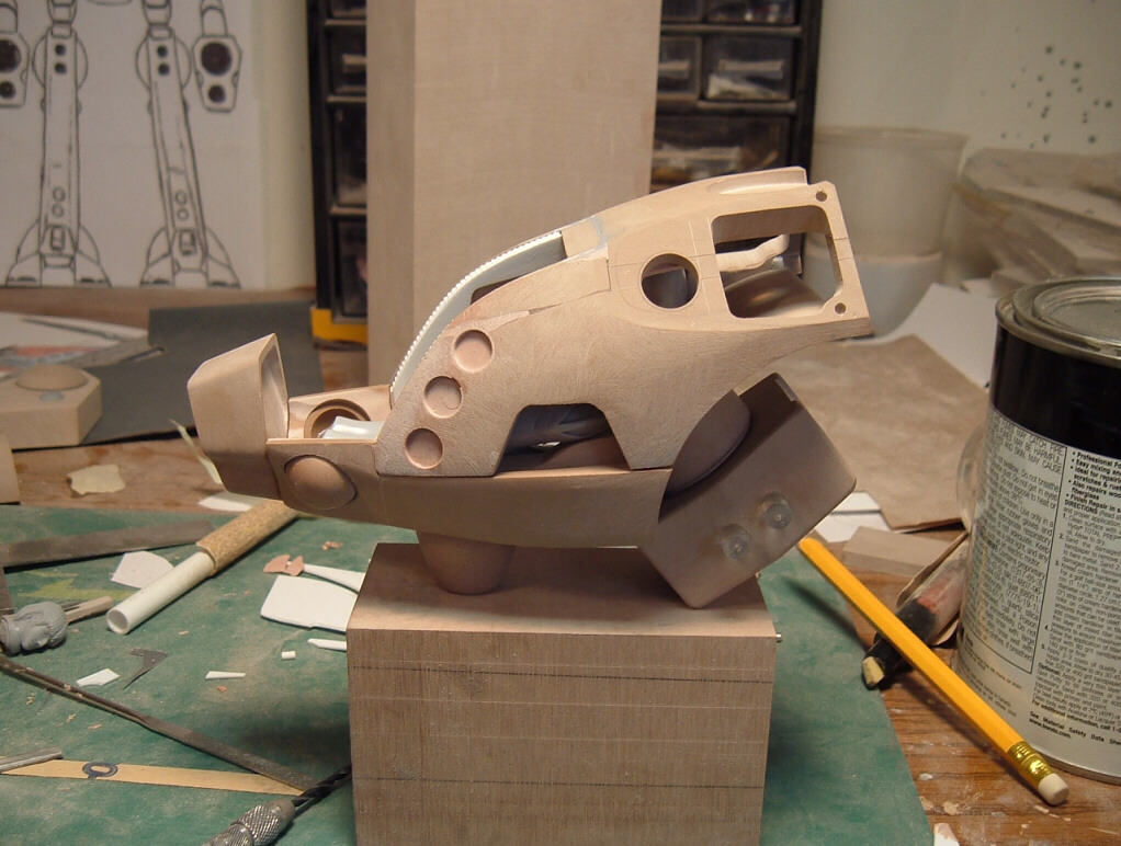

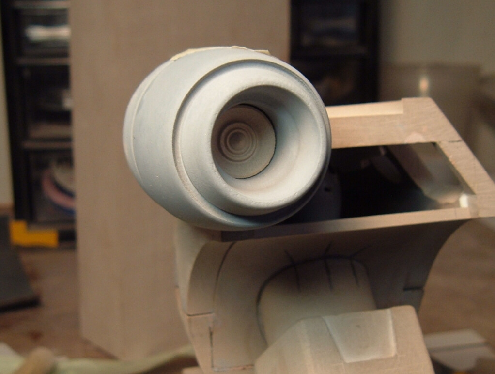

Pic 1: the main pod has undergone some substantial refinement since the last update. It now has a semi-finished inner hull lining, and I have strategically hollowed-out key sections to save weight.

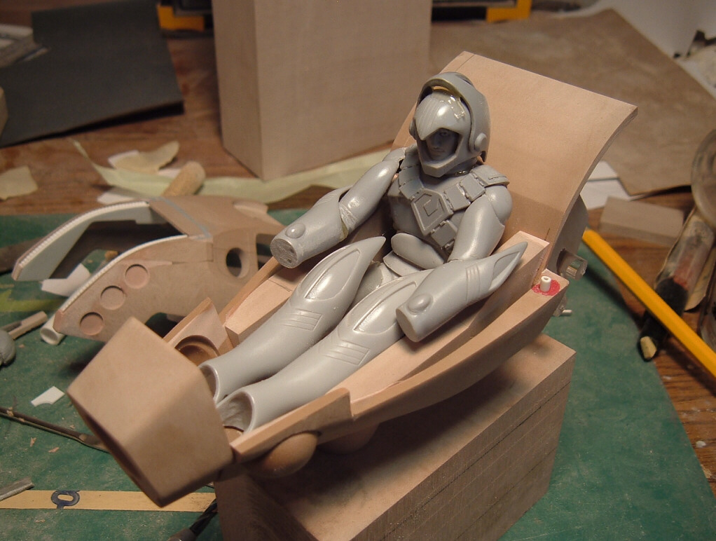

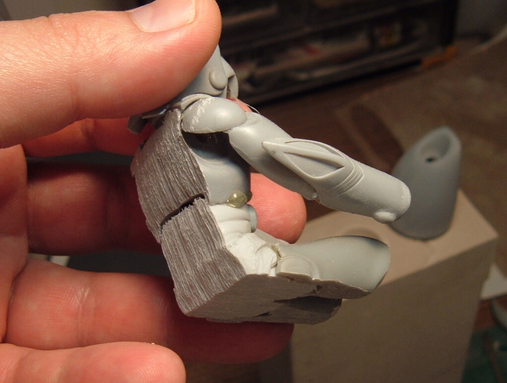

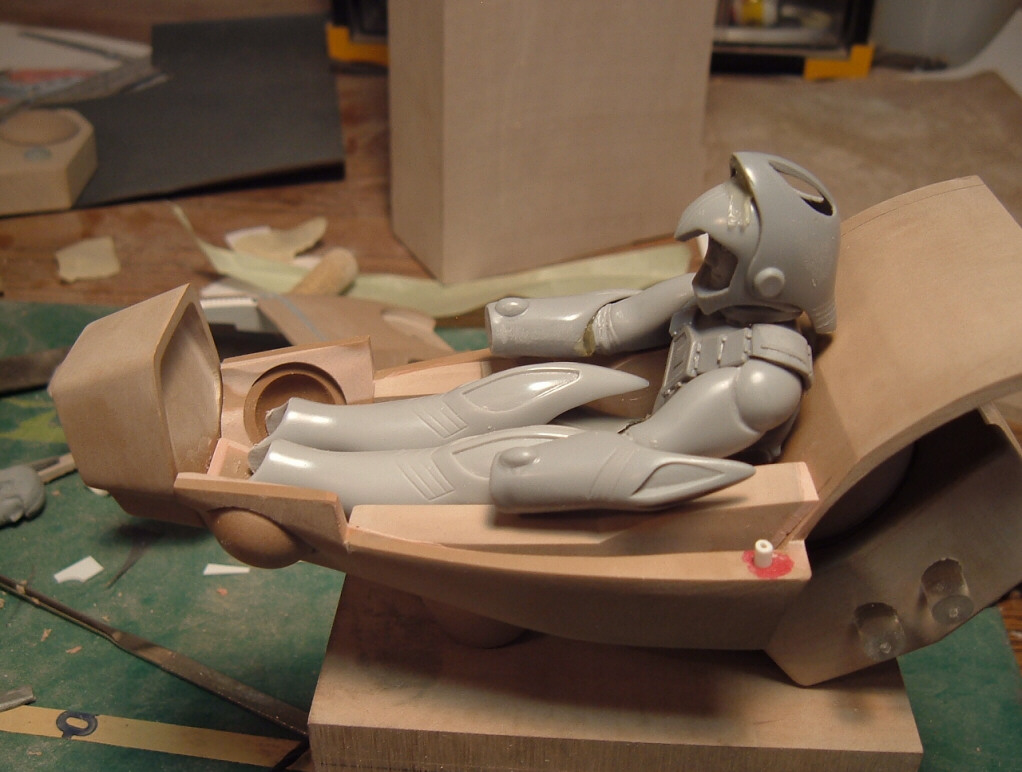

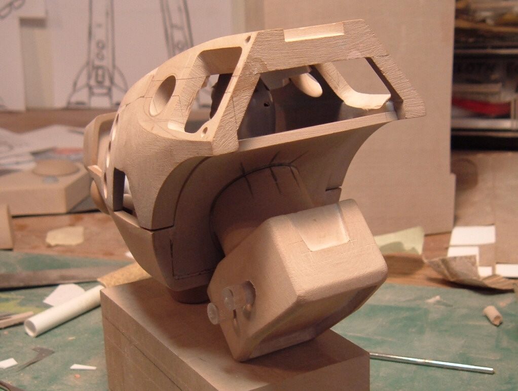

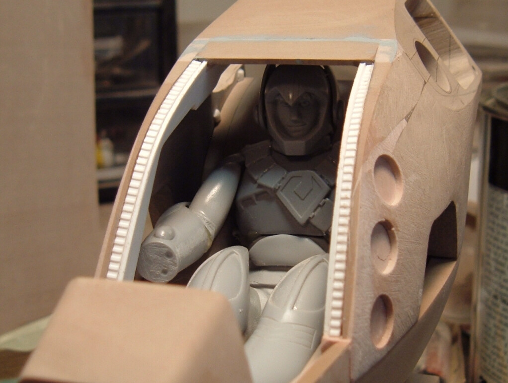

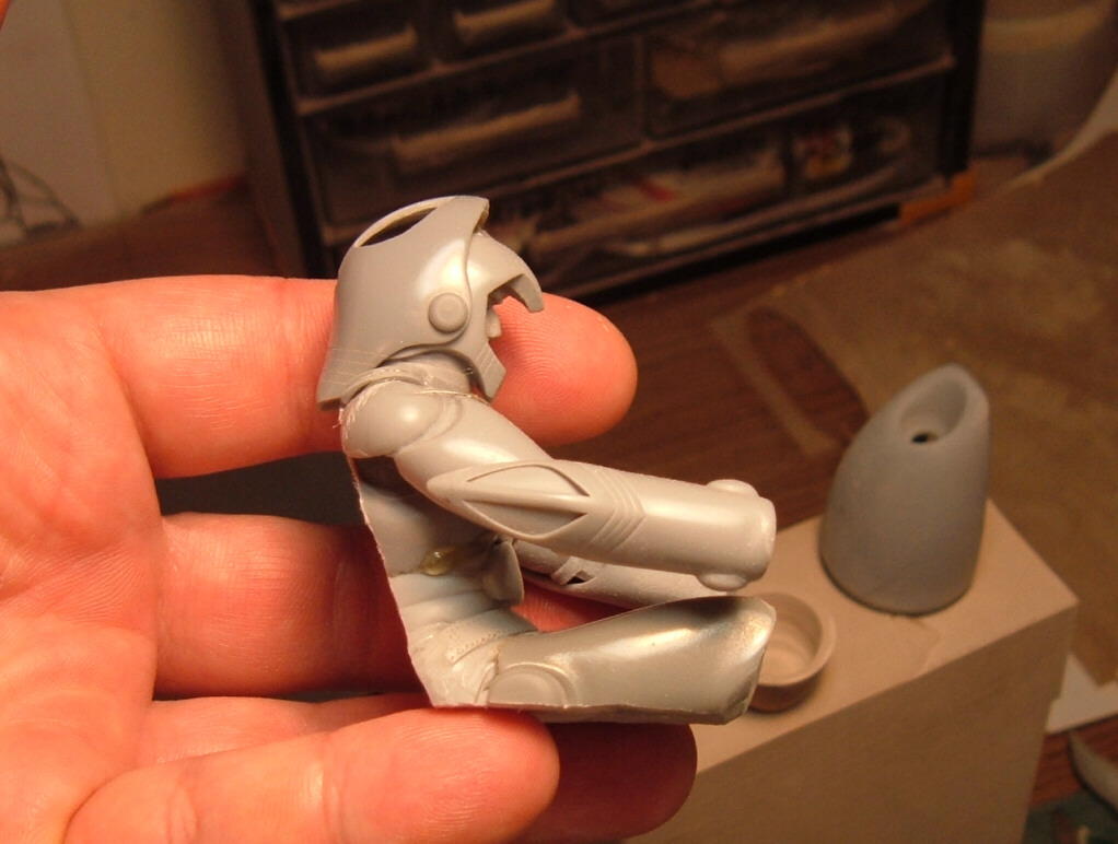

Pics 2 and 3: once thew basics of the inner hull were set, I was able to start test-fitting the Quamzin figure and make the appropriate alterations.

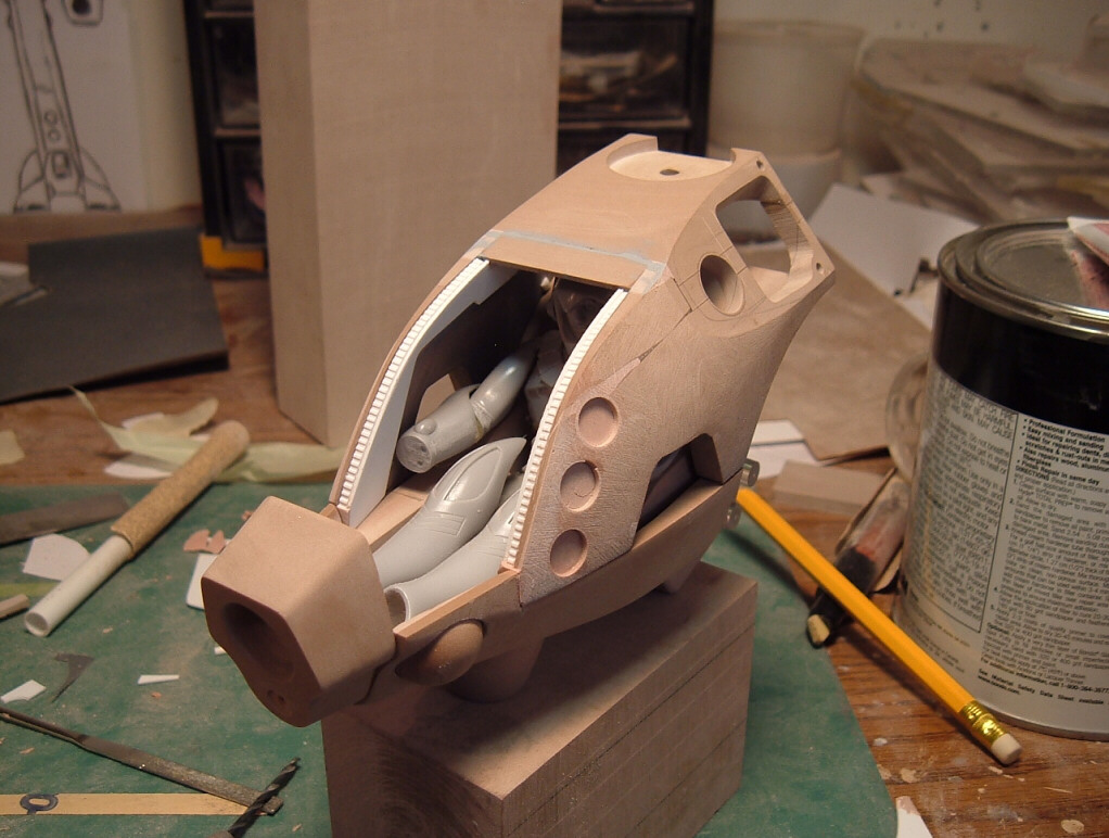

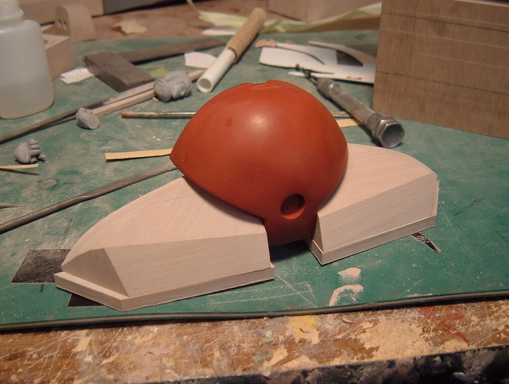

Pic 4: The pod seen from the back. Notice the crotch part: you'll see the acrylic rods that I've opted to use as structural inserts: being plastic in nature, these will bond more effectively with the resin and allow for an exceptionally-sturdy model.

Pics 5 and 6: A clearer view of Quamzin, being fitted for his "office." Missing hands and feet aside, notice anything unusual in these pics?
Pic 7: More test-fitting. The cockpit hatch will need some custom-fitting to acheive a proper seal.

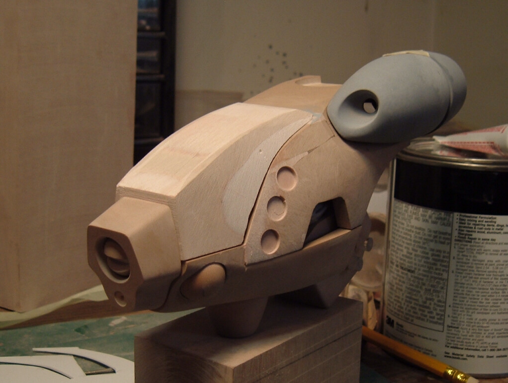

Pic 8: Aft view of the Royquommi reactor's basic nozzle; it will receive considerably more detail later.

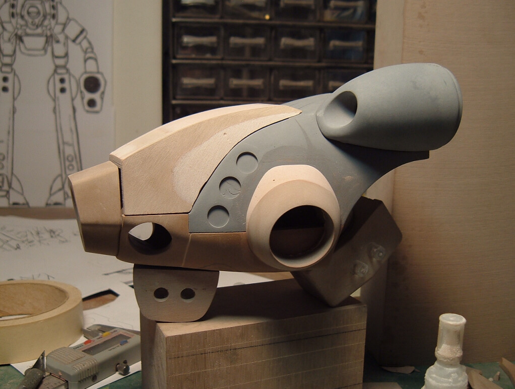

Pic 9: Remember the ball-part of the foo from previous updates? It has since undergone much refining. The cantilever-style design will allow it to be partially hollowed-out and still maintain its strength.
Pic 10: The basic foot parts. This is one area where the style-sheet diagrams didn't line up, so I'll need to do a lot of puttying to reshape the toes.

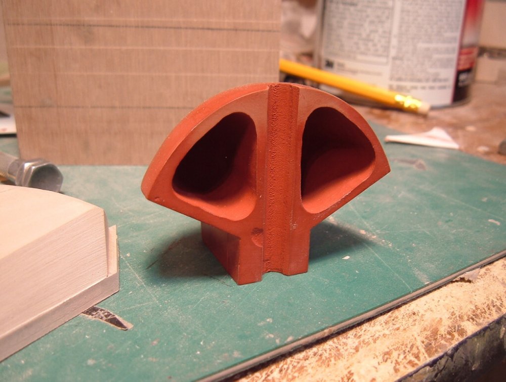

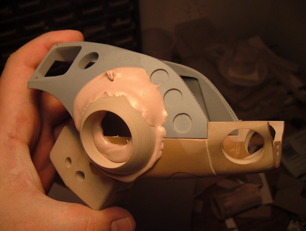

Pic 11: Speaking of putty, here it is at work! An aerosol mold release was applied to the hull parts, and then Bondo was slapped-on rather generously and then I smushed the shoulder armor into place and let it harden. It may look like a mess now, but with a bit of carving and sanding...
It looks like what you see in pic 12.
Thanks for the update.
What are we supposed to be noticing?
The only thing that looks a little odd to me is that in the cockpit shots, Quamzin's knees seem to be where his hips would be located.
Interesting answer, but that's not quite it. In fact, the way his boots are designed, the knee-guard rides very high up the thigh. The knees are actually where they should be.
Look at the pics carefully. Tell me if anything looks odd. If no one gets it, I'll divulge the answer later.
He's missing his groin armor, and belly armor and whole lower torso/lap are different. He's also missing the inner shoulder portions of his upper arm parts.

Hey, Captain, I'm trying to follow some of your construction techniques - you mentioned you put on spray release before the bondo... is this so the whole bondo area could 'release' off the surface easily for dissassembly?
Correct. You also have to time the removal of the bondo very carefully. If you pull it up too quickly, it won't have hardened enough and will break-up. If you wait too long, mold release or not, it will bite into the surface and get stuck.
Oh, as for the deal with the Quamzin cockpit pics, here's the bitty: I had to resort to some "anime magic" to get him to fit in the tub... By grinding-off most of his back, butt and thighs! No one noticed the foreshortening, even with the top off, leading me to conclude that my little forced-perspective project was successful ^_^
LOL, I was going to say that the unusual thinng was that there is a complete full body pilot in there, instead of the customary "halfie" amputee that most models get. I guess that would have been an incorrect observation :p
