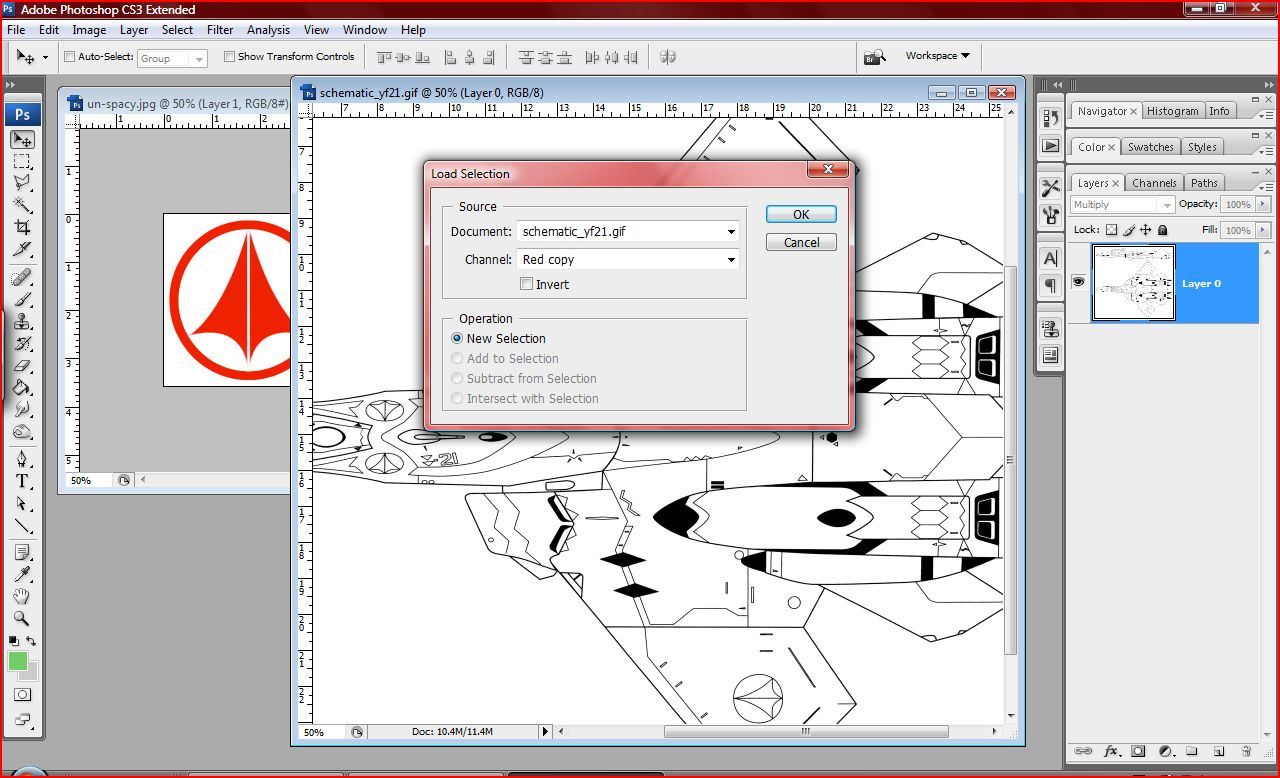

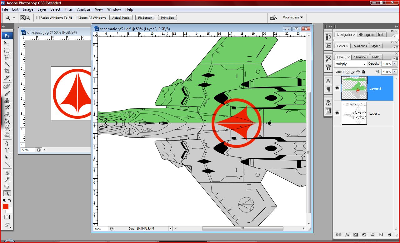

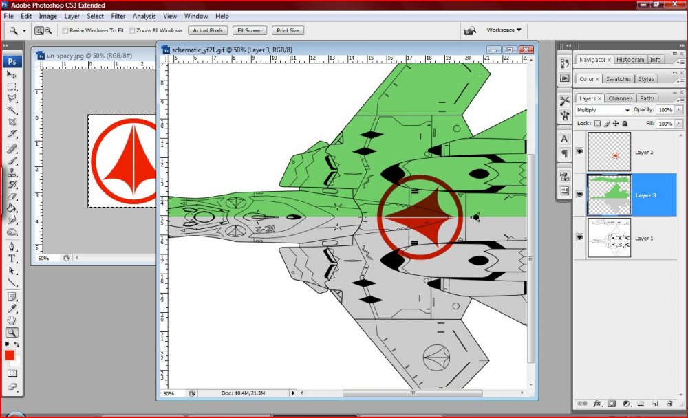

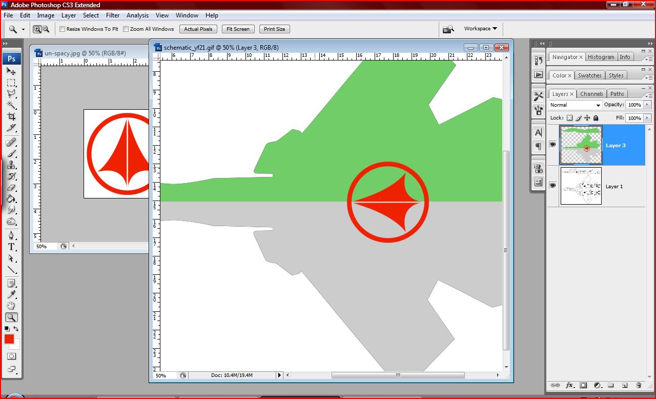

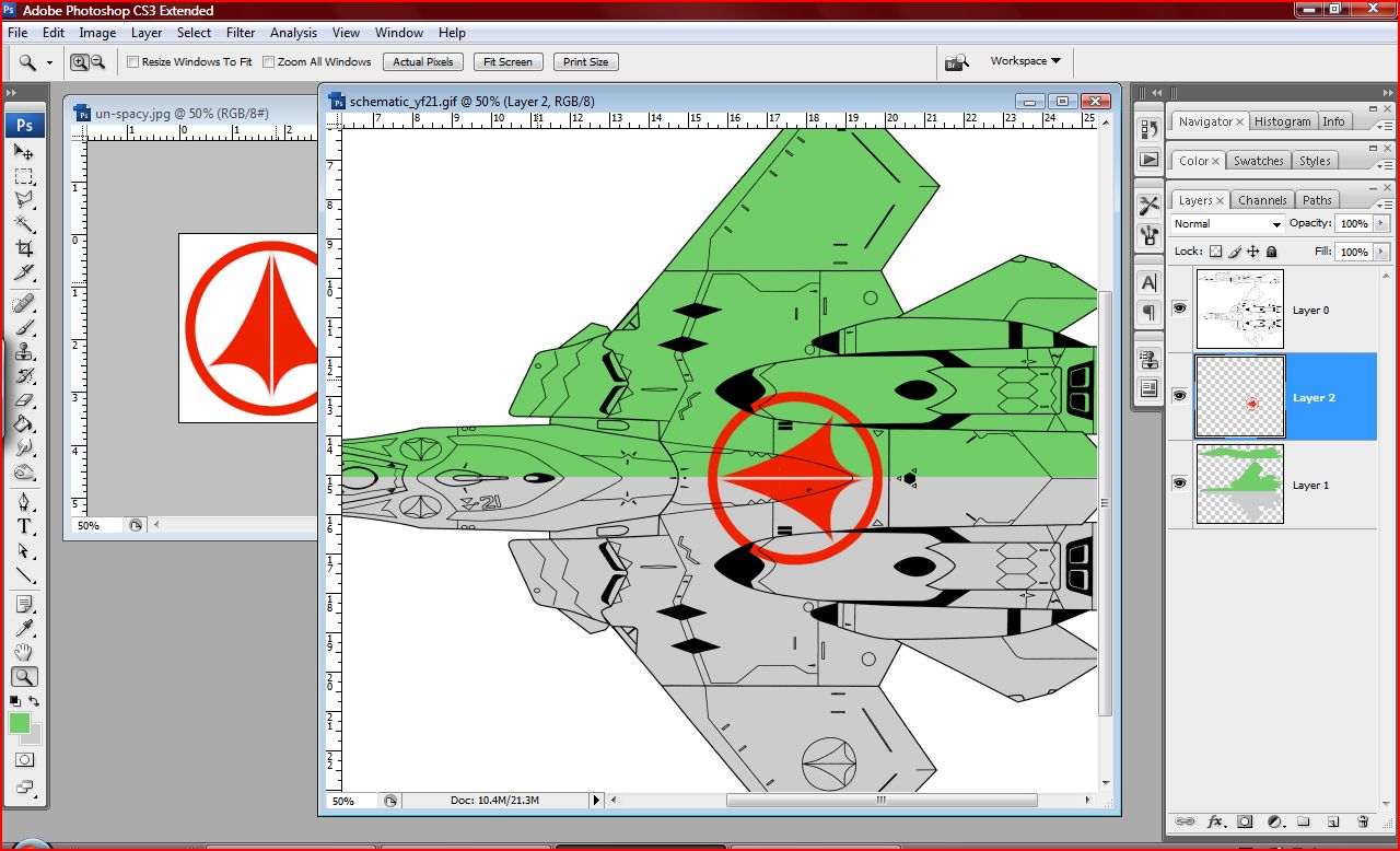

anime52k8 Posted May 26, 2009 Posted May 26, 2009 I got a quick question pertaining to Photoshop... How do you overlay panel lines over objects like the UN Spacy logo, the insignias on the tailfins, etc. I've tried layering in various ways, but I can't seem to achieve the desired effect. If it helps, I'm using Photoshop CS-4 Extended. I'm not a professional Photoshopper by any means, so any tips you guys could give me would be appreciated. My Diamondback Leader has all of its logos sort of "floating" above the surface panels of the Valkyrie... there are a couple of ways. I'm just going to go ahead and assume that you have the line art as part of the background layer. one way is to do the markings on a seperate layer and then set the layer to multiply: you can also use the same technique to color over the line art, but there's one problem. if you put a layer set on multiply over another layer with color, it will mess with the color on the multiply layer. a color set to multiply over white doesn't change and a color over black becomes black, any other color or shade and it will become a mix of the two. one way around this is that you can make both the color and marking layers separately then, with them both in normal mode, merge them into one layer: then you set the new merged layer to multiply now the only problem is that you can't go back and edit the color and marking layers once they're merged, so you need to be sure to keep a separate file where the layers aren't merged that you can re edit later, and don't merge the layers til you are 100% done making the markings and color you want. ok, so that's option 1, option 2 is in the next post.

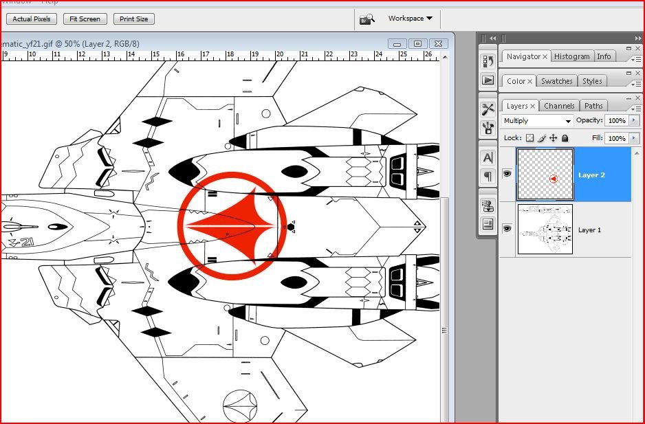

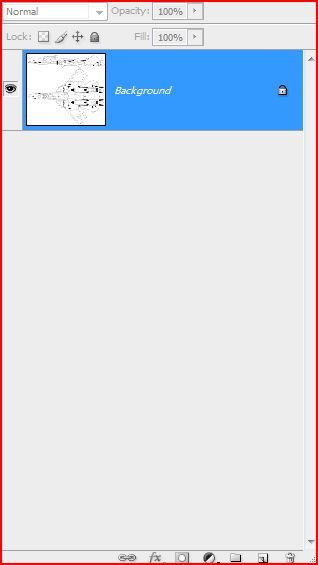

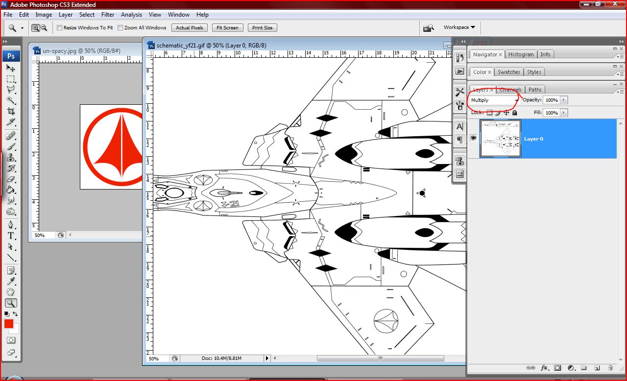

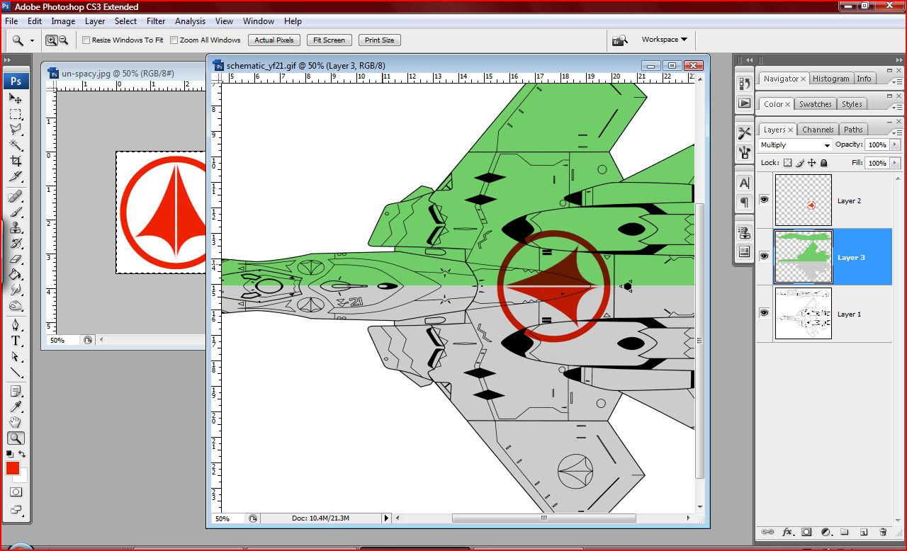

anime52k8 Posted May 26, 2009 Posted May 26, 2009 option 2: this one is what talos suggested in photoshop. first your going to need to make sure that the line art is on a layer and not the background. you can tell if it's the background because it will say "background" in italics and have a little grey lock oposite the preview image. if it is the background, convert it to a layer by right clicking on the layer and select "layer from background..." form the top of the pull down menu. then you use that same pull down menu from before to make the layer a multiply layer. (I remembered to highlight the pull down menu this time) then you can stack all your color and marking layers below your line art. next up is option 3...

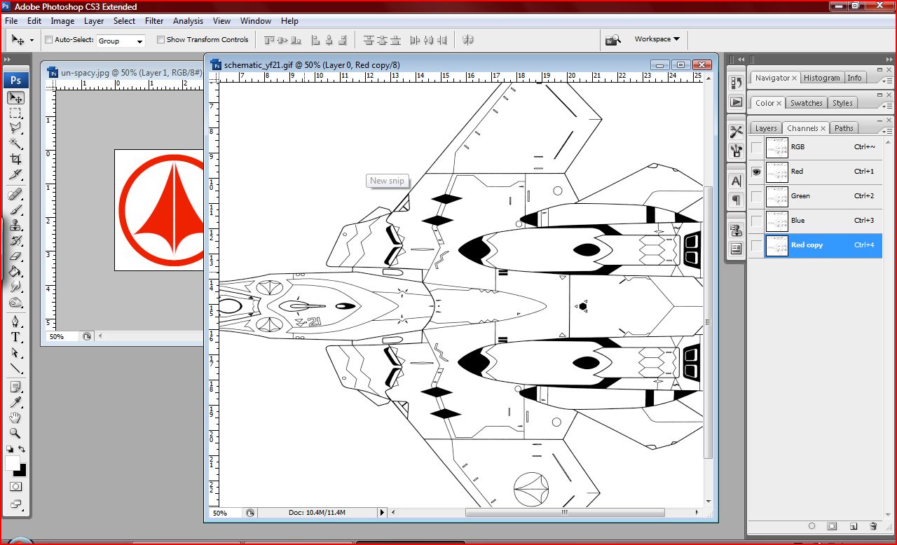

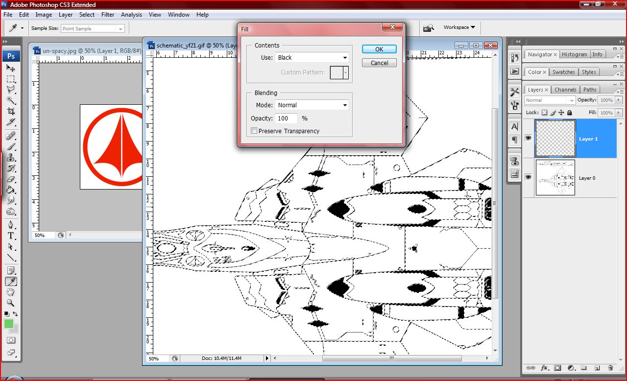

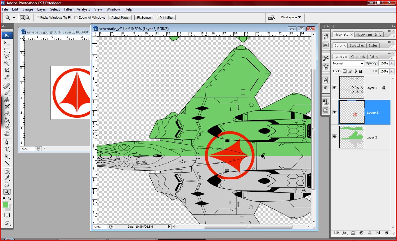

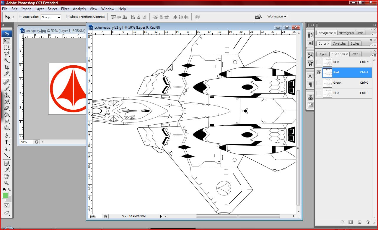

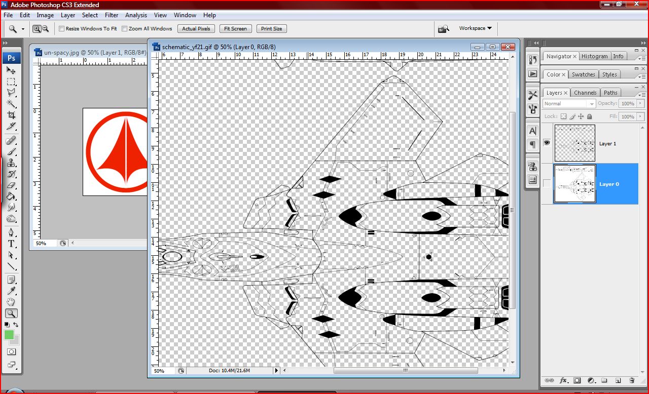

anime52k8 Posted May 26, 2009 Posted May 26, 2009 and finally this is how I do it personally. this is kind of like how Talos does it, but instead of using a multiply line art, I prefer to have the line art on a transparent layer. ok, so what you do is go into the channels pallet (tab next to the layers pallet) and select one (I usually just use the red channel on B&W line art) then right click the channel and duplicate it now you go up to the select pull down menu. and click on the load selection option form the bottom of the pull down menu and from the load selection menu create a new selection from the red layer copy. now invert the selection you just made (select>invert selection) and create a new layer. now on the new layer, fill the selection (shift+F5) with black now you can get rid of the old line art layer and you have a your line art with no white that you can stick over other layers while still in normal mode. then you do the color and markings same as always.

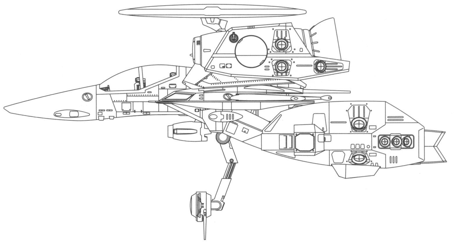

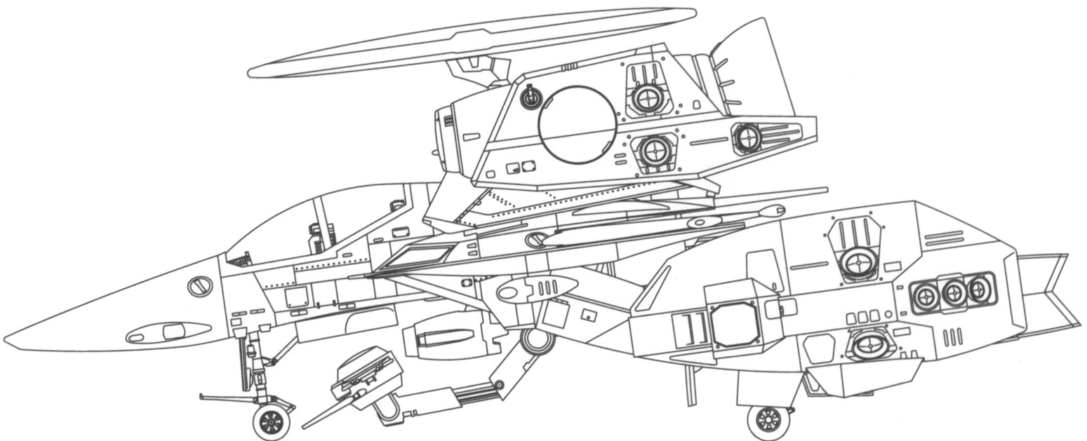

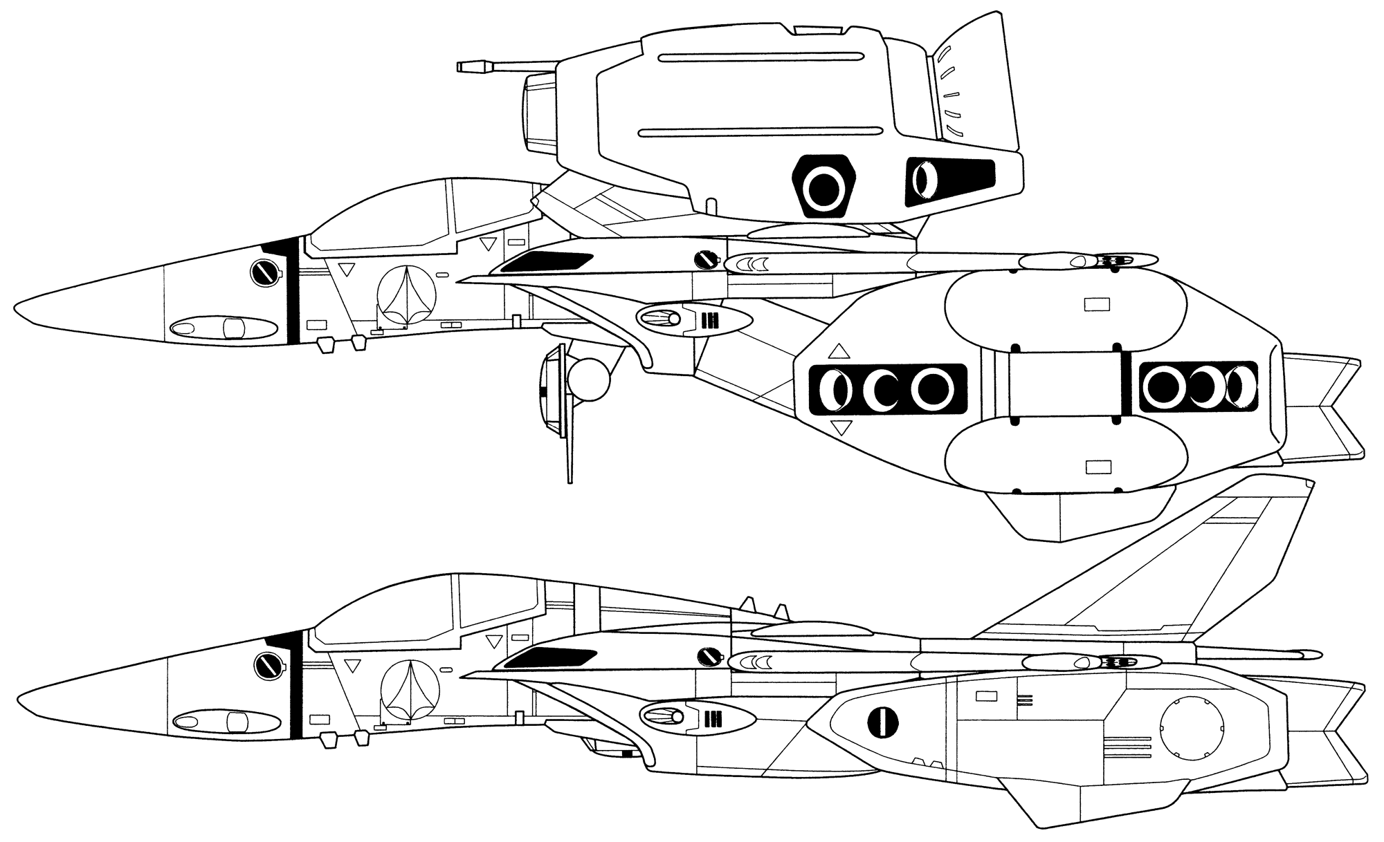

boinger Posted May 28, 2009 Posted May 28, 2009 VE-1 Elintseeker Line art for those who like to custom colour.
badboy00z Posted May 28, 2009 Posted May 28, 2009 Anyone want to try a few schemes on my original VF?? Lol. http://i2.photobucket.com/albums/y40/badbo...-X29lineart.png
Mr March Posted May 28, 2009 Posted May 28, 2009 The Strike Valkyire looks great Cyclone Trooper. Well done. Thanks so much for the schematics boinger. I was sure they existed

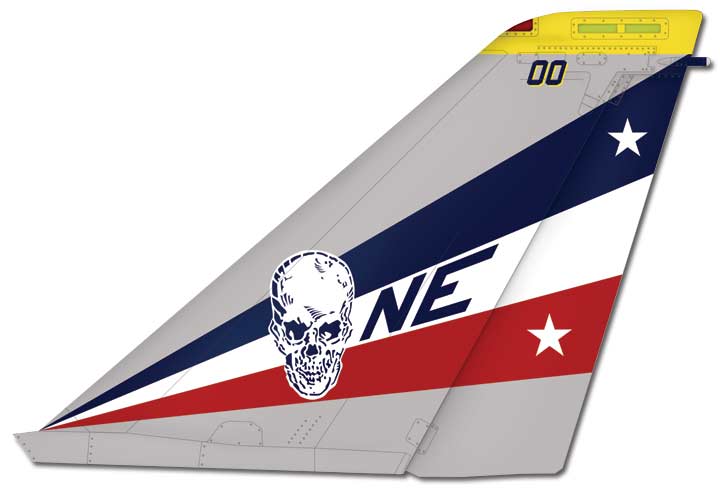

Talos Posted May 29, 2009 Posted May 29, 2009 SVF-96 will get upgraded eventually, along with the rest. Thanks, chillyche! And here's SVF-1A Wolfpack (designated as such, since SVF-1 is the Skulls).
505thAirborne Posted May 29, 2009 Posted May 29, 2009 Looks awesome Talos!! I'm telling ya, If Yamato were ever to make a VF-4 in 1/60, All of these Insignias & paint schemes look so awesome on this bird, it would be an amazing seller!!
