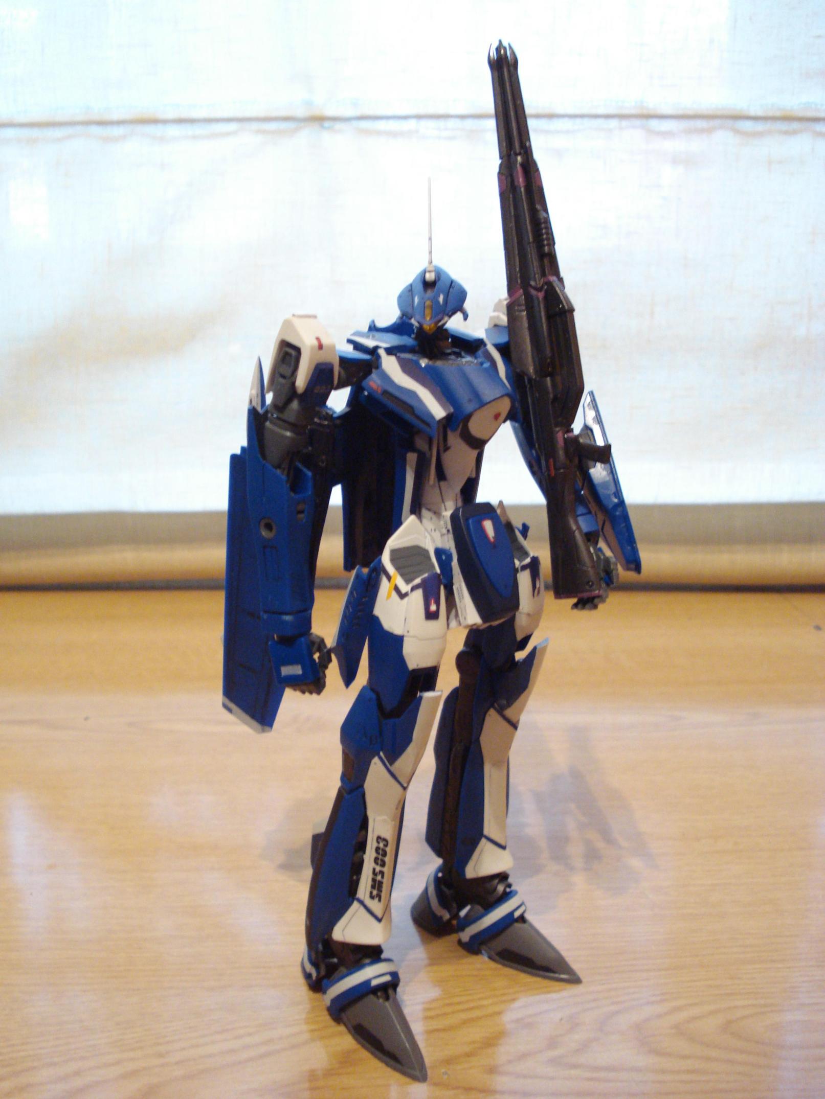

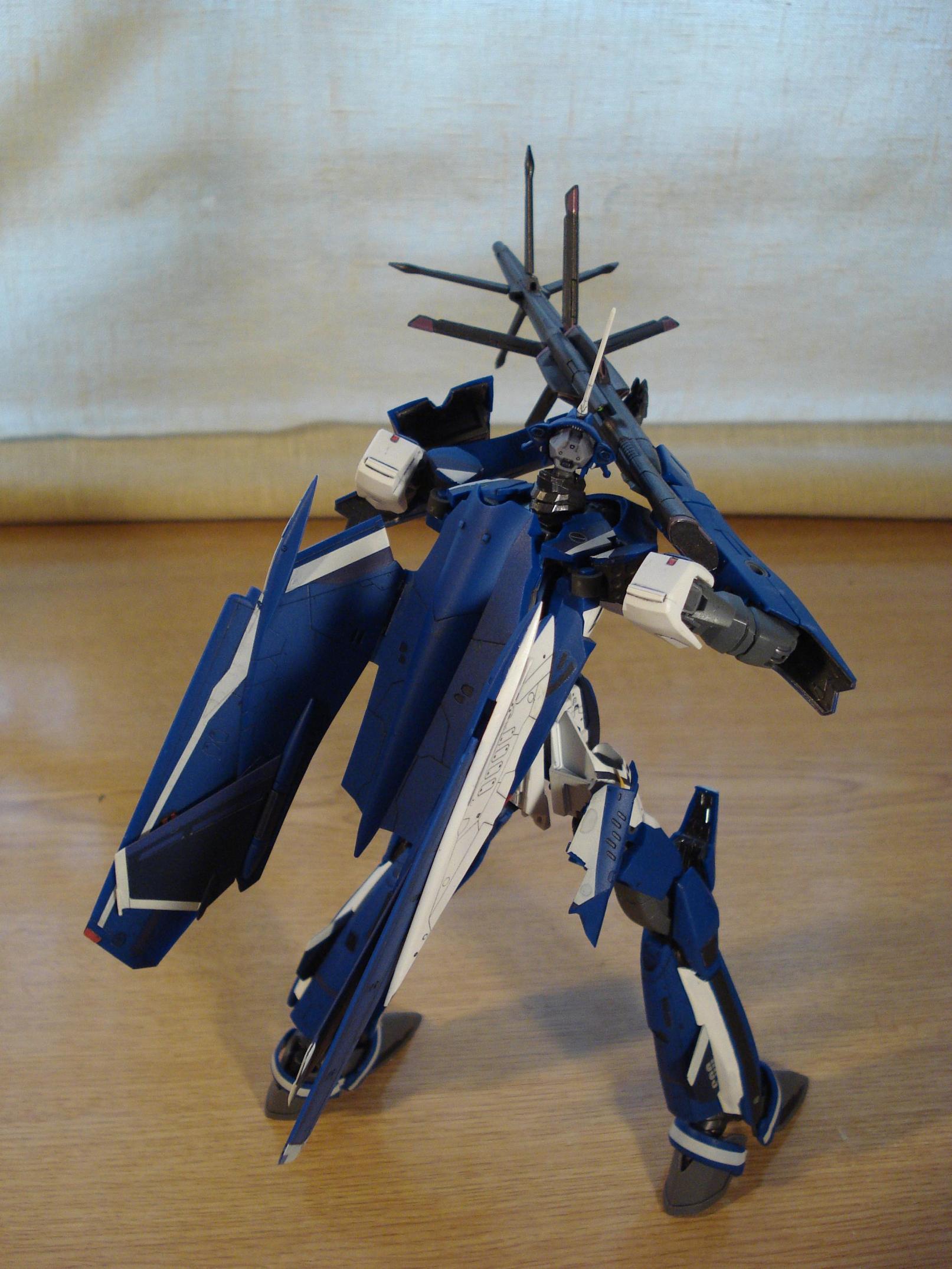

I did it on my 1/72 VF-25G and not encountered any problem.
I've managed to paint the knees, hip intakes and backlegs using Tamiya Surface Primer (White), then two clear coats:
