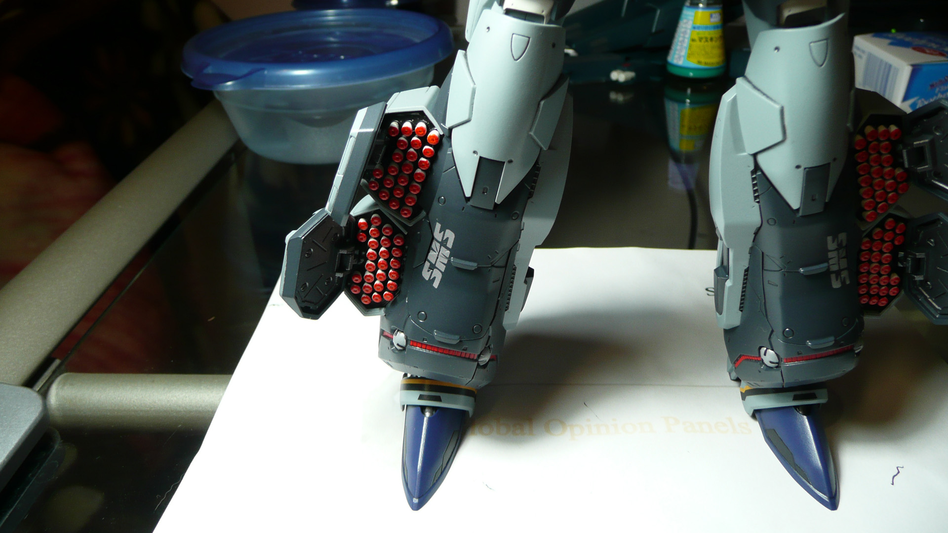

hi man!
i painted the whole missle block in dark iron,
then the missle tips (only) in white,
lastly i painted red dots on them
i like how they look this way, rather than painting the missle white with red tips :)
Did you do each one by hand... one at a time, or did you dunk just the red tips? How did you get the red tips so even all the way around?
Thanks - great work by the way!!
thanks man! a compliment coming from u is truly an honor :D
yeah i did them one by one
but honestly not all of them are even :p
these few days i was still doing some touching up on them
How did you paint all those little missles? :wacko:
I won't presume to speak for anyone else, but theoretically, you could create masks for the missiles by punching the appropriate diameter hole through some masking tape and spray the desired color (say, white.) In the case of a two-toned tip, I would use the same hole puncher(belt strap punchers are awesome!) and use that to punch little red circles from a solid red decal sheet and apply those to the tips. It's a bit of a long PITA, but the results will be crisp and uniform... Just an opinion.
Is dark iron the color you painted the whole armored pack with?
If so, I like it!!!
It gives the armored pack a more realistic look to it, unlike the dark grey....
Nice work! B))
thanks for the compliment Zinjo!
i used dark iron for only the missle blocks (the ones that have covers) and the wing gun turrets
the majority of armor pack and sniper rifle is in metallic black
Thats a good idea... belt strap puncher eh? Hmm wonder where I could get one of those.
I was thinking (purely a mental exercise at this point), but how to paint the bottom black, but have the missle bodies white (white tube all the way down to the bottom) and a red tip. I was thinking maybe spray the whole thing gloss white, then do a thin black heavy wash so the black sits/pools at the bottom (hopefully leaving the missle bodies white) then dunking the white tips into a small pan of red paint to get an even red tip at the top.
I did the heavy black wash method and it works well enough, though I was bit a sloppy about it and some of the wash got on the sides of the missiles. However it was acceptable to me since it just made the insides look kind of dirty.
The problem with simply dipping the missiles into some red paint is that half the missile racks are not flat, even rows. They're mutiple rows sitting at different heights. Check out the attached pic. The missiles look like they're in level, even rows, but they're not; they all sit at different heights. The innermost columns (closest to the leg) stick out the furthest. :wacko:
You could just take some brass tube and file a sharp edge on one end and use that as a punch. Also stack up the tape so that each punch gives you multiple masks.
I was thinking you could use some tubes as missile masks too.
I haven't tried this yet, but this was going to be my approach:
- spray the whole thing white with acrylic paint
- use black wash at the base as already mentioned
- come back with sponge dipped in windex or ammonia and wipe off the tips of the missiles, exposing the red plastic underneath
In theory, the missiles are the correct colour of red already so this might work. The problem would be getting the wiped area to be sharp between the white and the red. Not sure if this would work well but I'm willing to give it a shot!
