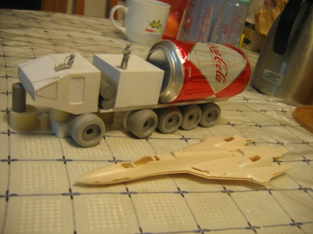

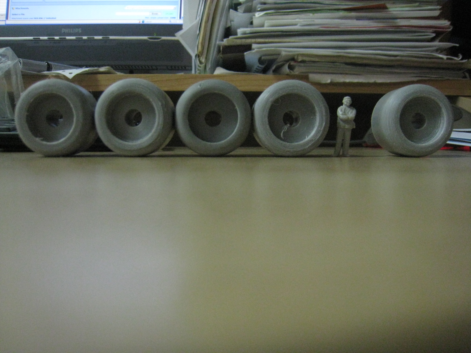

ahiachris Posted February 20, 2009 Author Posted February 20, 2009 Interesting project. That thing would be absolutely huge! I'd did all the calculations. Petar, what is the height of your pilots?? For the centipede I'm working on, an average height crew of 1.8 meter will be 25mm i height. For the truck to look consistence with the artwork, the truck will be approximately 250mm in length (18meters). It's indeed a hugh kit. Everyone are invited to give inputs. Quote
Kremmen Posted February 23, 2009 Posted February 23, 2009 I'd did all the calculations. Petar, what is the height of your pilots?? For the centipede I'm working on, an average height crew of 1.8 meter will be 25mm i height. For the truck to look consistence with the artwork, the truck will be approximately 250mm in length (18meters). It's indeed a hugh kit. Everyone are invited to give inputs. This would be a great project. Love the design. If a kit looked good I'd have one. Quote

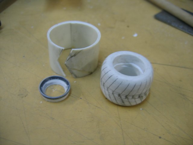

ahiachris Posted February 25, 2009 Author Posted February 25, 2009 (edited) What an awesome project to take on!! If there are plans to cast this, I'm in for at least two. No promises yet. Only managed to get the correct scale of the vehicle. I'd initially sculpted one wheel but eventually it the scale was not correct. I had to redo the wheel. Still don't know if I'll do it with cockpit or not. If the driver cab can be seen then I'll have to provide canopies. It'll be difficult to mass produce. The stairs and ladders and the catwalk will be another issue... Feel free to give your inputs Edited February 25, 2009 by ahiachris Quote
PetarB Posted February 25, 2009 Posted February 25, 2009 It doesn't matter how you approach it, it's a big job. Those wheels are a good indication of the size of the thing! Quote

ahiachris Posted February 26, 2009 Author Posted February 26, 2009 OK, thoughts: vacform the whole canopy in clear - struts can be painted on. Internal cabin area, wheels, machinery, suspension and chassis in resin. Ladder in brass rod - provide a bending template and the rod, with a cutting template and a sheet of thin styrene for the treads, or cast them in resin. Let buyers do the work, anything resincast that was thin enough to look good would break in transit anyway. Most of the load could be vacform I'd think. Thanks for the input. I think I'll do a solid prototype driver cab first. May be will try the vacuum canopy. As for all the other parts will mostly be resin. The ladder might be photo-etch and the stairs going to the driver cab will most likely be Plastruct. Even if a Vac form canopy be provided, the actual driver/crew will not be big because an airlock must be provided. The truck can be use under atmospheric pressure and without atmospheric pressure. I'd almost finished doing the tyres and I'm doing the driver cab right now. As for "let buyers do the work" no promises. My skill is not very good. Let all if they are going to get one and decide it when I finish the vehicle and start to mass produce it. Quote

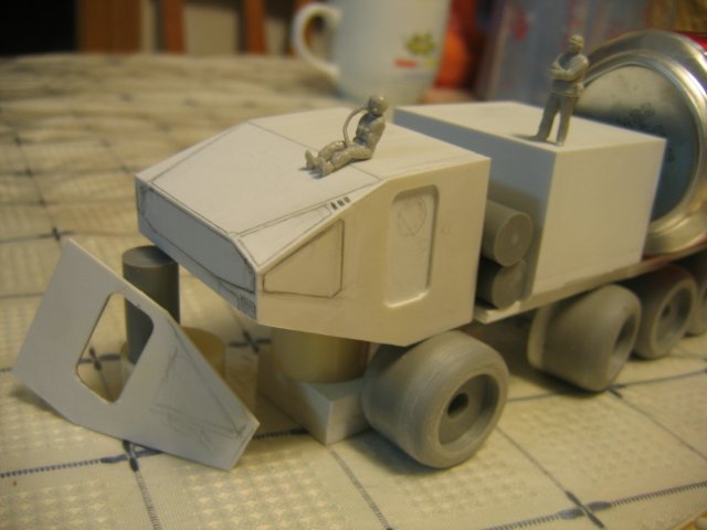

ahiachris Posted March 10, 2009 Author Posted March 10, 2009 Hi all, I'd been very busy working at the office. Since my son is still two years old so I can't do any work at home. Finally managed to get time building the driver cab. It's still very rough but I'll get there. I'll definitely be sculpting one or two tyre and send them to the caster. The size of the vehicle is really very very huge when compared with the valkyrie. I'll start some more detailing of the cab and will start on the chassis. Petar, I'd finally noticed that the pilots sculpted by Hasegawa for all most valkyrie were out of proportion. Don't forget to give comments and suggestion. I might be mass produced when it's finished.........Hope you all enjoy. Quote

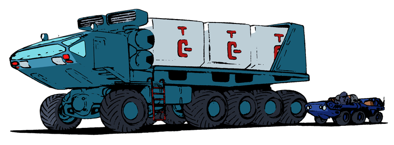

electric indigo Posted March 12, 2009 Posted March 12, 2009 Great work so far. I think the vertical dimension of the front plane ahould be reduced a bit, this should be more evident if you look at the b/w art of the vehicle. The colored version gives the impression of a larger vertical area while the lower half of the front lights are actually in the angeled lower area of the cabin. Quote
