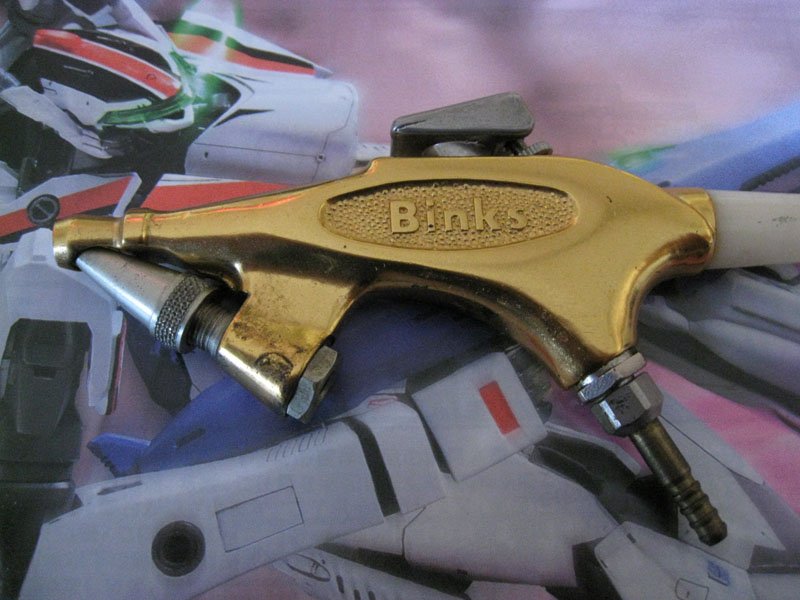

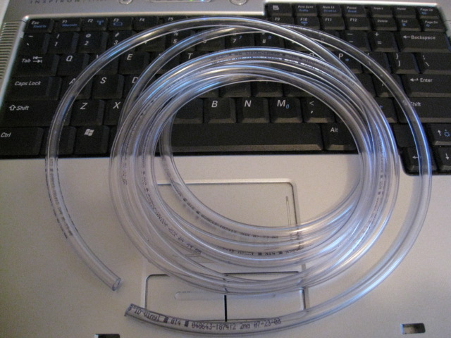

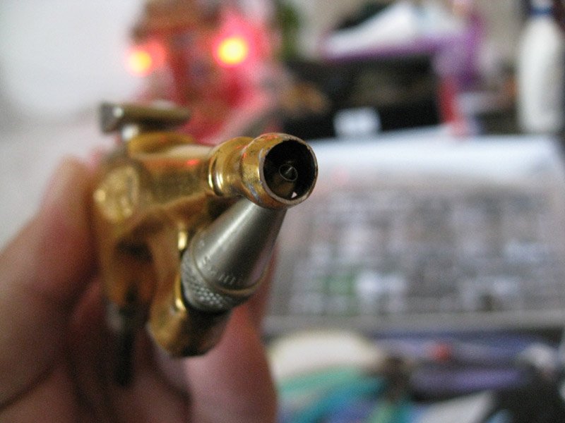

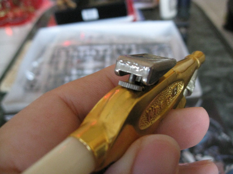

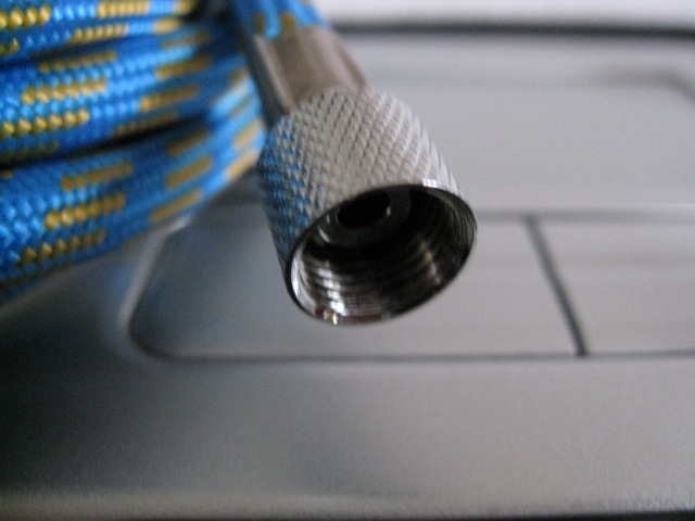

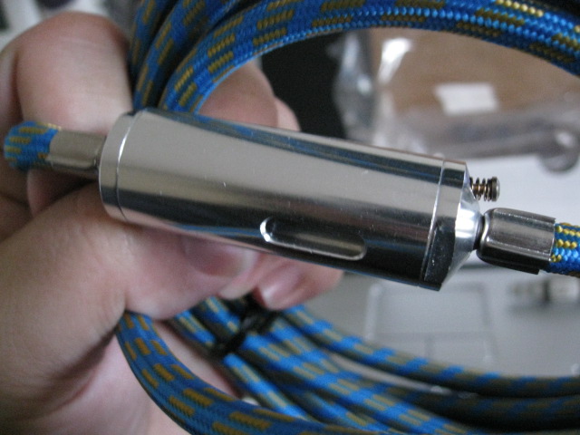

shiroikaze Posted January 15, 2009 Author Posted January 15, 2009 (edited) Bumping, I've heard alot of "you get what you pay for" when buying a compressor, does that apply for the moisture trap as well? Will any "decently priced" moisture trap work just as good as the more expensive traps? Is an inline trap works just as well as one attached directly to a compressor? Also, does anyone know what Tamiya Polishing Compound did WM Cheng use on his VF-0S's canopy? If I guess, it be "coarse", but I want to make sure. I also sent him a PM, but I guess he's kinda of busy lately. Sidenote: Nice to know that my local Lucky's stocks Future... Edited January 17, 2009 by shiroikaze Quote
shiroikaze Posted January 23, 2009 Author Posted January 23, 2009 (edited) So I found out what WM Cheng used, it was fine polishing compound. But anyway, I went ahead and bought the 1/8 hose with the inline moisture trap and two 1/8 quick disconnects... They don't fit! D: My airbrush doesn't have those connectors, found out the original connectors on my airbrush is actually meant for the clear vinyl tubing--I'll be sticking with this for now. Ugh, now I kinda wished my dad brought home the entire set... Sigh... So anyway, I'm just gonna forgo the water trap for now, I'll just monitor the tubing for any water coming up from the tank. Probably make my own at some point... Edited January 23, 2009 by shiroikaze Quote

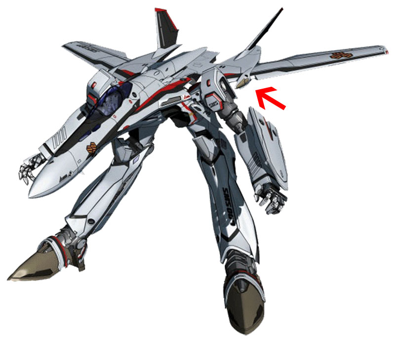

shiroikaze Posted January 31, 2009 Author Posted January 31, 2009 (edited) Curious, why does Tamiya regular cement come in a 20ml bottle whereas the extra-thin cement comes in a 40ml bottle? Also, what is that? Is it a light? A reflector? A warning color? Edited January 31, 2009 by shiroikaze Quote
edwin3060 Posted January 31, 2009 Posted January 31, 2009 No idea.. But the whole thing is a wing fence and it has thrusters on the top surface and some sort of attachment point (probably for the Super pods) on the bottom surface. Might be lights, or more sensors, or ECM equipment. Quote
shiroikaze Posted February 2, 2009 Author Posted February 2, 2009 I think I'll assume them to be sensors, thanks Edwin. Quote
edwin3060 Posted February 2, 2009 Posted February 2, 2009 You're welcome! I'm actually hoping that more information will come out in future Macross Chronicles...or a TIAS:MF (my dream!) Quote
