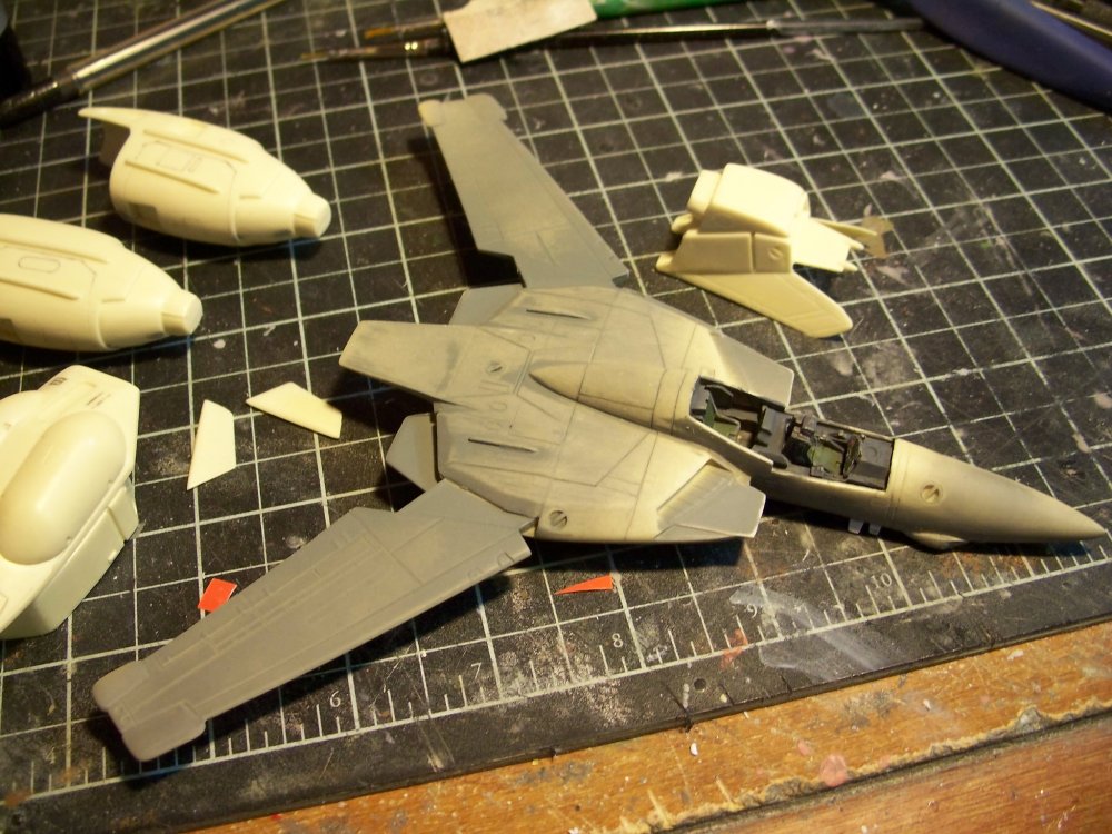

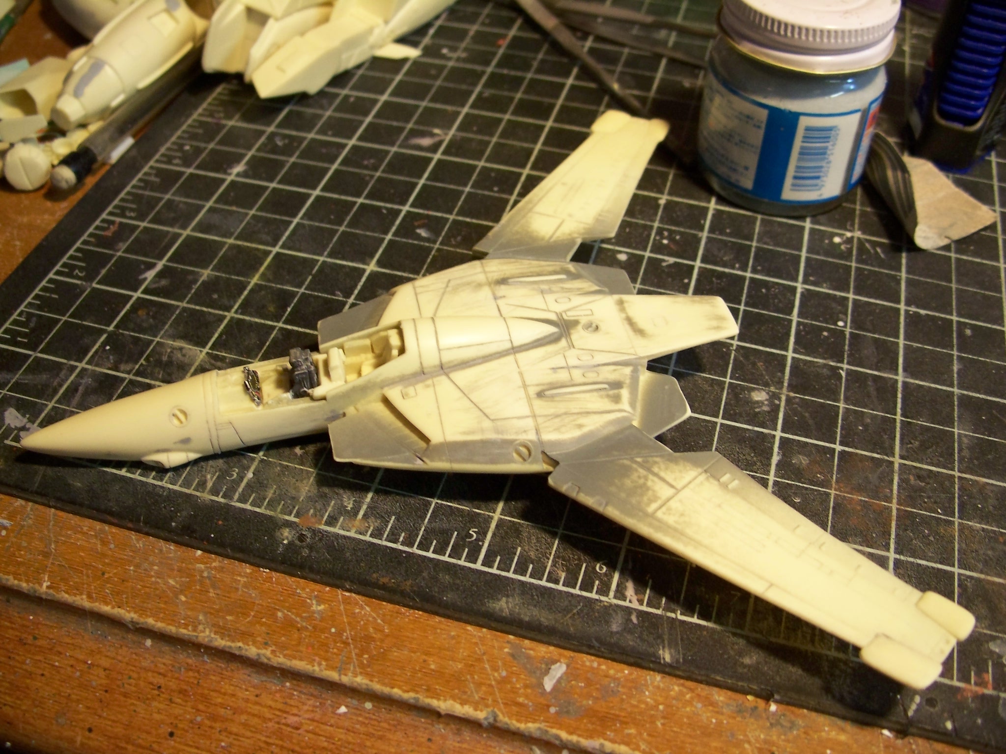

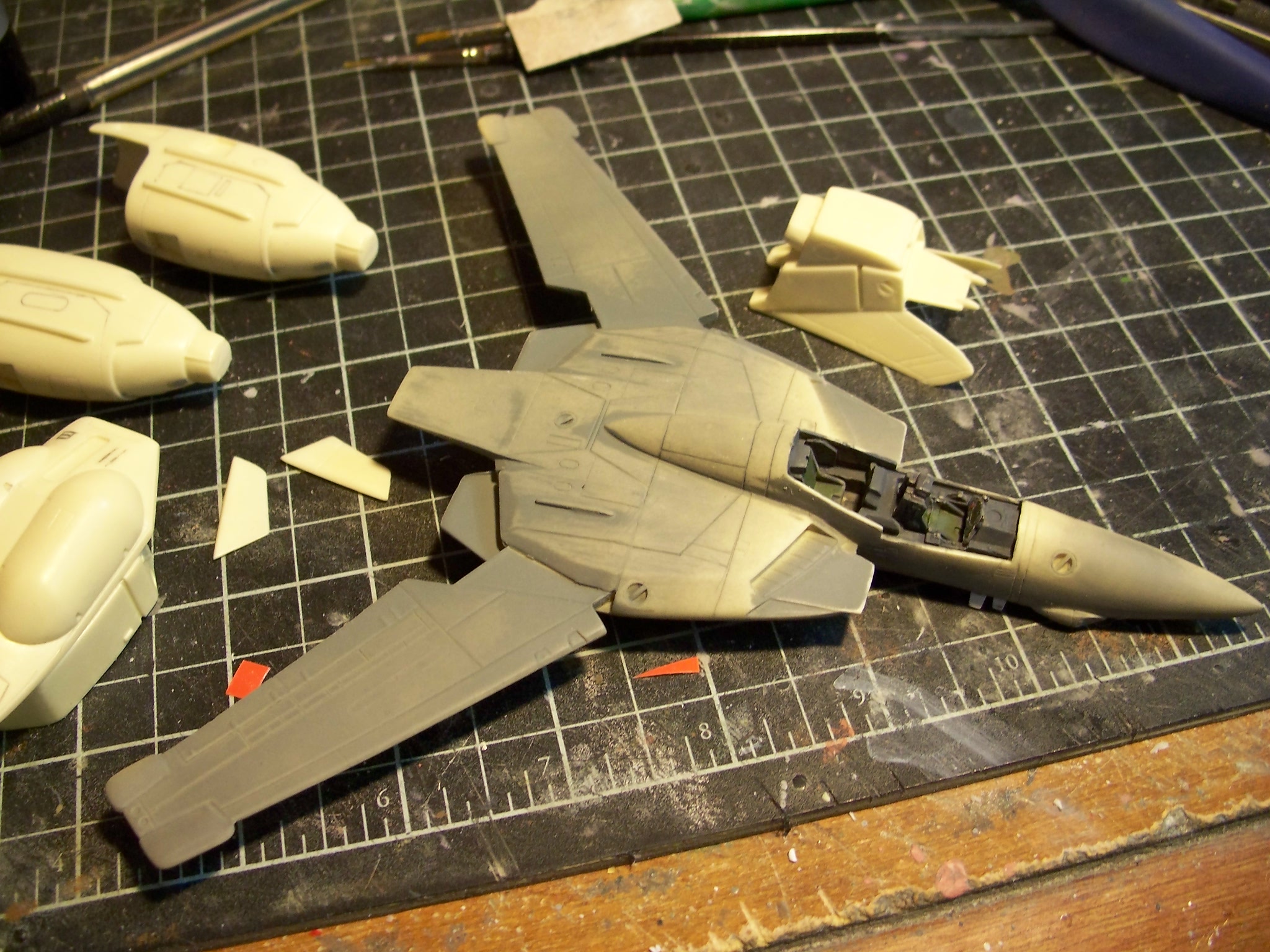

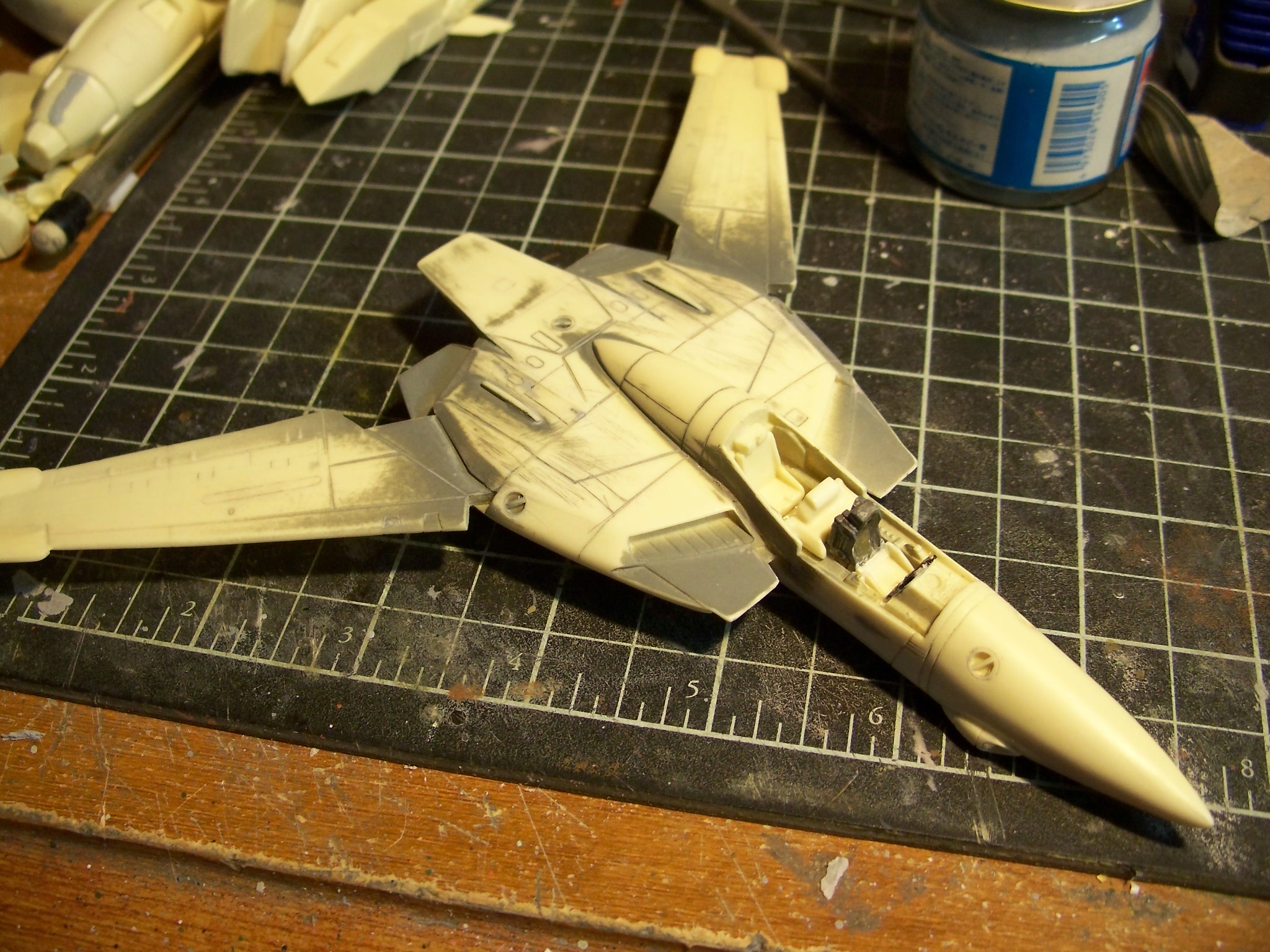

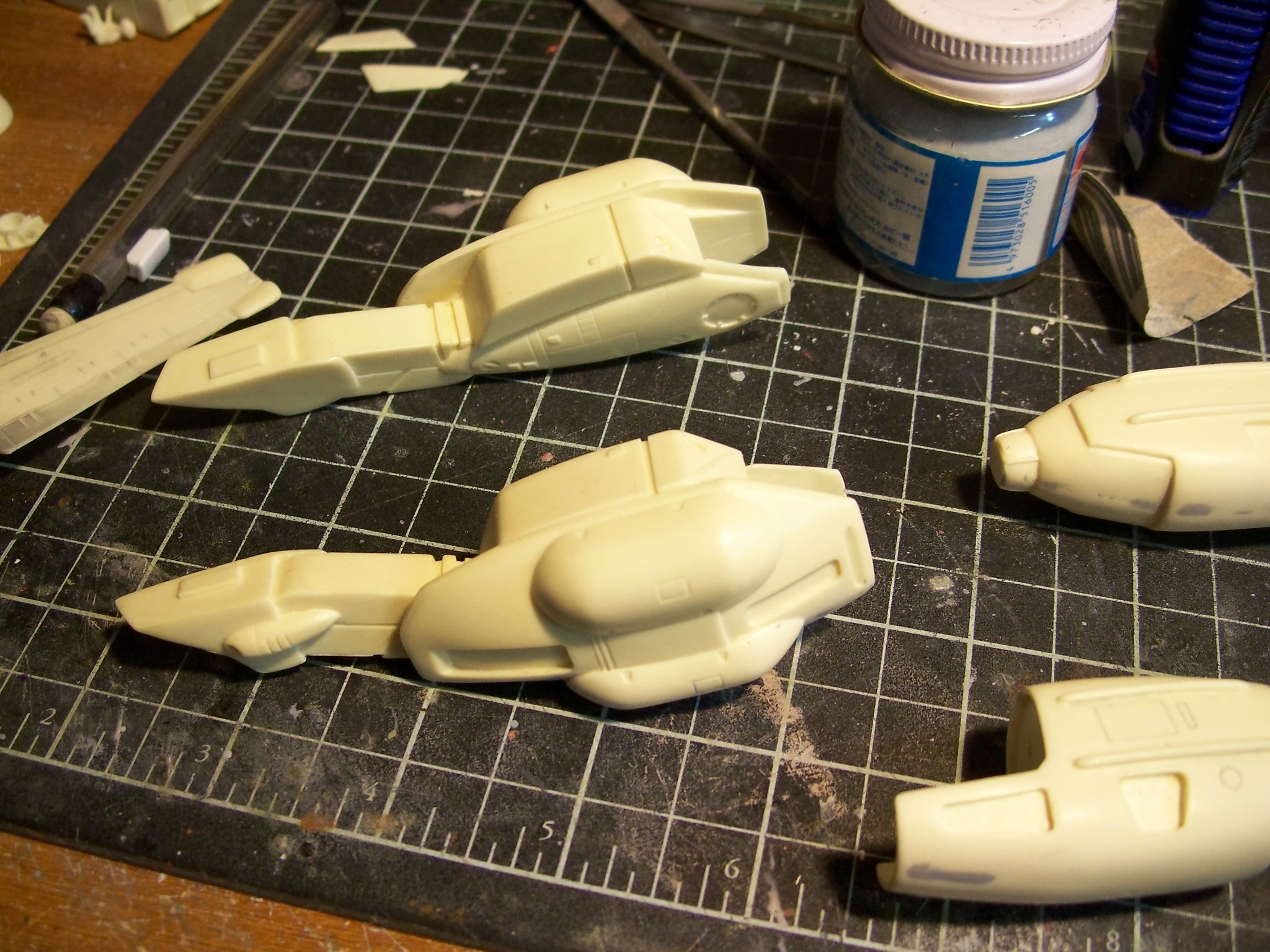

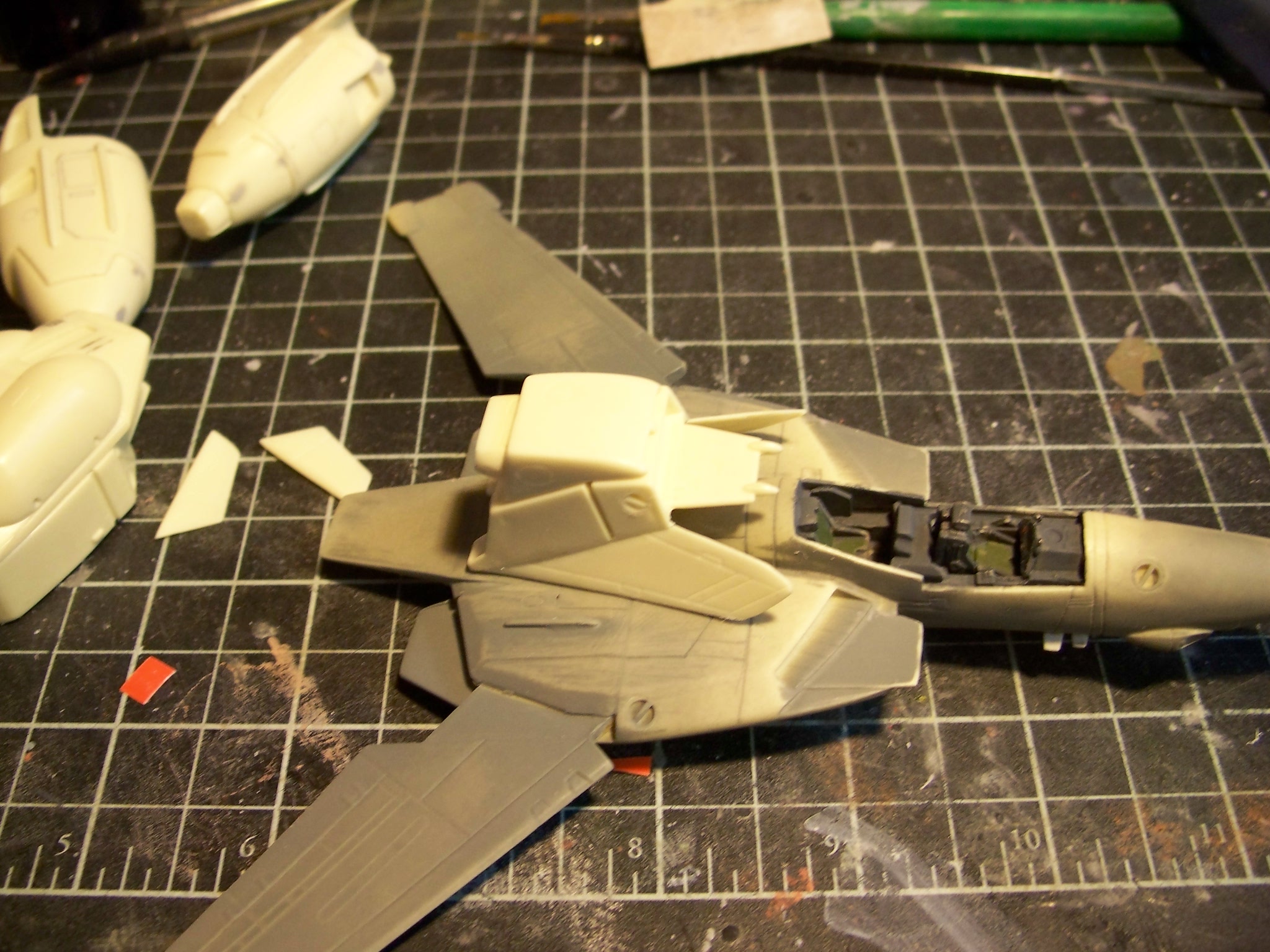

HWR MKII Posted December 12, 2008 Author Posted December 12, 2008 Here is last nights work. Glued on the wings and filled their respective seams. Also scribed in the upper wing fences that are prominent on every VF-1 kit from the Ultimate detail 1/48 to the 1/72 hasegawas. They are also seen in the PS2 DYRL opening scenes. Given 3 sources id say they are a safe detail to add. They also help fill out the wing and add a little interest. Next ill be cleaning up and getting everything ready for a coat of radome tan. In the cockpit i replaced the front seat top with a spare hasegawa VF-1 seat and the same with the front control panel. These add a needed detail touch to the cockpit that the kit was lacking. Not due to any fault in the kit. Its old as it is. Another reason im doing this build is that Macross Frontier has renewed my interest in the Macross series that came before. We have alot of new blood here because of it as well and some of the new members might also want to know more about what came before the VF-25. Quote

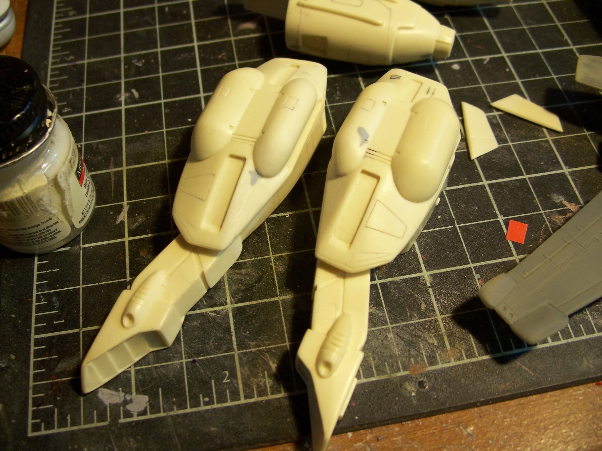

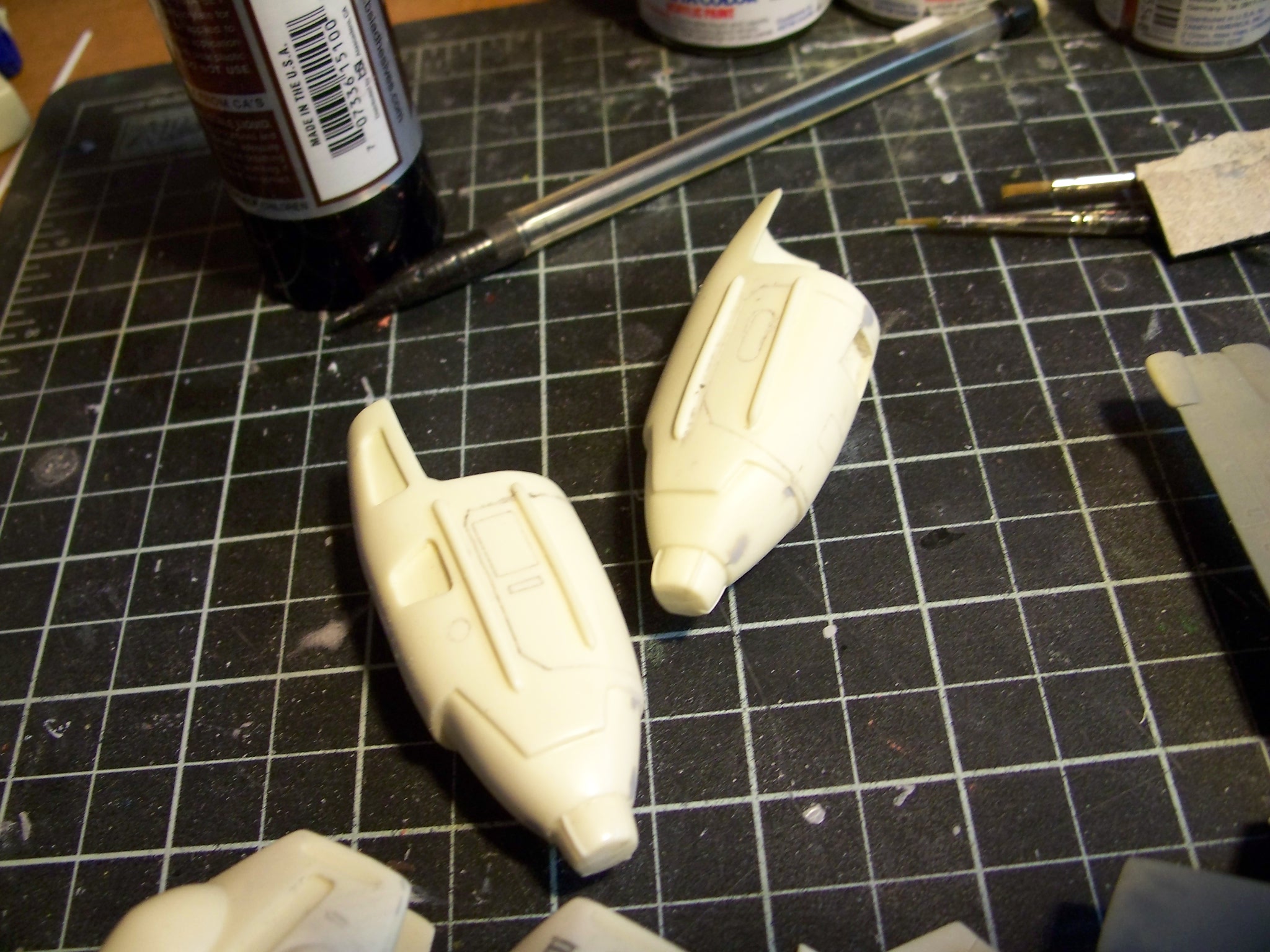

HWR MKII Posted December 12, 2008 Author Posted December 12, 2008 (edited) This will be a pretty clean build. Just sourcing better declas fot it. I should have what i need though. Doing some scribing work on the fast packs to bring more interest to them now. Edited December 12, 2008 by HWR MKII Quote

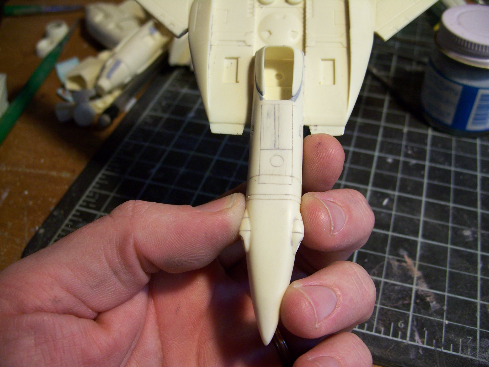

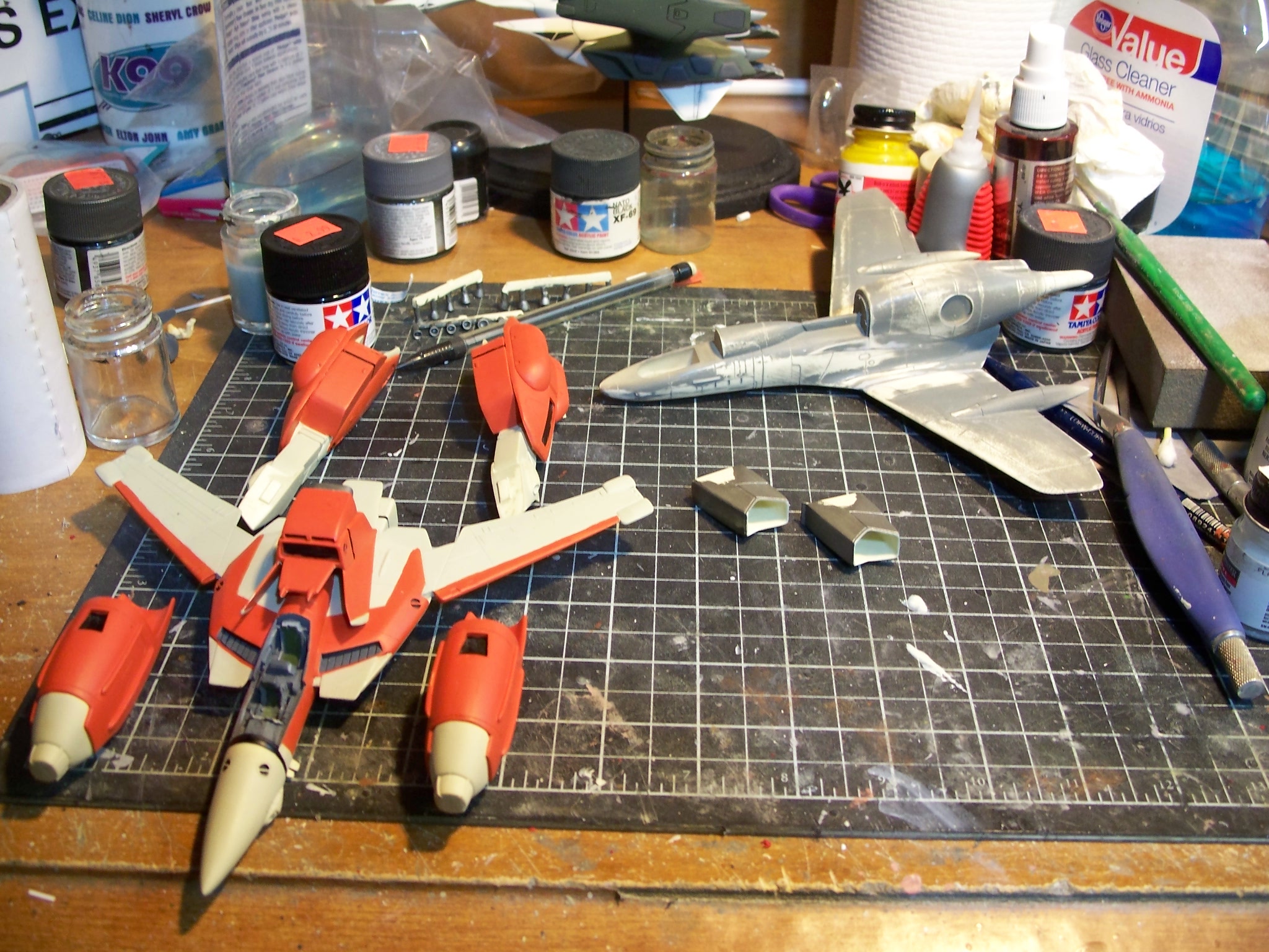

HWR MKII Posted December 12, 2008 Author Posted December 12, 2008 I have gone as far as i would like with the scribing. and all the necessary parts are ready for the initial color of radome tan. Quote
HWR MKII Posted December 12, 2008 Author Posted December 12, 2008 Everybody give thanks to testors acrylic for making a totally suckass paint. now off to rip and strip Quote

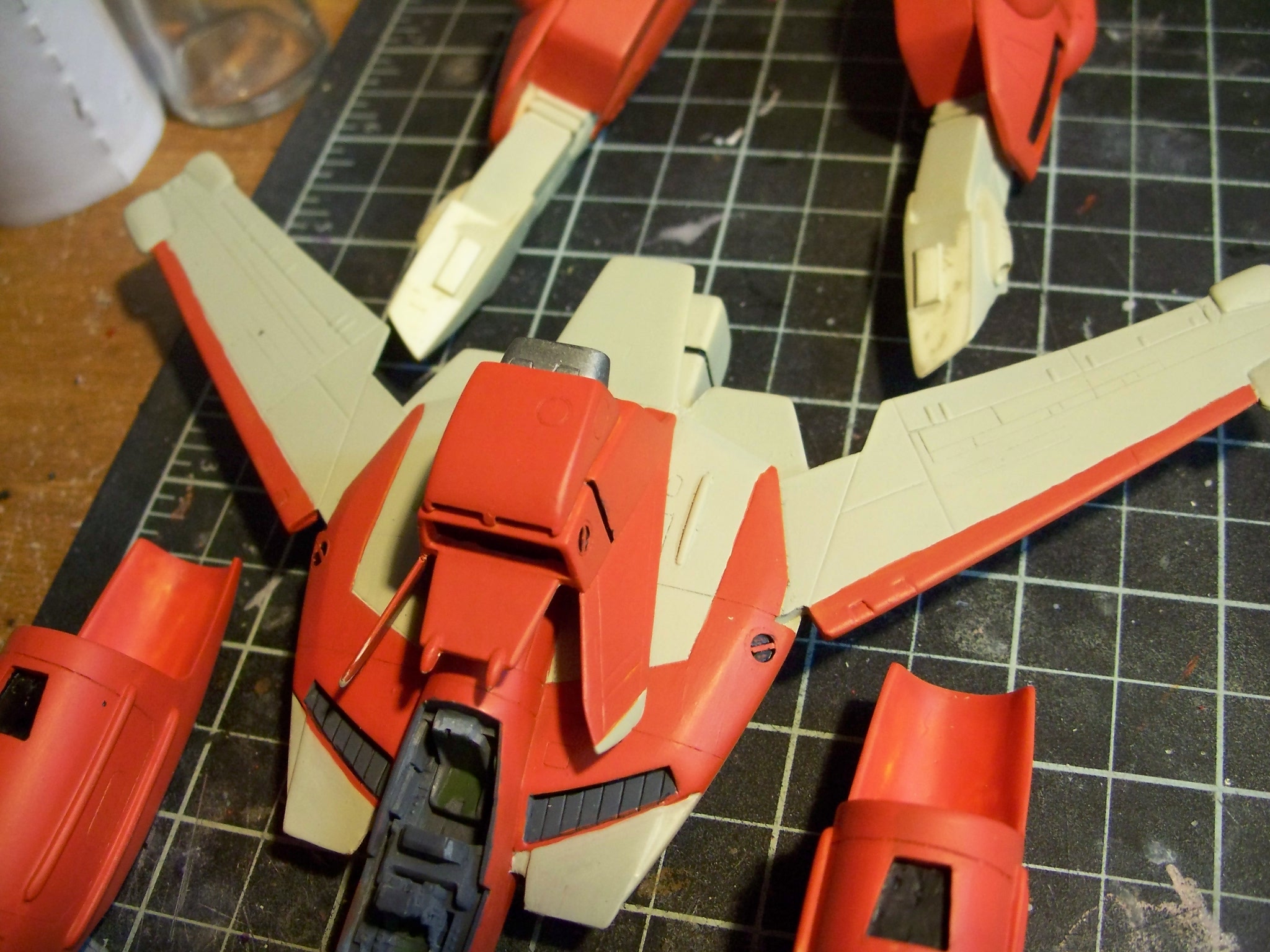

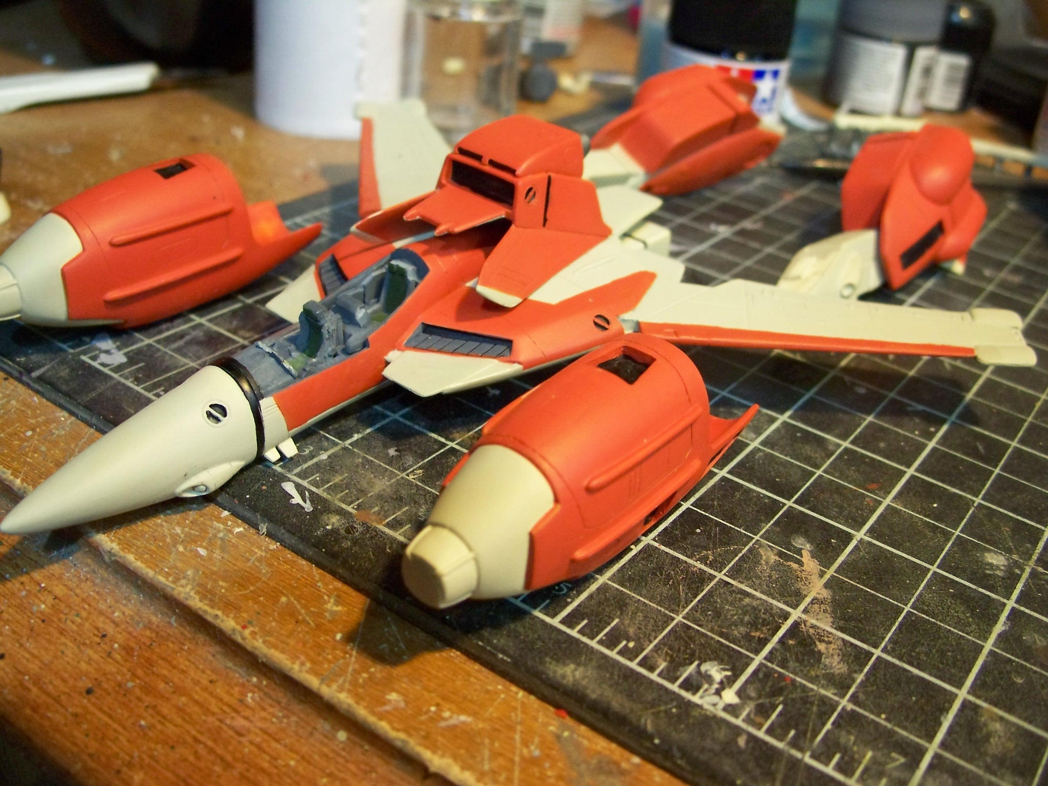

HWR MKII Posted December 13, 2008 Author Posted December 13, 2008 (edited) parts have been stripped and recoated with lightened tamiya deck tan. I actually like this color a bit more. As far as i can tell teh VT and VE 1 have almost the same wing tips. If one is going to go as far as calling a descrepancy in line art inaccurate than that is their issue. Ill live with it as it is. If i wanted this to be detailed as all get out id have got a hasegawa. It so happens i prefer the lines of this kit more. Im building a little resin space fighter here not an F-15E. Edited December 13, 2008 by HWR MKII Quote

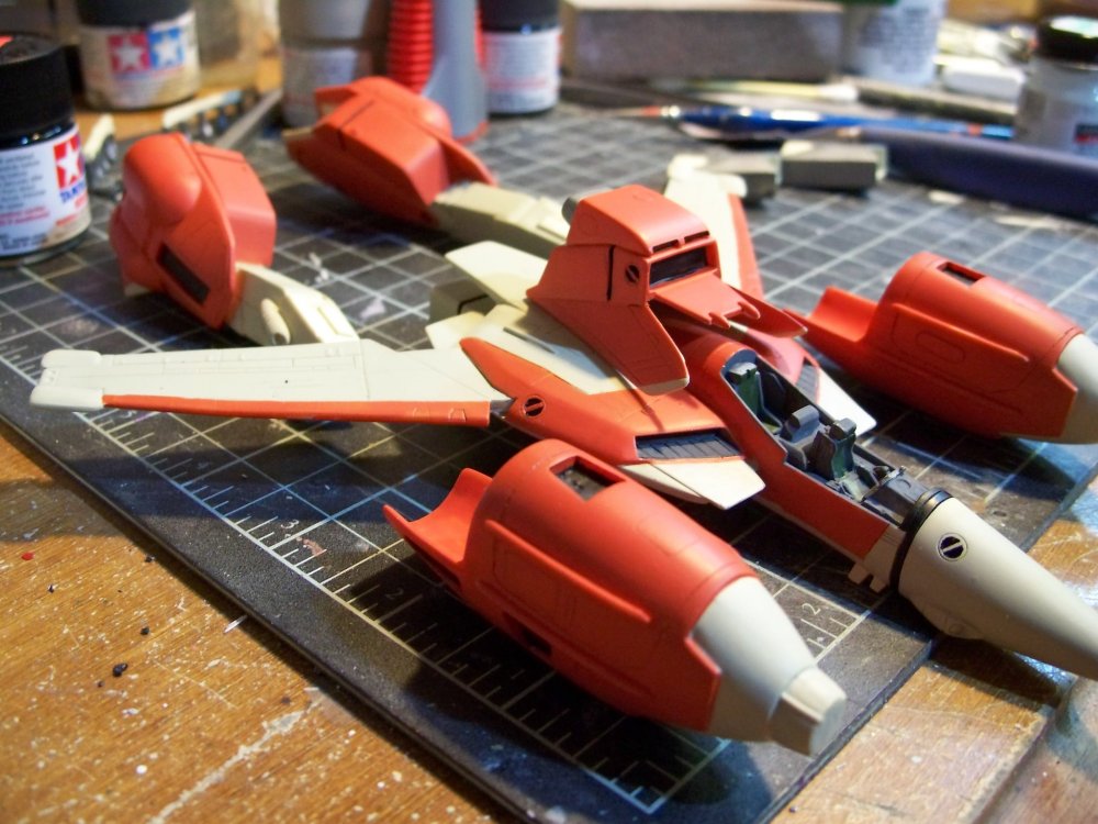

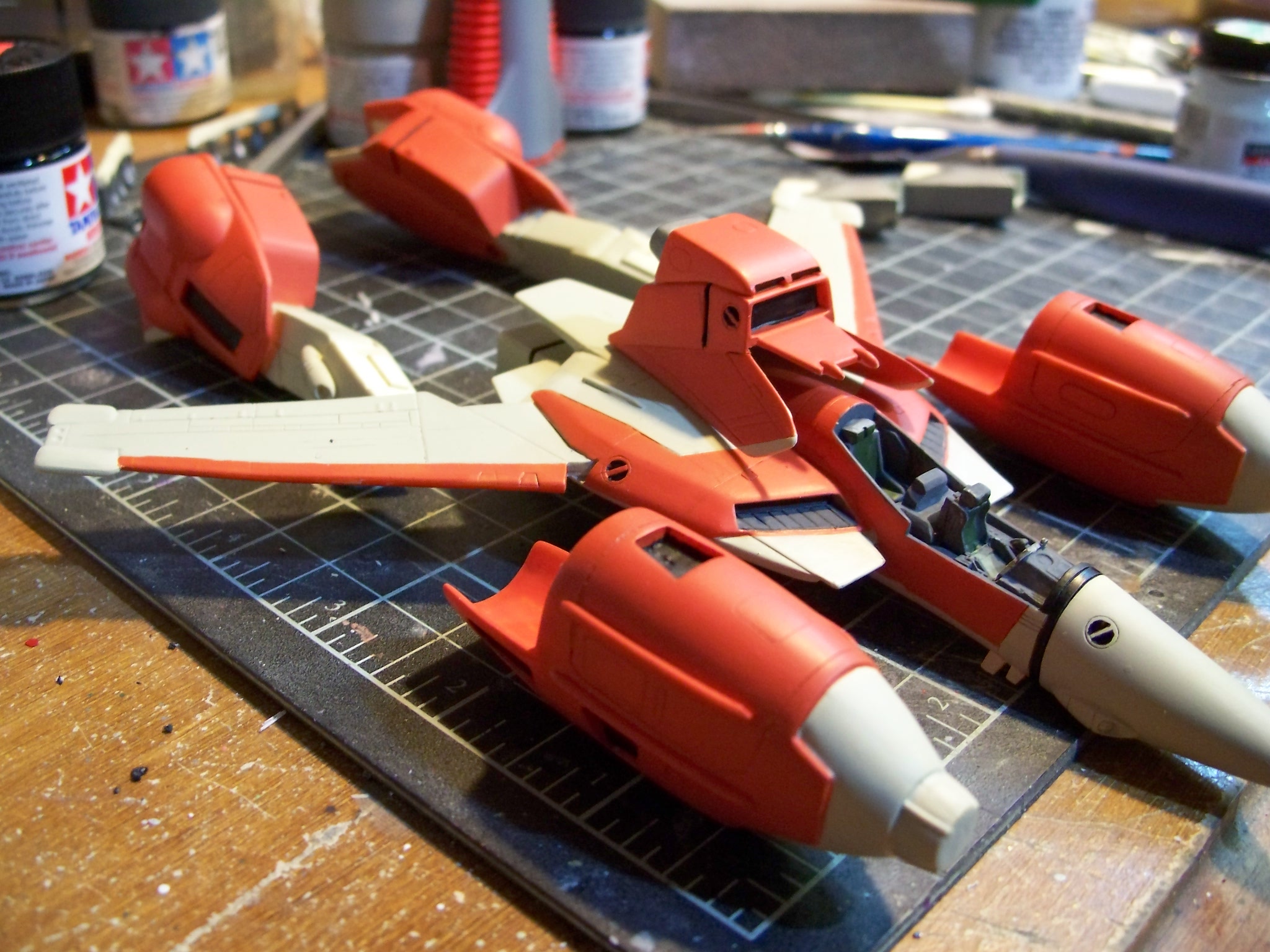

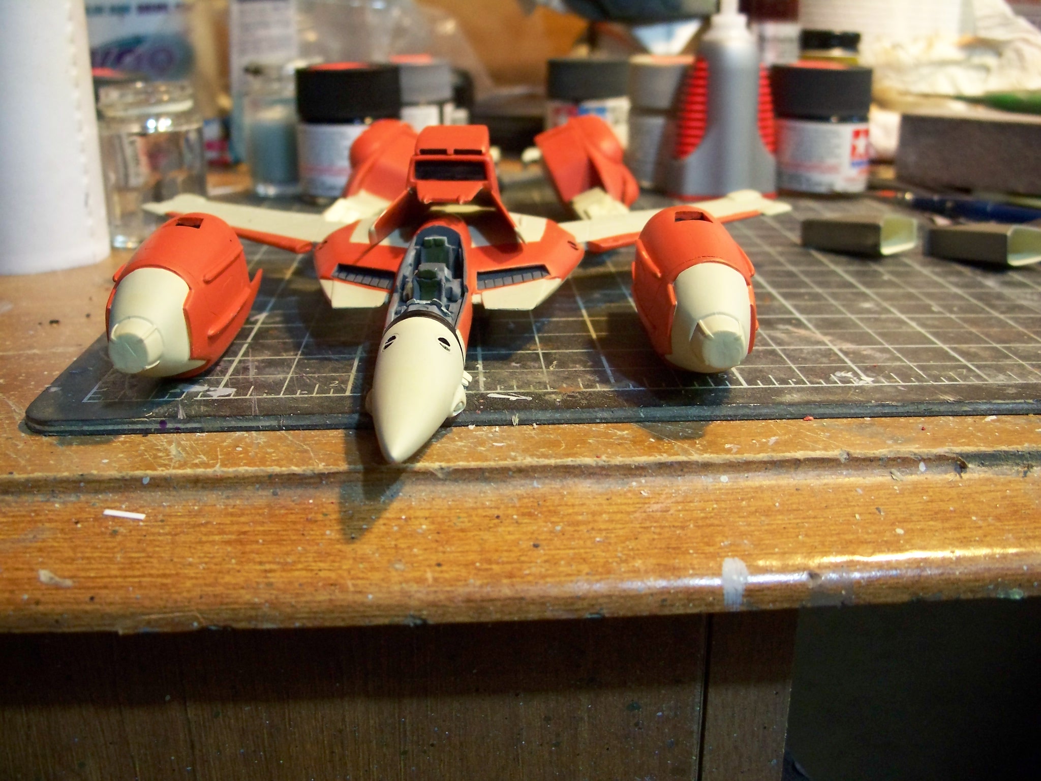

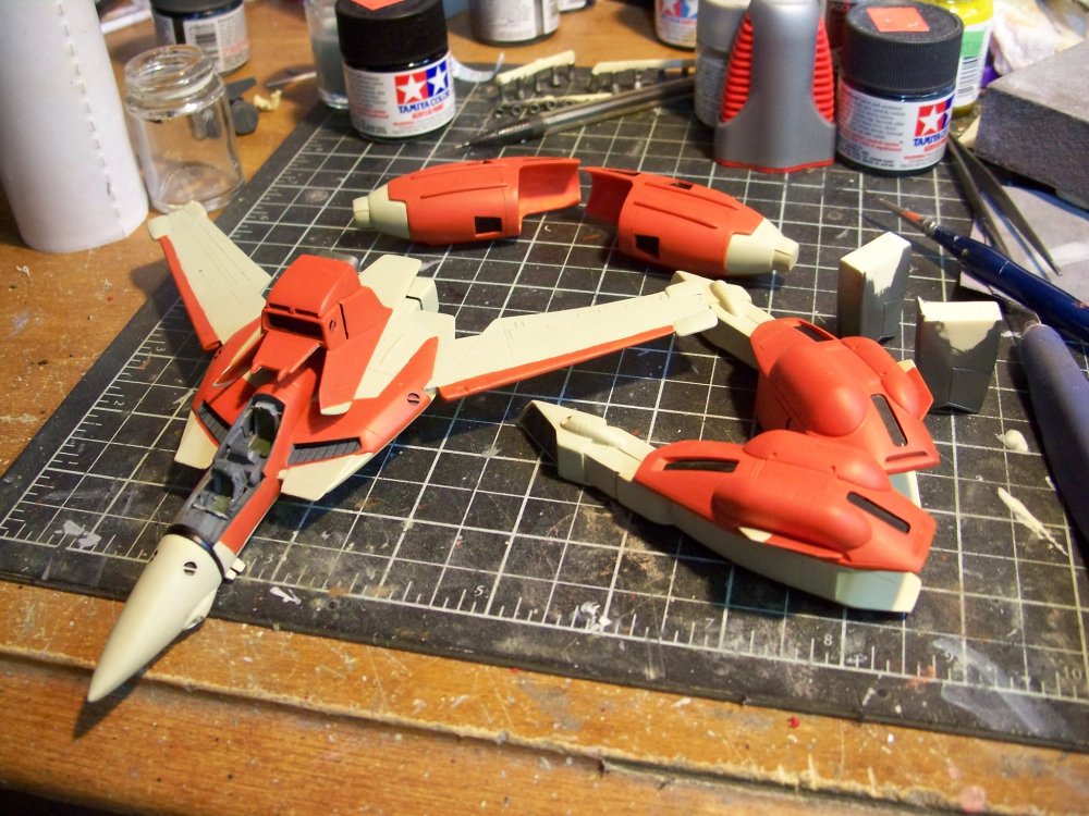

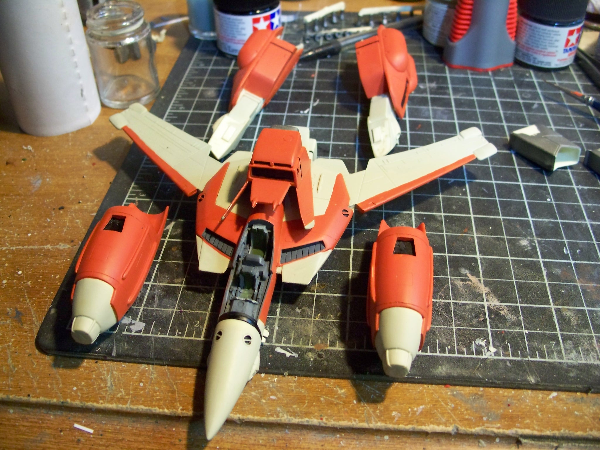

HWR MKII Posted December 13, 2008 Author Posted December 13, 2008 (edited) Ok no longer cranky. Things went as smooth as silk for everything else. I decided to dust off the ol brush painting skills on the orange. Saved alot of tedious masking and possible paint pull ups. I am satisfied with the resultsGood solid color and clean demarcations. That being said. Within a week i will have a sample set of some of PetarB's 1/72 pilots. These will be used to occupy the cockpit. I cant wait to get them. His sculptings are top notch. Also i am awaiting the decals from greyson 72. I cant do any of the landing lights until after the future, decals and matt coat are applied. SO the Ostrich is on hold for about a week. I dont mind though i have another Orange collection Valk to work on....and a Schira-Dow....and a VF-25. Man i really need to clean off my bench Edited December 13, 2008 by HWR MKII Quote
promethuem5 Posted December 13, 2008 Posted December 13, 2008 Looks sharp... I'm always in favor of brushwork in order to avoid tedious masking. Quote
HWR MKII Posted December 13, 2008 Author Posted December 13, 2008 Thanks Ben It will look even sharper after a wash. All the demarcation lines for the color came scribed into the model. The black line left from the wash will tighten up alot of things Quote
Berttt Posted December 13, 2008 Posted December 13, 2008 mmm seems nice for brush painting. I have noticced that even if you do get some brush amrks they can be hidden by a gloss oat afterwards. Quote
VFTF1 Posted December 13, 2008 Posted December 13, 2008 Borat voice: Veeerrrry nice! How much? But seriously - I am forever in awe of the talent of people on this forum for making stuff like this. Your project is no exception. Looking forward to the final result Pete Quote
Excillon Posted December 13, 2008 Posted December 13, 2008 Damn dude, explain your brushwork skills for those of us who aren't so great at it. Quote

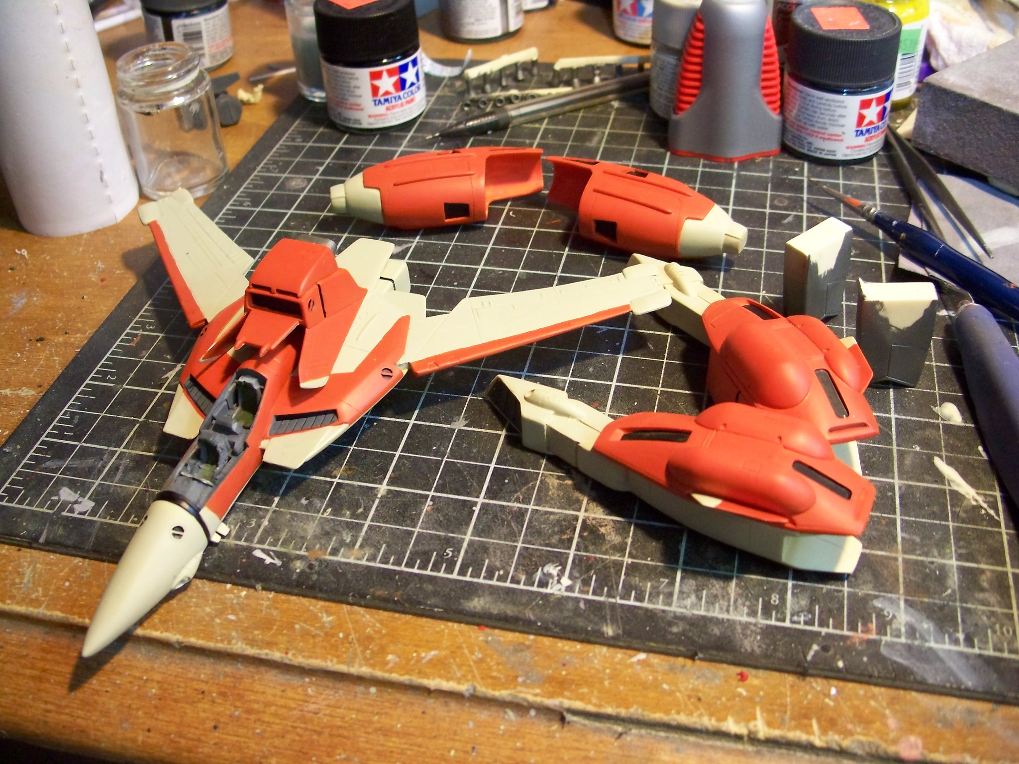

HWR MKII Posted December 13, 2008 Author Posted December 13, 2008 (edited) Theres alot of factors to the brush work. most important are a good base, a good soft round sable and the right paint consistency. The base on this was the tamiya deck tan. It was smoth but created a good tooth for the first layer to grip and spread evenly on. It only took 2 coats to get even coverage. A round brush holds paint better and spreads it more evenly than a square or flat brush. Alot of people try to use flats and thats where the streaks really happen. The paint just has to be thinned just right. Not airbrushing thin but not straight from the bottle either. Its a matter of trial and error for that one im afraid. Let the paint dry fully between coats as well so you dont lift the underlying layer. this is where a good base comes in handy again. Also dont try to paint the etire area with the one brush. use a liner brush or a smaller round to get close to details. these normally only need one coat since its a smaller area. also once you have a good edge it gives you breathing room to get in with the larger round. Edited December 13, 2008 by HWR MKII Quote

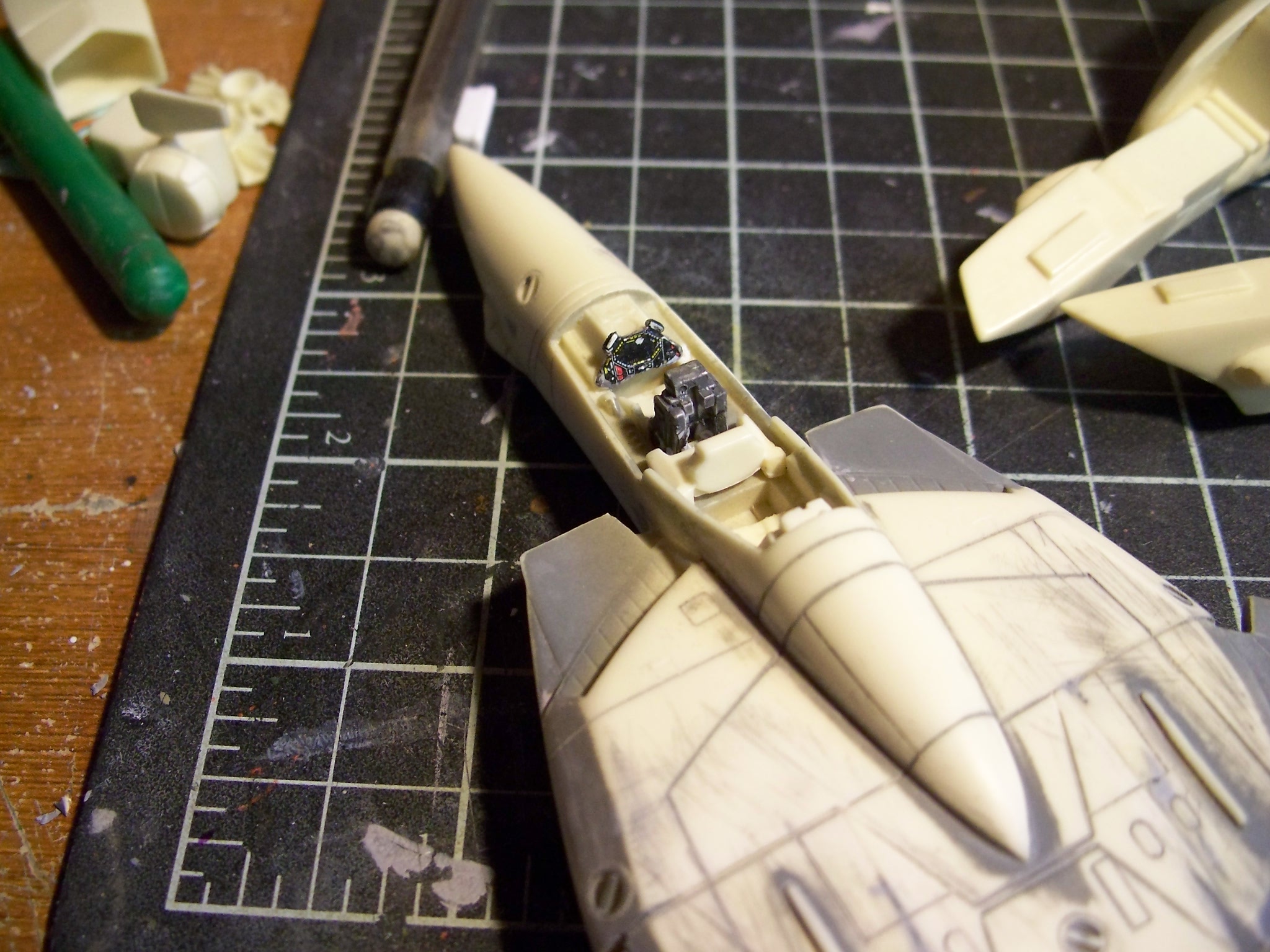

HWR MKII Posted January 2, 2009 Author Posted January 2, 2009 Ok the decals for the Ostrich arrived from Grayson 72 this weekend and are just what i need. Heres the bad part. Petars male pilot figure is incompatable with this kit. Doesnt mean i still wont use it and paint it up though. He sits too tall in this kits seat. I dont know how it would fit in a hasegawa since mine are all sealed but one would think Petar has a hase on hand to make sure it will fit and clear the canopy when closed. His female in civillian helmet however fits like a glove in the back seat and i have a spare DYRL style pilot so i can still have a minmay and hikaru in there. Should have some shots for you guys in a day or 2. Petar once these are painted ill take a bunch of different shots and let you pick the ones you like most. Quote
PetarB Posted January 2, 2009 Posted January 2, 2009 All figures have been designed specifically for and tested in the Hasegawa VF-1 series kits, and they seem to work fine. I didn't have any Arii or resin kits to test out on. When you get the camera out, I'd love a shot of the male pilot just placed in or near the seat so I can get a handle on the issue. If I can, I will alter it so it's a 'one size fits all'. There will be always be a tiny variation in height, due to the pouring process, however you can run the base across some sandpaper to easily correct this. Anyway, can't wait to see this Ostrich painted up, it's one of my favourite Macross subjects. Quote
Grayson72 Posted January 2, 2009 Posted January 2, 2009 All figures have been designed specifically for and tested in the Hasegawa VF-1 series kits, and they seem to work fine. I didn't have any Arii or resin kits to test out on. When you get the camera out, I'd love a shot of the male pilot just placed in or near the seat so I can get a handle on the issue. If I can, I will alter it so it's a 'one size fits all'. There will be always be a tiny variation in height, due to the pouring process, however you can run the base across some sandpaper to easily correct this. Anyway, can't wait to see this Ostrich painted up, it's one of my favourite Macross subjects. Did you ever see the build up I did? Quote
