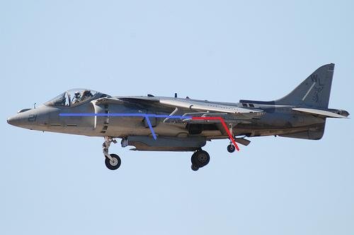

Vostok 7 Posted December 7, 2008 Posted December 7, 2008 (edited) And on the topic of the Russian birds do they use lift fans? I thought that both the Yak-38 and Yak-141 used dedicated lift engines and not fans as in the F-35B. The fan on the F-35 is powered by a shaft from the main engine while as the Yaks have lift engines that are separate from the flight engine/s. Or am I wrong? Indeed, the Yak-38 and Yak-141 use two small lift jets behind the cockpit, but one of the major similarities is the "swiveling" main jet exhaust for stability, similar to the F-35. Despite the Yakolevs using separate lift engines versus one engine with a shaft driven fan, the systems between the Yakolevs and F-35 are very similar. The Harrier uses a completely different setup in that it has only one engine with four vectorable ports to provide lift, part of the reason the Harrier has been so successful because it's rather simplistic. However, the Yak-141 is distinct in that it is mach-capable and true multi-role fighter aircraft rather than strictly close support attack aircraft (though the F-35 is closer in role to the Harrier being multi-role, however the F-35 is mach-capable and so can fill the role of air-superiority better than the Harrier could). Vostok 7 Edited December 7, 2008 by Vostok 7
SchizophrenicMC Posted December 7, 2008 Posted December 7, 2008 F-35: Air flows around lift fan shaft as it is sucked towards the turbine. The fan causes air to flow downward, giving upward thrust. Harrier: Air flows into engine, where cold air in the front is directed out of the front 2 thrust vectored nozzles. The rest of the air continues into the turbine, and hot air flows out of the rear nozzles. Yak: Similar to the F-35, except they use 2 fans. Please note that while the F-35 shown is an A model, therefore CTOL only, however it was the only schematic picture I could find. The Blue lines on the Harrier one show cold air flow, red is hot. This doesn't mean the same on the other 2. I didn't differentiate because the fans don't share their intake with the engines. ..........bmp untitled.bmp
hobbes221 Posted December 7, 2008 Posted December 7, 2008 Indeed, the Yak-38 and Yak-141 use two small lift jets behind the cockpit, but one of the major similarities is the "swiveling" main jet exhaust for stability, similar to the F-35. Despite the Yakolevs using separate lift engines versus one engine with a shaft driven fan, the systems between the Yakolevs and F-35 are very similar. The Harrier uses a completely different setup in that it has only one engine with four vectorable ports to provide lift, part of the reason the Harrier has been so successful because it's rather simplistic. However, the Yak-141 is distinct in that it is mach-capable and true multi-role fighter aircraft rather than strictly close support attack aircraft (though the F-35 is closer in role to the Harrier being multi-role, however the F-35 is mach-capable and so can fill the role of air-superiority better than the Harrier could). Vostok 7 Yeah I got how the Yaks and -35 have the same lay out for thrust when compared to the Harrier I was just checking as how everyone was calling them 'lift fans' sometimes I get a little picky on words. But thanks for the info and reply. And on the whole lift fan vs engine thing has it been stated 100% just what are in the SV-51? because if they are just fans that would seem to say that they would have to powered by electric motors without a direct power take-off shaft do to it being a variable fighter.
