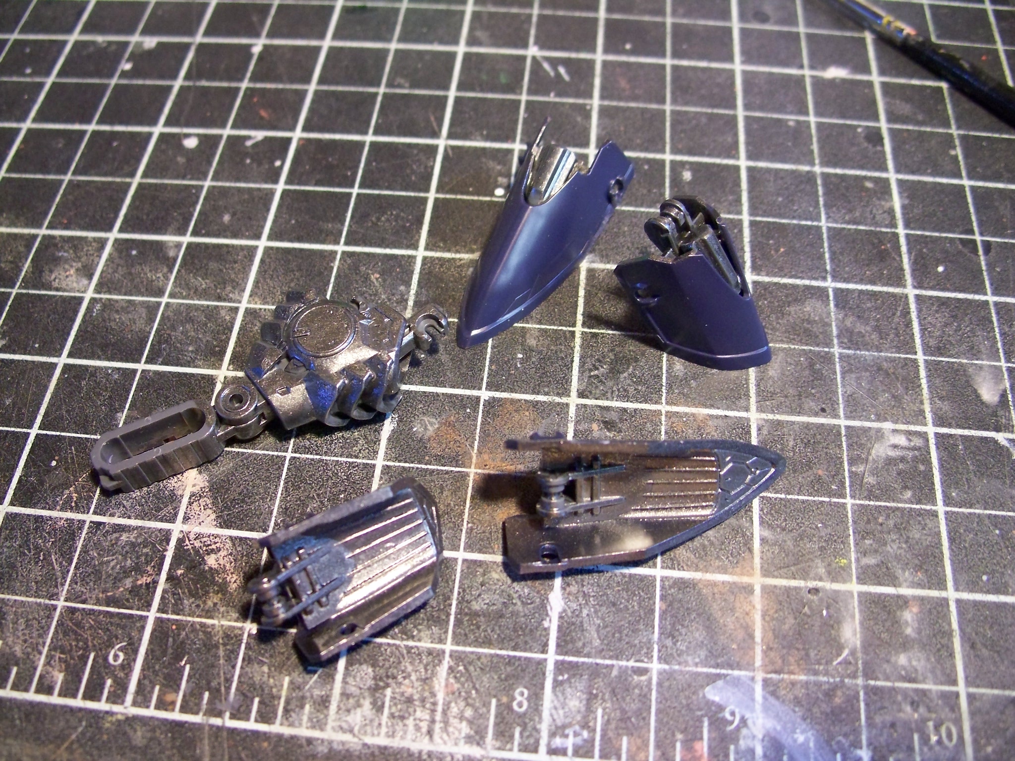

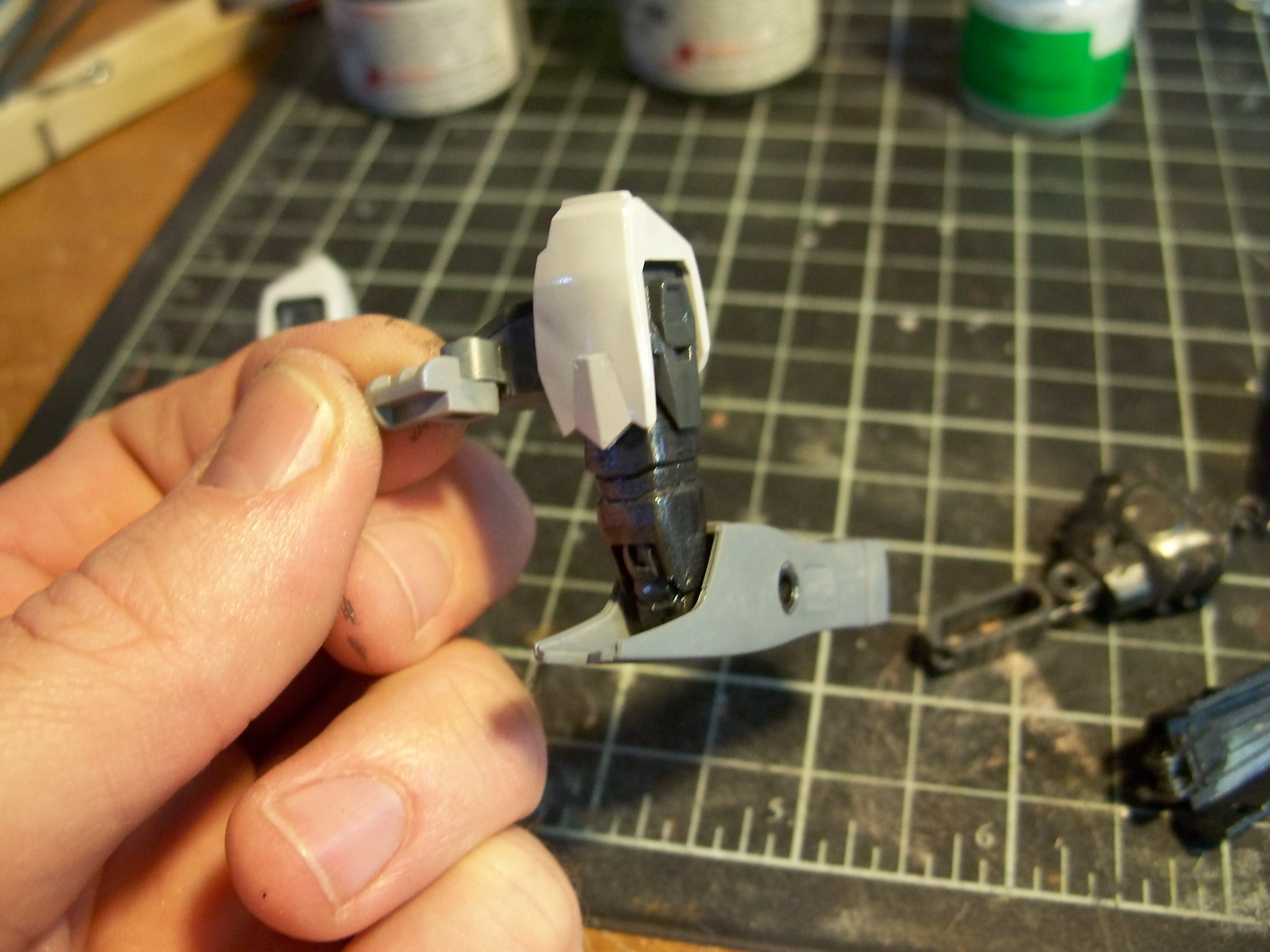

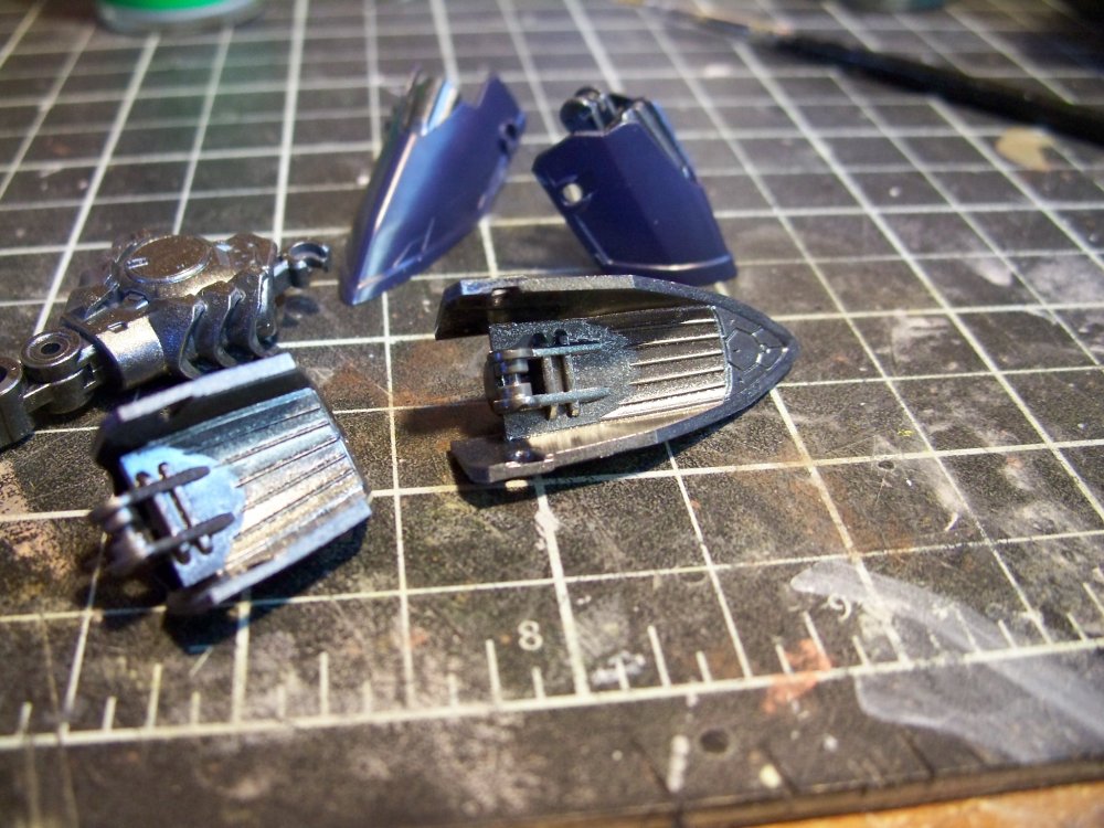

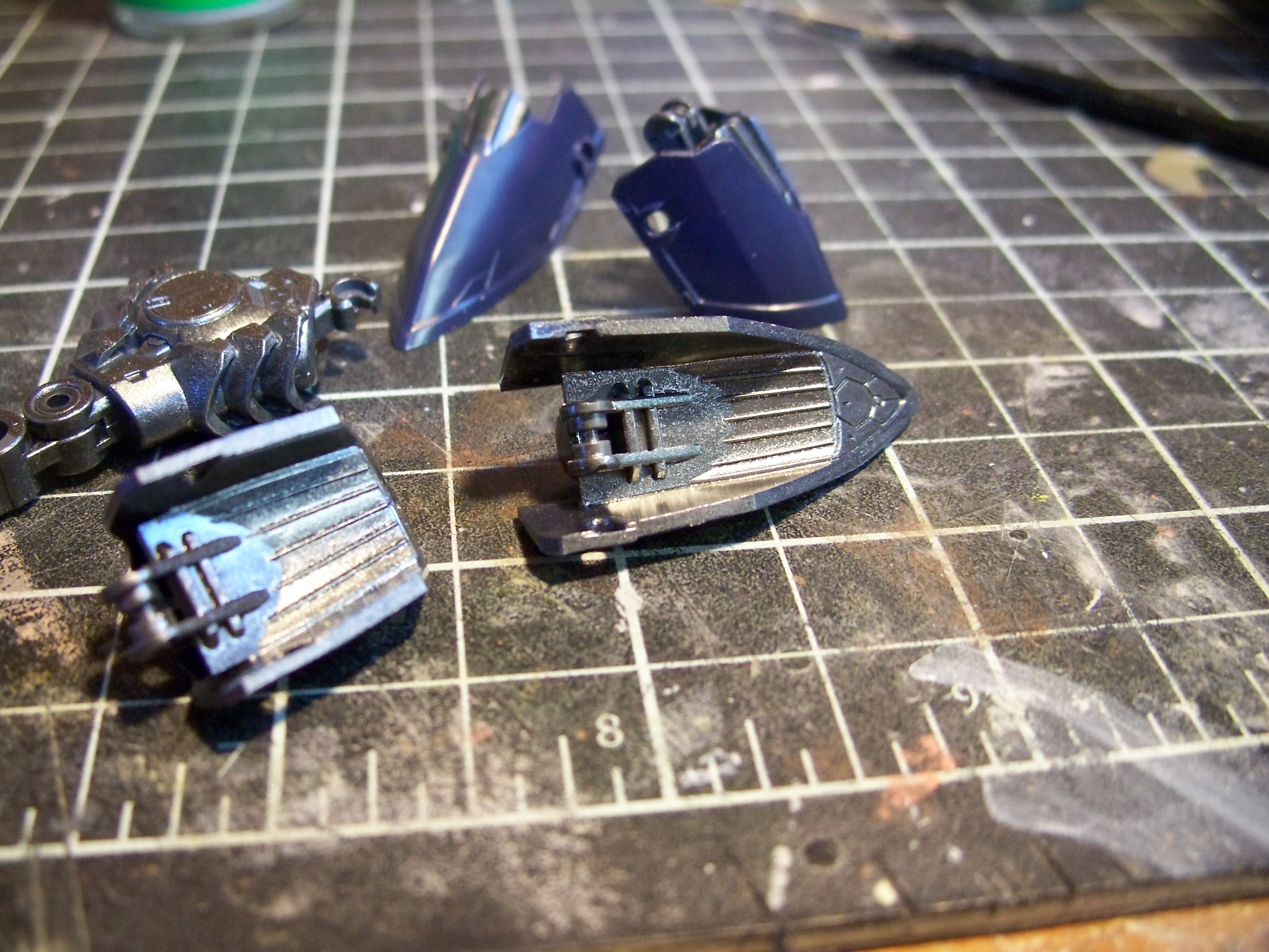

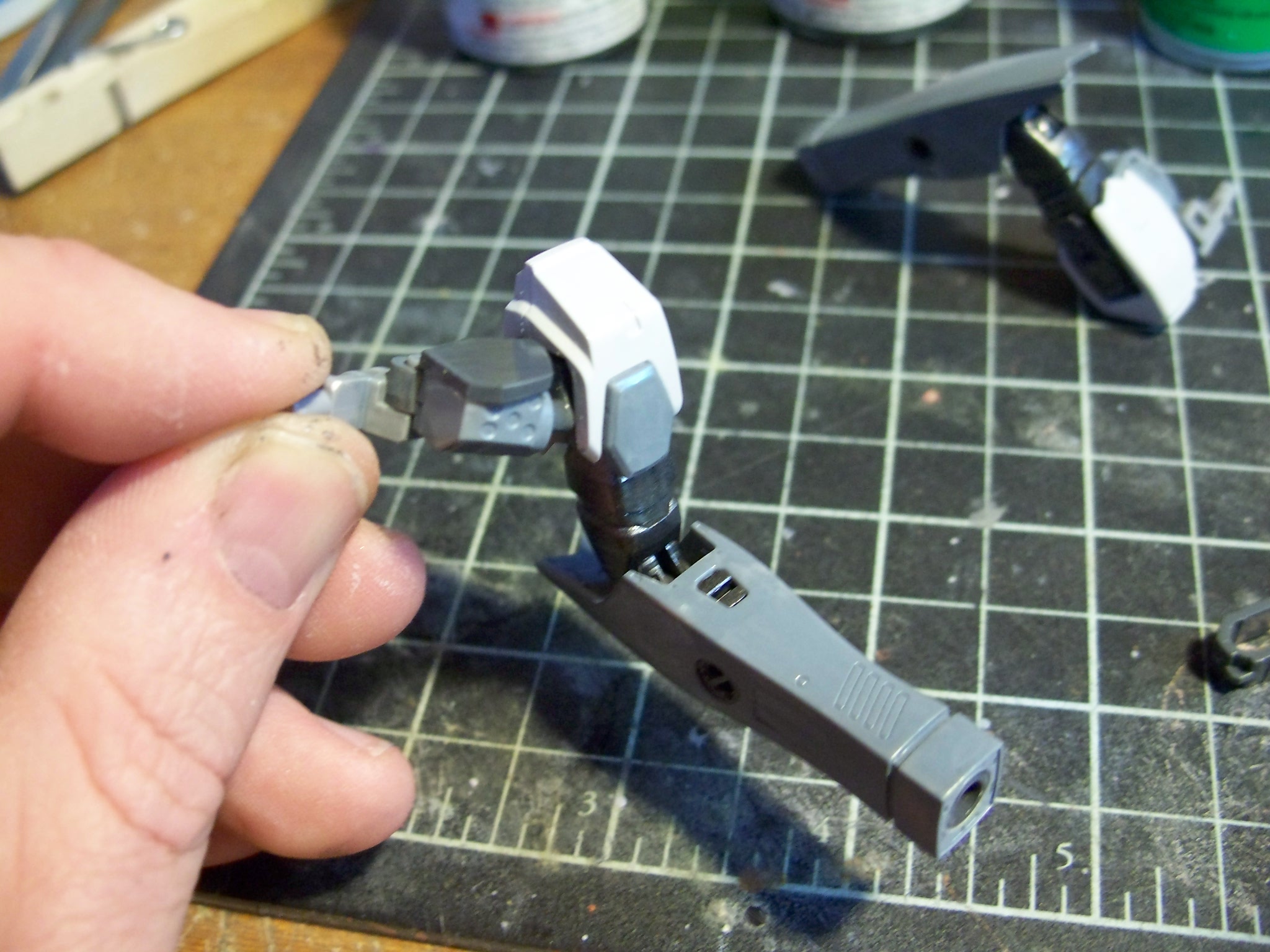

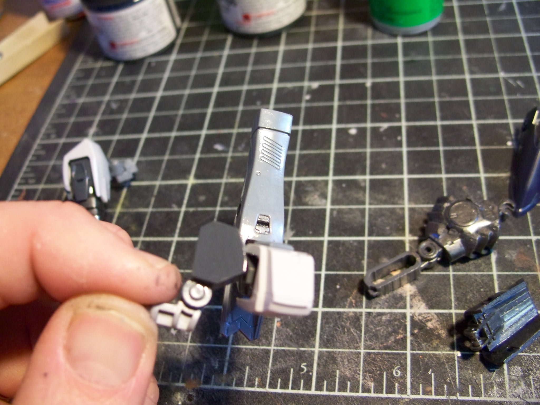

HWR MKII Posted December 9, 2008 Author Posted December 9, 2008 (edited) Arms and shoulder assemblies are done. For those wanting to do a darker grey on the upper fuselage pieces note that there is a panel on the shoulder part that needs to be painted dark grey. The part is molded in a lighter grey plasatic. I have fully painted all my parts. All internal mechanical parts will be gunmetal with grey metallic details where applicable. I have also started on the foot thrusters. Again the internal parts are overall gunmetal. I will pick out details later when the entire assembly is ready before fuselage panels go on. I dont like the purple plastic that the exhaust nozzles are. So the inside gets a coat of gunmetal while the outsides will be metallic grey. Aside from the very light grey all paints used are tamiya. The light grey is Polly S. Where possible i am prepainting all the parts before assembly. In cases like the arms though the parts must be assembled and the seam taken care of before painting. This kit reenforces my belief that bandai does not consider painting when making their kits. while it can be done they really dont allow for subassemblies when painting. Edited December 9, 2008 by HWR MKII Quote
edwin3060 Posted December 10, 2008 Posted December 10, 2008 For a transforming kit there might be some areas where the tolerances don't really allow for painting, else you would get a floppy/gappy model otherwise. Quote
HWR MKII Posted December 10, 2008 Author Posted December 10, 2008 With how thin im getting the paint not very likely. I have found that a light coat of paint can actually tighten a join and make it less floppy. So far all parts fit nice and tight. Quote
