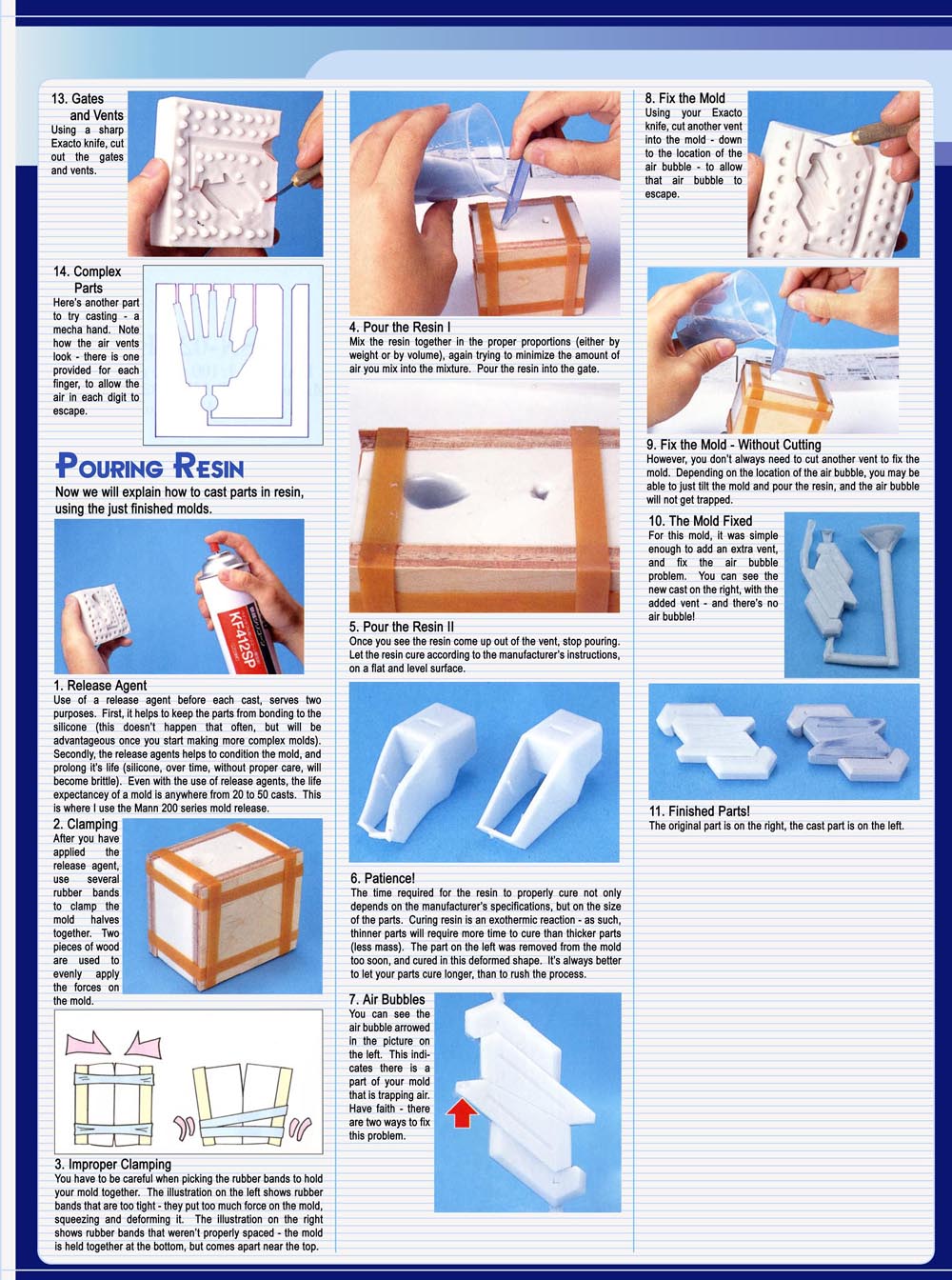

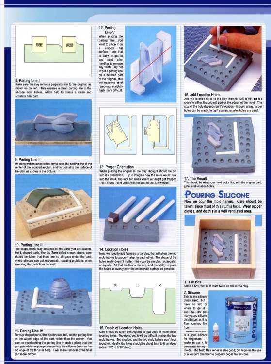

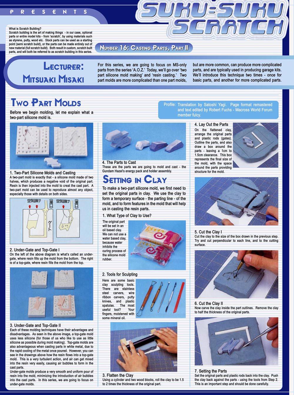

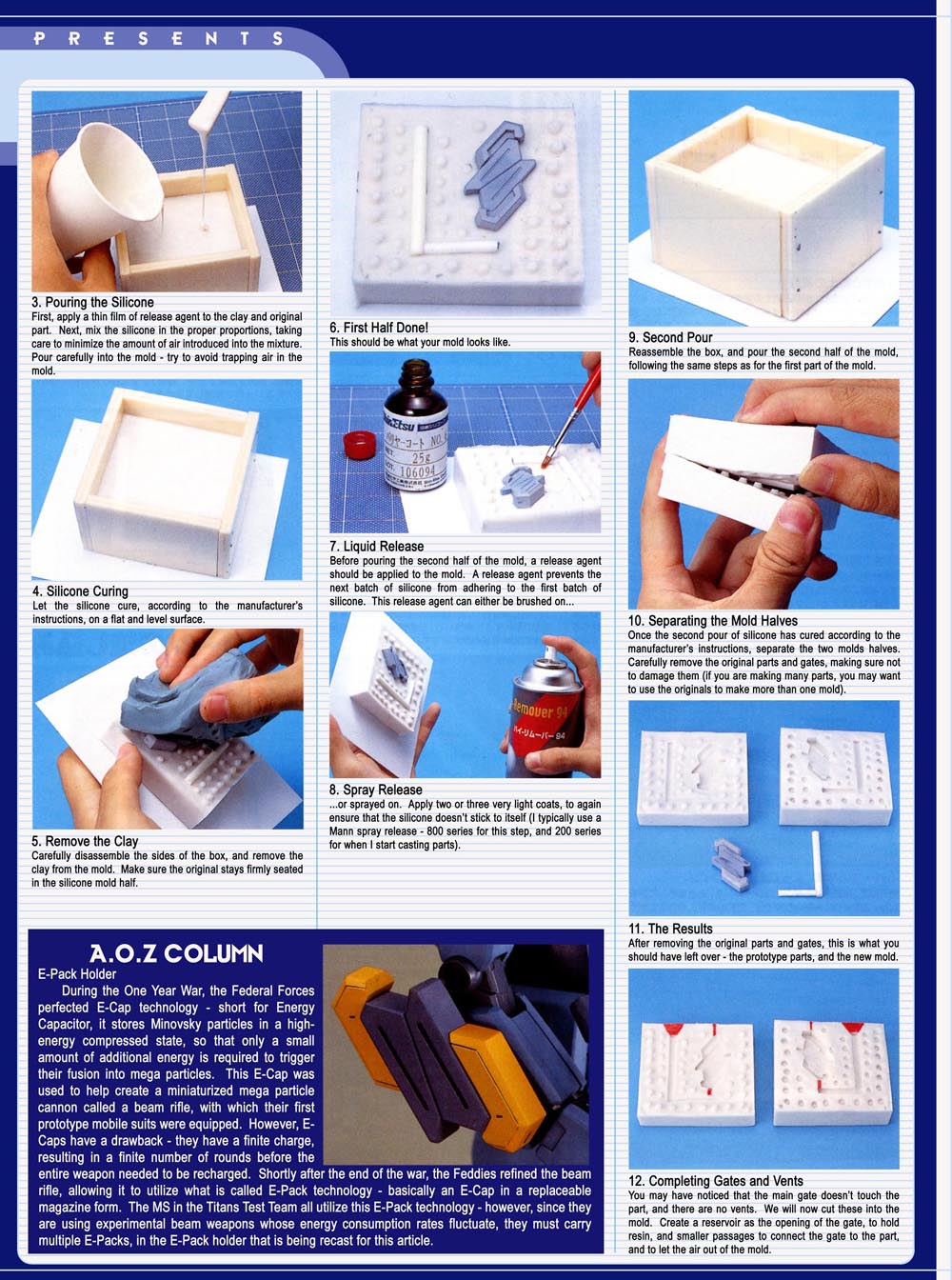

Ignacio Ocamica Posted October 29, 2008 Posted October 29, 2008 Hope these pics help you!!! (Courtesy of MW member Fulcy)
