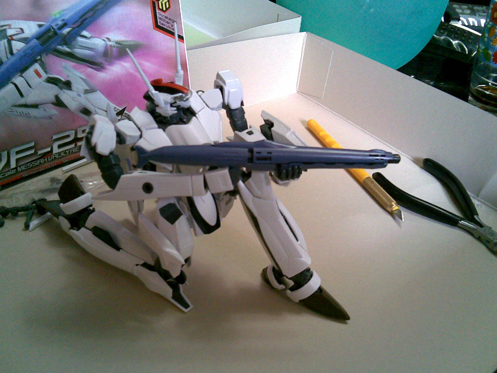

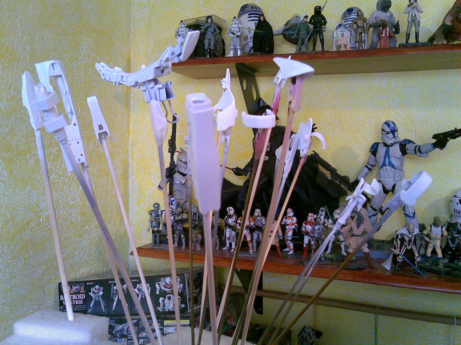

bishop_710627 Posted October 31, 2008 Posted October 31, 2008 (edited) hi W CHENG YES!!!! Good Luck. As you Know I really want to follow your step by step. My work: Edited October 31, 2008 by bishop_710627

wm cheng Posted November 3, 2008 Posted November 3, 2008 Hey everybody, I managed to start it on Friday and got a few hours on Saturday too so I plan to start the thread tomorrow on Monday. Its very different though, its not like any normal model so my approach will be very different too. I just plan on totally "snapping" it all together completely first to see where everything goes and where it all has to move and rub against each other - THEN I plan of taking it all apart to paint properly and glue and fill the seams and turn it into a proper model. Its this part that I will document, I know I usually take a bunch of photos of the process, but there really isn't much to photograph when I'm just "snapping" the pieces together. I am pretty much following the instructions to the letter... its a pretty complicated model with tons of moving parts. So I'll consider modifications such as magnets and such only after I get a good handle of how it transforms and goes together. I'll document the process where I take it all apart again - this is my "work horse" experiment for my other subsequent VF-25s. David, I tried to look for purple food dyes but had no luck on the weekend. I'll still search on Monday, but I also plan on cutting all the tabs away from inside the canopy - it really detracts away from the model, so it may take a while to carefully cut them out, and re-polish it back to translucency. Plus I'll try to re-build the front of the cockpit hood, it just looks weird that it just ends like that before the front windshield. I am curious as to how everybody tints their canopies.
