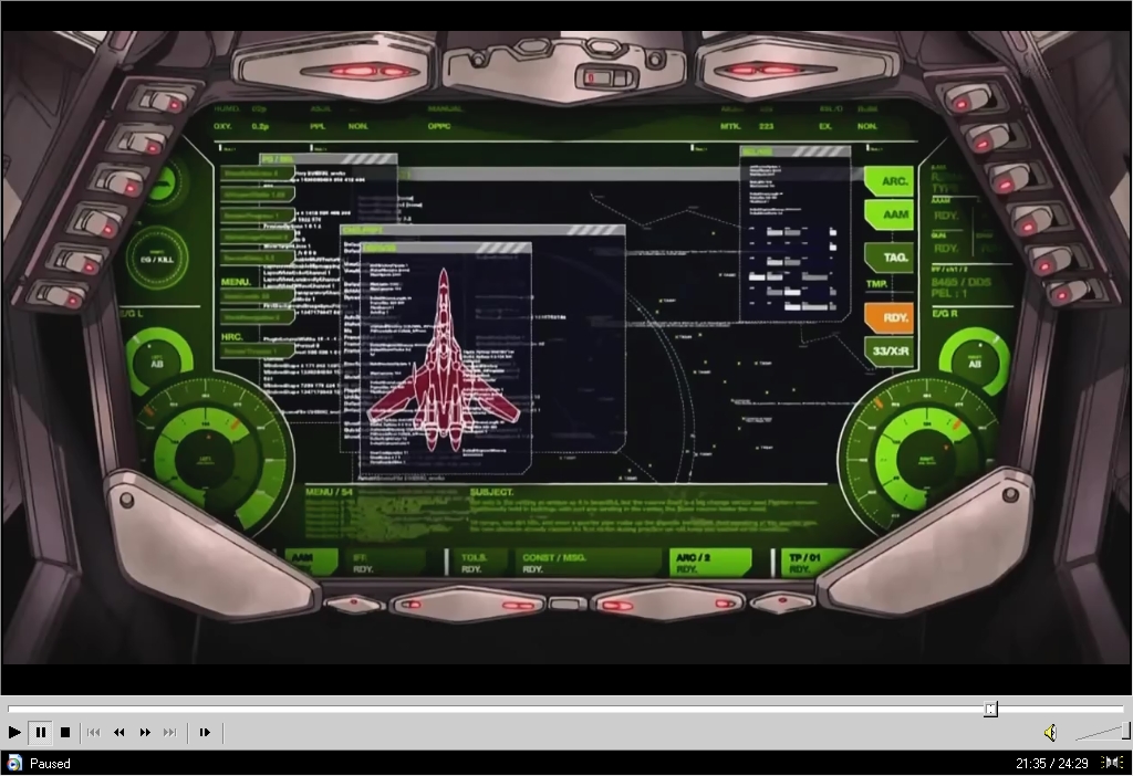

David Hingtgen Posted October 17, 2008 Posted October 17, 2008 Does anyone here know of something we could do to get some instrument panels printed up? I mean, there's no way to paint one like this--there aren't even any gauges molded on to drybrush or anything, it's just a bunch of green flat-panel displays in the anime. And bandai just gave us a featureless grey slab. Here's the best pic I could find of a "normal" VF-25 instrument display: Quote

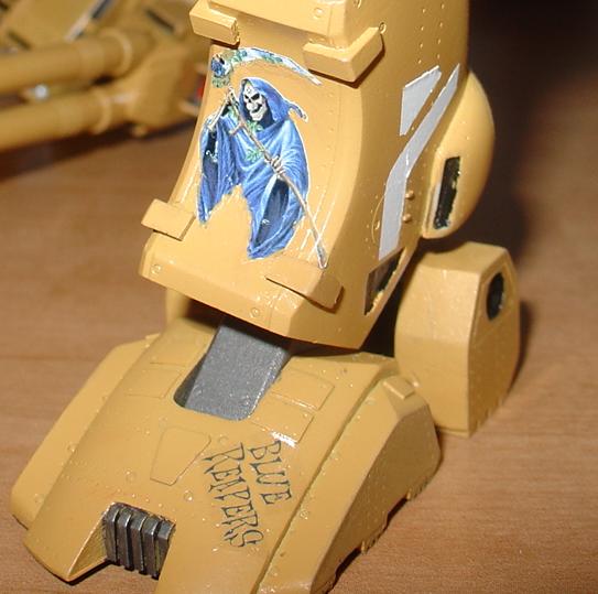

Ranger565 Posted October 17, 2008 Posted October 17, 2008 Does anyone here know of something we could do to get some instrument panels printed up? I mean, there's no way to paint one like this--there aren't even any gauges molded on to drybrush or anything, it's just a bunch of green flat-panel displays in the anime. And bandai just gave us a featureless grey slab. Here's the best pic I could find of a "normal" VF-25 instrument display: Dude you can so make your own with that picture. All you need to do is print it out on a white decal paper. Serious. Just scale it to your size. White Decal paper works best when using Colors and its not an Irregular shape. Thats a square shape and you dont have to cut around. Here is a custom Decal I made for Johns Destroid Defender. Granted its more complex and I had to cut around the Blue Reaper to make it right. But It worked. Remember Yours is Square Quote
