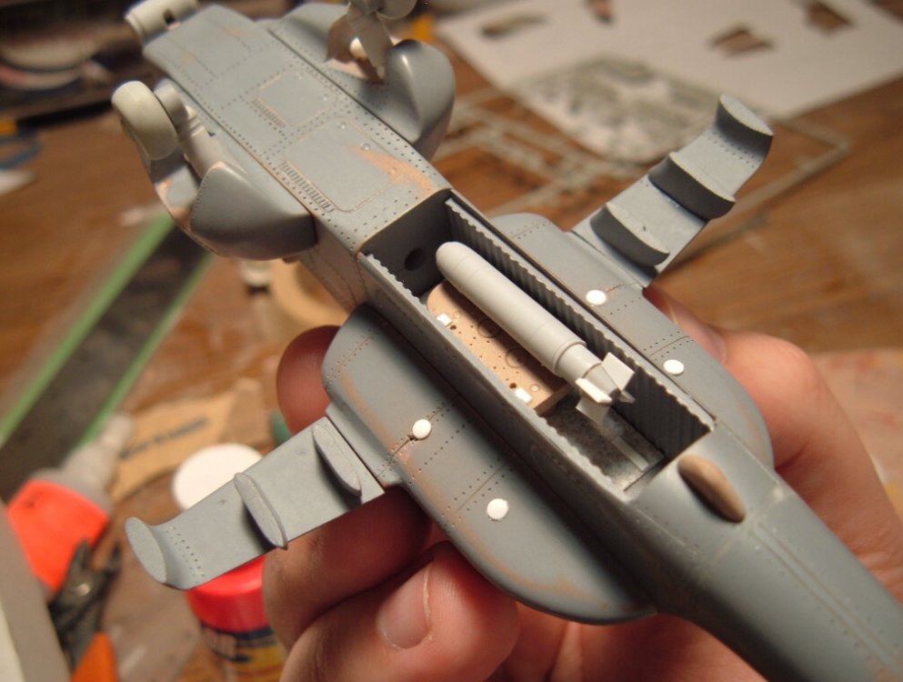

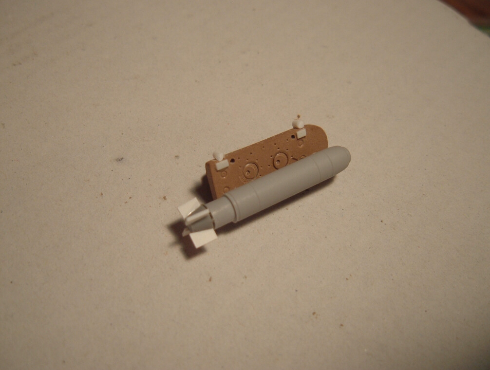

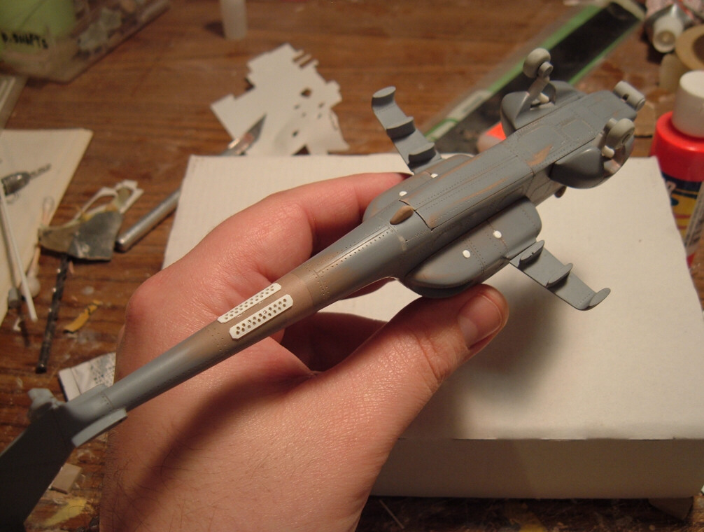

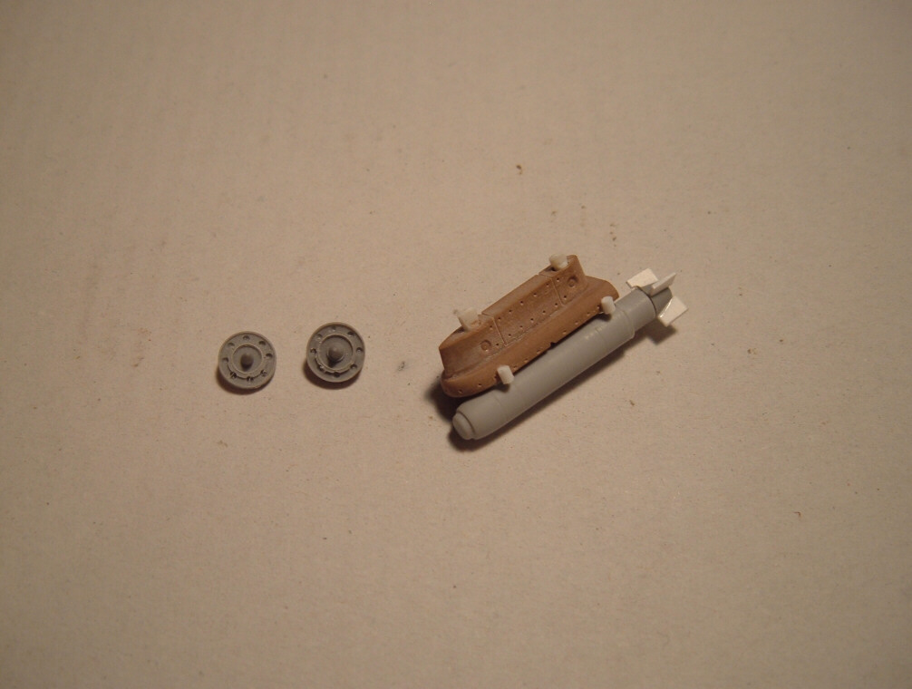

captain america Posted November 8, 2008 Author Posted November 8, 2008 (edited) ...And as promised, here are the 99% finished master patterns of the Commanchero. Kindly take notice that dainty components like rocket pods, wings, etc. Have all been temporarily glued with hot glue. They will fit together infinitely better when proper glue is used. The first couple pics are of the "Macross Universe" style iron bomb (thee will be 2 in the kit) and the pylon that fits inside the ventral weapons bay. The 3rd and 4th pics are of the ventral bay itself--one open with the bomb/pylon, the other closed. I invisioned this weapons bay to be truly multi-functional. I just happened to choose to outfit it with two iron bombs, but I could also forsee it being able to accomodate a magazine-style container with a automatic loading mechanism to supply rockets to the port-side launcher, though I elected not to use the latter option at this particular time. Oh. You will notice that there are four small "circle-type" shapes on the underside of the engine housings. I added these so that there could be future "upgrades" to the Commanchero... Like optional armored external fuel tanks for long range missons Edited November 8, 2008 by captain america Quote

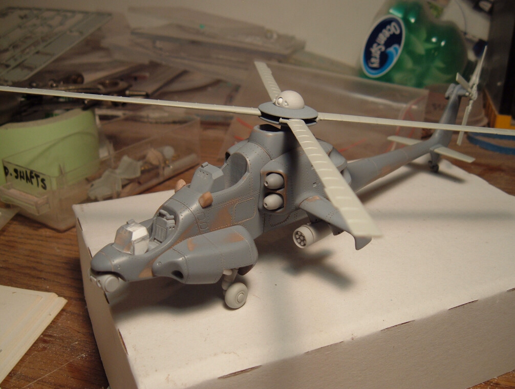

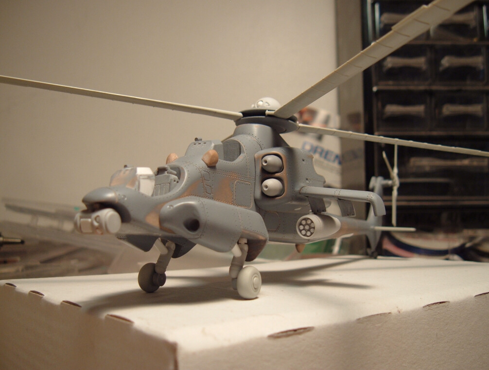

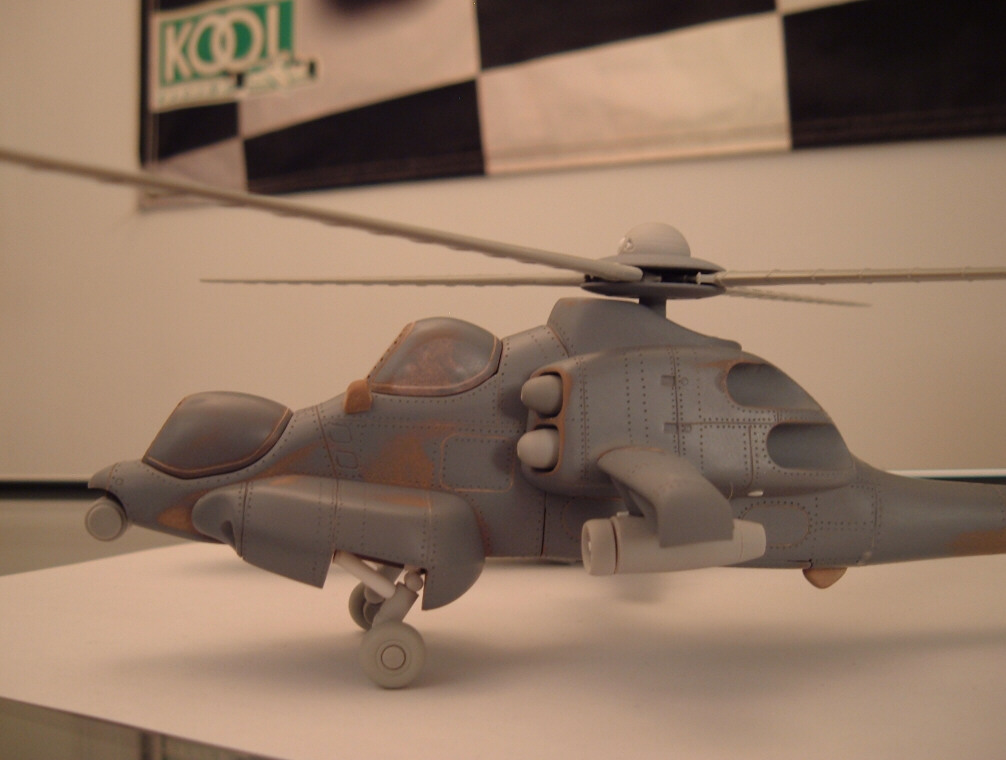

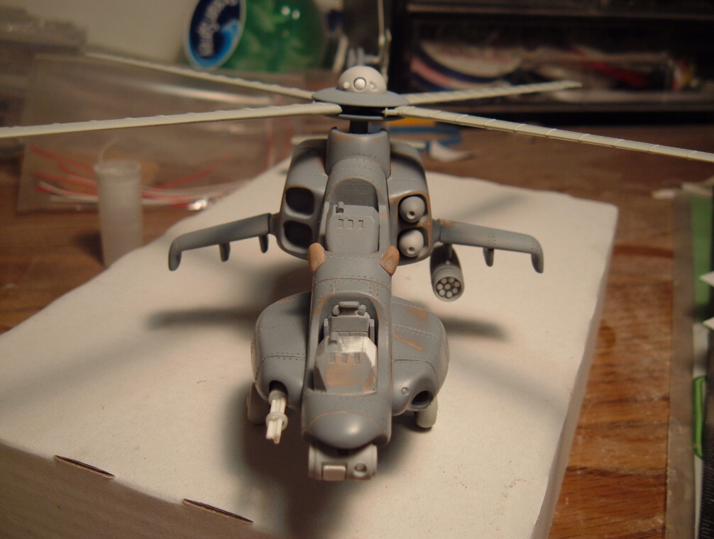

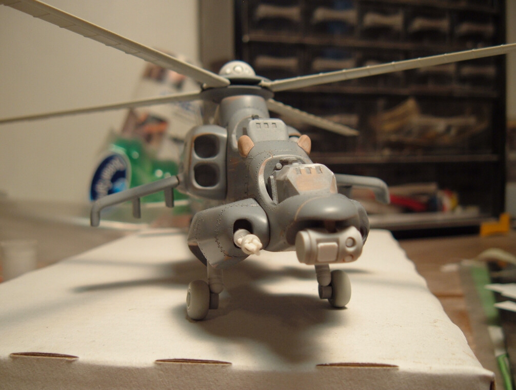

captain america Posted November 8, 2008 Author Posted November 8, 2008 Next, the standard beauty-shots of the whirly-bird with the cockpit details. I really didn't expect it to turn out quite this nice, but I'm glad it did. It truly is a fearsome looking chopper, especially from the front. There will be, of course, six of the underwing rocket pods included with the kit, though the rockets themselves will not be removeable due to their small size and the problems associated with casting them.Can very easily be remedied with a pin-vise if you want the empty look though. Quote

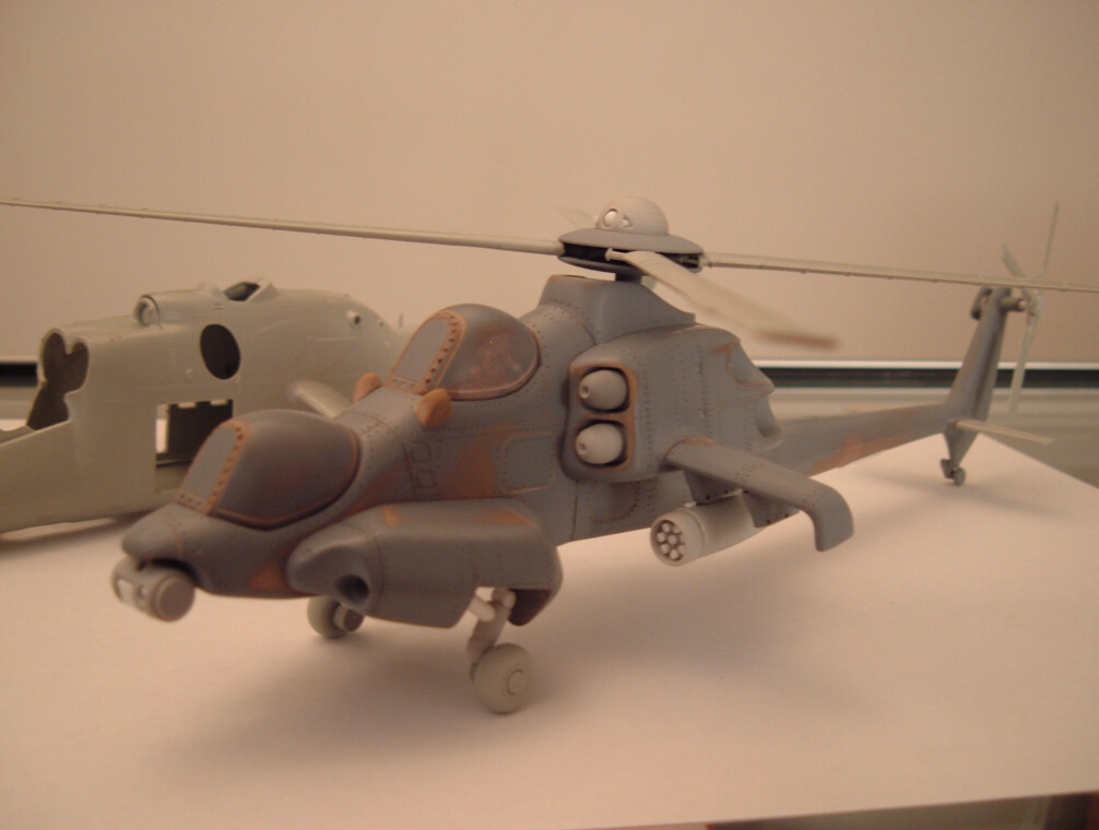

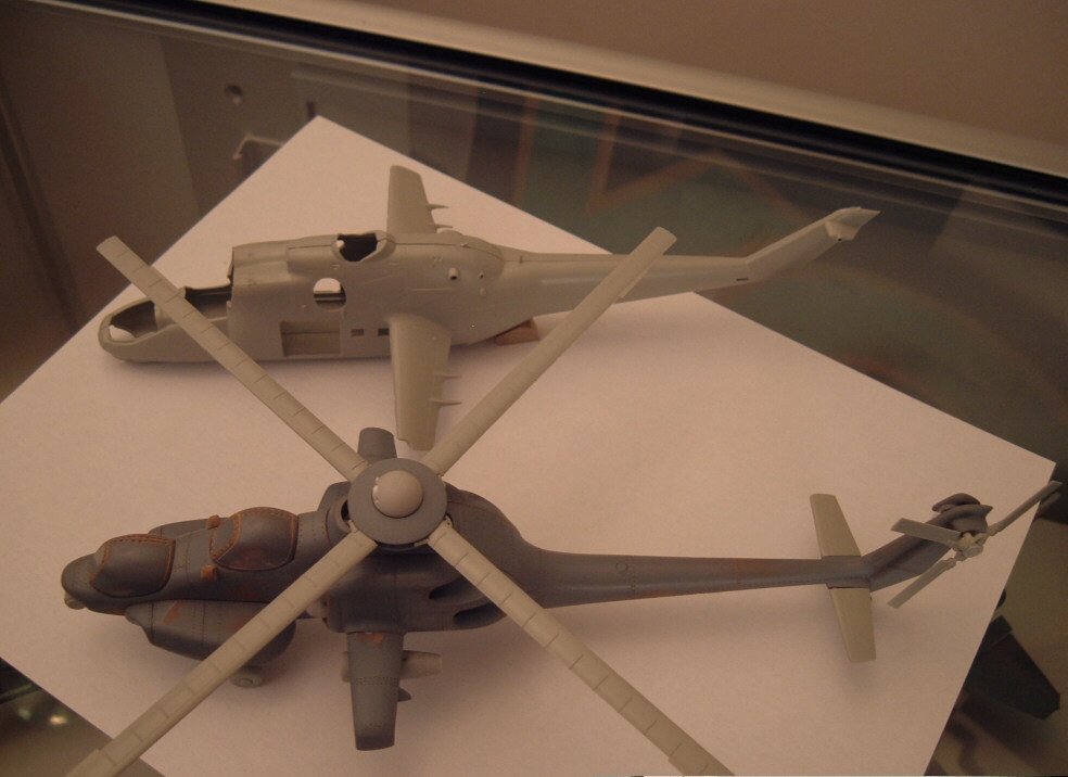

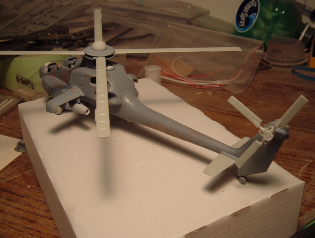

captain america Posted November 8, 2008 Author Posted November 8, 2008 Next is a pic of the "special olympics" tail rotor. She will actually have four blades, nut the MI-24 I took them from only had three blades, so I had to searate them all, machine a new hub, and the fourth blade will be a duplicate casting. The next couple of pics are of the Commanchero next to the hull of a 1/72 Hind. The Commanchero is only slightly shorter in length, but has the same "presence" as its real-world commie counterpart. The landing gear bay doors were intentionally left ff for the pics, as they are 90% putty and therefore very suceptible to breaking. They will be molded in short order so as to make sure I can have some good, solid resin masters. An unfortunate side-effect of certain detailed parts is that the molding process does sometimes destroy them, so I have to make sure my molds are perfect so that they can provide me with usable masters. Anyhoo, that's what she looks like. I will be posting early next week with payment info, though I will give you all advance notice that there may be a bit of a delay due to the vac-forming of the canopies, but shouldn't be anything drastic. Enjoy the pics Quote
PetarB Posted November 8, 2008 Posted November 8, 2008 Wow, you really knocked this one out of the park. Suddenly all the detailing makes it look like a real chopper. Amazing stuff! I think the rear boom looks a bit too long for my tastes, but that's a design issue. Anyway, thanks for the pics and looking forwards to grabbing one! Quote

007-vf1 Posted November 9, 2008 Posted November 9, 2008 Now I realize that I won't like the Comanchero posing landed on its wheels. This model is meant to be displayed flying on air ( my personal opinion). What i like most is that as a simple design and little screen time it has on the tv series; your build looks as daunting and menacing as the hellhound.. It will be a treat seeing it with all the missiles add-ons... Quote
captain america Posted November 10, 2008 Author Posted November 10, 2008 007-vf1 said: Now I realize that I won't like the Comanchero posing landed on its wheels. This model is meant to be displayed flying on air ( my personal opinion). What i like most is that as a simple design and little screen time it has on the tv series; your build looks as daunting and menacing as the hellhound.. It will be a treat seeing it with all the missiles add-ons... Yeah, I know exactly how you feel. If anything, I wonder how well a real-world Commanchero (hereinafter Turbo Airwolf Junior LOL) would fare with its wheels (front to rear) spaced so far apart; I'd tend to think it would put a lot of unnecessary stress on the fuselage, but hey, I didn't design it, my job is just to make it look believeable Quote

captain america Posted November 11, 2008 Author Posted November 11, 2008 cool8or said: That Comanchero looks incredible!! How will yo do to avoid folding in propellers? Folding? I think maybe you mean sagging? I will use either a brass or acrylic rod insert in the main propeller blades, so they will not sag over time. Quote
MechTech Posted November 11, 2008 Posted November 11, 2008 Absolutely top notch work John! I'll have to build it, put it on my desk and see how many people ask about the design Getting money ready... - MT Quote
Valkyrie Posted November 11, 2008 Posted November 11, 2008 captain america said: Folding? I think maybe you mean sagging? I will use either a brass or acrylic rod insert in the main propeller blades, so they will not sag over time. Carbon Fiber rods are the way to go. They're more resilient, and they'll bond with the resin better. Quote
