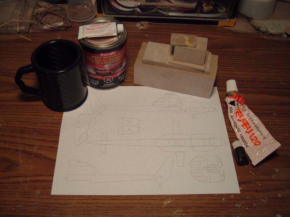

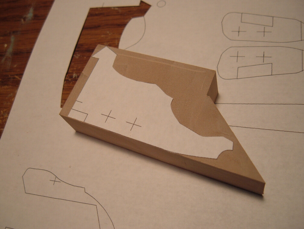

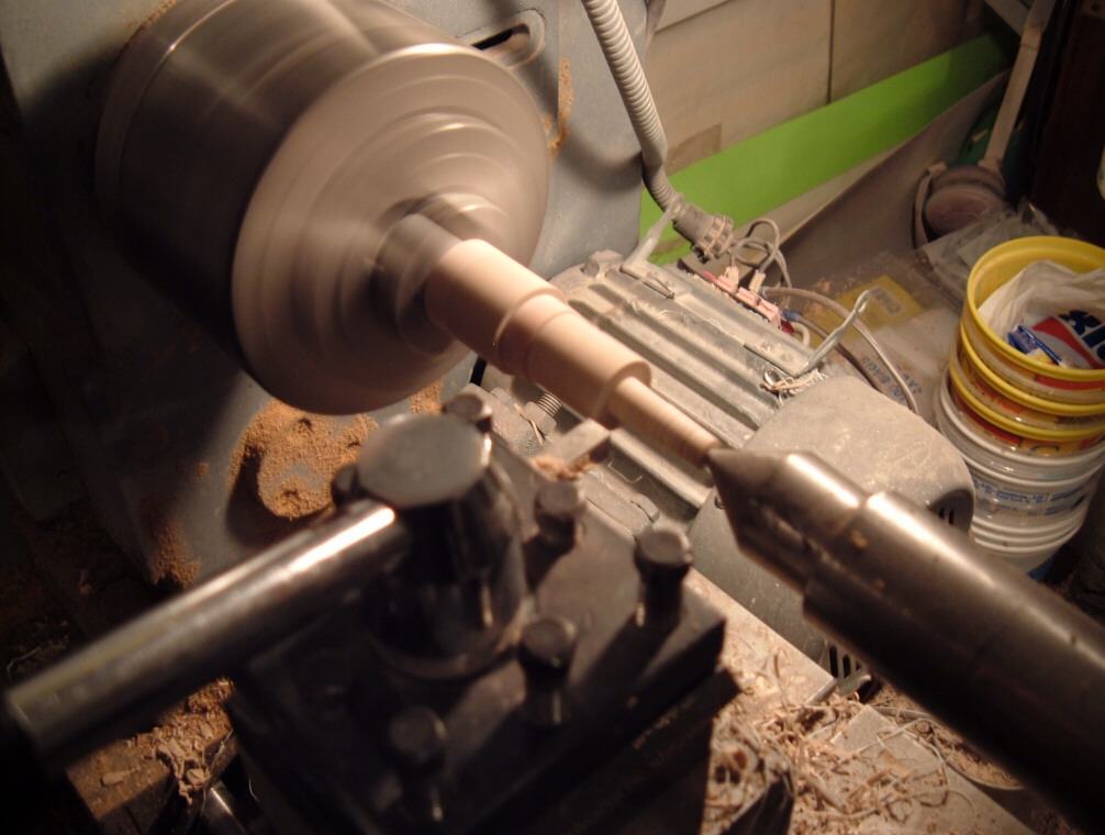

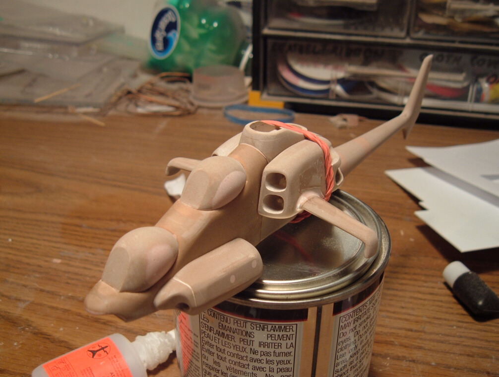

captain america Posted October 18, 2008 Author Posted October 18, 2008 Guess what? Time for a build progress report! As per my previous projects, this one started by sitting with books to study lineart, followed by approximately a day and a half in front of the computer in order to draft diagrams based on that lineart. Once those are rendered to the point where I feel comfortable, I print them out and get onto the fun stuff. Fun stuff generally consists of getting all my materials together, which you can see in the 1st pic below: the usual suspects are there, as well as the unsung workhorse in my arsenal: my coffee cup. 2nd pic: the diagrams I made and printed are now cut and placed onto slabs of modelling board for cutting. THis is a simple, but very effective way of keeping track of the most important dimensions on a part. 3rd pic: depending on the shape in question, I will either start trimming it on the bandsaw, as seen in this photo, or sometimes directly on the milling machine. Quote

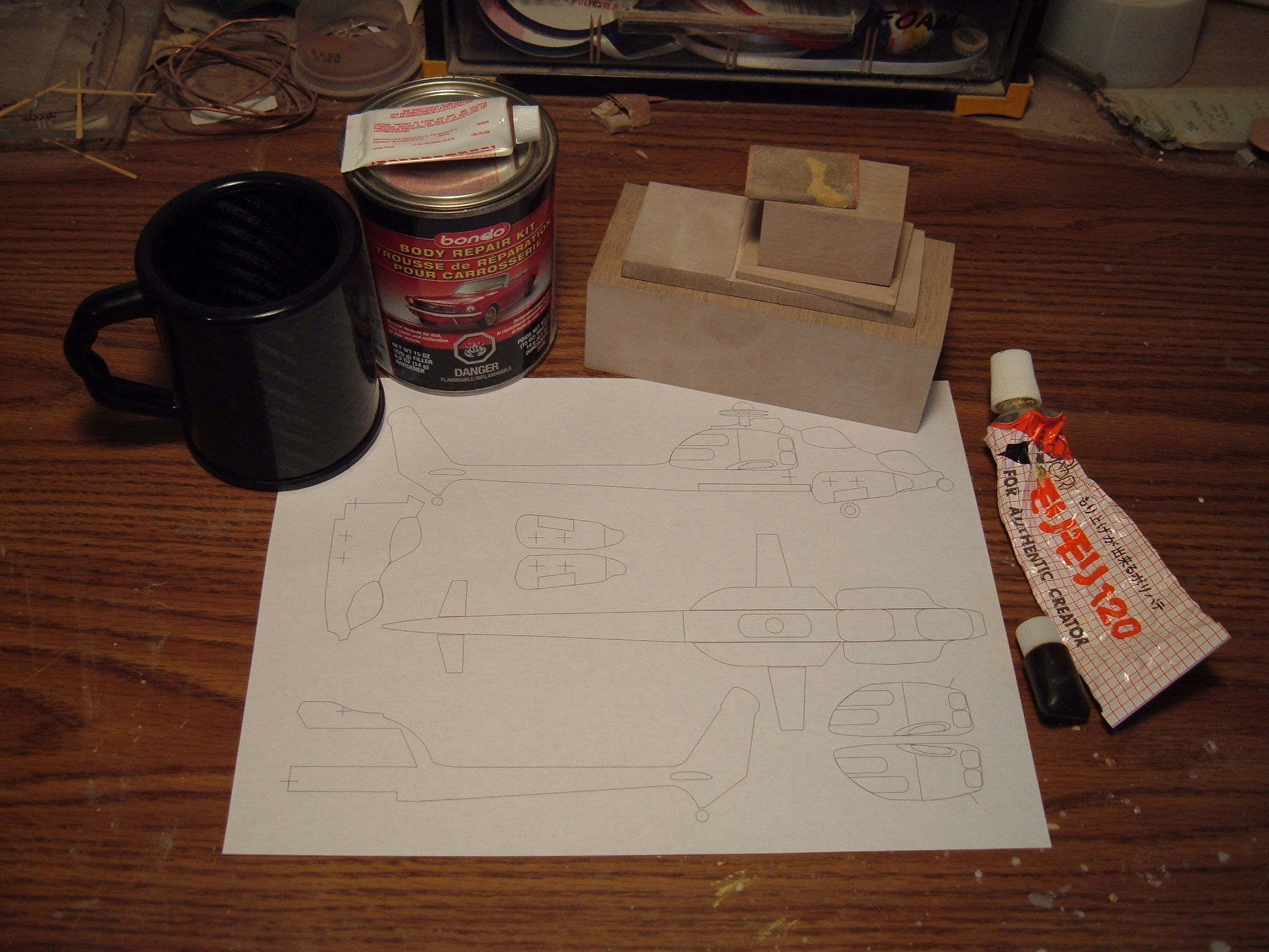

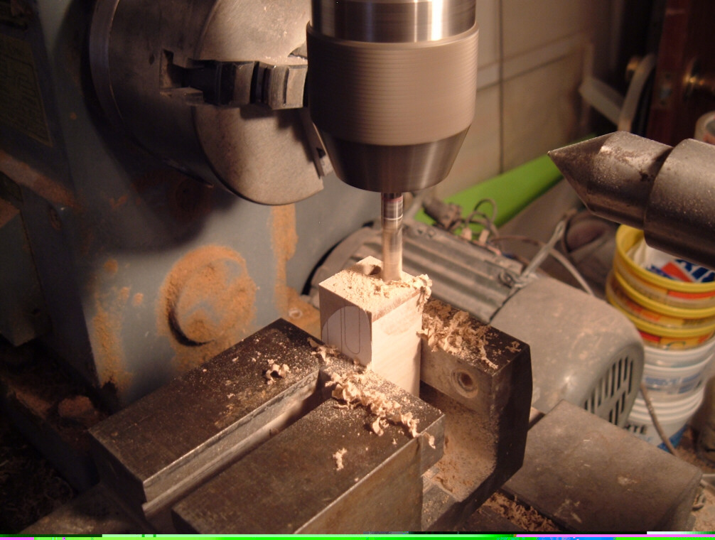

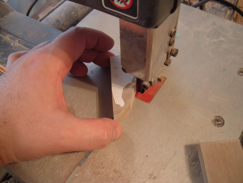

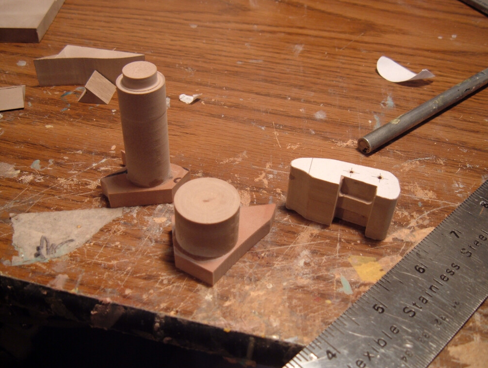

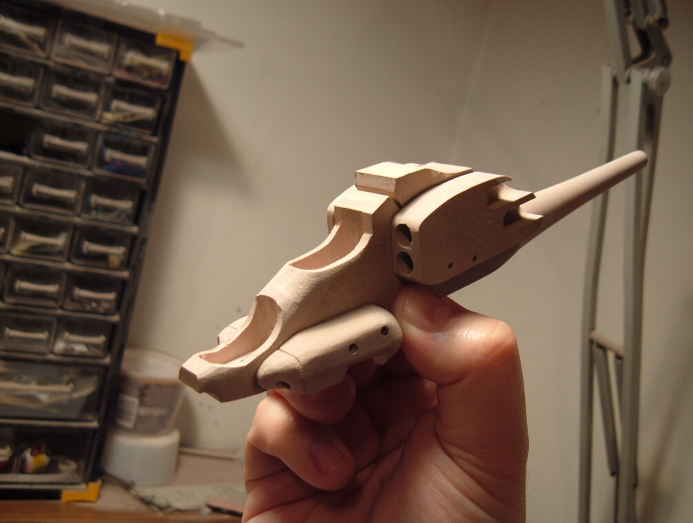

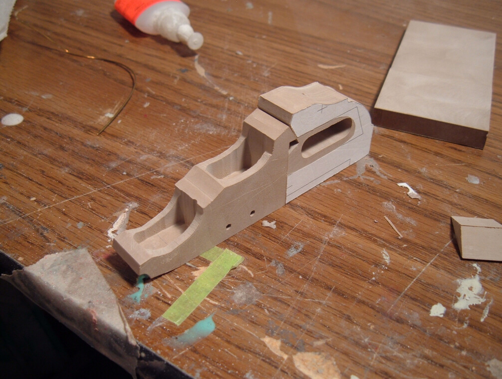

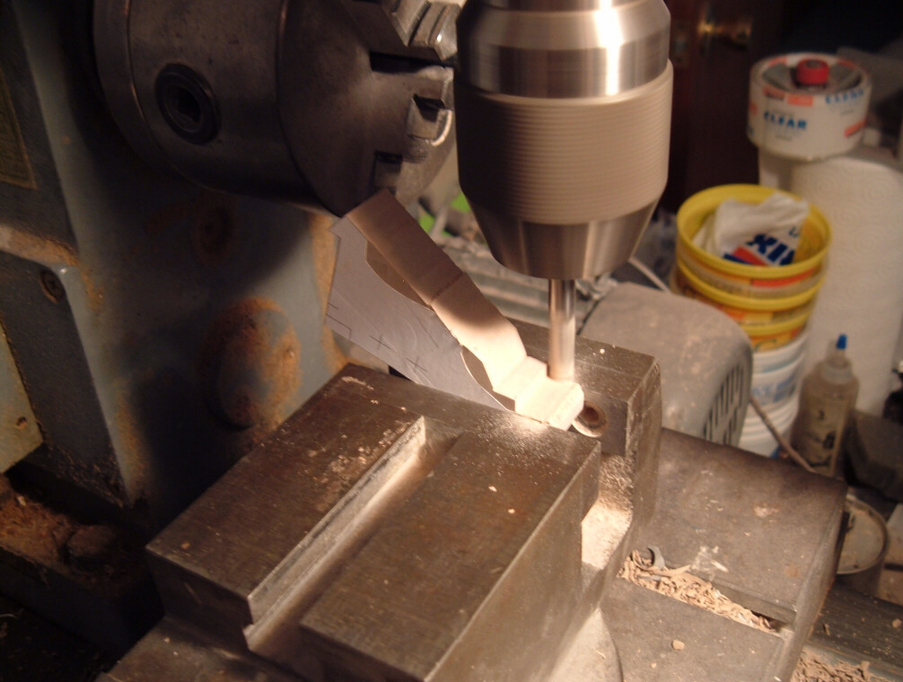

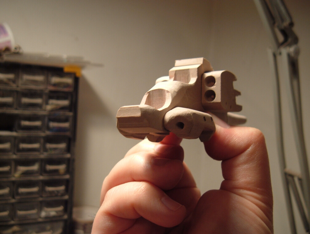

captain america Posted October 18, 2008 Author Posted October 18, 2008 Update continued. Pic 4. Speaking of milling machine, here we can see it in action, as I'm refining the foreward fuselage part. There is also, despite me not photographing it, lots of work done with a Dremel and sanding blocks/files to a given component. Pic 5: here I'm using some scrap modelling moard that came off the lathe, and combined them with other scraps I had laying around. The first two pieces from the left will be combined to form the Commanchero's tail boom, while the part on the right wil be used to create the weapons pods. Pic 6: Finally, after several hours, the main fuselage is starting to take shape. There are a few small milling mistakes that will have to be fixed with putty before proceeding, but no big deal. Quote
captain america Posted October 18, 2008 Author Posted October 18, 2008 Update continued. Pic 7: here we see more milling. This time for the aft fuselage. For what it's worth, the composite material that makes up the modeling board is very hard on my toold, which will need to be sharpened shortly. Pic 8: the round shapes seen in pic 5 have now all been glued together and placed on the lathe. Owing to the fact that the part in question is long and spindly, the dead center was used to keep the part stable as it's being cut. Pic 9 & 10: This is what I have to show after about 2+ days of work. The parts are still quite crude, but it's now starting to look like a helicopter. As per my usual methods, I should have another update about this time next week, so stay tuned Quote

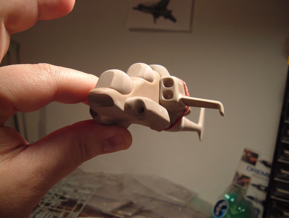

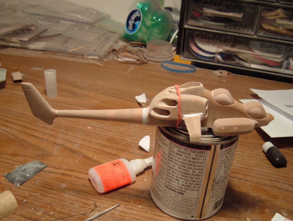

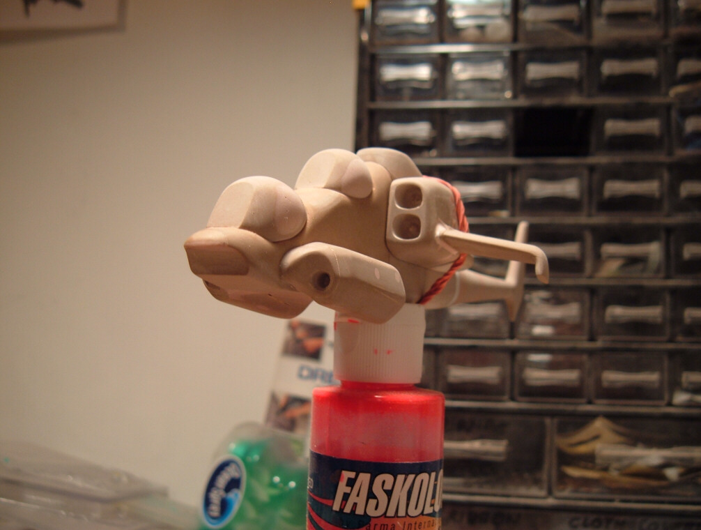

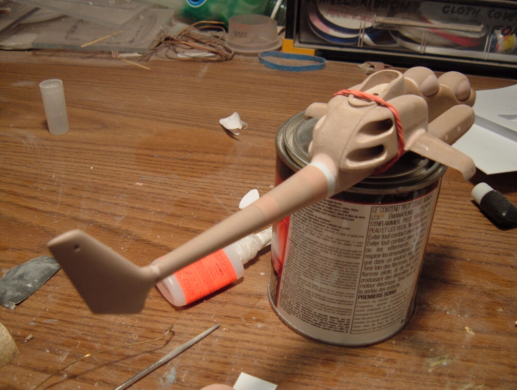

PetarB Posted October 19, 2008 Posted October 19, 2008 Pic 9 & 10: This is what I have to show after about 2+ days of work. The parts are still quite crude, but it's now starting to look like a helicopter. Fantastic work, John. I can just about hear the 'Whoooooooosh' sound you made as you held the fuselage between your fingers and whizzed it around the room.... Quote

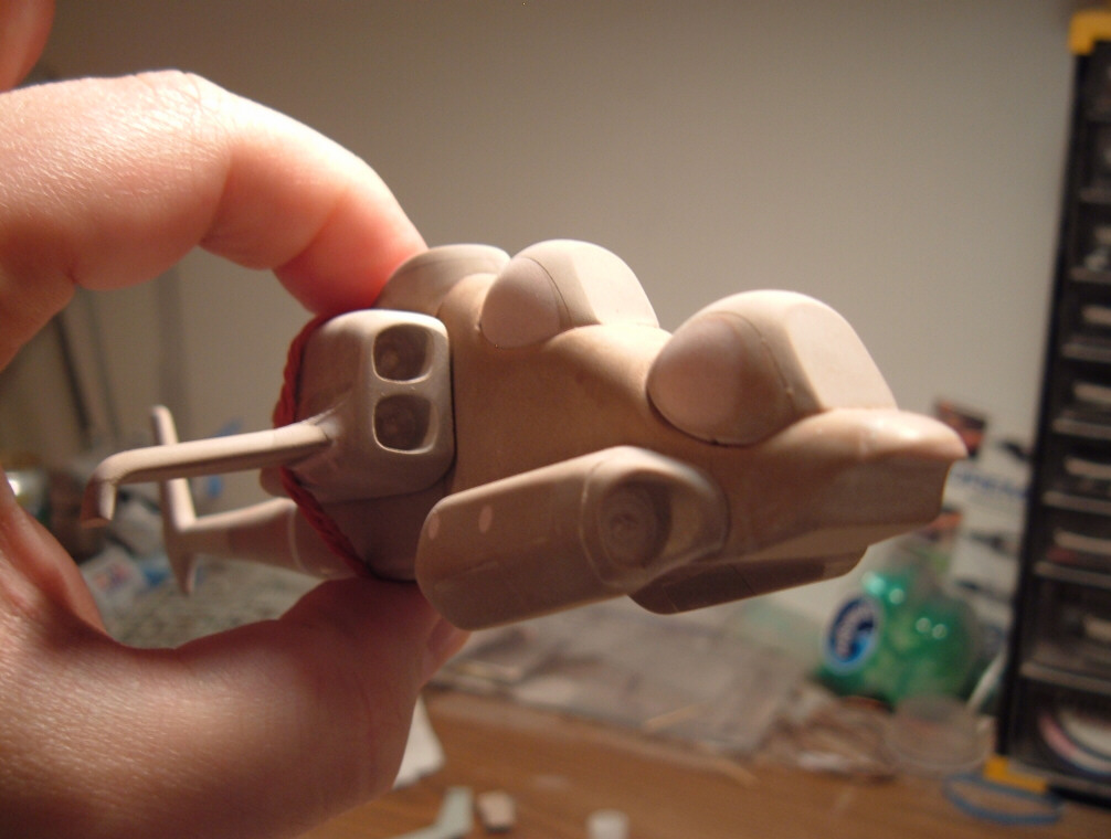

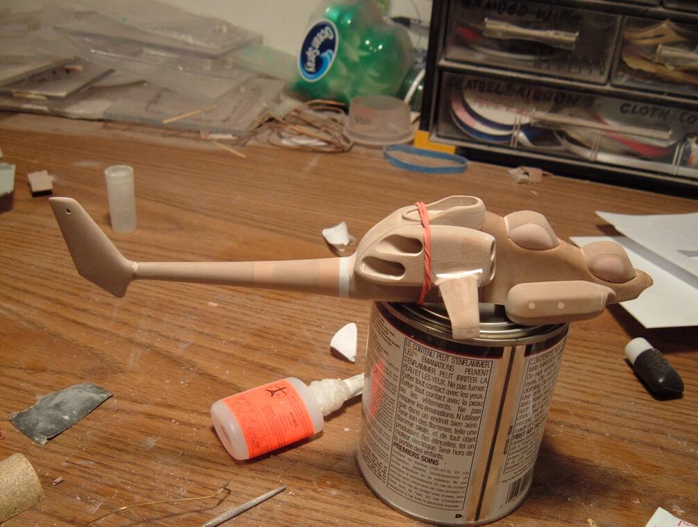

captain america Posted October 27, 2008 Author Posted October 27, 2008 Ask... And ye shall receive! My foremost apologies for the delayed update; had some emmergency matters that needed my attention. As a result, this'll only be a partial update since I wasn't able to do as much work on the Commanchero as I would have liked. Anyhoo, here are some pics of the chopper as it looked last Friday; a little bit of refining was done to get the shapes looking more like their line-art counterpart. I retained the "bubble canopy" look seen in the frontal view, though this may be rather problematic to vac-for... Anyone interested in doing the canopies as a subcontractor? Quote
captain america Posted October 27, 2008 Author Posted October 27, 2008 Three more pics. Oh, I also narrowed the center fuselage an extra 1mm since the last update. In spite of that, the fuselage doesn't look flimsy at all; quite an impressive sight actually... Quote

PetarB Posted October 27, 2008 Posted October 27, 2008 Hi John, that simply looks awesome. In my opinion you could get away with reducing the width of the 'bubble' in the canopies if it caused too much of an issue with the vac-forming. Once again, my commendations, this is a beautiful sculpt, especially considering the conflicting lineart issues you've had to deal with so far. Quote
