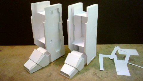

Maiden Japan Posted January 29, 2009 Posted January 29, 2009 I am scratch building a 24 inch Optimus Prime made out of styrene sheets.

edwin3060 Posted January 30, 2009 Posted January 30, 2009 I am scratch building a 24 inch Optimus Prime made out of styrene sheets. Sounds great! Will he be transformable?

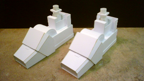

Maiden Japan Posted January 30, 2009 Posted January 30, 2009 You'll see. Here's a progress. I am planning to enter this to this year's Botcon.

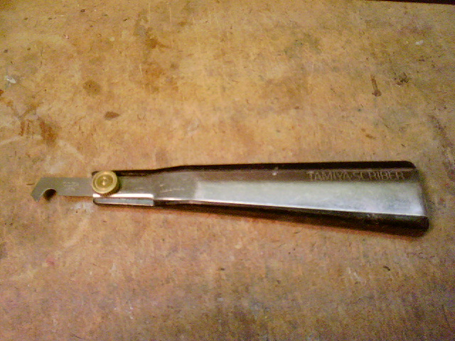

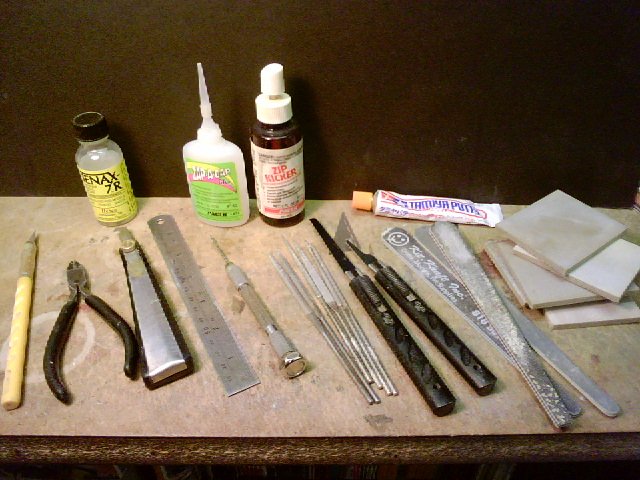

miriya Posted January 31, 2009 Posted January 31, 2009 What tool is best for cutting styrene sheets? Especially the thick ones? I have been running my panel liner over and over but it is a drag. The exacto does not work well on the thick stuff.
VF-19 Posted January 31, 2009 Posted January 31, 2009 I like to score the plastic sheet and then snap it off. But, a hacksaw would also work well too.
MechTech Posted January 31, 2009 Posted January 31, 2009 Maiden Japan, that looks great and like it will be HUGE! Miriya, running a scribing tool (several times) is really about it unless you saw or machine excess away. Scribe at least half the thickness and bend it to break it off. You can score more shallow, but the accuracy of your cut decreases. Yes, then you have to clean up the edges, but that's life! On the positive side, a Fiskars rolling cutter IS the BOMB for thinner plastic like .020" - -perfect for strip cutting too. NO raised edges, just cut and glue! - MT

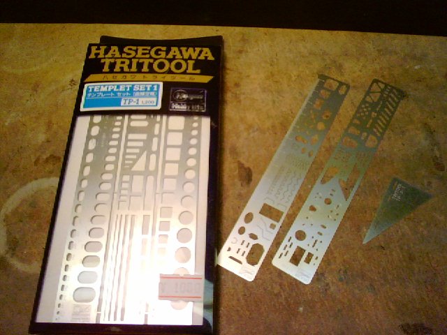

Maiden Japan Posted January 31, 2009 Posted January 31, 2009 Let me show you guys some of the tools I'm using. To cut the styrene sheet use exacto blade, cut about halfway deep then carefully bend the sheet in half. you can also use small hobby saw by Tamiya. To make the panel lines I use this plastis scriber by Tamiya, and etching saw by Hasegawa ( the small triange piece) Those square things that stacked are sanding sponges. They are perfect sanding on rounded surface.

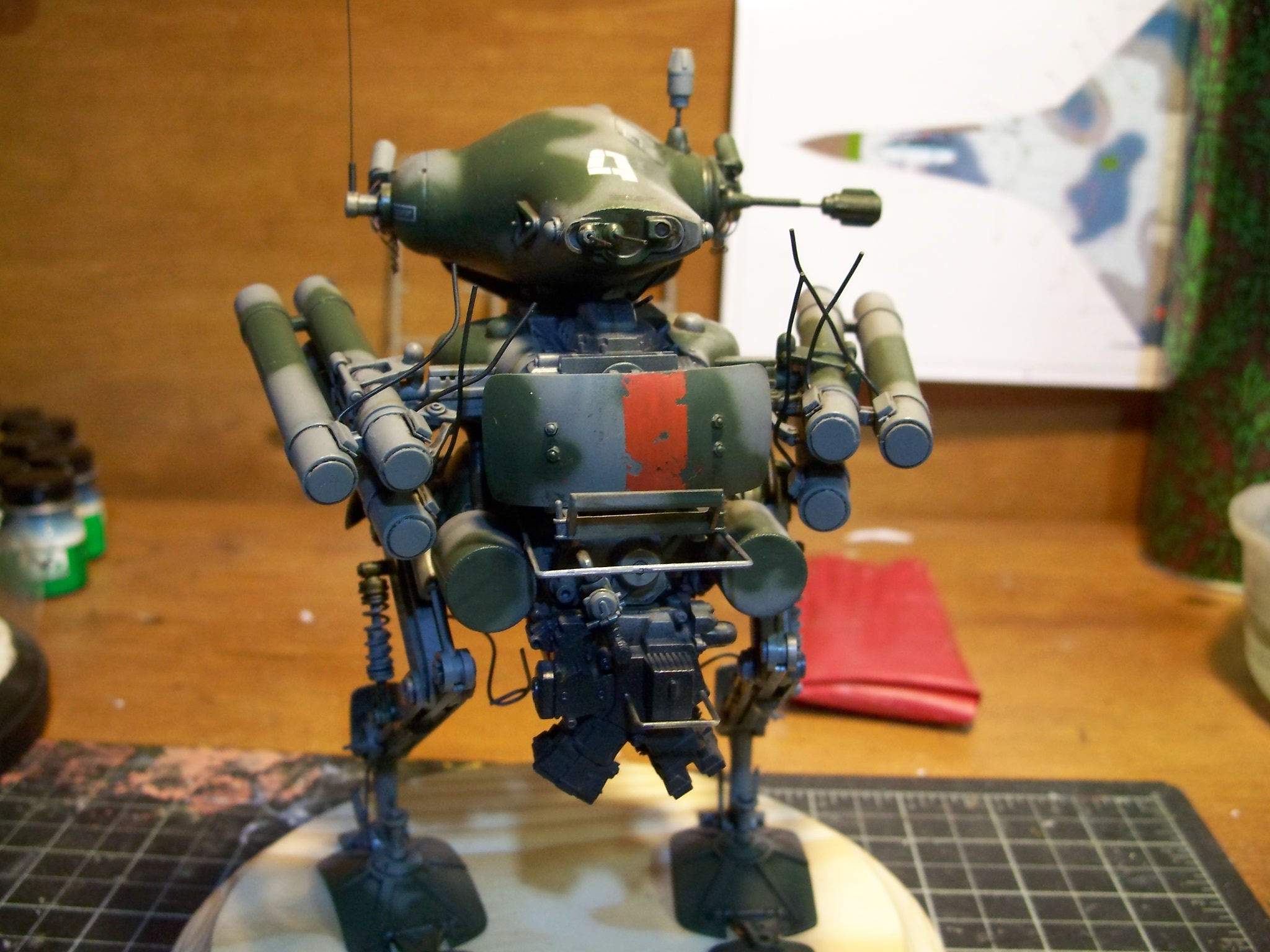

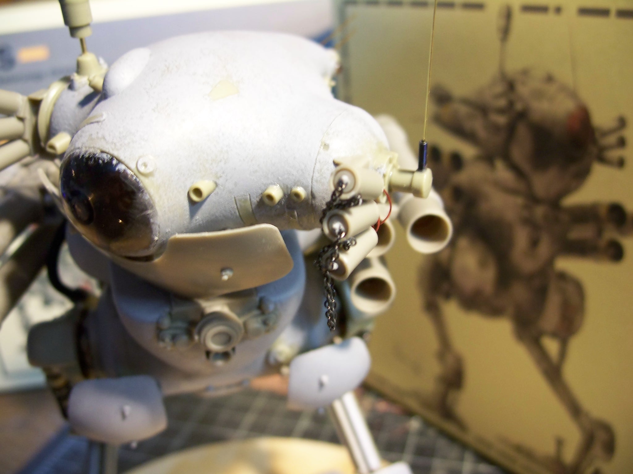

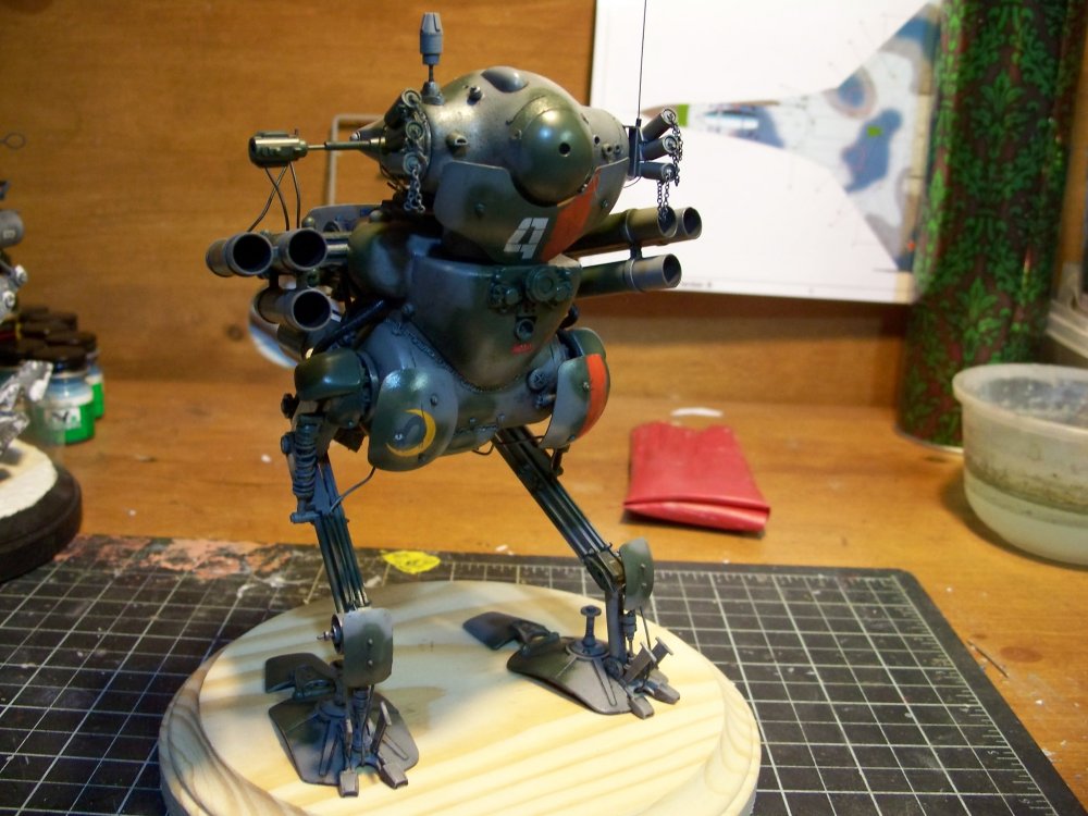

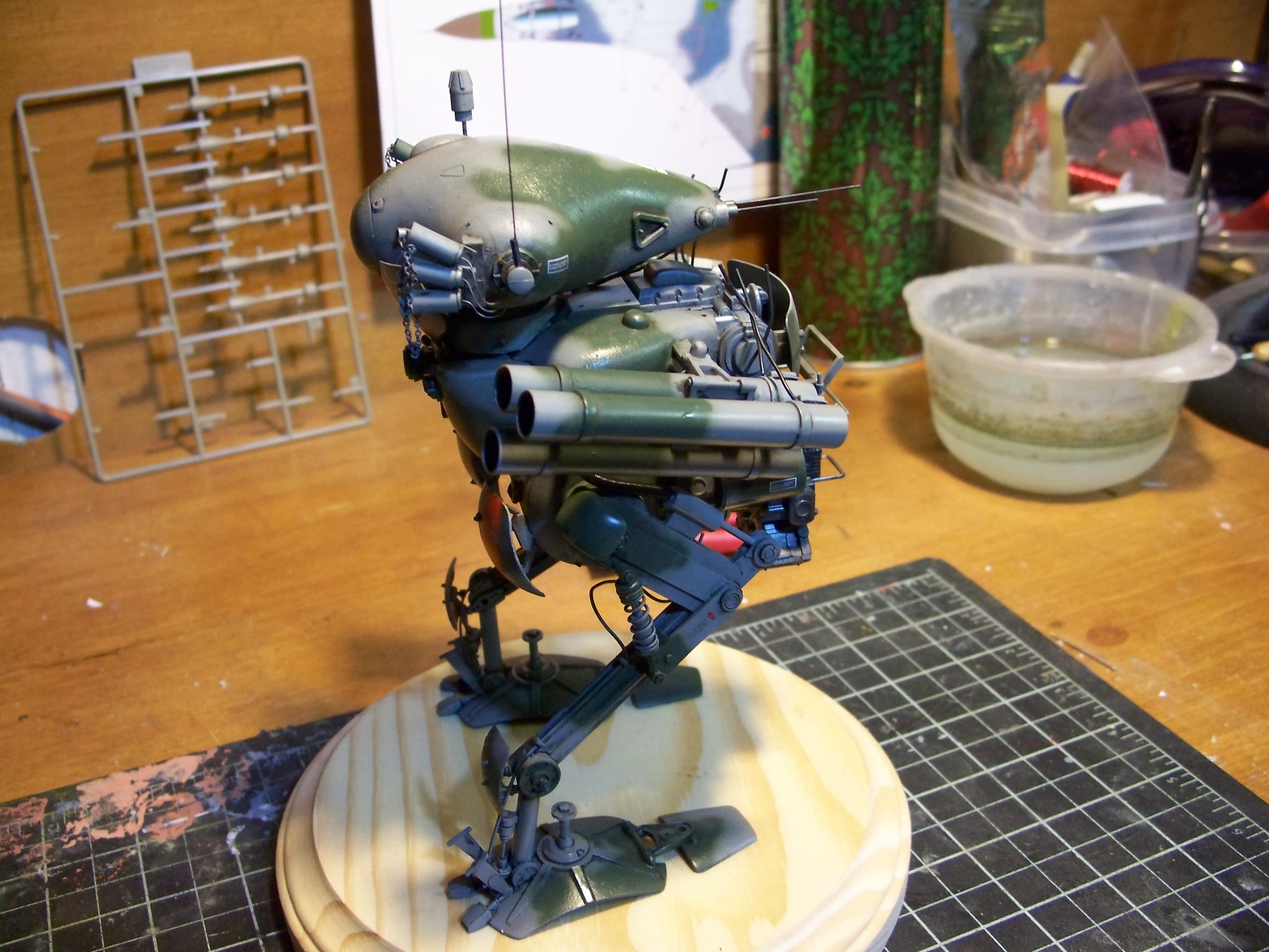

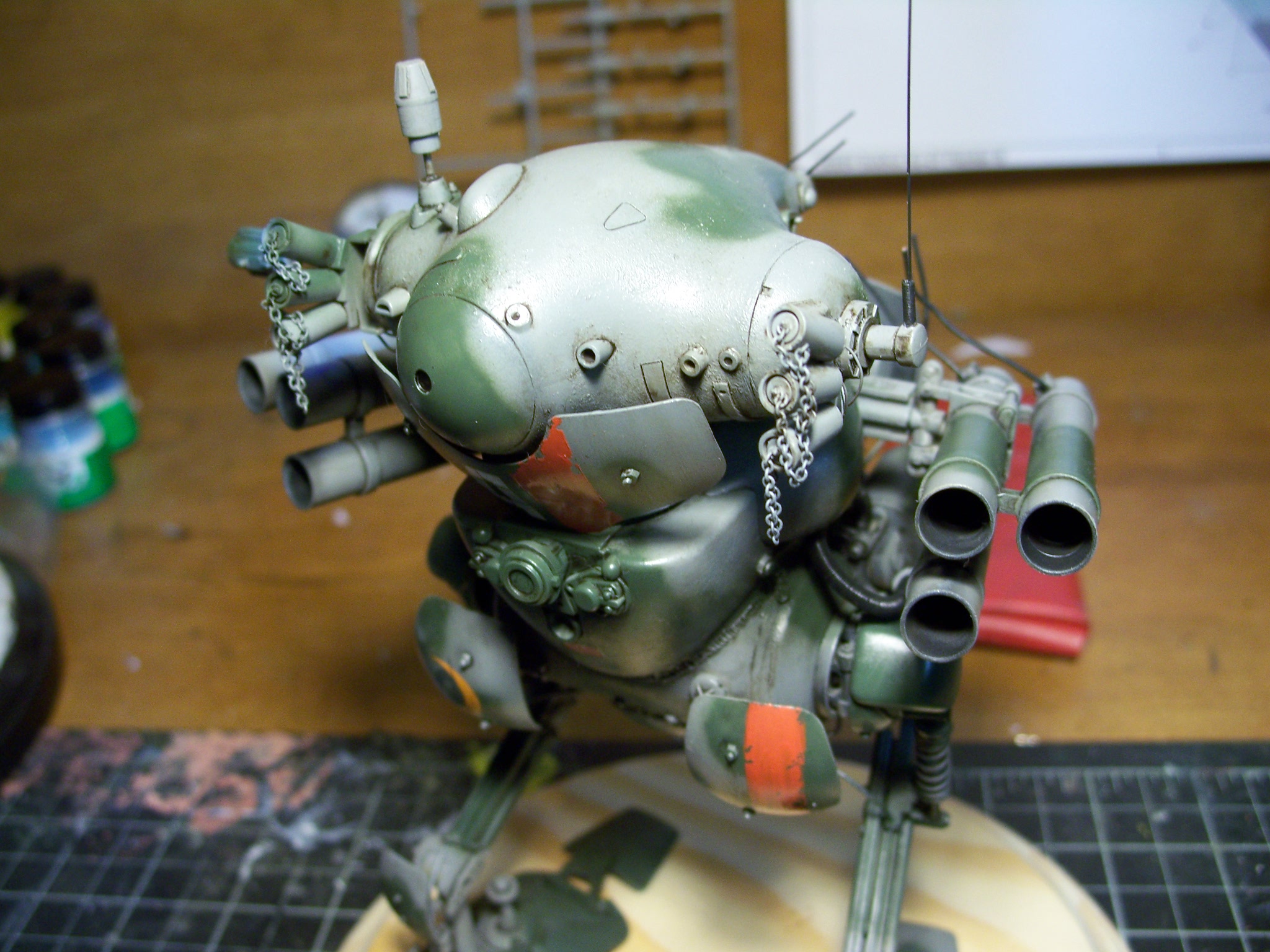

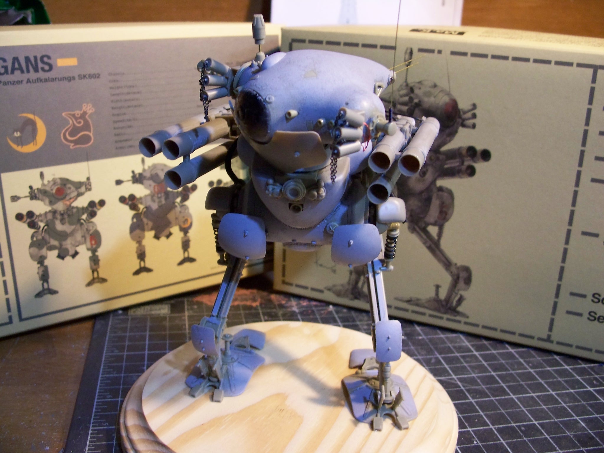

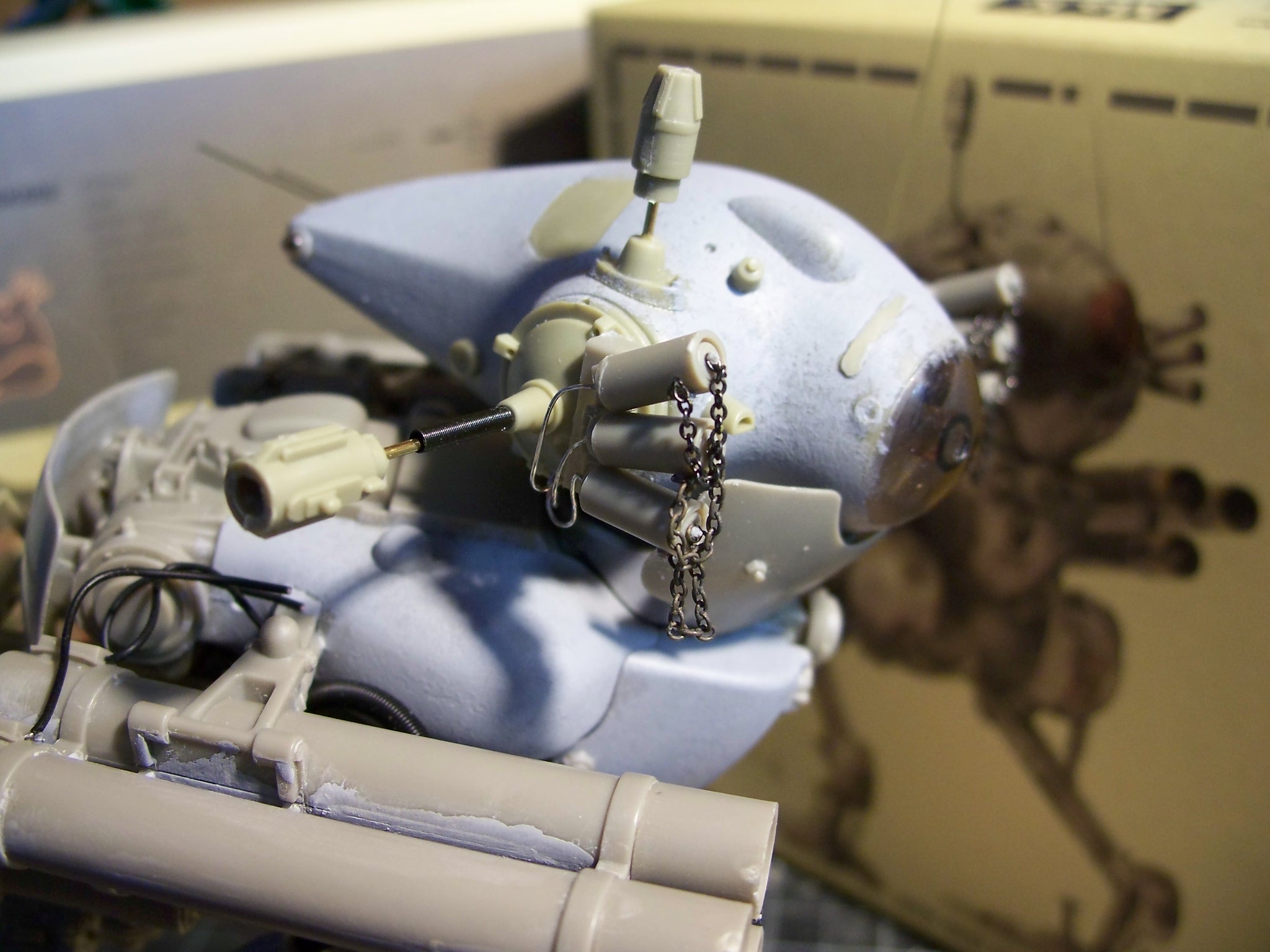

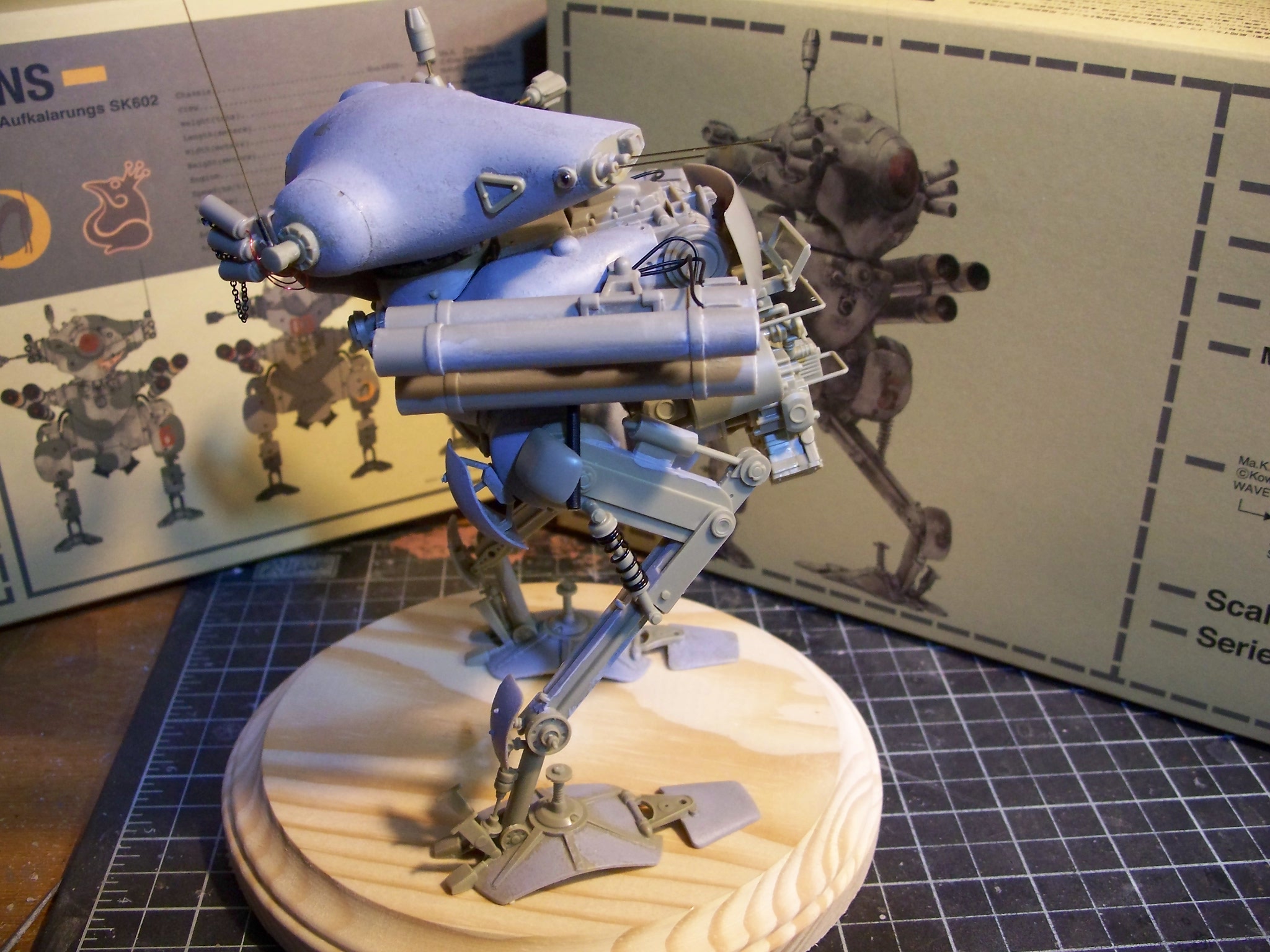

Vile Posted February 1, 2009 Posted February 1, 2009 That's a nice looking goose you've got there! Are all those metal bits scratch parts or do they come with the kit? I often look longingly at at Ma.K. kits in model shops, but I can't really justify the cost when i have a wardrobe full of unbuilt models at home ...
HWR MKII Posted February 1, 2009 Author Posted February 1, 2009 Aside from the chains on the smoke dischargers and the wire leads for them, everything else came in the kit.

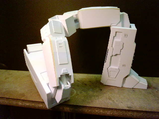

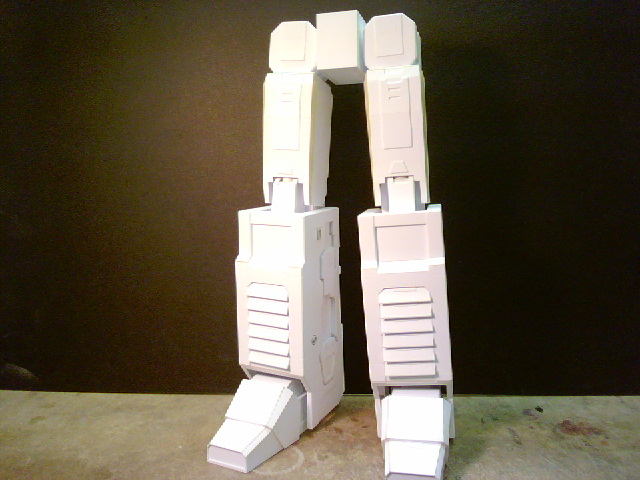

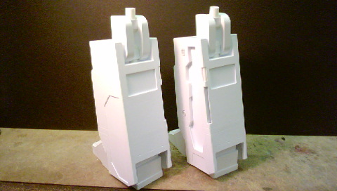

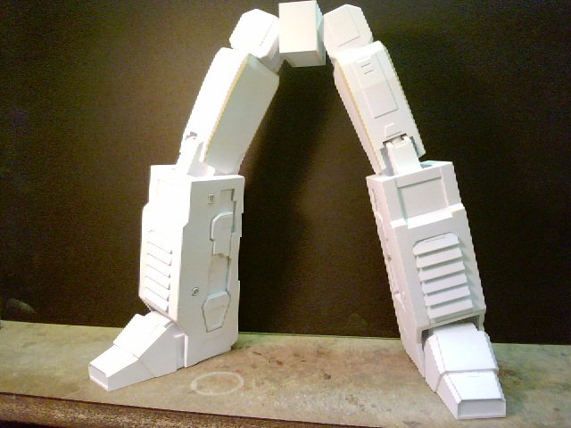

Maiden Japan Posted February 2, 2009 Posted February 2, 2009 Update on 24 inch Optimus Prime project. Adding knee joints and detail on legs.

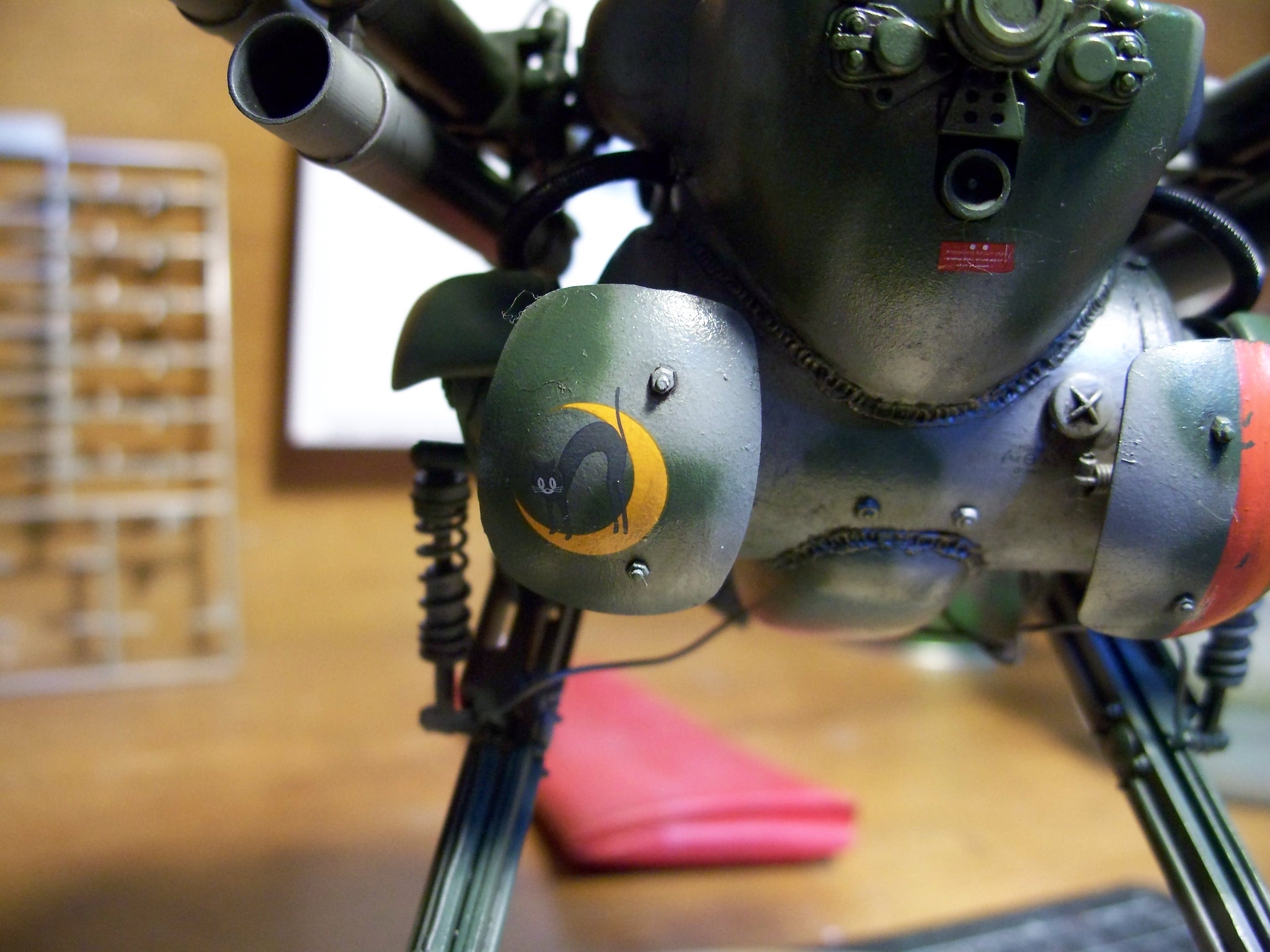

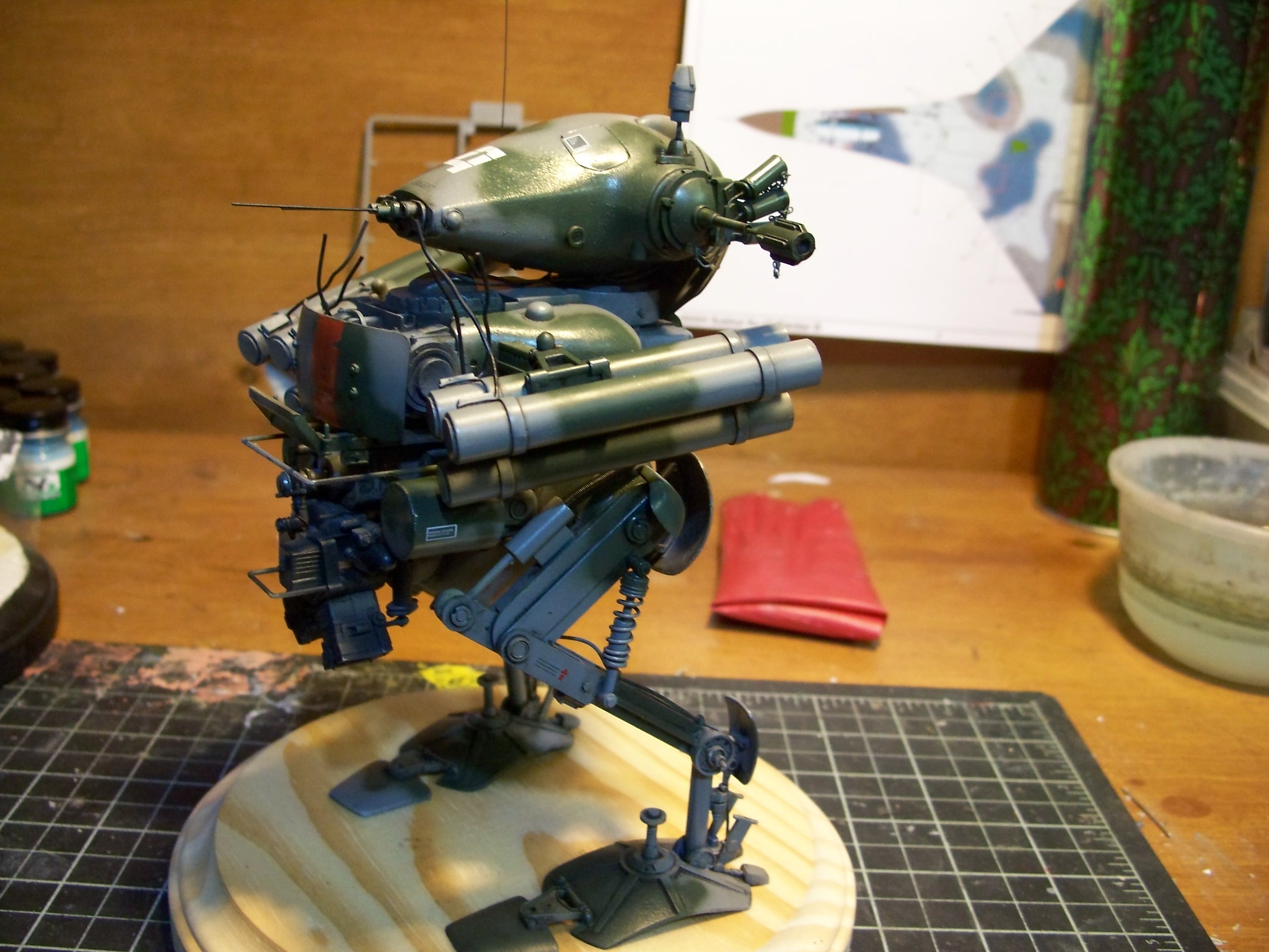

promethuem5 Posted February 2, 2009 Posted February 2, 2009 Looks fantastic HWR.. did you use masking for the chipped stripes? They're spot on. I'm always amazed at how much multi-media goodness comes in a MaK kit... gonna have to get my hands on one someday. Are the wires on the smoke launchers(?) going to connect to something when it's done?
edwin3060 Posted February 2, 2009 Posted February 2, 2009 That's just amazing! The detail on it is superb.

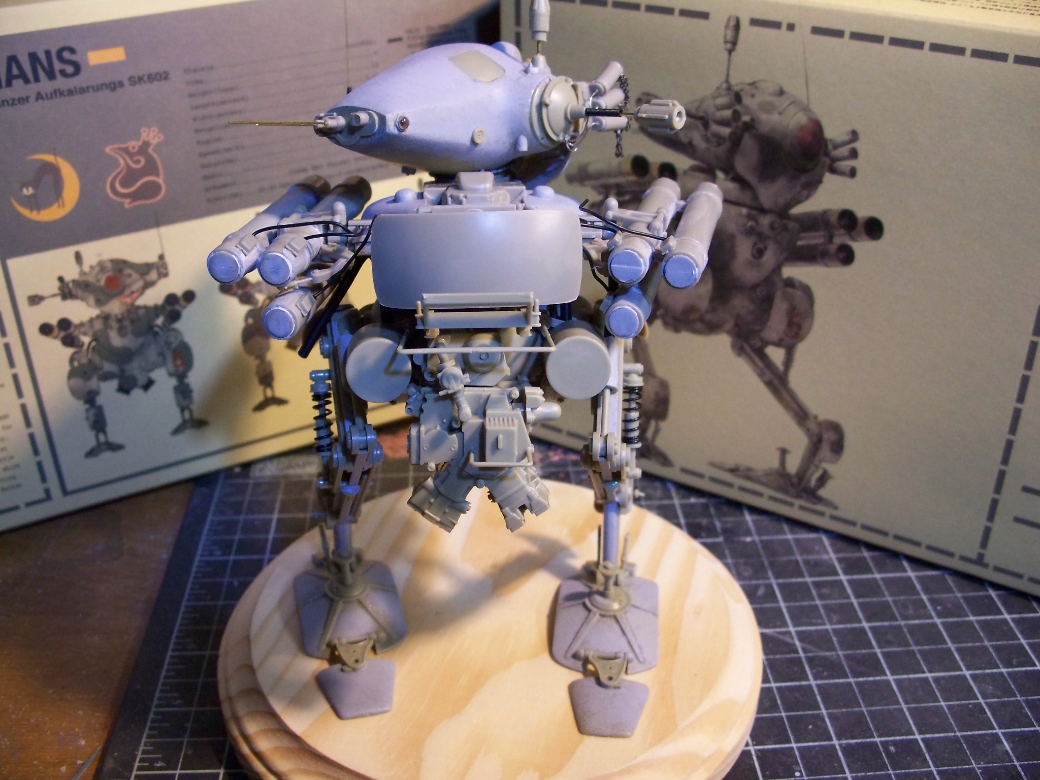

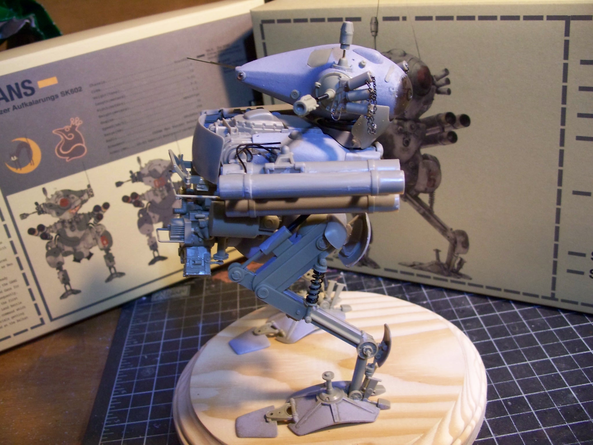

big F Posted February 3, 2009 Posted February 3, 2009 Little more on the gans tonight. I love the way you have made the red stripe look chipped and battered. they whole thing looks great. Maiden Japan which prime are you modeling this from.

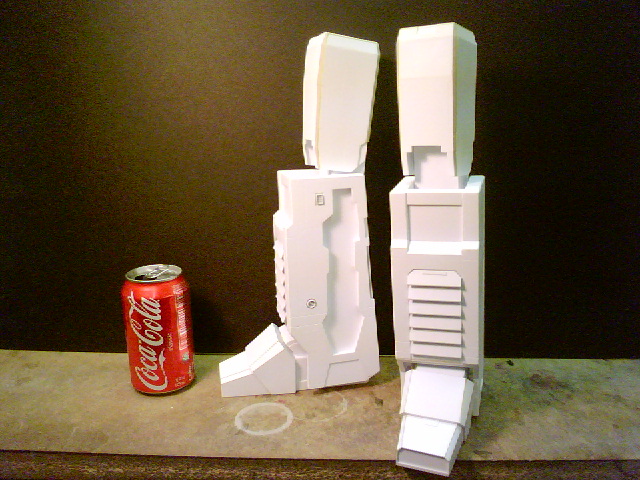

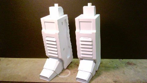

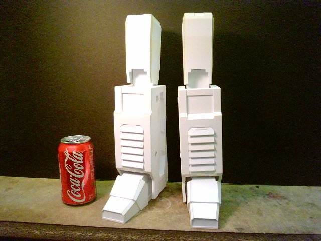

Maiden Japan Posted February 3, 2009 Posted February 3, 2009 It is from Generation one, with my own original design. I added more parts to the legs. And this time I took picture with a Coke can, so that you can see the actual size.
MechTech Posted February 3, 2009 Posted February 3, 2009 I knew it would be huge, but that's huge (and great work!) - MT

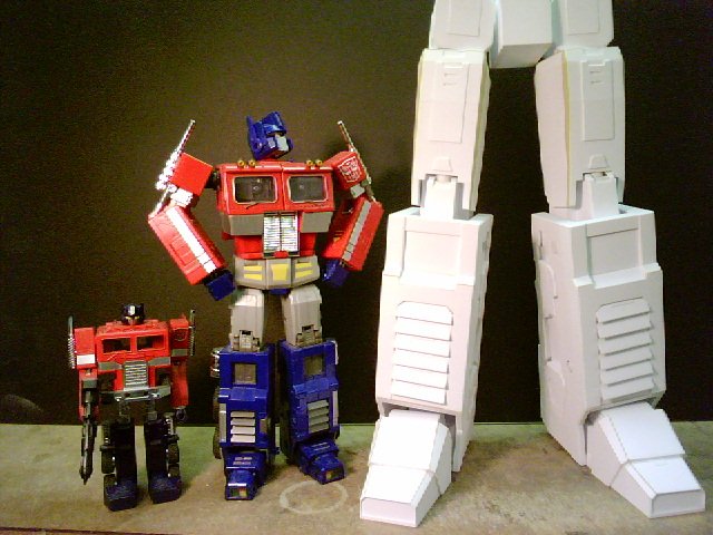

big F Posted February 4, 2009 Posted February 4, 2009 It is from Generation one, with my own original design. I added more parts to the legs. And this time I took picture with a Coke can, so that you can see the actual size. F@*^ heck that is big maybe you should post your next pics with the G1 prime in shot top remind us of just how huge this really is.

Maiden Japan Posted February 6, 2009 Posted February 6, 2009 Update on 24 inch Optimus Prime project: I added hip joints and more details on legs. And as requested I put it next to original G1 and MP Optimus Prime.
