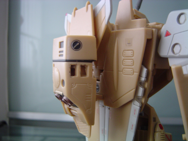

Ignacio Ocamica Posted August 12, 2008 Posted August 12, 2008 I just had to mod the backpack with a dremmel for the regular CF!!! I left the TRU CF unmodded. Quote

Ignacio Ocamica Posted August 12, 2008 Posted August 12, 2008 So did you attach super armor to your TRU CF? No, I did the mod only to the regular CF! Quote

MilSpex Posted August 13, 2008 Author Posted August 13, 2008 No, I did the mod only to the regular CF! Thanks for the picture! Quote
