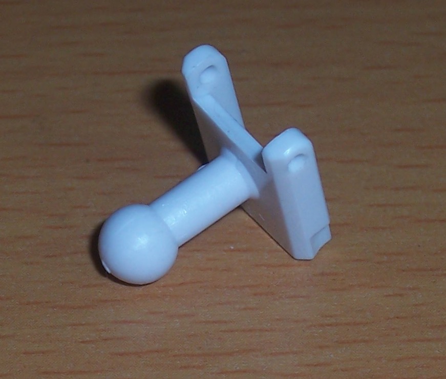

len_d69 Posted January 11, 2009 Posted January 11, 2009 (edited) Most likely both, as they have been doing with every 1/60 release so far. Look forward to seeing the pics! Baka ng 1S 1st run ng only valk kailangan ng fix. ARRRGGGHHHH I'm done with version 2. Went to see my 1J thinking about the fix by monster and this is what I saw!!! I guess its confirmed that Yamato never did fix the shoulder. Sadly I may be the first casualty. And just a warning!!! We always talk about not handling these version 2 correctly but for my case I have NEVER transformed it except for the first time when I transformed it to battroid mode last November. It was just displayed in my shelf and never been touched for months!!! Edited January 11, 2009 by len_d69

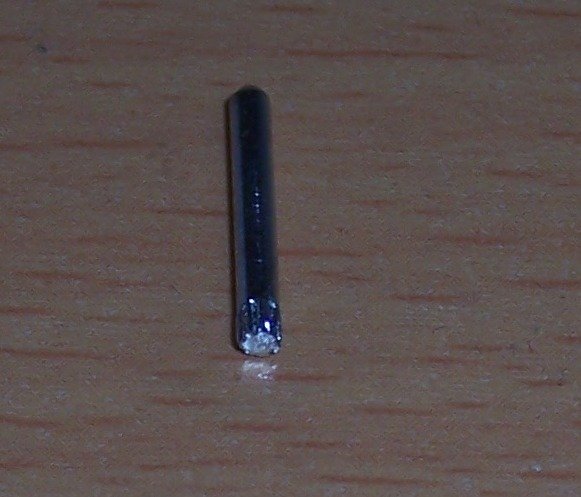

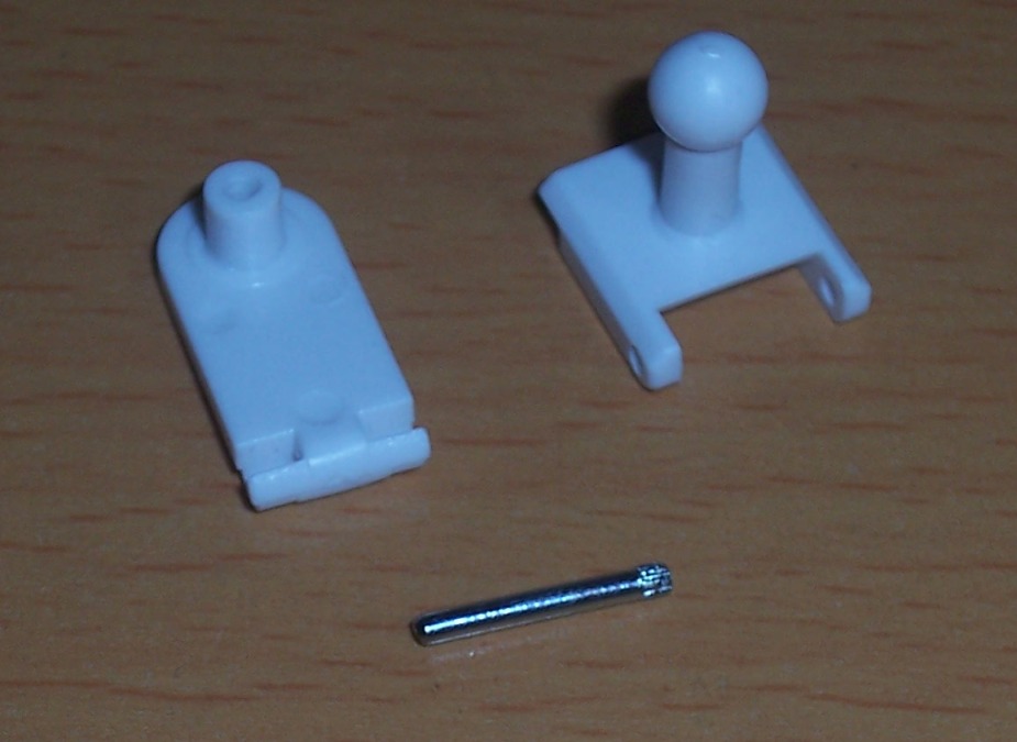

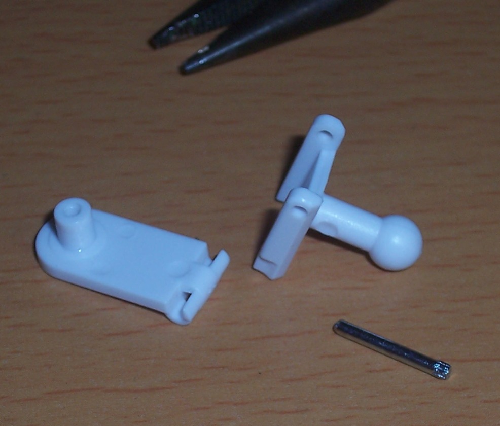

m0n5t3r Posted January 11, 2009 Posted January 11, 2009 i wasn't sure if i'd be modding the hinge pins on my 1J after i had done the pins for my Roy & Hik 1S's (since both are 1S's that have pins that have the fat end pointing in opposite directions, one up, one down... compared to my 1J that has both L & R pins pointing down)... but after seeing len's pic of his cracked 1J hinge i decided to go ahead and do shoulder surgery on my 1J. putting some oil/lubricant before pushing the pin out is a must... i tried pushing it out w/o any lube and it didn't budge and might crack if it is forced. i used a precision torx-head screwdriver that's about the same/smaller diameter as the pin. will sand it down tomorrow... zzzzzzzzzzzzzzzzz pics below:
OmegaD3k Posted January 11, 2009 Posted January 11, 2009 It's just a small crack. Nothing a bit of glue can't fix. It's not like it's broken or anything. In any case, the best thing to do is to hold the piece tightly if you plan on moving the arm around in any way. Other than that it should be ok. I now suddenly have the urge for a VT-1 with Misa Hayese That would be awesome indeed! I hope that these other variants are not only the double seaters, but also custom color schemes as well, like the 1/48 Low Vis Ver.2.
Kyp Durron Posted January 11, 2009 Posted January 11, 2009 (edited) This is silly. It seems to me that this could easily be fixed by Yamato simply using smaller diameter push pins for the shoulder hinge. Don't get me wrong, I love my 1st edition Roy 1S Super/Strike, but these breakages could so easily be prevented at the factory. Graham, if you talk to Yamato again, try suggesting smaller diameter push pins to them. -Kyp Edited January 11, 2009 by Kyp Durron
Folka Posted January 11, 2009 Posted January 11, 2009 I haven't gotten my VF-1A just yet, but i did happen to find some Wahl hair clipper oil. I might use that to remove the pin if it turns out to be a problem.
