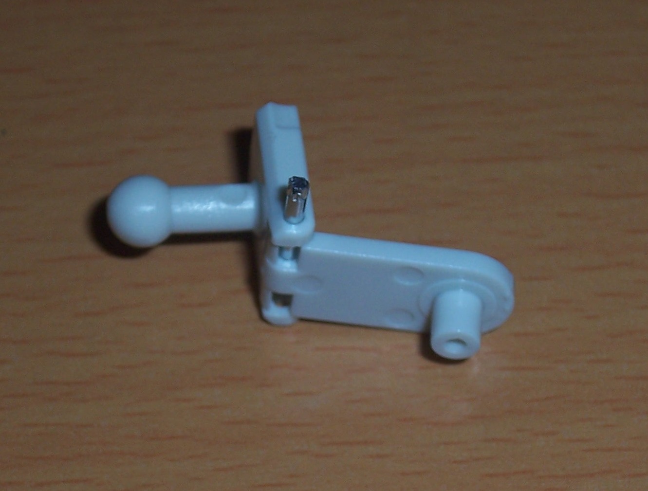

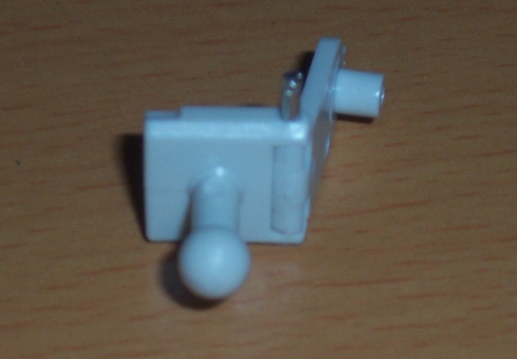

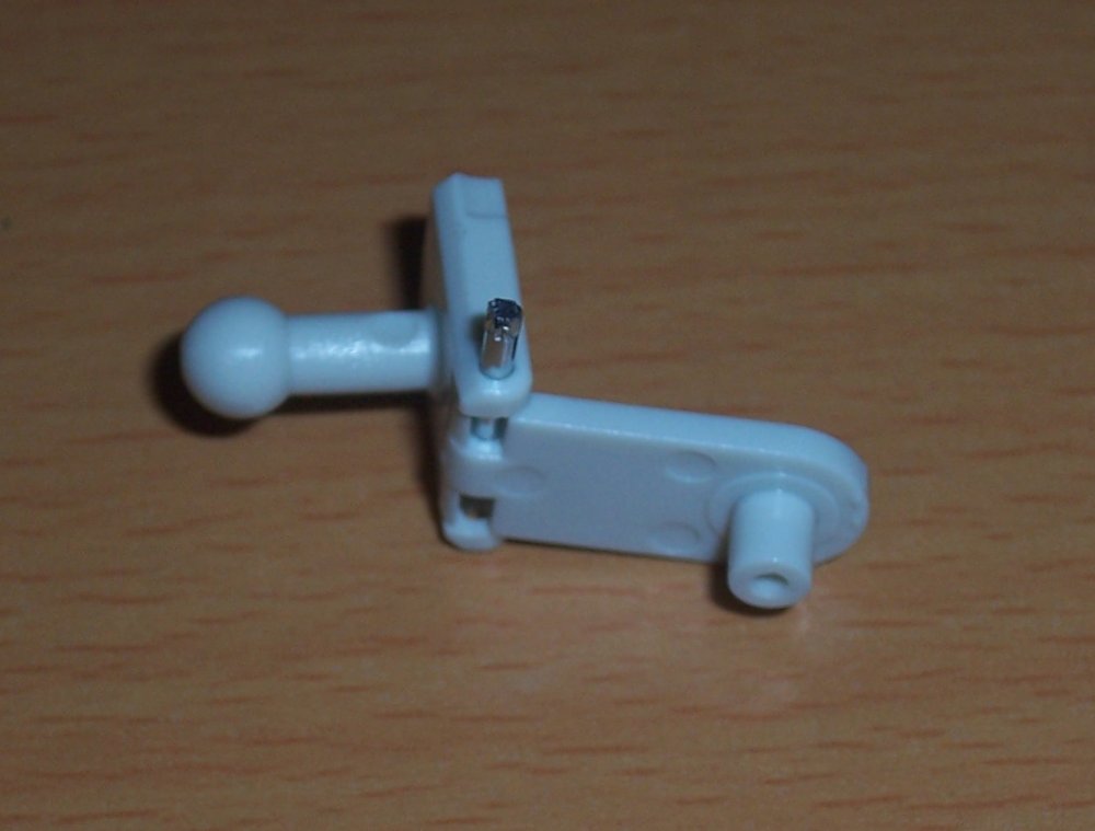

m0n5t3r Posted January 8, 2009 Posted January 8, 2009 (edited) when i heard about new reported breakages on the v.2 1/60 Roy 1S, i checked out my Roy 1S shoulder hinges and found some tiny stress marks around the fat end of the pin. it's one of two related things - the plastic is too thin around the fat end of the pin or the fat end of the pin is too FAT. so i proceeded to dismantle my 1S and got the stressed shoulder hinge and soaked it in some gun oil (i guess any lubricant will do.... except 5eX lube ) hoping that it would make it easier to push the pin out. IT WORKED! (see pics) now i will be sanding down the offending chunky part of that hinge pin... Edited January 9, 2009 by m0n5t3r
m0n5t3r Posted January 8, 2009 Posted January 8, 2009 i will be doing this fix on all the shoulder hinges of all my v.2 VF-1's... it will help me sleep better at night!

Shin Densetsu Kai 7.0 Posted January 8, 2009 Posted January 8, 2009 (edited) when i heard about new reported breakages on the v.2 1/60 Roy 1S, i checked out my Roy 1S shoulder hinges Wait, which VF-1S do you have, was it 1st run or 2nd run, and when did you receive the replacements? it's one of two related things - the plastic is too thin around the fat end of the pin or the fat end of the pin is too FAT. Or 3-Yamato should have made it out of more durable materials that could handle the fatness of the pin. Edited January 8, 2009 by Shin Densetsu Kai 7.0
m0n5t3r Posted January 8, 2009 Posted January 8, 2009 1st run Roy 1S. Well, Graham did confirm that Yamato did not change the material used for the hinges, and i doubt that they will. The cheapest solution for Yamato is to change the pin... only on the fat end of the pin is there a chance of cracking/breaking... the other "normal diameter" end of the pin seems to have no problem whatsoever notwithstanding what kind of plastic is used.
Shin Densetsu Kai 7.0 Posted January 8, 2009 Posted January 8, 2009 1st run Roy 1S. When did you get the replacement hinges? The cheapest solution for Yamato is to change the pin... only on the fat end of the pin is there a chance of cracking/breaking... the other "normal diameter" end of the pin seems to have no problem whatsoever notwithstanding what kind of plastic is used. Yes but isn't the tension due to the fat end of the pin, the only thing keeping the pin in place?
m0n5t3r Posted January 8, 2009 Posted January 8, 2009 (edited) the shoulder hinge is NOT a replacement, it's the one that came w/ my 1S... no crack, just tiny stress marks around the fat end of the pin. i just finished sanding down the fat end of the pin and reinserted it back... it is still pretty tight, no worries whatsoever that the pin will slip out on its own, 0% chance... tested it by closing and opening the hinge continuously many times and i even cranked it... seems fine... even the slight bulge it had near where the stress mark was and the stress mark seems to have disappeared! ... i have put as much stress on it, pulling the two parts in different directions, as much as i possibly can w/o forcibly breaking it... and its still fine. Edited January 8, 2009 by m0n5t3r
