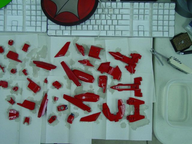

I am posting progress pics here.
I was lazy and stupid and did not sand it first. I did clean the parts with soap water but still I did get some chipping at first fit test. Jung advised that I sand the friction parts first but I had already painted them and I am too lazy to start over. I used Krylon Fusion rattle can. At this point I am thinking of putting a few coats of Future or of Tamiya Clear Coat and hope that one of those will help prevent further chipping.
Here are the first pics. .. .
Next is making the custom cockpit to fit the 1/60 amputee pilot...
Hollowed out a cockpit piece with a saw and a file. (used a mask after inhaling a bit too much plastic powder)...

Thanks. You are right. When I do my next 1/55 custom I will definitly sand the hell out of everything first, especially the parts that rub like Jung recommended.
For this one I am not going to paint the white stripes because my son wanted it all red with no white.
I actually like the way that the decals or tampo printing whatever are still coming through and the panel lines too. It gives it a certain quality that is cool for this.

I have started to put it together and it does look cool. I will post the completed one as soon as I can. But it is starting to chip and scratch. It will be fun to take before and after pics from before I give it to my son and after he plays with it for a month.

I just found that putting it back together I am chipping the hell out of it! The first parts I was doing well but the arm parts with the springs in the shoulder? Ahhhhh!

In doing this project I am constantly wondering what kind of paint the toy companies use that sticks so well after years of use? Is is some industrial poo that only toy manufacturers can get?
yeah, I hate chipping too, no matter how many clear coats you use, something always chips, what I hate the most is the chipping that happens when you're masking and when you take the mask off a big chunk comes with it no matter how careful you are...maybe Graham could give us some insight as to what paint Yamato uses on their toys...

Chipping is a *FACT* of life.
What you have to do is as I did..........
I find a bottle paint that is a close match to my spray can base coat and use that with a brush for touch ups. I have a file on the computer for each Valk that shows what colors I used.
Places where they rub even with lots of sanding are best hit with a quick dab of flat paint that closely mimicks what you used to spray it with.
Eventually you won't have to touch it up any more. The movement will wear it down to the point that paint stops flaking.
Just take good notes.
Sanding is your friend though. Truly.

To add to what Skull says
You can with some types of rattle can decant the paint and add the right type of thinners too it and stor it like mormal modell paint, that way you can get the exact match. You may have to experiment with thiners etc as not all manufacturers are forth comming with the relevant info on the can or web etc. But if you get it right its a great option.
