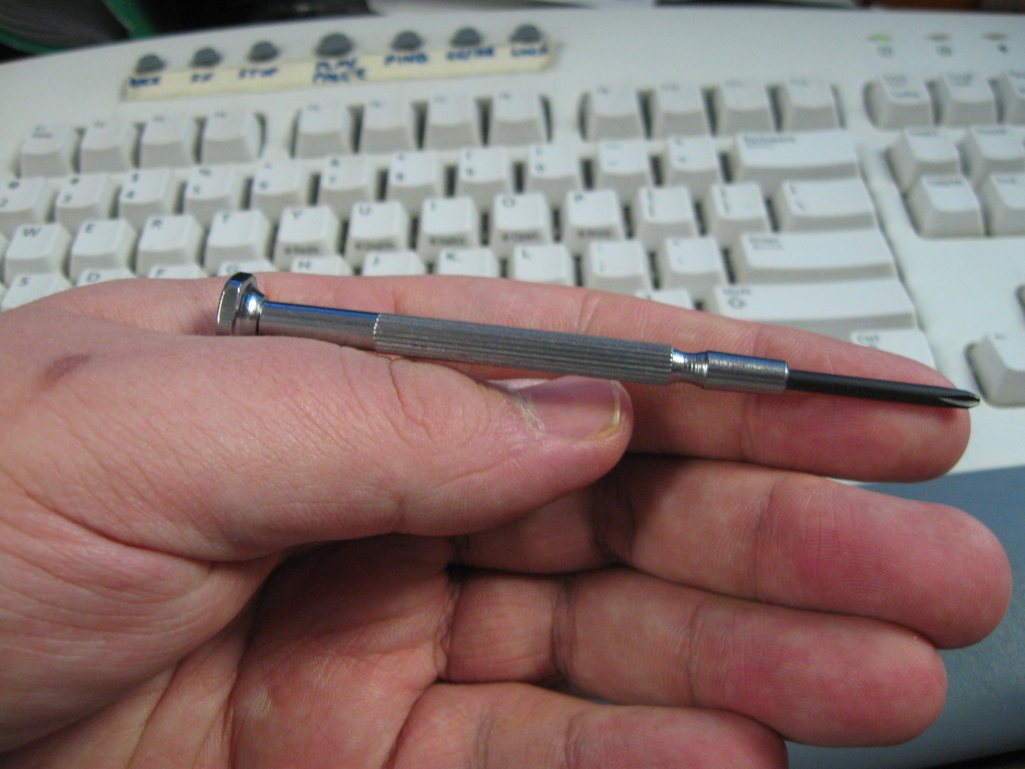

logos Posted March 18, 2009 Posted March 18, 2009 Thank you so much. I did the fix and the arms poses aren't scary and a chore to do now. Still they shouldn't glue them at all. Hey, did you all noticed the heavy wear on the fasteners? It's like they used really cheaply made screws or they were in a real hurry when putting them on. All of mine are like that. What do you mean by heavy wear of the fasteners? Do you mean that the heads of the screws are starting to strip? If so then yes they tightened the screws way to much on yours as I find that the screws don't have to be tightened much at all. As soon as I feel resistance (or quarter/half turn past that) in the screw driver I stop. I find that is usually more than enough torque to keep the shoulders loose and still be able to hold a pose. Note: I find that a Philips 1 or 1-1? screw driver works the best. Quote
mr.chogokin Posted March 18, 2009 Posted March 18, 2009 What do you mean by heavy wear of the fasteners? Do you mean that the heads of the screws are starting to strip? If so then yes they tightened the screws way to much on yours as I find that the screws don't have to be tightened much at all. As soon as I feel resistance (or quarter/half turn past that) in the screw driver I stop. I find that is usually more than enough torque to keep the shoulders loose and still be able to hold a pose. Note: I find that a Philips 1 or 1-1? screw driver works the best. Yeah, the screws are starting to strip and it isn't just the ones on the shoulders, but everywhere! Quote
logos Posted March 18, 2009 Posted March 18, 2009 (edited) Yeah, the screws are starting to strip and it isn't just the ones on the shoulders, but everywhere! They are soft metal screws so that will happen. Are you using the appropriate sized phillips like I mentioned? Edit: Added a pic for reference. Edited March 18, 2009 by logos Quote
eriku Posted March 18, 2009 Posted March 18, 2009 Heh, that's exactly the same screwdriver I used on mine. Quote

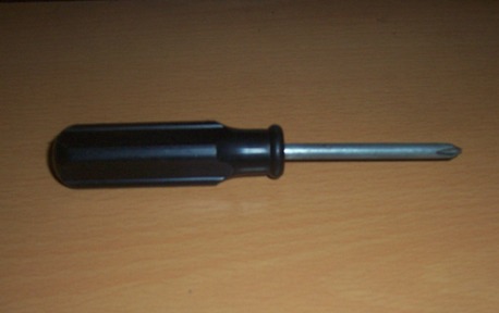

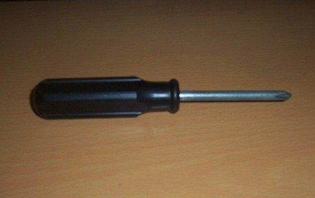

mr.chogokin Posted March 19, 2009 Posted March 19, 2009 They are soft metal screws so that will happen. Are you using the appropriate sized phillips like I mentioned? Edit: Added a pic for reference. Of course I did. The only places I did put the screwdriver to are to loosen the 4 pieces on the back shoulders. What I meant is, the screws with the worn tops are like that fresh out of box. Quote
m0n5t3r Posted March 19, 2009 Posted March 19, 2009 Of course I did. The only places I did put the screwdriver to are to loosen the 4 pieces on the back shoulders. What I meant is, the screws with the worn tops are like that fresh out of box. LOL... maybe he thought you were using something like this : Quote
mr.chogokin Posted March 19, 2009 Posted March 19, 2009 LOL... maybe he thought you were using something like this : LOL! that's like skeet shooting with the grand cannon. Quote
