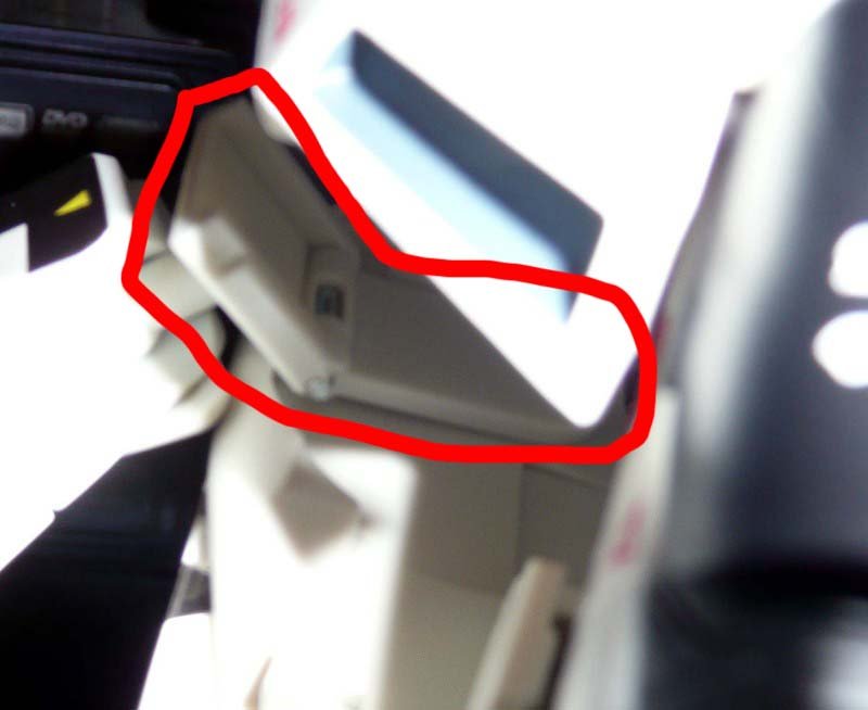

ok, sorry to be a pain about this, I know we're beating this to death and Graham already send pics to Yamato about this
well, since I've been trying to glue back the piece that broke from the hinge with no success, I was able to take a good look about what might happened and what I've concluded that the piece breaks by a series of combined factors, but the main problem is that the shoulder is too tight
now, let's get technical :huh:
IN HERE YOU CAN SEE HOW THE HINGE IS ARRANGE; 1 IS THE HINGE -- 2 IS THE METAL PIN -- 3 IS THE BAR THAT PIVOTS -- 4 IS THE LIMIT WHERE THE HINGE HOUSES WHEN LOCKED FOR BATTROID
NOTICE THAT THE PIN IS THICKER IN THE DISTAL END, PROBABLY FOR THE PIN TO NOT SLIDE, THE PIN (PIECE NO.2) ITSELF APPEARS TO BE GLUED TO PIECE 3 AND THE HINGE (PIECE 1) IS WHAT MOVES, SO ESSENTIALLY WHEN YOU MOVE THE HINGE TO POSITION THE SHOULDER, PIECE 2 AND 3 ARE STATIC AND PIECE 1 IS WHAT MOVES
ABOUT THE THICKER DISTAL END ON PIECE 2, NOTICE THAT THANKS TO THAT, PIECE 1 IS MORE NARROW ARROUND IT, LESS PLASTIC TO SUPPORT, MORE FRAGILE
NOW IN HERE, WHEN YOU APPLY FORCE TO PIECE 1 UPWARD, MOST OF THE FORCE WILL BE FOCUSED ON THE CIRCLED AREA, BUT THIS DOESN'T SEEM TO BE THE PROBLEM
NOW IF YOU APPLY FORCE DOWNWARD PIECE 1 SUFFERS A LOT ON THE CIRCLED AREA THAT APPEARS TO BE THE MOST FRAGILE BIT OF PIECE 1
ANOTHER THING, WHEN POSITIONING THE HINGE ON TRANSFORMATION, NOTICE ON PIECE 4, THERE'S A TAB WHICH PREVENTS THE SHOULDER TO DROOP DOWN ON BATTROID, THE PIECE CIRCLED ACTUALLY STANDS OUT AND IF YOU'RE NOT CAREFUL THE TAB FROM 4 WILL CLASH WITH THE WEAKEST AREA OF PIECE 1 MAKING IT MORE SUSCEPTIBLE TO BREAKAGE
NOW WHAT APPEARS TO HAVE HAPPENED TO ME, IS THAT WHEN I WAS TRANSFORMING TO BATTROID, WHEN POSITION THE HIP BAR IN PLACE, IT PUSHED PIECE 1 AGAINST THE HOUSING OF 4, MAYBE MY PIECE WAS CRACKED AT THE MOMENT AND THE EXTRA PRESSURE MADE THE PART BUCKLE AND BREAK
Now, what I think the problem is, essentially whenever you move the hinge on transformation, the weak part of the hinge gets stressed, but in essence it should hold, until you start to move the arm, the extra tightness of the shoulder applies extra pressure on the hinge, since it's the right arm that holds the gunpod, whenever we play with it this is the arm we move the most to pose (probably why there have been no left arm breakage reported yet), remember that the metal pin is glued so it doesn't move with the hinge, so essentially the only piece that actually moves is the plastic hinge, all the pressure is directly to only that slender piece of plastic until it eventually breaks
now what I think would have prevented is that the thick part of the pin be up instead of down getting thicker plastic on the downward edge that gets stressed the most and for the pin to move with the hinge thus the energy would be transfered to the hinge and pin when moving it
well, that's my analysis...hope everyone understand this, feel free to add any corrections or extra stuff you might want, thanks...
