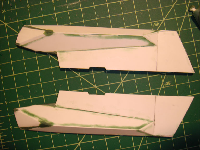

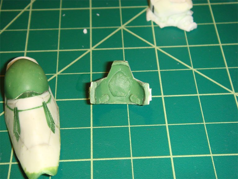

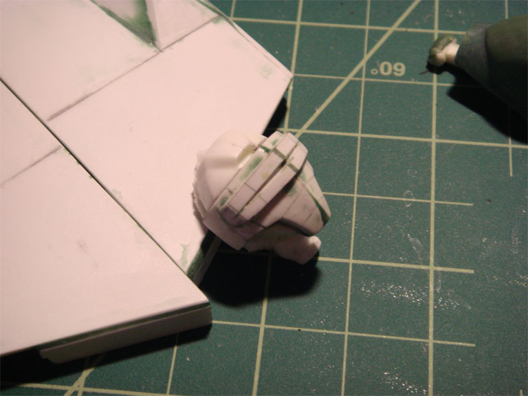

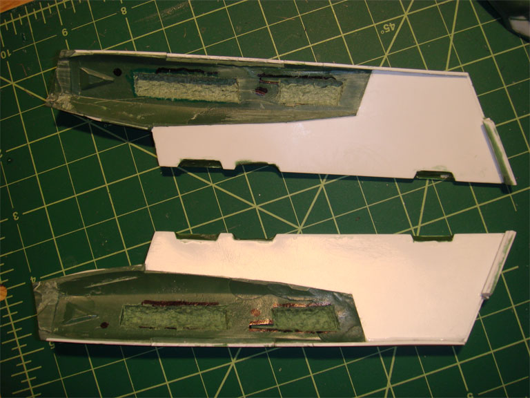

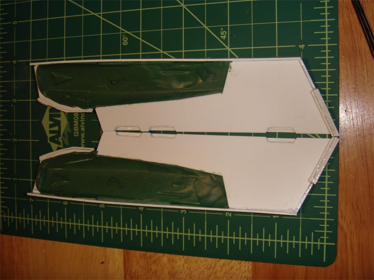

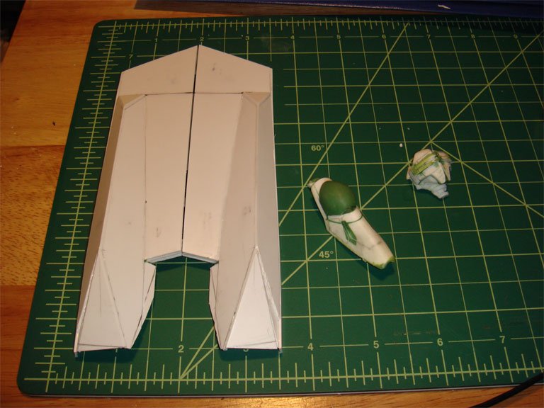

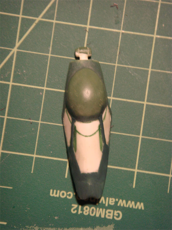

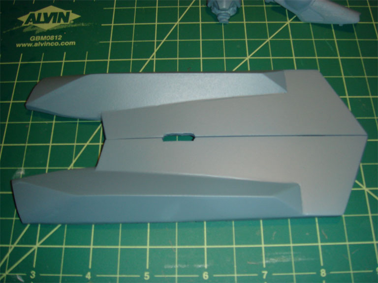

PsYcHoDyNaMiX Posted September 4, 2008 Author Posted September 4, 2008 Blah... with school starting I wanted to get more done with this project. Here is what I have so far. There is still alot more that needs to be done. ALOT. I am more determined to finish this project within the next month (before October), maybe sooner. P.S. I've already ordered magnets from the recommended link by eugimon. Quote
eugimon Posted September 4, 2008 Posted September 4, 2008 Sweet, that replacement canopy looks really nice! Keep up the hard work. Quote
Valkyrie addict Posted September 4, 2008 Posted September 4, 2008 AWESOME!!! take your time man!, school and work comes first Quote

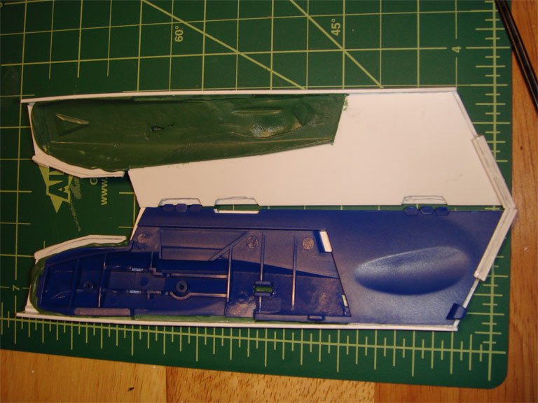

Fly4victory Posted September 4, 2008 Posted September 4, 2008 Work and school is always a downer, except the money from work. On the belly plates, I can see that you have used sheet platic for the construction but what is the green stuff? How did you keep it from sticking to the origional parts. The canopy and face plate are perfect. They will look great in color. Looks like lots of hard work. Quote
PsYcHoDyNaMiX Posted September 4, 2008 Author Posted September 4, 2008 (edited) Fly4victory: The green stuff is a two part modelling epoxy called "Kneadatite". Sculpts pretty well (better with water) and cures in 4-5 hrs with max strength in 24 hrs. I had a supply of the ribbon form, but it seems they sell it in a tube now. If you get the ribbon and don't want it to cure on its own you can slow down the process by keeping it in your freezer. Mine has been there for like uhh... 4 years now? LOL, good stuff however. ***EDIT*** Oh yea to answer you question about how I kept "it" from sticking to the original parts. I used a petroleum based jelly (Vaseline) or in minor cases chap-stick... lip balm. I applied a thin layer of the petroleum based jelly to the original and set the part on to form the shape w/o sticking. Let the part sit for a few minutes to cure (depending on what you're using to capture the shape) and when its about right remove the two parts. Edited September 4, 2008 by PsYcHoDyNaMiX Quote
Fly4victory Posted September 5, 2008 Posted September 5, 2008 Thanks PsYcHoDyNaMiX, very clever better than plastic wrap. Now I need to get some "Kneadatite". Quote

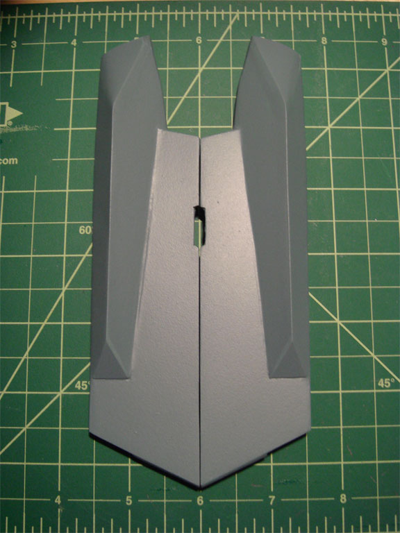

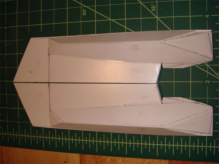

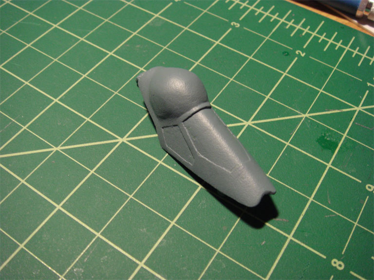

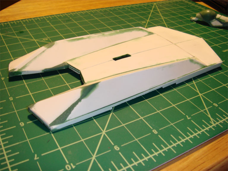

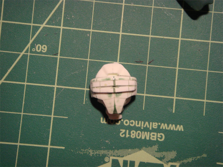

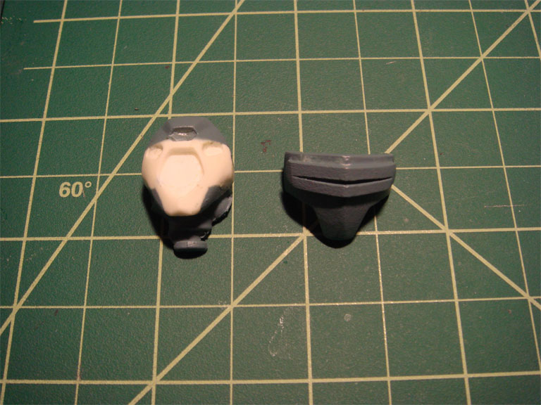

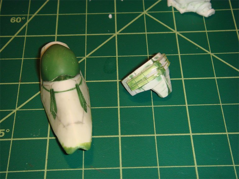

PsYcHoDyNaMiX Posted November 10, 2008 Author Posted November 10, 2008 (edited) Update: After sand down/trim the canopy the parts will get primed for more sanding/puttying. I was able to gut out some of the excess putty for the bay covers to reduce it's overall weight (some more will be removed eventually). Pics... ***EDIT*** Quick note: changes which I have made from the previous pics. I was able to start working on the actual visor for the battroid's faceplate (trimming, shaping, etc...). I was able to round out the front of the bay covers (near the intakes) and fill/smooth out the joining of the seams. I was able to round out the main canopy window some more and I am currently working on it's framework. Edited November 10, 2008 by PsYcHoDyNaMiX Quote

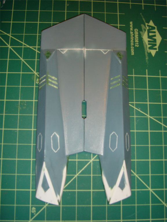

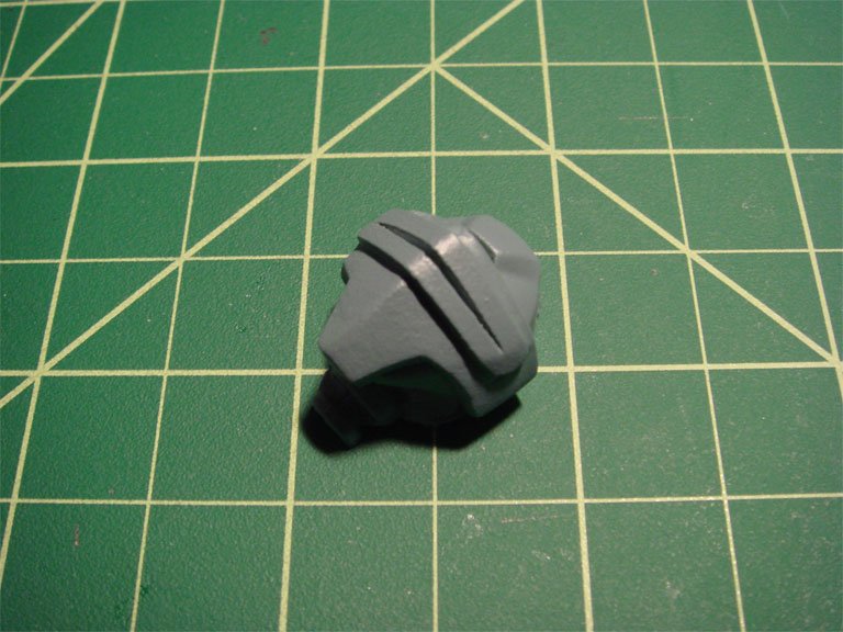

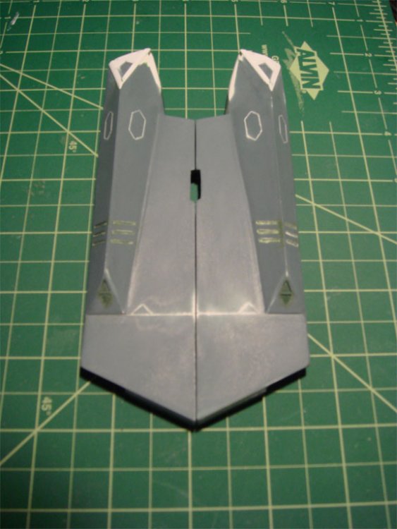

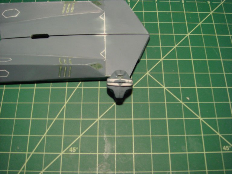

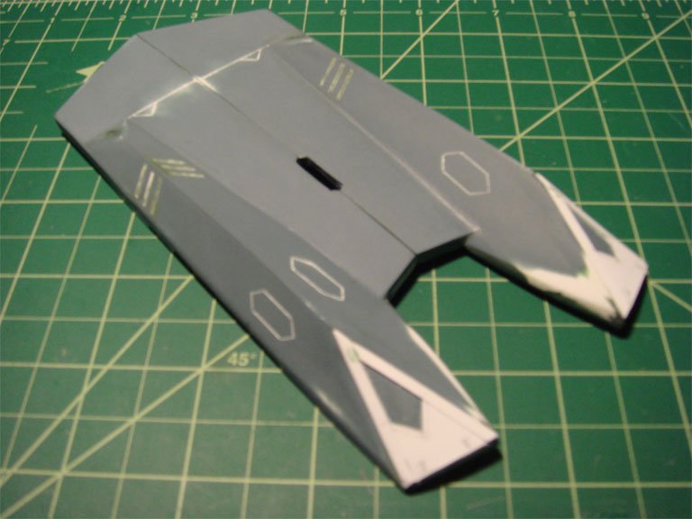

PsYcHoDyNaMiX Posted January 2, 2009 Author Posted January 2, 2009 (edited) HAPPY NEW YEAR! Hey Everyone, I've been on break the past week and a half. Aside from the holidays, family events and stuff I made some more time to start up on the project again. I was able to work on the canopy some more and get some more sanding done. I primed up the parts for the smoothing out process and any other rough areas I may have missed with my eyes. I still have to etch/detail all the parts, and define the mounting holes on bay covers (for the display mount). Here are some more pics, enjoy: Edited January 2, 2009 by PsYcHoDyNaMiX Quote

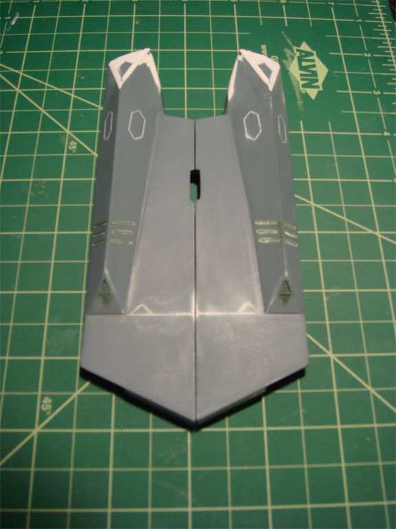

PsYcHoDyNaMiX Posted February 28, 2009 Author Posted February 28, 2009 (edited) Hey guys, I've worked on the project since I've last posted, but haven't had the chance to taking more pictures and posting them. I'll try to get some up by next week. I have this programming project I need to get out of the way for my OS class. -=X I've started etching out the panel lines and other markings. You'll see them when I post up the pics. Max "School has me in the gutter atm... >.>" Edited February 28, 2009 by PsYcHoDyNaMiX Quote
