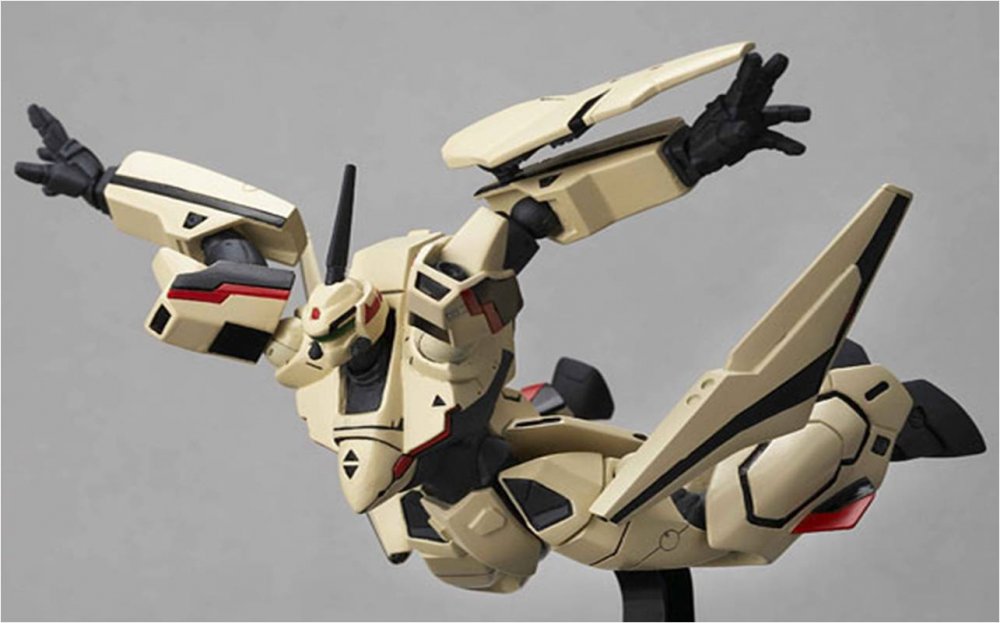

Also one pose I really wanted my YF-19 to do is the free falling pose like the one shown on photo 01. As we all know by now, recently released yf-19 figure (not 1/60) can do this because it is not transforming, action figure (See photo 02).

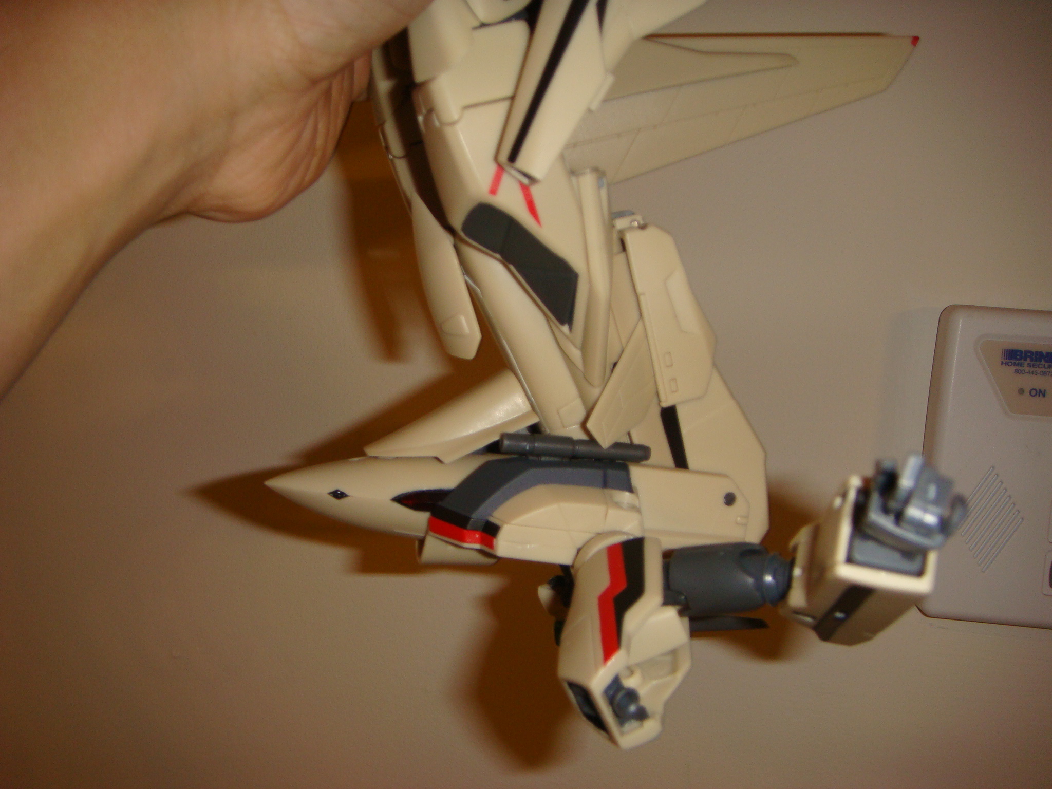

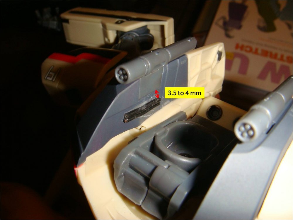

Now let’s get to the point here. Check out my photo 03 and see if you think I've came close. :rolleyes:

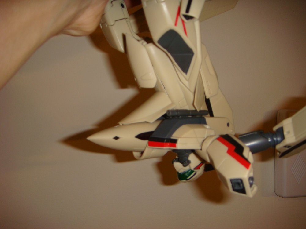

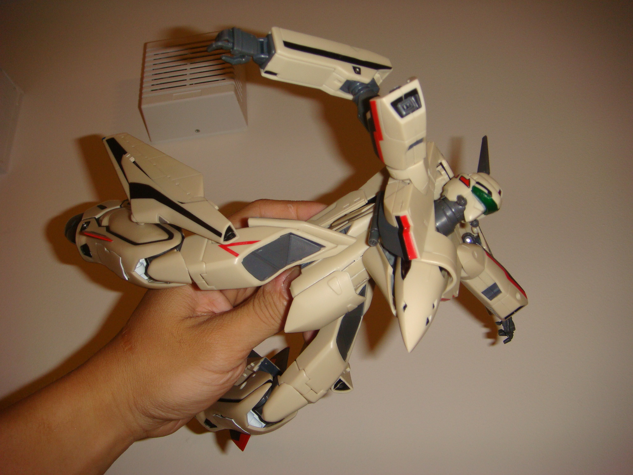

Now photo 4 and 5 is showing me holding the YF-19 by its leg and upside down (Without any mod, you all know what happens :wacko: ).

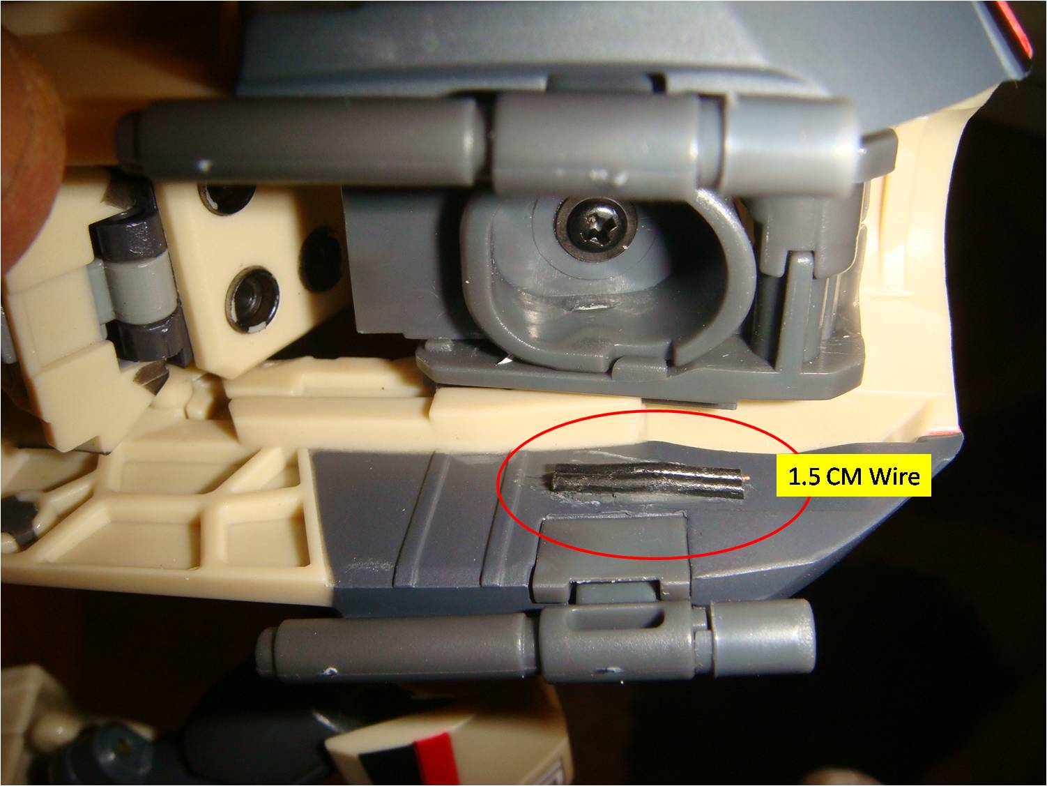

Photo 06 shows where the wires go. Cut about 1.5 cm of wires (I've used 2 rows to ensure it secures the chest tightly) and glued it just below the base of chest cannon plate as shown. Photo 06 should give you precise locations I am talking about.
Photo 07 is shown from another view and with approximate distance from the cheat cannon base plate (3.5 - 4 mm below).

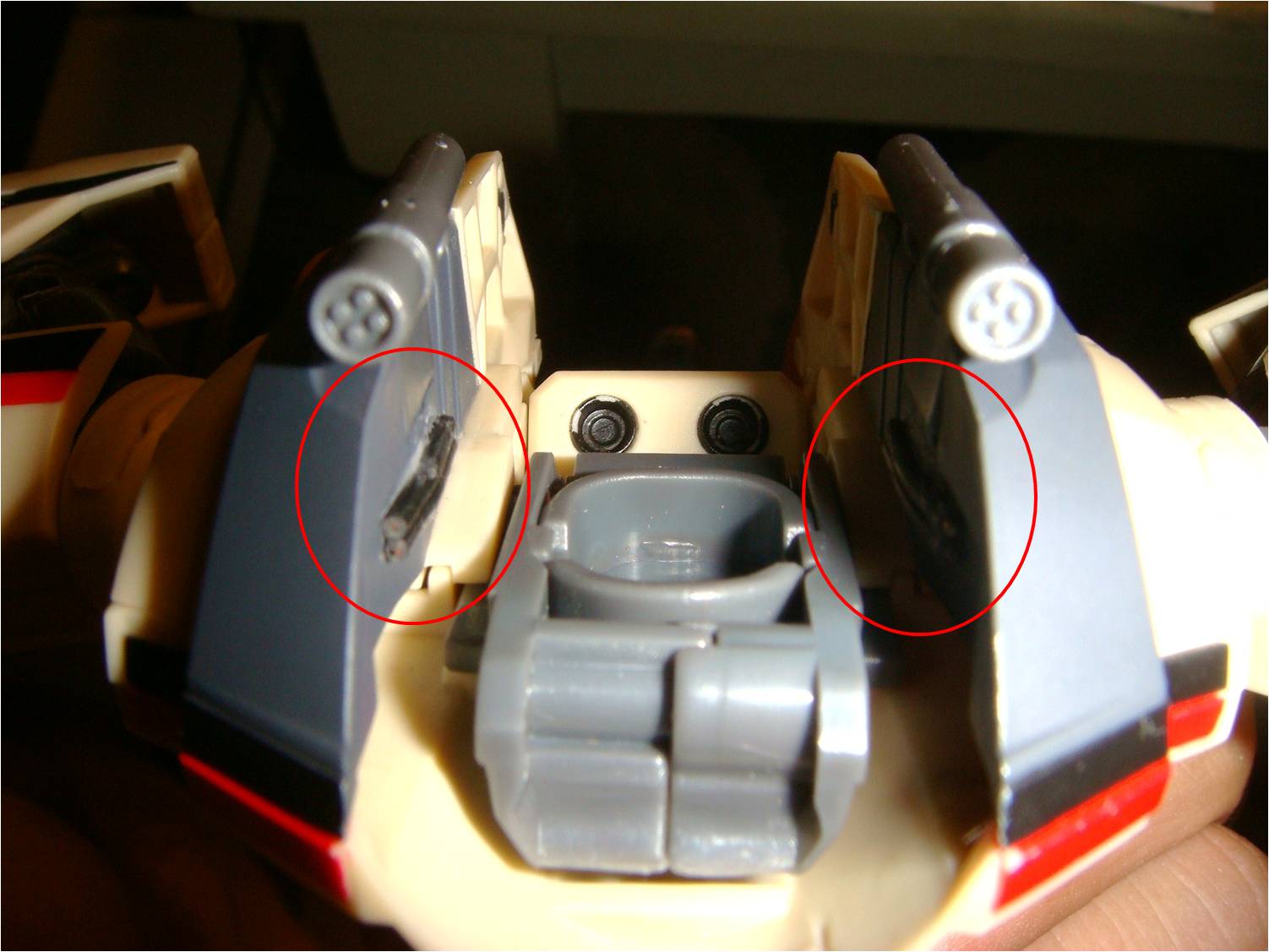

Photo 08 shows what it looks like once is completed (frontal view)

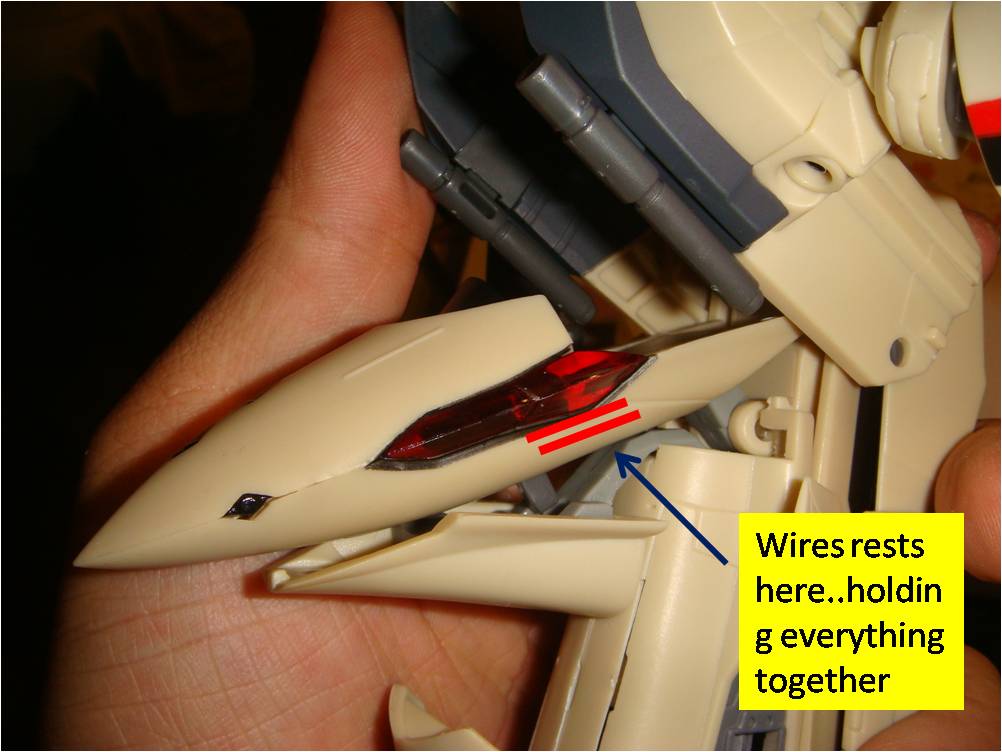

Finally, photo 09 explains the concept again. The wires are not pressing against the side of nose cone; rather, it is gripping the nose cone just below the radar sensors (shown as red lines in photo 08).
