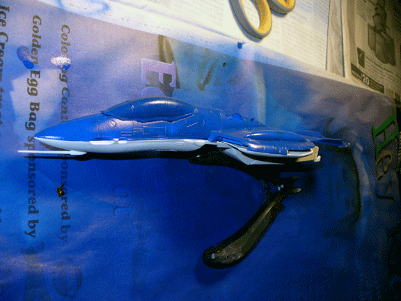

Rockhound Posted May 1, 2008 Author Posted May 1, 2008 Update: Main color added! Here are some pictures with the blue and white main colors applied. When I was looking at them, they looked perfect. The pre-shading was subtle and the blue a a dark yet vibrant color. I wasn't too happy with the white, as it clashed way too much with the dark blue, so I plan to tone it down with some light gray like I said in a previous post. But the blue was perfect... Until I saw the photos. The pre-shading is still sticking out, even after four passes of acrylic paint! Must of used too much water. Guess I'll hit it with another coat. I also included a shot that had the bottom and top halves together to see the contrast of colors. Well, here ya go! To do next, add one more coat of blue, add a quick coat of light gray, apply gloss coat, start the metals paints for the feet, mozzles, gun, etc. Quote

HWR MKII Posted May 1, 2008 Posted May 1, 2008 (edited) Looks like your leaving too much of the pre shading showing through. You want it to look like grease stained paint from handling and use. The effect needs to be very subtle. It will show more as you do the panel lining is done. In 1/72 scale you want the effect to be very subtle, almost invisible. Any chance you could give it one more overall misting of color? Edited May 1, 2008 by HWR MKII Quote
Rockhound Posted May 1, 2008 Author Posted May 1, 2008 You're right HWR, it really does need an extra coat. Here's an updated picture with the new coat of blue and the light gray added to the white parts. I'm very happy with the light gray, but looks like I need yet ANOTHER coat of blue. ugh... maybe it's the camera. It looks extremely subtle in person, but once I take the photo the shading is glaring. Could be the lighting also. sigh Guess I'll throw some more blue on it. Good thing the panel lines are still deep. If it's not good after this last coat, oh well. I've already done like 7 passes on it. I think my problem was using enamel paints on the shading, then acrylic on the coats. It wasn't an issue when I did the gray/white paint. So, Rockhound's important tip of the day: WATCH WHEN USING ENAMELS FOR SHADING AND ACRYLICS FOR MAIN PAINTING! ...... I wanna start decalling already. Quote
HWR MKII Posted May 1, 2008 Posted May 1, 2008 I think it looks right as it is. Any more and it will look too clean. Blue is a tricky color. I use mainly acrylics for everything. The only oils i use are for my panel washes. Quote
Excillon Posted May 1, 2008 Posted May 1, 2008 I see what you mean about the blue. That's nice! Quote
jardann Posted May 1, 2008 Posted May 1, 2008 That's looking nice Rockhound. I like the blue a lot! I think what happened with your preshading is that it was a little too dark for the white on the underside. Next time you should maybe try a lighter grey color for the preshading under a white topcoat. Just another warning about something that I've experienced: Sometimes you can get a problem using enamels under acrylics. The enamels take a much longer time to cure and will cause the acrylic top coat to crack or peel. Keep up the great work! I'm excited to see this finished! Quote

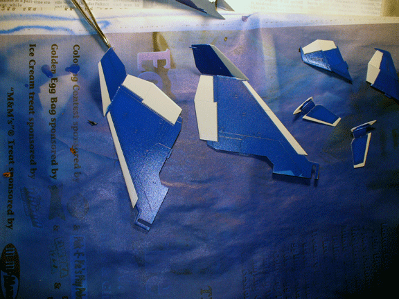

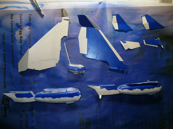

Rockhound Posted May 1, 2008 Author Posted May 1, 2008 New updates (again)... After seeing the blue in better light, I was pleased with the outcome. So once I was able to see it better, I hit all the painted parts with an ultra-gloss coat and waited 7 or so hours for it to dry. Then I started masking off the areas I needed to paint white on the wings, canards, and stabs. The thing with masking tape is, it might be too sticky. So I stuck it to my shirt a few times to get rid of most of that stickyness, but leaving just enough to adhere to a glossy surface. This prevents accidently pulling up some of the painted and coated surfaces. The pieces that need to be masked for blue paint, namely the legs and head, were done with a combination of masking sol and masking tape. This was done to the legs due to the uneven lines across the length of it. yes, I could of simply cut the masking tape into wavy sections, but what fun would that be? I'll hit the dark blue surfaces with a fine mist of white primer to lighten up the color. This keeps you from doing coat after coat of light gray and gets you a much more true color that's the same shade as the rest of the bottom surfaces. Quote

Rockhound Posted May 2, 2008 Author Posted May 2, 2008 Here are the parts that were unmasked. There was a little bit of overspray, but since it's acrylic it's easily removable. For the legs, one side was masked with masking sol, and the other side was just tape that was cut to make a wavy seperation. After painting it, I was happy with the protection the masking sol offered, but the tape had a "truer" shape I guess but with some overspray that found it's way between the tape. Agian, easily removable. I also pieced together the main body of the model, seen here. You can see that keeping the pieces separate helps alot. The clean lines could not of been masked so well due to the complexity of the shape of the nose and fuselage. I did have one little accident on the rear stabs though. The masking tape pulled a little bit of the coat and blue paint up. But I just remasked over the finished surface and painted the bare spots. It came out pretty well. Now I just gotta paint the dark grays onto the parts that attach to the back of the leg/engine and the lower leg "canards?" Once that's done, I'll glue those pieces onto the legs, recoat with one more layer of ultra-gloss, and start working on the metal parts such as the feet, engines, gunpod, and turbines. Till then! Quote
