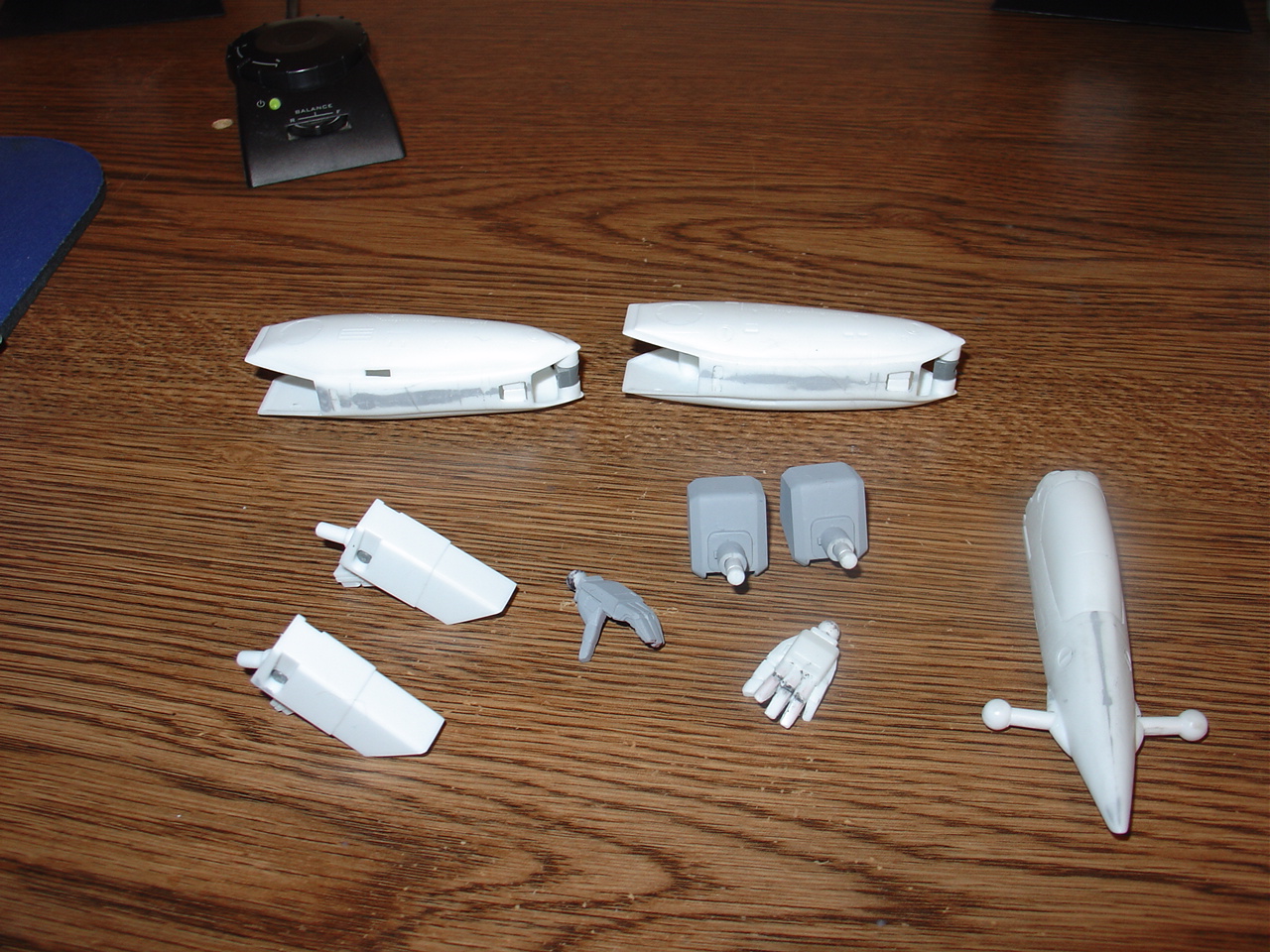

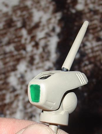

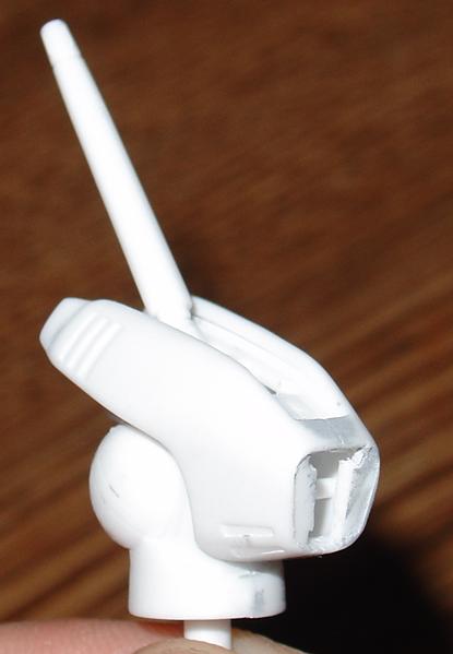

I was desiging a VF-1A Battroid Standerd issue with booters.
This was my thread posted on the Monkey boards last year. But as I said, I never got to complete it

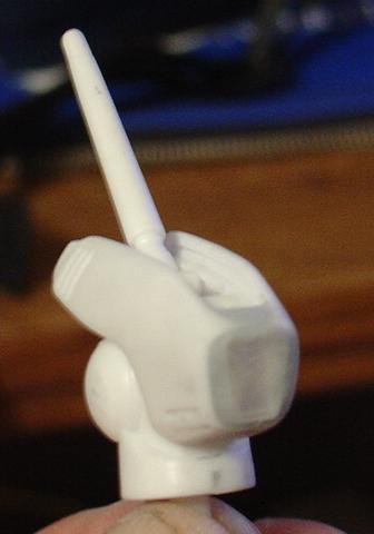

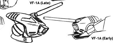

What I was showing here is that the DYRL Head is WAY different from the TV Head. And I was always a TV fan the Kit is designed after the DRYL Heads. So I cut out and used PART 15! from the FIGHTER KIT Clear Sprew. IF you notice Their is no use for part 15 and its was some kind of design for the TV Head :D
So I made it work and made the head.

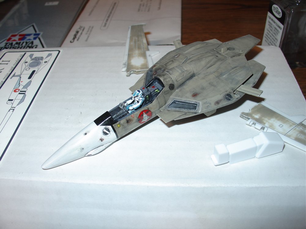

Once I have glued what pieces togeather that I can Paint easy. I begin painting the parts that I KNOW have to be painted before glued.
I am sorry I dont have any before pics to the Fighter but this is the best I had at the time. You can see that I was working on the kit and comming up with ideas.
3. Prime your parts, Get all the stuff needed to paint them. RESEARCH what you want to do. Think about what paint scheme, what Colors, what dammage you want to portray. I normally took me about 2 weeks of research before I made my kit. I wanted mine to be right, 90% of the pics I have seen out there are wacked. So if you wanted stuff to be right you take the time .

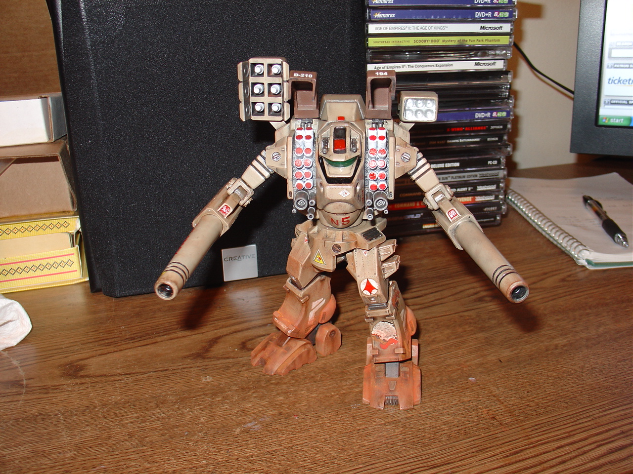

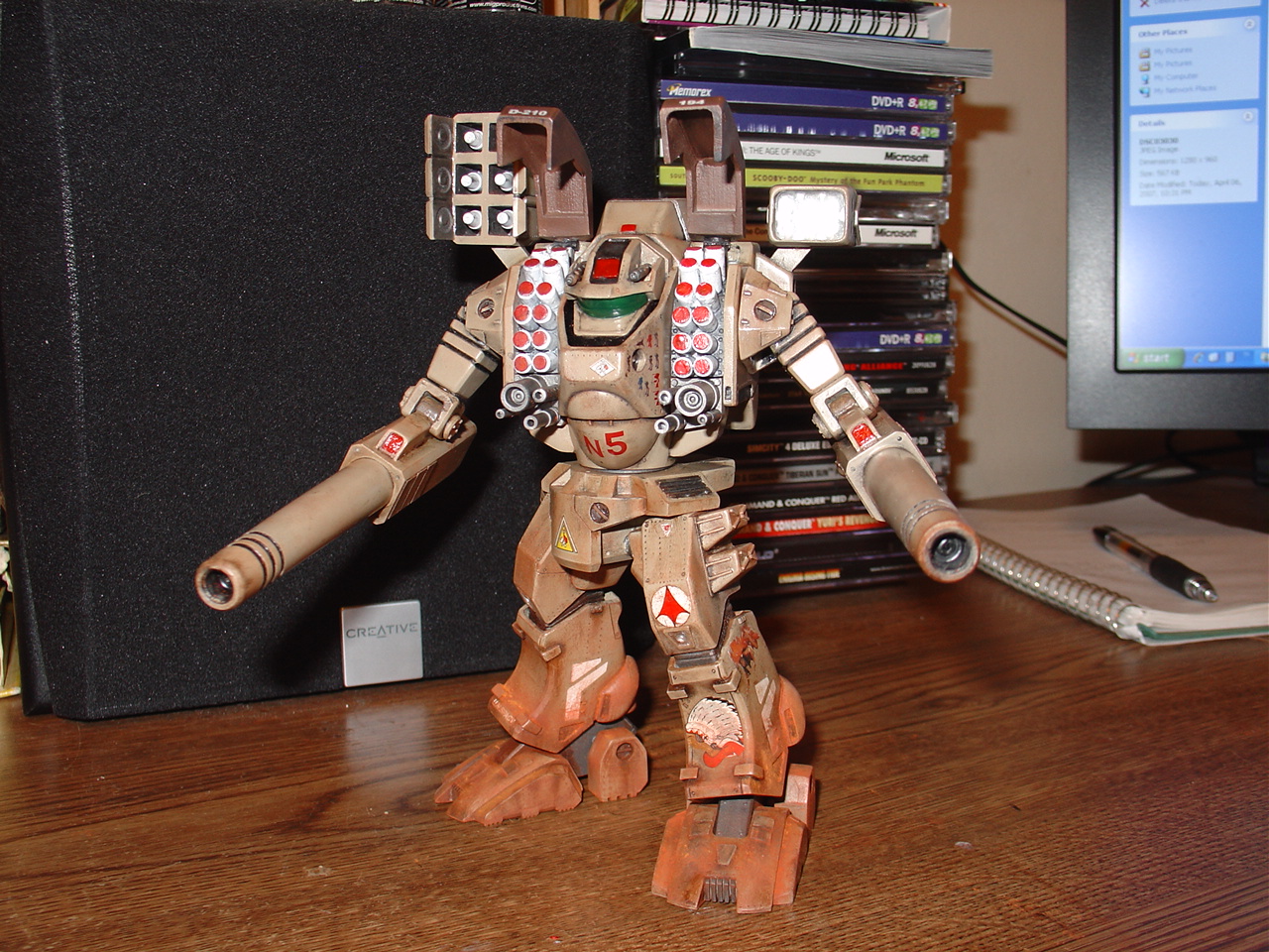

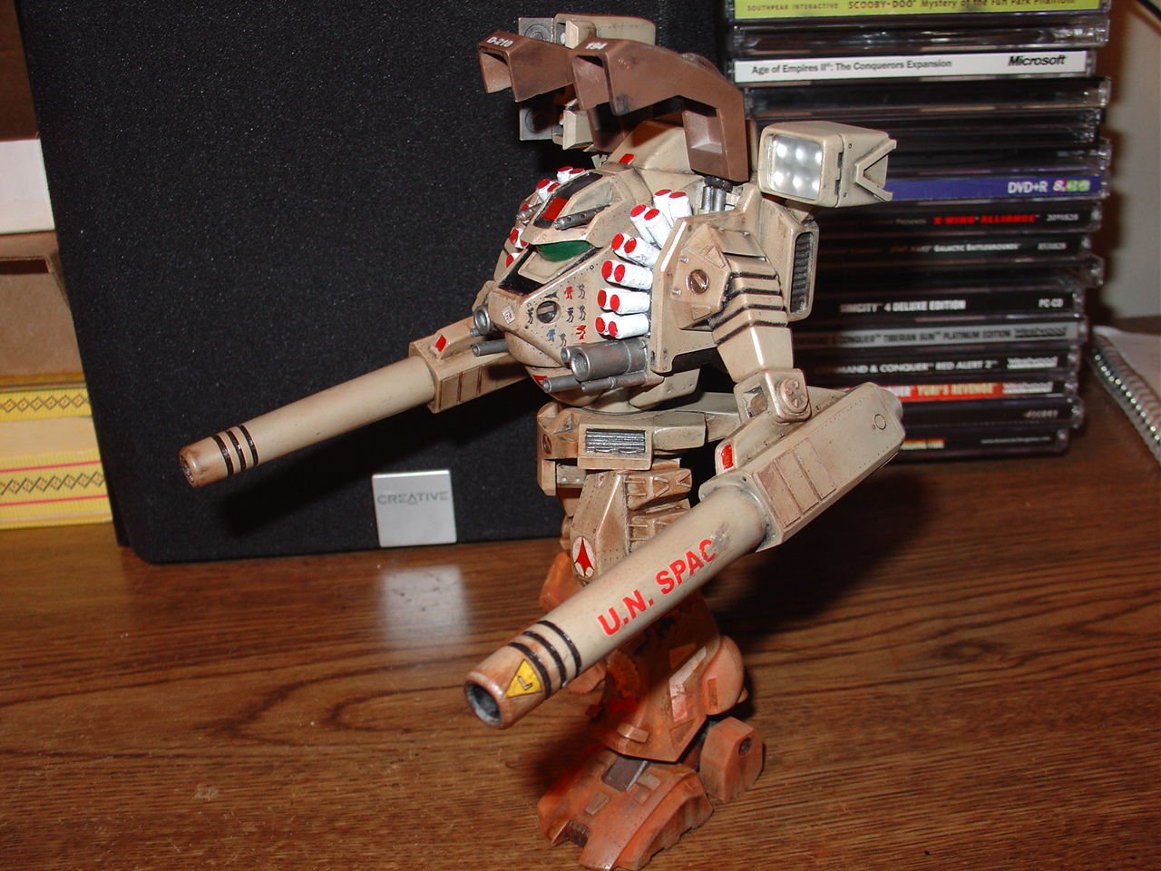

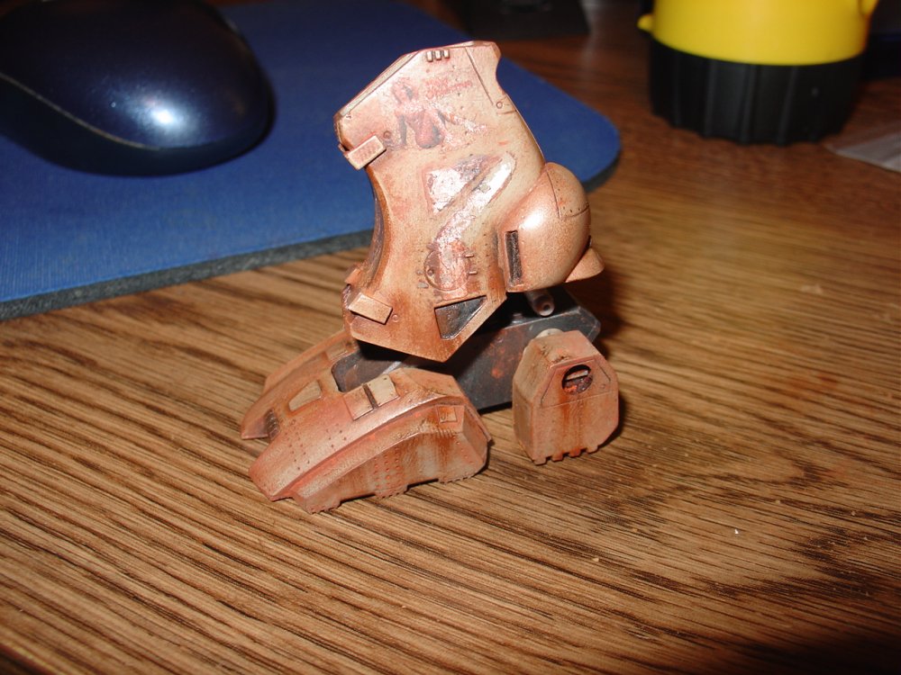

Here is a few pics of my Tomahawk from John Mascoto. This was me working as I began to invision what I wanted to do. Its hard to explain my Planning process but the pictures will explain how I was thinking.

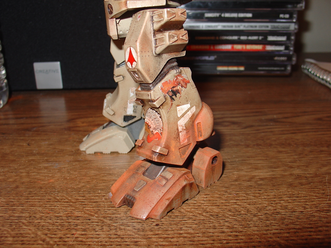

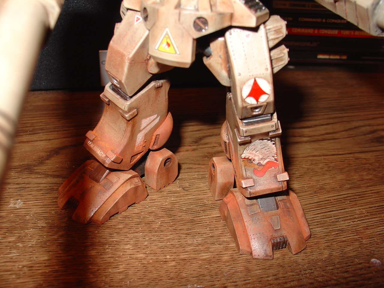

This Tomahawk again was themed from the Mars Battle. I used Orange powder on the legs to give the effect it was walking in the dirt and dust of Mars. There is 3 shades. a Light Orange dust, Dark orange Dust, and the color Rust powder. They can be bought at a hobby shop.

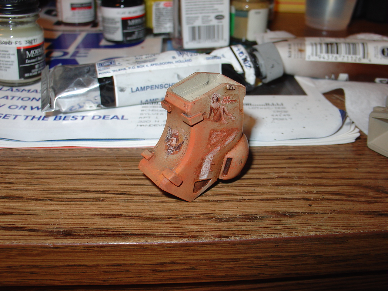

I did not like the decals I put on the first part of the kit. So I did remove them later and placed Indian decals. I love naked women on my Kits, Just gives it that GUYS touch. And the feel of World War 2 pin ups. The decals can be bought from Starshipmodeler if you dont already know. They are part of the "Cheesecake Series"
PS. I never liked the Indian after I was done. I chose it because its a "Tomahawk" I thnk I would have liked a better looking Indian. But I did put the Indian chick on the side crawling
Also MANY of these decals I custam made. or used from The Buyer Sheets that you can find out there on Ebay. I custom made the Red and white Kite.
