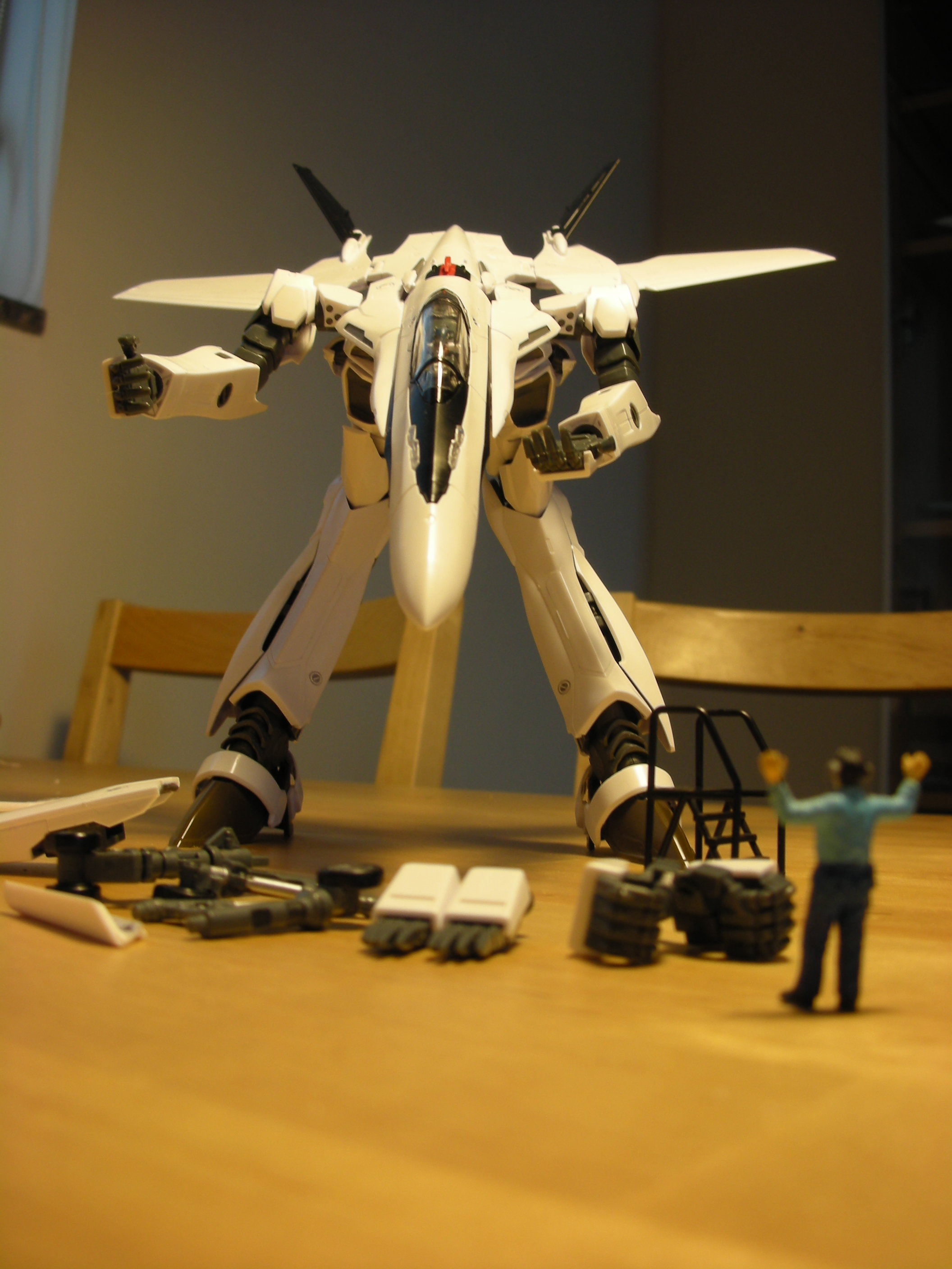

Graham Posted October 6, 2008 Author Posted October 6, 2008 I made some progress, after panel line and clean up, painted landing gears and cockpit, head, now assembled 1 leg and the front of the plane. I took a shortcut and decided to use the sticker for the crotch area, what about you guys?? I am also puzzled at the instructions, which seem to tell me to add the decals or stickers during assembly, is that really necessary? I am also not sure what to do with the "big screws", they're moulded, so applying the decals could be tricky...and I am not great at painting with a brush, but have no clue how to do it otherwise. I also used the sticker for the crotch area. I built my kit first before applying the stickers, but discovered after that there are some stickers that should be applied during assembly, such as the long black stripes on the wings. If you apply them after assembly, you will have to trim some of the sticker, as the end of the wing is hidden inside the wing glove (think that's the correct technical name). Graham

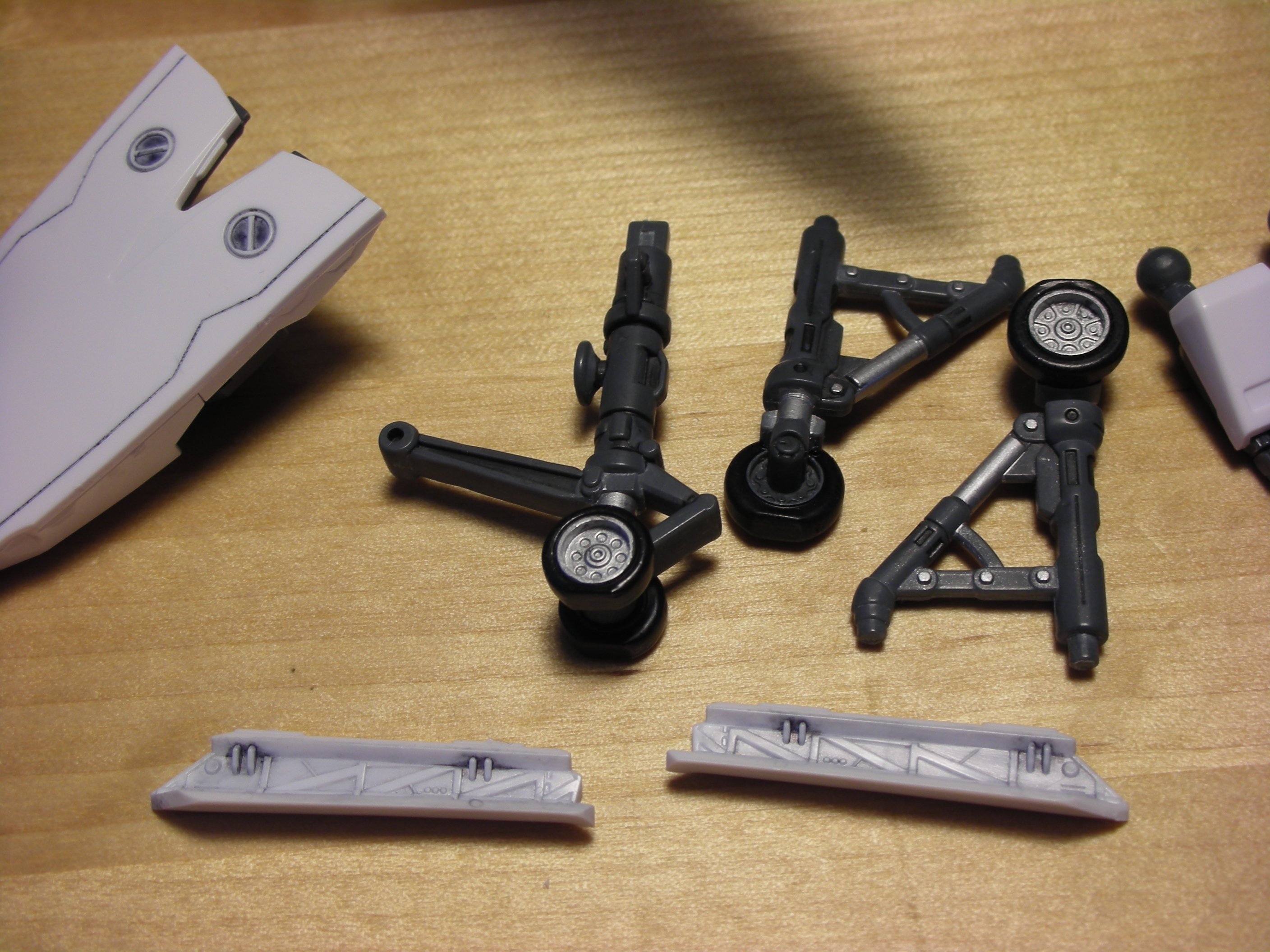

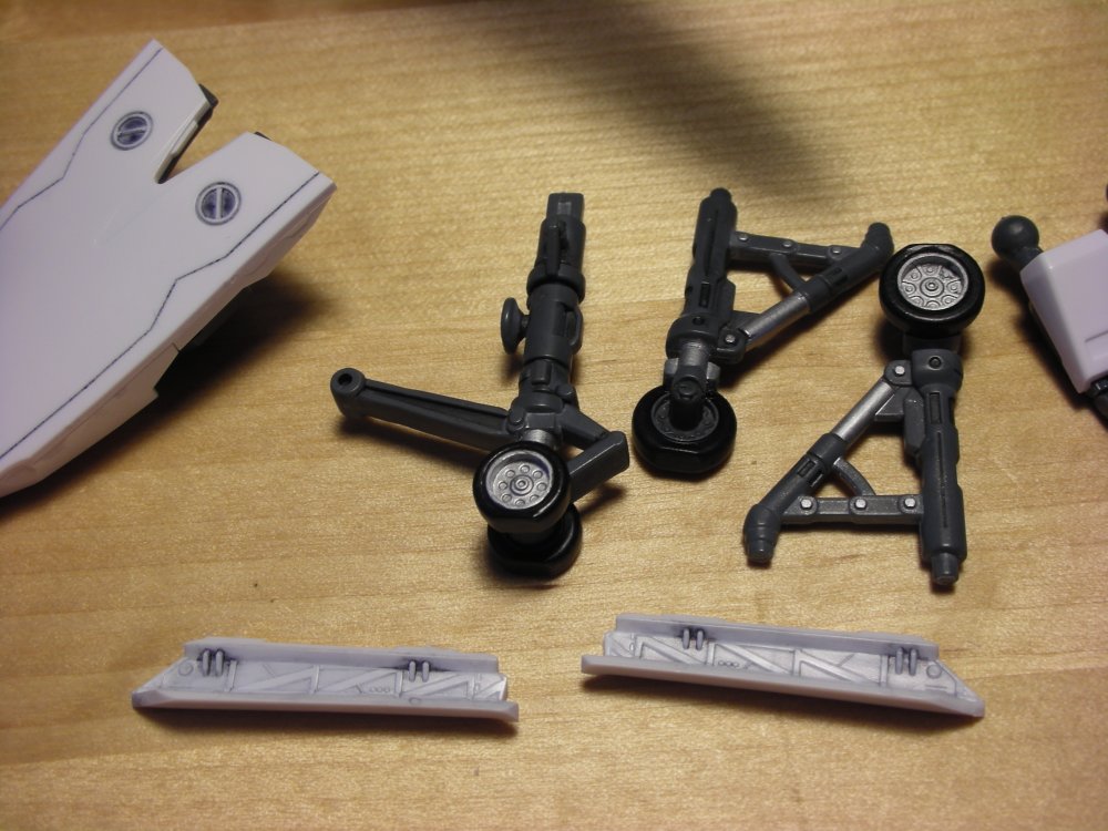

regult Posted October 6, 2008 Posted October 6, 2008 (edited) Graham, you have just given me "double woops" and this is no technical vocabulary...299 in Wanchai!! and confirmed my fear that I will not be able to apply the decals properly now that the thing is assembled. This is what I have so far: spent a lot of time trying to paint the landing gear, but Tamiya flat white just does not stick properly, so after repeated trial and error, decided to leave it unpainted, but had to do the hydraulics, rubber and hubs, also had to do some weathering and washing with gundam pens and/or black paint...looks so much better afterwards!! if the panel lines were not higlighted, the real seams would be distracting and too obvious. Another part that demanded a lot of time was the cockpit frame. I tried masking and painting, but then opted to go "commando" and rely on my "naked" hand. Alto hime was challenging too, I don't have the proper color, so he turned out to be a bit blueyish...he's too underscaled, which made it harder to paint. I decided to use decals instead of the stickers, have a hard time aligning them, so the decals will give me that extra time to nudge and adjust, but I guess without a clear coat I will be losing them pretty soon (?!) Edited October 6, 2008 by regult

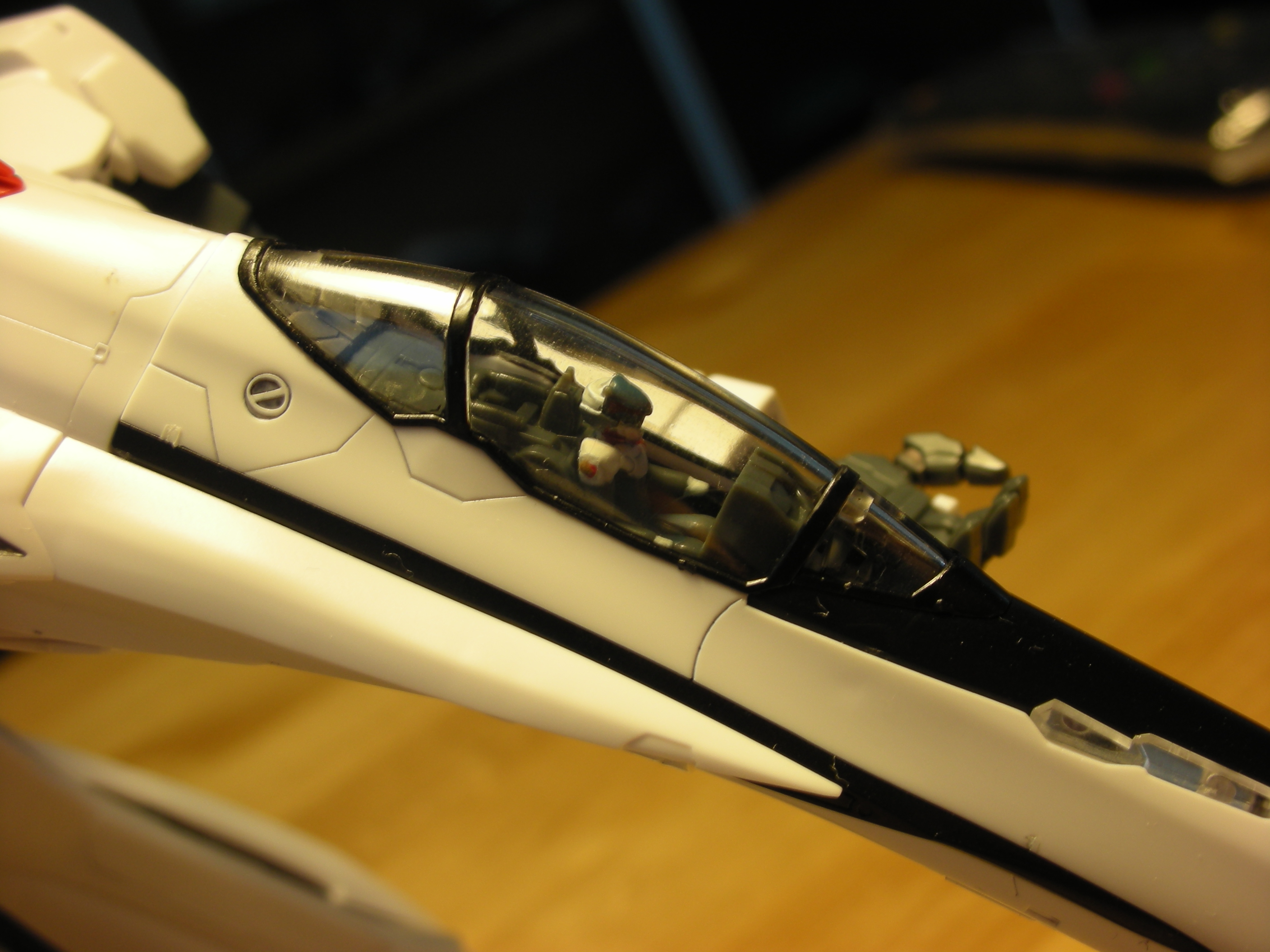

GGemini Posted October 6, 2008 Posted October 6, 2008 Yes, I used the Gundam marker for the circle-bar verniers. I also painted the visor, but I painted it on the inside, so the paint wont rub off. The paint is starting to rub off the canopy frame on mine. I also painted the bklack stipe on the front center chest plate and that started to rubb off afer one transformation, so I used the sticker, which looks pretty good. Graham "circle-bar vernier"... noted. That sticker (the one in the chest plate) is precisely the one I damaged trying to transform it... I hope it was a problem with the transformation and not because it's actually a part that will be rubbing against another. And yes, painting the visor from the inside gives it a very nice look to it @regult: nice work w/alto! I went for the "colored canopy" to avoid painting everything inside. Couldn't find clear purple-ish so I went with blue (as it was used in one of the kits shown here before) and it doesn't look bad at all
David Hingtgen Posted October 6, 2008 Posted October 6, 2008 I plan on free-handing the canopy---masking rarely works for those in my case. (though strangely, when I was like 12, I got an SR-71 canopy just perfect with magic tape) Anyways---any resin casters etc plan on making us an actual 1/72 Alto? I can deal with 1/72 pilots, but Alto seems 1/100 at best, which is beyond my ability to make look decent. PS----IMHO, the VF-25 has pale grey landing gear, based on the anime. They also don't have launch bars. And pale grey paint usually has MUCH better coverage than white paint. I'm going to remove the launch bar and paint the gear grey.

regult Posted October 6, 2008 Posted October 6, 2008 Regult, I notice from your pics, you haven't trimmed off the parts where you trimmed or cut the off the sprue. I think about a third of the time I took building the kit was taken up by using a scapel and file for trimming after I clipped the parts off the sprue. Don't have a scalpel, but did use a knife and tamiya modelling sand paper (up to 2000 grit only...), but probably some parts were forgotten or left imperfect because I was tired...I know exactly what you mean, I think I spent twice as much time doing the sanding and polishing than actual building...painting was also very time consuming. My wife kept telling me to enjoy the process (the "fun of it"), but I was just tired of gundam pens, trimming, thinner, washing the brush...I wanted to see the VF-25!! IMHO, the VF-25 has pale grey landing gear, based on the anime. They also don't have launch bars. And pale grey paint usually has MUCH better coverage than white paint. I'm going to remove the launch bar and paint the gear grey. I totally agree with you: I really didn't see any launch bars in the anime, and the landing gears are usually light grey or off-white. Actually, after posting the photos, I tried using one of the Tamiya flat grays but it didn't go too well either, maybe I should just leave it because I washed the landing gear with thinner too many times and I don't want to damage them. May consider cutting off that horrible, orversized launch bar. In one split second, forgot the episode sorry, you could clearly see Michel's valk's nose gear up close, and the wheels were into some kind of catapult (sorry, not sure what's the proper macross terminology), without the help of a bar.

wm cheng Posted October 6, 2008 Posted October 6, 2008 ... but Tamiya flat white just does not stick properly, so after repeated trial and error, decided to leave it unpainted... Hey Regult, what do you mean the Tamiya flat white doesn't stick properly? I plan of painting this sucker entirely when I receive this kit and I almost exclusively use Tamiya acrylics. Do I need to primer the entire model first? Flat white is tricky to get good coverage. Sometimes if the part is really molded in a dark plastic, I spray a grey primer first to bring up the shade and eliminate any color tint for the white to lay over - white never has good coverage, but also flat white is better than gloss white at coverage. So how does one glue the ABS parts? or is it designed so that the ABS parts don't need to be glued?

Jarrod Posted October 6, 2008 Posted October 6, 2008 Hey Regult, what do you mean the Tamiya flat white doesn't stick properly? I plan of painting this sucker entirely when I receive this kit and I almost exclusively use Tamiya acrylics. Do I need to primer the entire model first? Flat white is tricky to get good coverage. Sometimes if the part is really molded in a dark plastic, I spray a grey primer first to bring up the shade and eliminate any color tint for the white to lay over - white never has good coverage, but also flat white is better than gloss white at coverage. So how does one glue the ABS parts? or is it designed so that the ABS parts don't need to be glued? FWIW, the paint I used on mine was Tamiya acrylic, airbrushed, and it adhered with no problems at all. I've never primered any Bandai stuf, and never have a problem. As for glueing the ABS(at least the parts that need/could be glued) I've always just used plain old hobby super glue with no isues. This ABS isn't like the same kind of ABS that you'd find on an assembled toy, its feels and acts a bit more like model styrene. I've glued, sanded, and painted it the same as the rest of Bandai's plastic.
badboy00z Posted October 6, 2008 Posted October 6, 2008 Since acrylics are water based they tend to not coat properly if the part is not primed. I would suggest you wash the parts and apply some primer before the actual paint job. I personally like to use lacquer paints. They dry faster and sticks without primer but it's harder to clean up and more harmful to your health.
