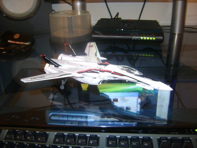

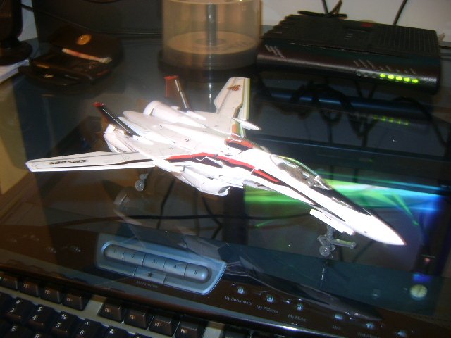

Graham Posted October 6, 2008 Author Posted October 6, 2008 Finished building and panel lining mine at the weekend. About halfway through applying the stickers. The stickers are actually extremely good quality. Nice and thin, with no border and they stick really well. As others have said, the kit is very solid in battroid mode, but really needs some locking pegs in fighter mode, as the legs do not lock onto anything. Also, the left wing-root gun on mine doesn't want to stay in position in fighter mode, leaving a big ugly gap. Haven't tried Gerwalk yet. Only painted a few small parts, such as the head lasers, canopy frame and PPB Knife blade, otherwise the left the rest of the kit unpainted. Used Gundam markers for the panel lining. I found through trial and error that the best way of removing the excess ink from the bare white plastic, was to just wipe it off with my fingers. Needed to rub quite hard, add the occasional dab of saliva (don't worry, I washed the parts afterwards with soap and water to remove any smell ), but I was really pleased with the end result. Overall, I'm very impressed with the engineering and design that went into this kit. What really surprised me was the amount of ABS parts in this kit (Probably about 50%, or most of the internal frame). I know it's been mentioned that Bandai is now using a lot of ABS in their recent kits, but it's new to me. From 1987 to 2002, I built a lot of Bandai Gundam models, and the ones from that period had none or minimal ABS parts. Looking forward to the Ozma kit, which has far fewer markings. Graham
