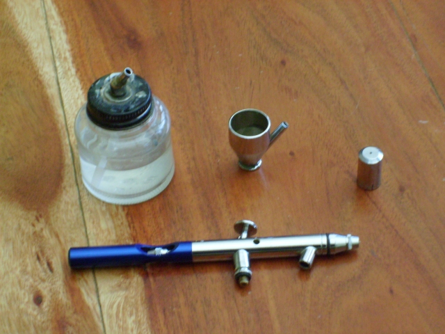

winterdyne Posted February 17, 2008 Posted February 17, 2008 (edited) I use a nu-air NAG700 compressor. Sounds like a motorbike, but has a nice big tank. Not really sure where the regulator came from. I use a Revell Profi-plus IDB750 dual action airbrush. Paint wise, Tamiya is I think best. Use Tamiya thinner, and thin with around a 80-20 paint-thinner for solid work, 40-60 for preshade, then 30-70 for overspraying (blending). You'll be wanting a lot of thinner. Buy the larger bottles, not jars. It's substantially cheaper. They're a bit difficult to get hold of, there was talk of being able to use iso-alcohol instead, but there are apparently issues with that. You can spray with GW acrylics, but they're not so well formulated for it. I thinned with water and a tiny amount of washing up liquid to break up surface tension. This also worked with vallejo acrylics. I will experiment with this more (given the difficulties with getting tamiya thinner) but to date I haven't dared try on anything expensive. Tools you'll need: Compressor WITH TANK, REGULATOR (pressure guage and outlet), MOISTURE TRAP, and 1/8" connector (I think that's the standard airbrush hose). Ensure the regulator can be closed and has a pressure release on the outlet so you can remove your airbrush (and or hose) whilst there's still air in the tank. Otherwise cleaning becomes a bit of an exercise. The guage, you just need to be able to read. Mine's in bars (~15psi/bar). Similarly, a marked regulator (settable in bars) helps. Various techniques call for different pressure settings. An airbrush - to start go with a single action (dual takes practice). These adjust paint flow by screwing the needle in or out of the tip, as opposed to levering the trigger. Internal mix (inside the body of the brush) is best to avoid spattering. External mix blow air across a small opening to draw paint up into the airstream. They spatter more. Get an airbrush that takes a small tube as a feed for paint - either a removable metal cup or a jar adapter fits into this. Airbrush hose - do not leave this attached to your compressor. Repairing it when it splits is a pain. Cheap and vinyl, or expensive braided. Your choice. Bear in mind that the braided hoses, although much tougher can still suffer from buckled connectors etc. Jars. Lots of little jars. Buy them from hobbycraft in the uk for about 60p. Also get jar adaptors (with a little tube!) that fit the top of the jar and have a connector for your airbrush. These are well worthwhile for cleaning, and dealing with mixed and thinned paint. You'll want at least half a dozen. Gloves. Latex gloves to keep paint off your hands and finger grease off painted surfaces. When you gloss with an airbrush for the first time you'll know why these are on the list. A Mask. Something to stop you breathing paint particles. Cotton buds / Q-tips. These are great! Use em to clean your airbrush (dipped in thinners) regularly. A wet q-tip fits neatly in the feed of a standard airbrush, and helps clean it out. Also used for cleaning up oilwashes etc etc. Cocktail sticks. Superglue to parts you're painting and use as handles. Stick em into a block of polystyrene foam as a quick and easy 'paint tree' to hold up wet parts. Use to mix paint, test consistency etc. Newspaper and 'spray boxes'. Unless you're using a paint booth you've built, chances are you're trying to paint on a table in your house. I use a shoebox, a document box, and a large house removals box as paint boxes. Those go on the table, and get lined with newspaper (taped on with cheap masking tape). Spray into the box (so it doesn't go all over your table / house so much), and toss in your crap like used sticks and q-tips. When finished, or it's too messy, just fold the paper in and bin it. No mess. Sandpapers. Yes, you may need to sand your paintwork if you get a nasty run or droplet. I use 1200 grit (DRY) for this, with very very little pressure. Make sure the paint is fully cured before trying to sand it. If it runs, finish the coat if appropriate and sand away the run once it's all dry. Unless working over a preshade, this usually works for me, even then the resultant weird colouration can be disguised with weathering. Masking tape - some cheap, some tamiya. I've not found any tape that compares to tamiya for actually masking on other paintwork. The cheap tape is for sticking newspaper to stuff mostly. Soft, long bristle paint brushes - Can also be used to pick up runs, and for removing dust. Patience - Your most valued tool. Read up on techniques for anything you're wanting to try (google airbrush preshading techniques, google the complete future), and test your hand with *your* airbrush on a bit of paper or old model before frustrating yourself on something costly. Think that covers it. Oh yeah, when you get an airbrush, take it apart, and put it back together at least 3 times. You'll want to be able to do that quickly to clean it once it starts spattering when you have a mix you can't quite remember in the cup. Edited February 17, 2008 by winterdyne Quote

winterdyne Posted February 19, 2008 Posted February 19, 2008 (edited) That compressor looks ok - small and quiet, and at the moment the bidding's pretty low. I think I've seen that model in a local model shop for around £200. Jar with attachment and removable cup. These fit both my airbrushes. As I said, you'll be wanting at least half a dozen jars, but you can scrape by with only a couple of the attachments for them - it just makes it easier to clean your brush by having one just for water, and another for paint. Airbrushing is one of those things where having the right kit (and enough of it) can make your life much easier. As for the brush (bristle brush), as long as the bristles are fairly long (>1/2") and soft, it doesn't matter too much. You need to be drawing the paint smoothly, not flicking or scraping it as it dries. Doesn't need to be sable (but synthetic brushes will be killed by cellulose thinner if you paint with lacquers) and doesn't need a fine point - this is for touching up without leaving brush strokes. It does need to be soft - keep it clean at all times. Unlike a fine-detail brush, where a little left over paint can help keep a stiff point, left over paint on it will simply mess your finish. Automotive emery papers are fine. 1200 for finishing / sanding coats or drops or runs, 600 for prep work, and 320 for being a butcher. Work wet on bare plastic, dry between coats and have a bigger soft dusting brush (ladies' blusher brushes (CLEAN) are ideal) for removing the dust. Edited February 19, 2008 by winterdyne Quote
