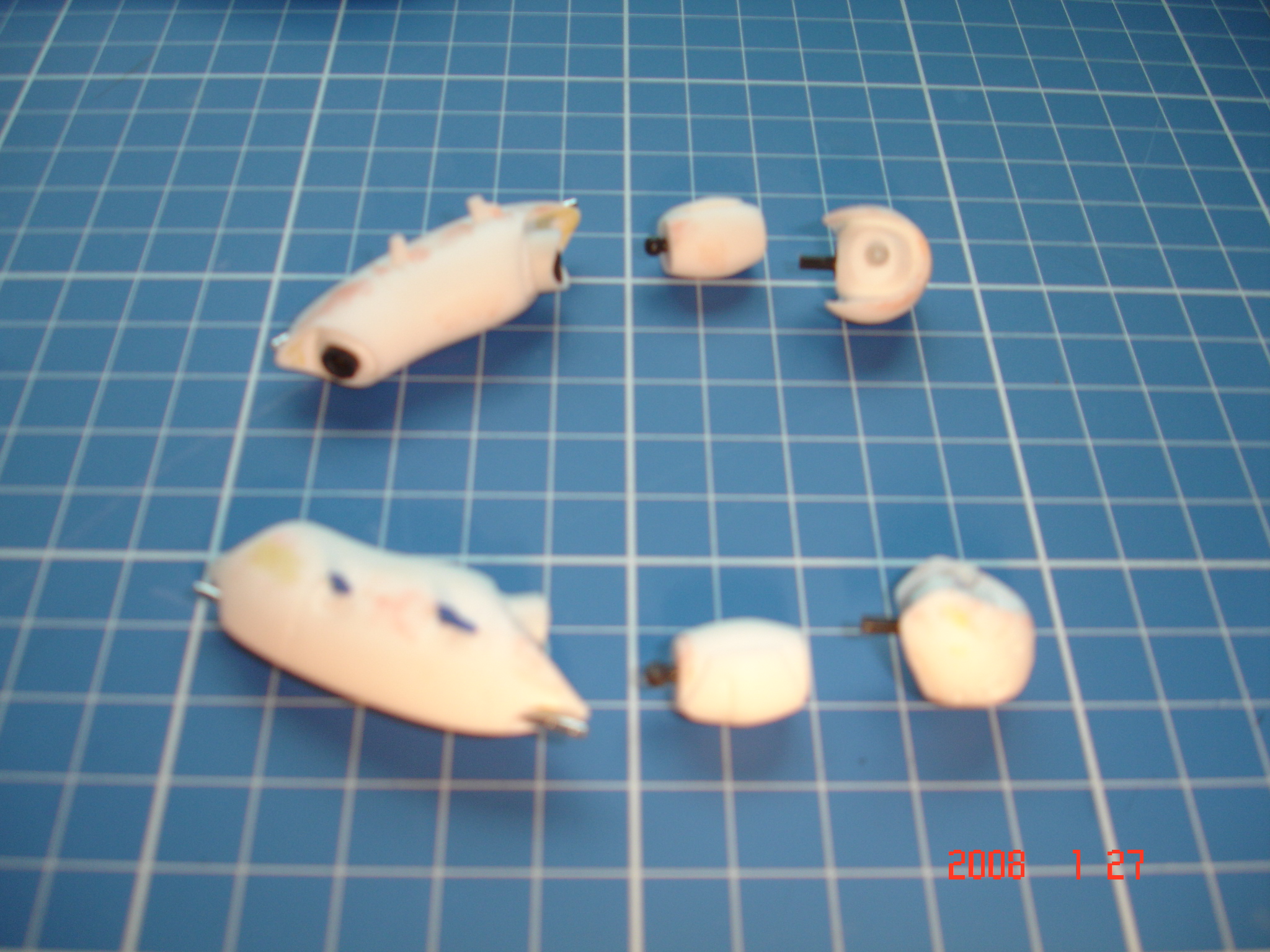

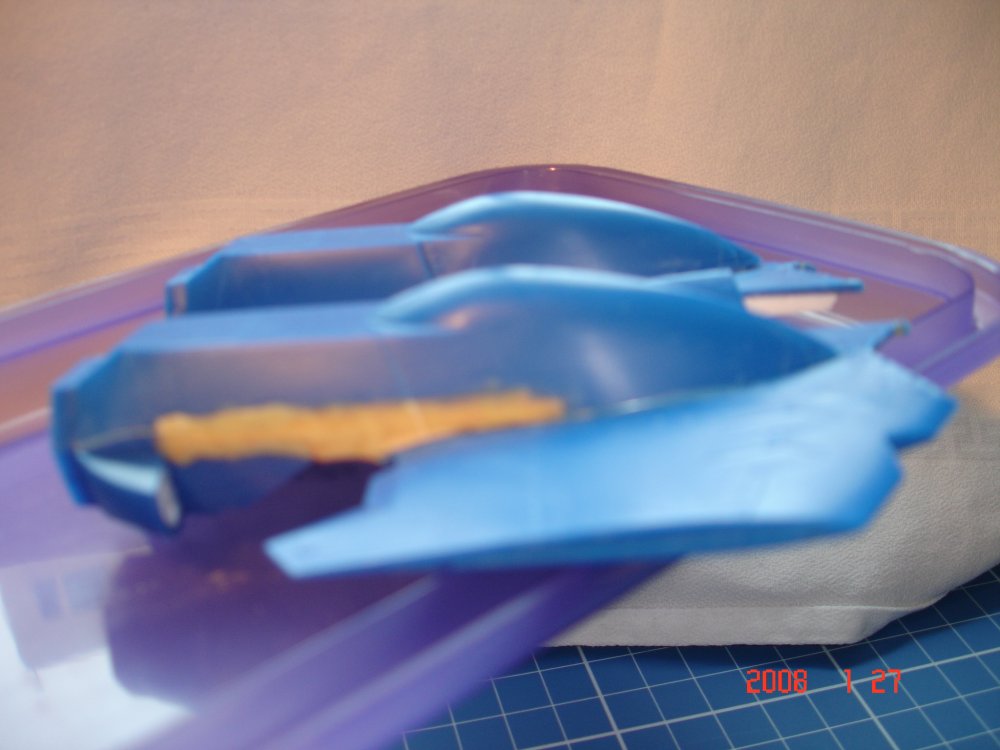

Hi, as promised in a post last week, attached are some pics showing the progress of the conversion of the Hasegawa 1/72 scale YF-21 to a YF-21/VF-22 Battroid. The resin parts were courtesy of the recast kit ("Gokigen-Seimitsu" conversion kit) from fellow MWer PsychoDynaMix. For your information, I have the original conversion kit (which I got off of a Yahoo! Japan auction a couple of years ago) and compared the two. The details and shape of some of the parts were different. I am wondering if there were multiple versions of these. I checked the photos of a WonderFest event from a few seasons back with completed battroids and it seemed that some parts were different for the YF-21 and the VF-22. At any rate, where I think lacked details, I used modeler's creativity to build in the blanks. Hope you like them. By the way, apologies for the low resolution/quality of the pics. Once completed, I will try to post with better resolutions.

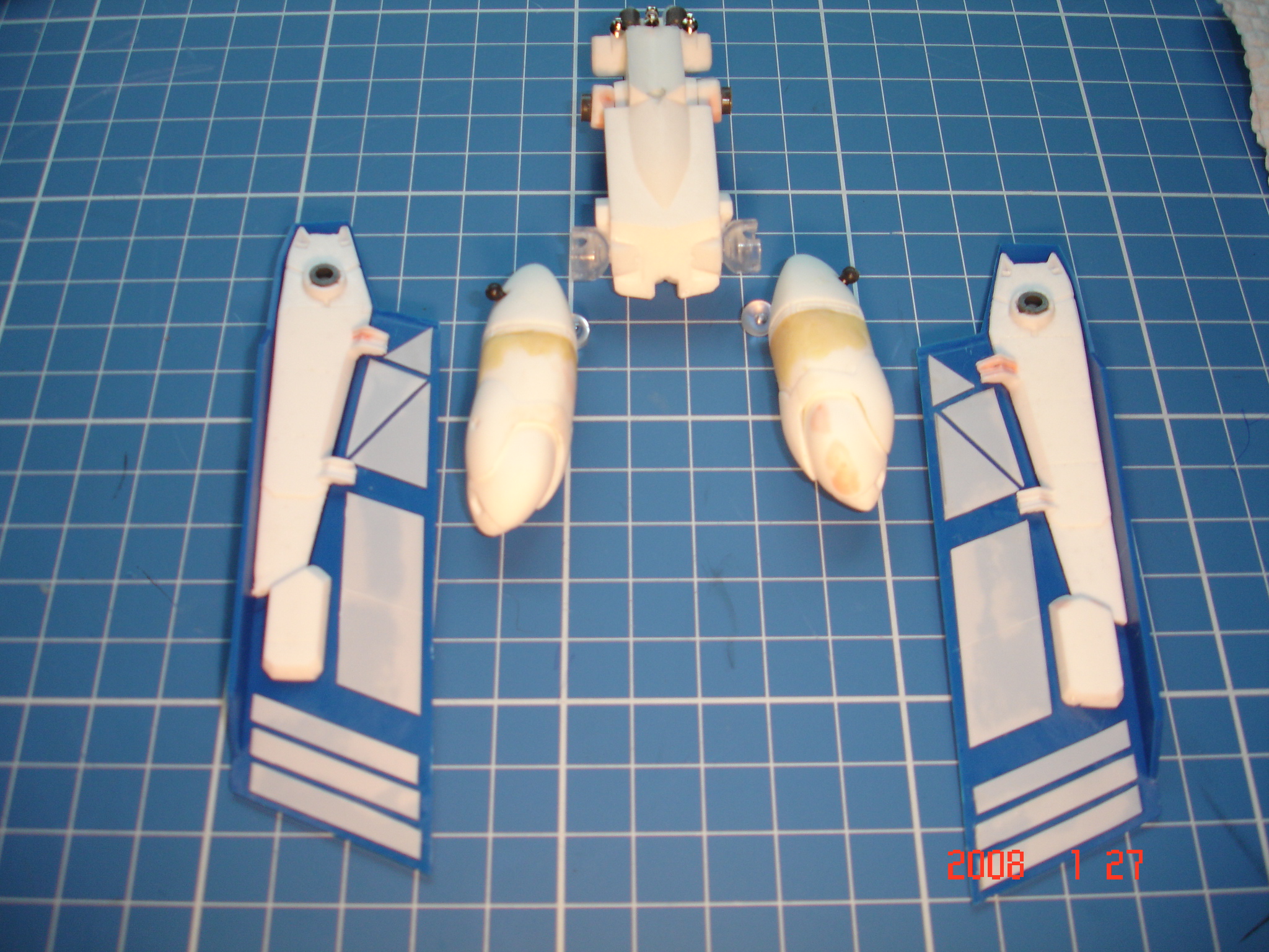

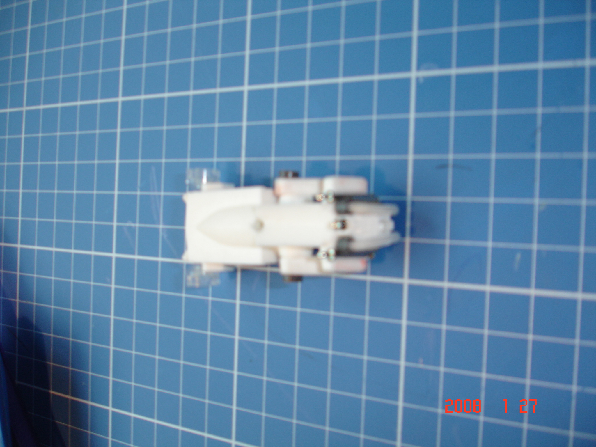

Above is the fuselage reshaped into the shorter Battroid mode. I followed the instructions to the letter but attaching the two main engine/burner covers was a pain. I filled in the blanks with epoxy putty, regular putty and resorted to a lot of sanding. Even the instruction says, use your modelling skills to achieve this. It would be nice if someone could just recast the shorter version of the fuselage. The instruction requires you to cut off a few panels in the lower body/hull to shorten it. But upon examining the linearts from KS, they are supposed to swivel and fold into a stack of slanted panels. Perhaps I will try that next time. The second photo shows the resin part with photoetched details I added.

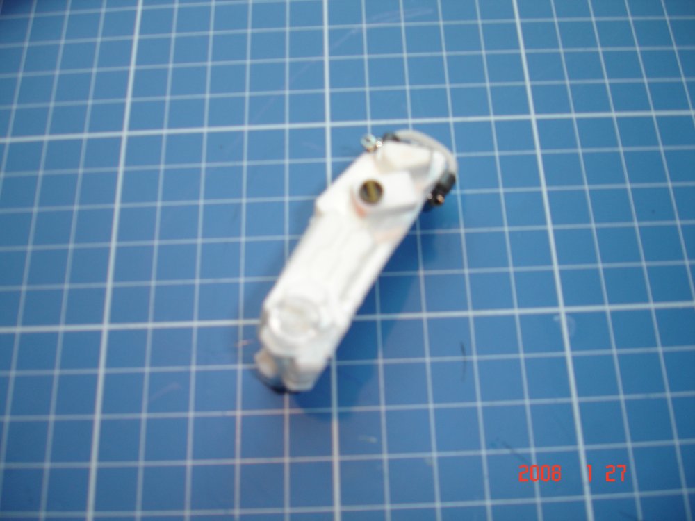

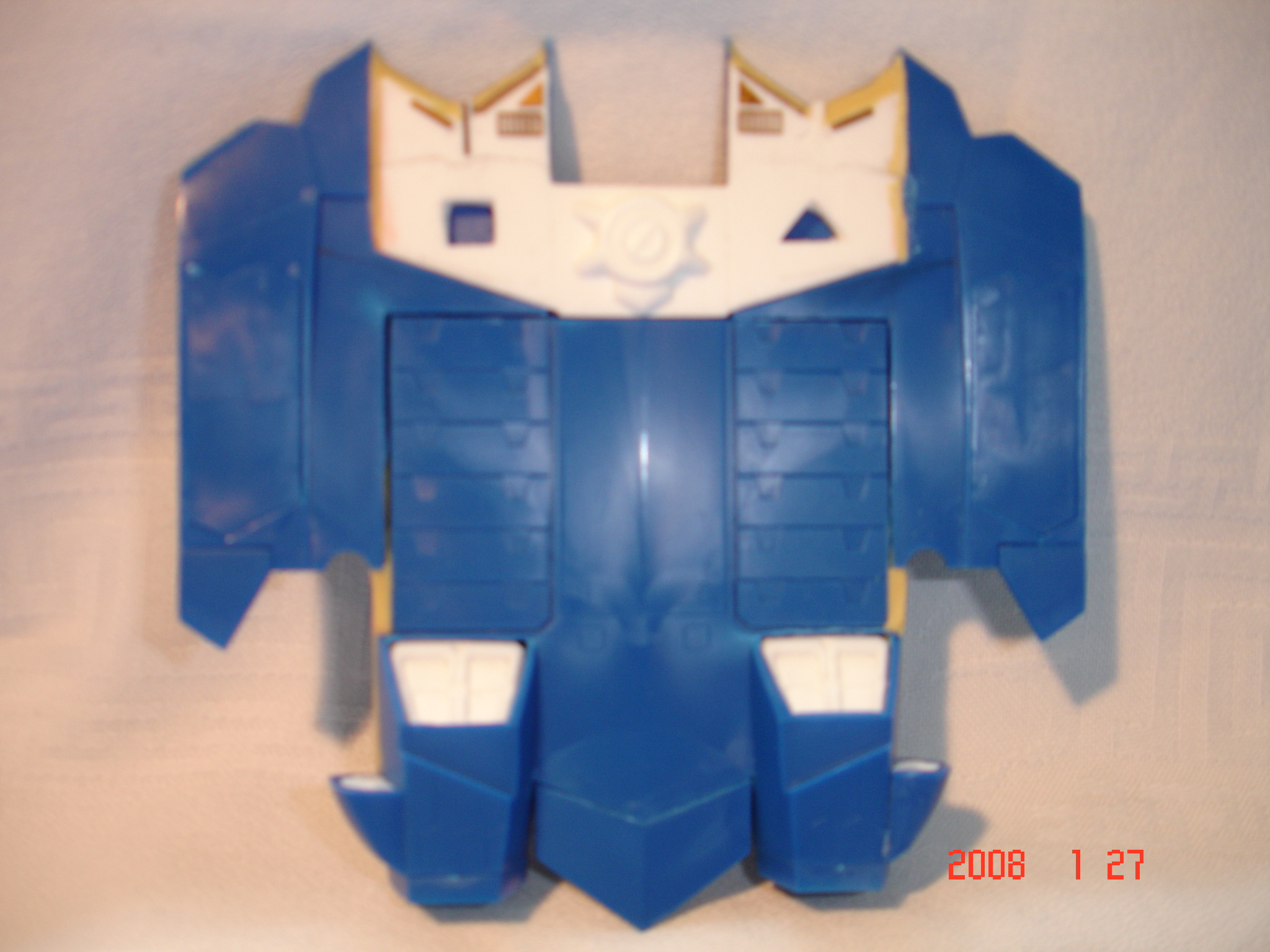

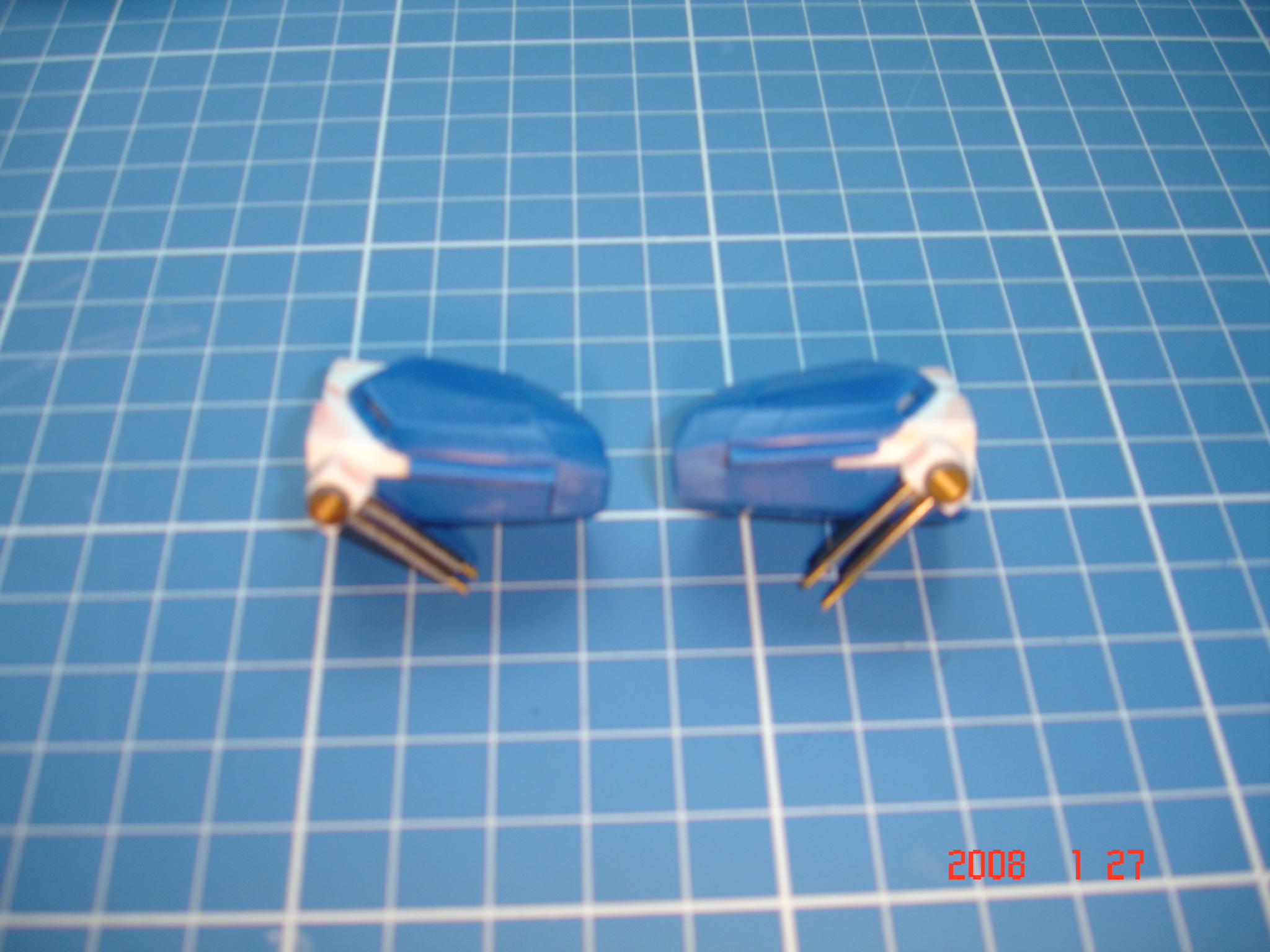

Above shows the body of the Battroid to which the limbs attach. As you can see (again, sorry for the poor picture quality), I have added ball joints for the legs, the shoulders and the head (Yellow Submarine - which I consider the best but quite hard to pull them apart once you attach them). I also added mecha option parts from Kotobukiya and photoetched parts for details as well as mesh pipes. The small recast parts to beef up the detail around the neck area were cast with too many bubbles and was impossible to clean up. So instead, I took some pipes and Gundam details to add hooks.

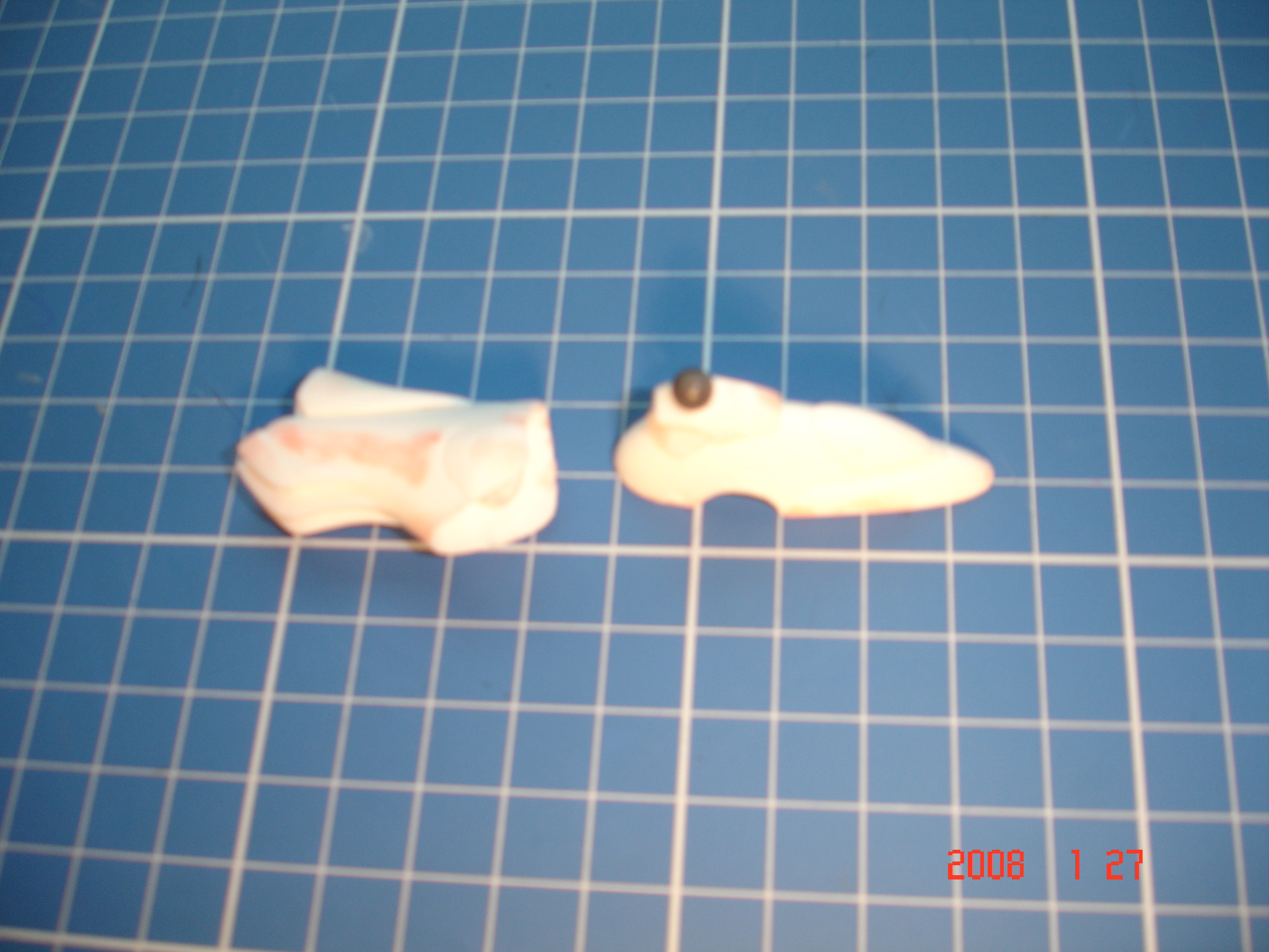

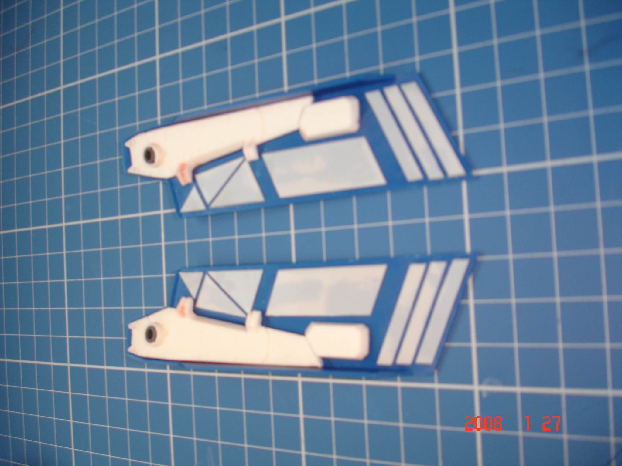

Above shows the two intakes. I didn't like the pipes that were recast so I replaced them with brass pipes and wire. By separating the two parts, it makes them easier for me to clean them up, paint and assemble at the end. These intakes are to be attached to the fuselage.

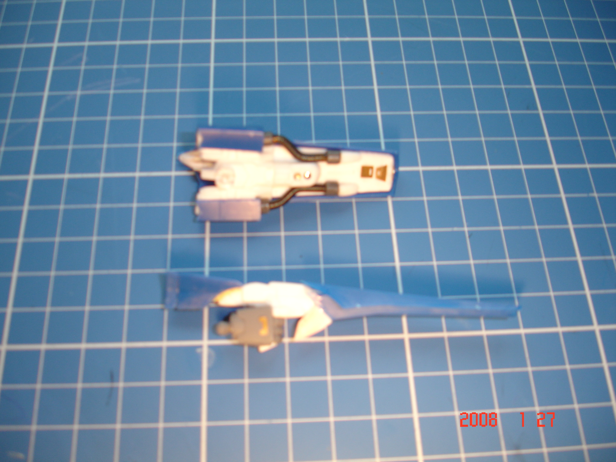

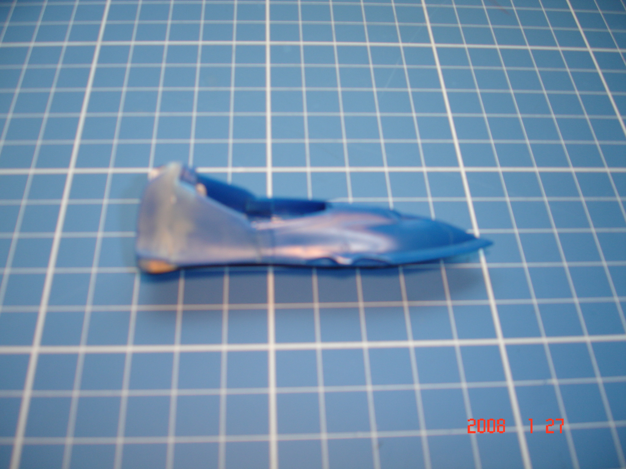

The lower side of the head unit with details I've added using springs, pipes, photo-etched and G-option parts.

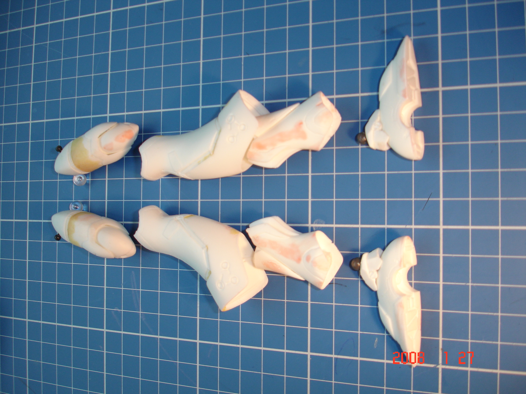

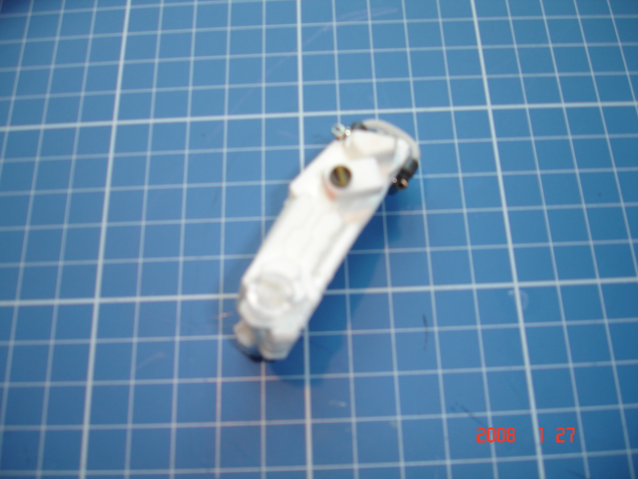

Above is the nosecone and the cockpit area which was sawed to shorten the length. Added epoxy and regular putty, after which a lot of sanding was done.
The shoulders and the arms of the Battroid. I decided last minute to add the elbow joints. Thus, the shoulder attaches to the intakes using a ball joint. The upper arm attaches to the shoulder using regular poly cap. The lower arm with a scratch built elbow area (8 mm pipe and ball joint poly cap (Wave)) attaches to the upper arm using a ball joint. The hands (not shown in the picture - a 1/144 Gundam resin manipulaters) attach to the lower arm using ball joints (Wave).
Above are the pics showing the legs and the joints. As previously discussed on another post, I decided not to make the knee joints move. Firstly, to preserve the linearts of the beautiful leg design as much as possible and secondly, for fear that anything short of a metal screw would not hold up the weight of this model. I believe another MWer had thoughts about this piece so I am open to suggestions. However, I did use the largest ball joints (Yellow Submarine) to attach the thighs to the body and the ball joints to attach the feet to the ankles.
Above are the pics of the shields that will be attached to the outer side of the thighs, again, using ball joints. Details were added on the inner panel using sheet styrene.

I spent an hour last night fine-tuning the details (and more sanding) as well as adding the details and hinges for the wing part that folds. Initially, I was thinking of using photoetch hinge detail to make the wings workable. But given that the fuselage is attached to the torso and can't move, thus, the wings won't be able fold out and fold in anyway, I gave up on this idea. Instead, I added a thin layer of epoxy putty and ran a pattern using the outer barrel of my pin vise :rolleyes: and added hinges (photoetch and kotobukiya option parts).
