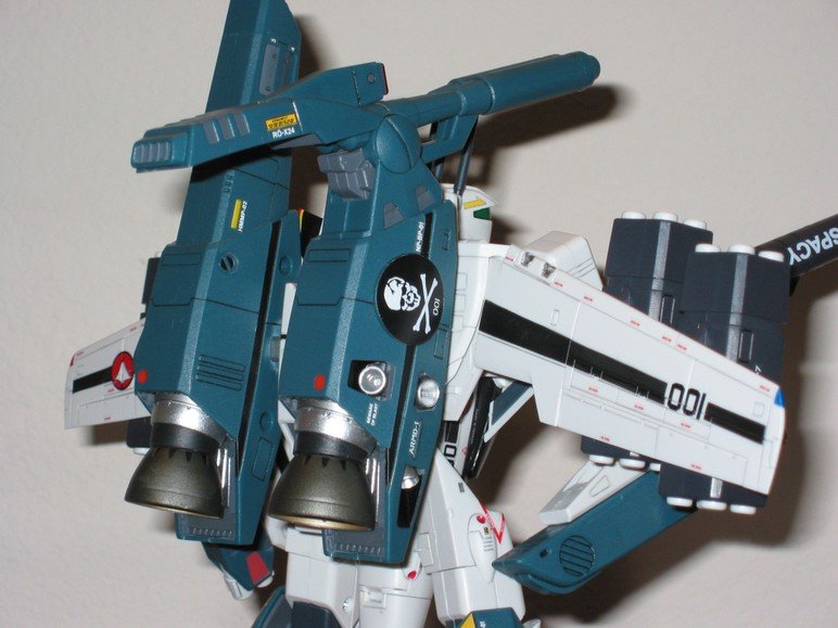

sqidd Posted September 23, 2007 Posted September 23, 2007 I'm sure this is somewhere, but does anyone have som buletproof instructios on how to panel line? I need to do a few of my Valks. That looks great! Quote

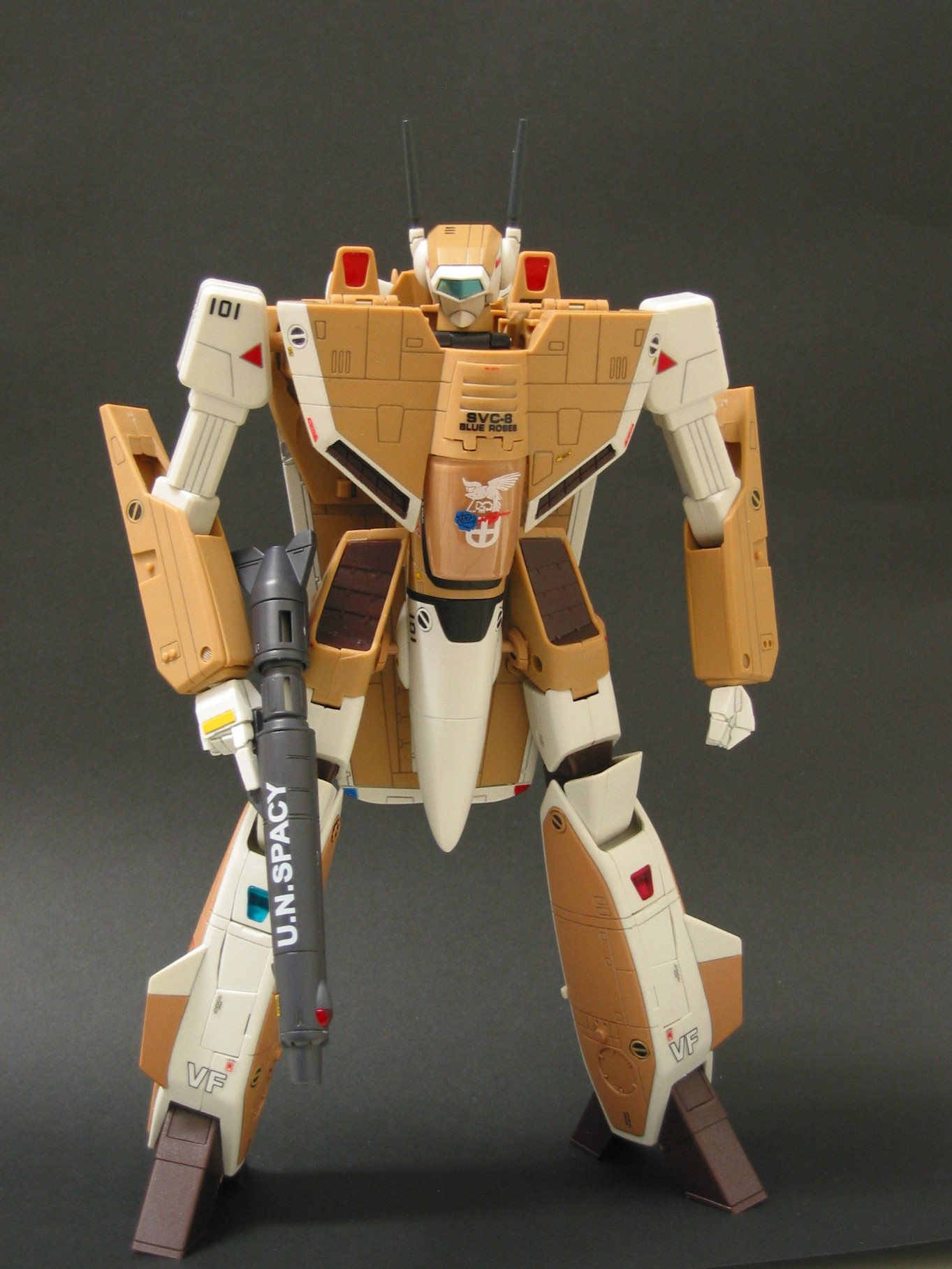

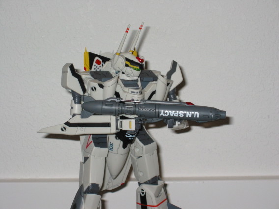

ghostryder Posted September 27, 2007 Posted September 27, 2007 (edited) Great... So I'll by 2 Gundam Markers (Black and Gray) and 2 copics (Black and Light Grey) to see which are better and for the future. Did I understand it right that I have to clear coat when using Gundam Markers and Pencils, but not if if I used copics? Seriously, for a white valk and your first time, go with a 0.03mm mechanical pencil. For the little amount time it will take you, the results will be fine and you do not need to clear coat. I play with my valks, and the panel lines do not rub off at all. Take a look at Swoosh's M&M VF-1Js in the "strike a pose" thread for a better visual. This full frontal of my avatar valk will also give you a better idea of what pencil looks llike: Edited September 27, 2007 by ghostryder Quote
Lukas Posted September 27, 2007 Posted September 27, 2007 Wow... looks really good for the amount of work it should take. And Swoosh's M&M valks were panel lined with a mechanical pencil too? I think I'll do it this way than... But just to understand the difference. Why do I have to clear coat panel lines made with a copic oder gundam marker, but not the ones made with a mechanical pencil? It's quite the same for me (noob haha). ^^ Quote
ghostryder Posted September 27, 2007 Posted September 27, 2007 (edited) Wow... looks really good for the amount of work it should take. And Swoosh's M&M valks were panel lined with a mechanical pencil too? I think I'll do it this way than... But just to understand the difference. Why do I have to clear coat panel lines made with a copic oder gundam marker, but not the ones made with a mechanical pencil? It's quite the same for me (noob haha). ^^ If you use a very thin lead pencil (0.3mm), the lead should be deep enough in the panel groove such that your fingers will never touch it. I guess some people use thicker lead, and have rub-off issues? Keep in mind, pencil lead darkens quite a bit if you clear over it. So by not clear-coating, you will have ultimate control over the final darkness of the line. I forgot to mention, an easy way to panel line darker plastic (fastpacks, gunpods) where pencil might not show up too well is Sakura Pigma Micron pens (0.25mm). These are alcohol-based artist pens that clean up with spit/water when applying, but stay on pretty well after drying. Here's some examples of the Pigma pen on fastpacks and gun (these were my first attempts, so don't laugh): Edited September 27, 2007 by ghostryder Quote
Lukas Posted September 27, 2007 Posted September 27, 2007 Looks good too. But still the one question... why not to use gundam markers oder copics (0.02mm) without coating? Should be the same as with the pancil. As long as I don't touch or rub IN the panels its okay, isn't it? Quote
ghostryder Posted September 27, 2007 Posted September 27, 2007 Looks good too. But still the one question... why not to use gundam markers oder copics (0.02mm) without coating? Should be the same as with the pancil. As long as I don't touch or rub IN the panels its okay, isn't it? You can do either, assuming the paint line isn't so thick as to make contact with your fingers while handling. You can always paint without clear coating and see if it stays on. If it doesn't, touch up the panel lines and clear coat. IMO, if you use stickers and you handle your toys, clear coating isn't worth the trouble. Quote
