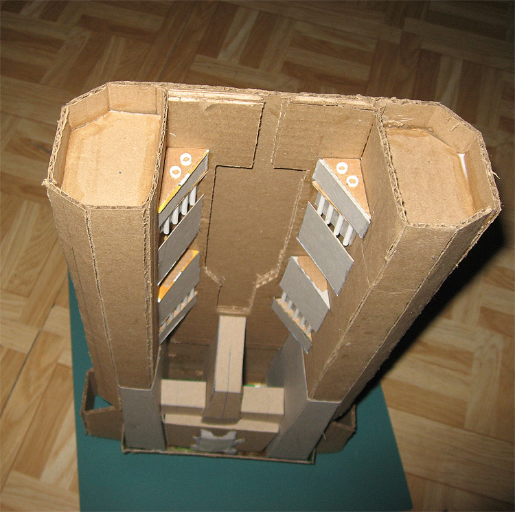

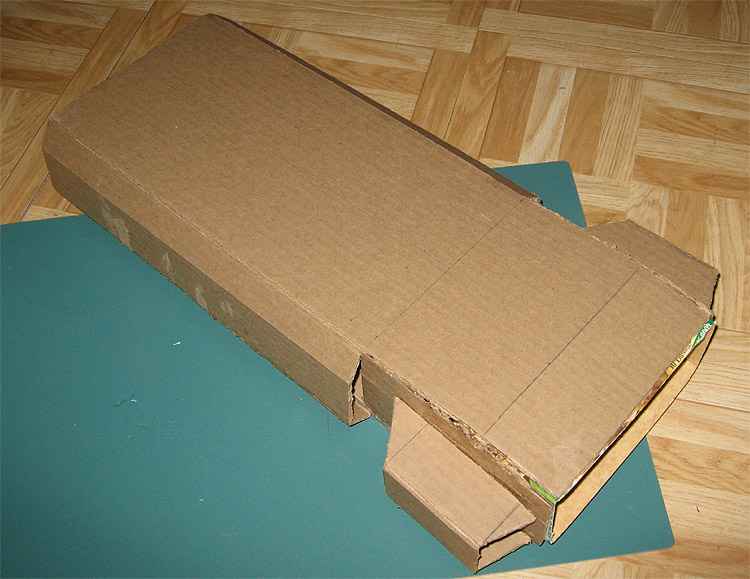

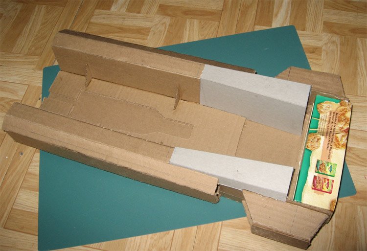

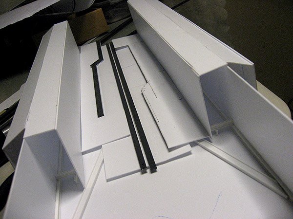

007-vf1 Posted August 20, 2007 Posted August 20, 2007 I started this project a week or so ago and about 12 hours later this is how far I have got. Yeah is virtually not much but taking continue measurements and recalculate scales is a pain. I am using a small scale print copy since I couldn't blow the original line-art bigger on a copy machine; and making a correct scale hand drawing with that many details would take me several hours that i rather spend building.. Quote
mechaninac Posted August 20, 2007 Posted August 20, 2007 Ooh, cardboard modeling... groovy. Looks like an ARMD so far; great work from very bad source material. Quote
MechTech Posted August 21, 2007 Posted August 21, 2007 That looks great so far. I empathize with your scratch building efforts. You still can do it really cheap in styrene if your interested. Buy a sheet of 40" x 72" for $11.48 (link). It's easy to work with and the painted surface will be smooth, and not so "corrugated." You could also plate what you've done in thin styrene too. Just some helpful, humble advice. - MT Quote
007-vf1 Posted August 21, 2007 Author Posted August 21, 2007 Mech; yeah my idea is to plate it in styrene after I am done with it. the corrugated parts have to be hidden. I am building this model as a mechanical structure there are support pillars inside the hollow areas so is tedious... Thanks for the tip on the big styrene sheet.. Any suggestions are appreciated a little update I made 3 hours later Quote
MechTech Posted August 21, 2007 Posted August 21, 2007 That's cool. I'm not sure what you can use to get the styrene to stick to it. I've used contact cement for paper to styrene (pattern cut outs). The glue just has to be dry or it'll attack the styrene. UHU makes styrene compatible craft glue. Good ole white glue doesn't stick well to styrene either. Once the panels are glued together it won't really matter though. Have fun! - MT Quote
007-vf1 Posted August 23, 2007 Author Posted August 23, 2007 That's cool. I'm not sure what you can use to get the styrene to stick to it. I've used contact cement for paper to styrene (pattern cut outs). The glue just has to be dry or it'll attack the styrene. UHU makes styrene compatible craft glue. Good ole white glue doesn't stick well to styrene either. Once the panels are glued together it won't really matter though. Have fun! - MT You know what..?? I didn't think of that. I have seen a few cardboard models lately and got me pumping. I didn't realize I'd be limited with that medium. I won't even be able to glue any putty on it and work some curvy and tubing elements that would become difficult on cardboard; let alone detail it the way I think I might be going to...and yes, although I used a combination of glues it didn't stick as strong as I wanted it to be. I took your suggestion and ordered a few sheets. But I was looking into the .080" which is as thick as I'd like it to be and realized is quite pricey. So now I'll have to combine a thinner sheet and work more into the inner structures to keep it sturdy enough. That's what I liked about cardboard in the first place...it was sturdy enough, glued super fast and was way cheap to obtain... At least now I have a good template to cut the styrene pieces in and wont take me 15 or so hours to get to that point... so the project is on hold until i get the new material... Do you know how easy modeling foam bonds to styrene, and if it is easy to putty on?? Quote

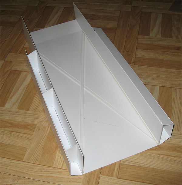

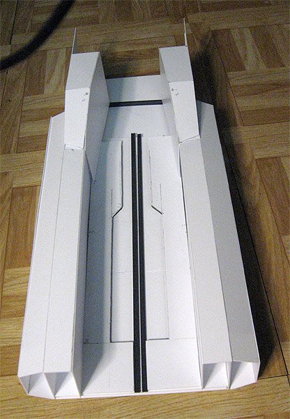

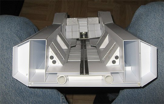

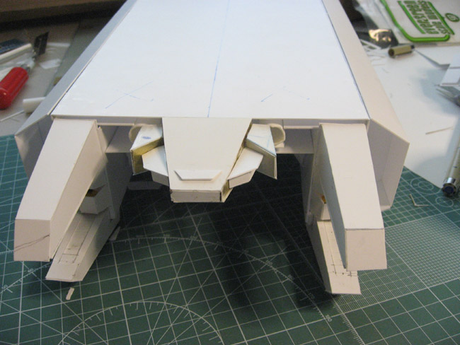

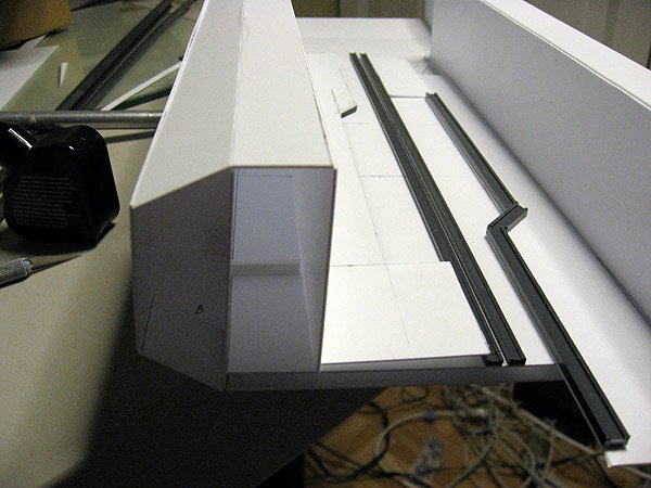

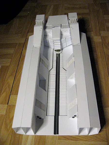

007-vf1 Posted August 31, 2007 Author Posted August 31, 2007 Update 8 -30 Finally...! I am slightly beyond the point I was before switching to styrene... After glued I realize I had to dismember the build in 2 parts to add more detail to the under structure. Good thing I weld the plastic lightly to see how it looks.. By the low detail pics available I had to create the end of the middle beam that connects to the long longitudinal rail and figure what exactly was. All i could come up with is a sort of viewing tower which hangs of the ceiling I added some clear styrene and sort of came up the way I wanted to and added some inner structure alike a command operation room.. If you see the detailed pic you can barely make it up except that it reflected the light of the room so might be easy to see what i was talking about... Those tubular structures along the side walls were such a pain in the behind, I wish I had a better process to cut tubular styrene lengthwise...took forever to get it.. The pieces in the center back structure are loose hence they seem to be off alignment... Quote

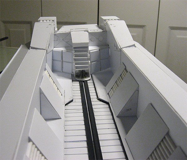

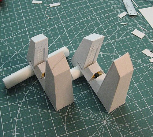

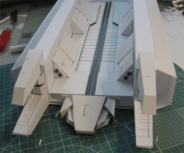

007-vf1 Posted September 20, 2007 Author Posted September 20, 2007 (edited) Well, well one little update... The front forks got finally done. biggest mishap was to have to increase the thickness of the platform since it was too thin. to fit the frontal "command" nose.. luckily the styrene wasn't glued tight shut so it took just a bit of a struggle. Now I can imagine how handy must be to have the machinery J. Moscato uses to get things done quickly. Edited September 20, 2007 by 007-vf1 Quote
