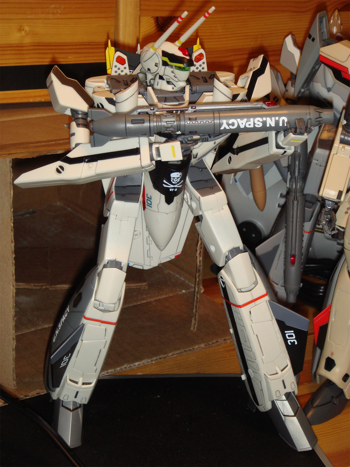

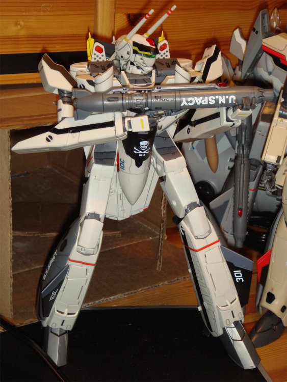

Grand Admiral Posted August 11, 2007 Posted August 11, 2007 I've had good luck with a fine-tip Gundam Marker. http://www.gundamstoreandmore.com/gundammarkers2.html Here's a picture of my stealth VF-1J. It doesn't show up all that well in the photo, but you can see them a bit. I used a black marker, but on one of the white fighters I'd recommend a gray or light brown. Quote
