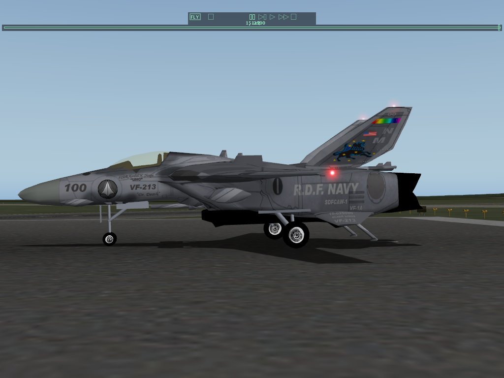

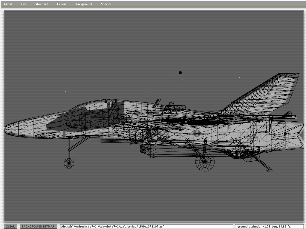

l_e_m Posted July 27, 2007 Posted July 27, 2007 (edited) This is my first post, and I wanted to let anyone know who is interested that I am almost finished with the Valkyrie. The flight test team and I have a few issues yet to work out with the flight control logic along with carrier suitability. I used Macross source material to construct a rendition of the Valkyrie. I used the elements that worked, removed those that didn't, and made alterations for the sim's capabilities. Overall, I am satisfied with the design, and I hope everyone else is too. The paint scheme is reminiscent of what is seen on the X-35C demonstrator with a few tweaks here and there. I am sorry that this is Robotech Valkyrie, but it is still a Valkyrie. No one is perfect I guess. Here is the technical data on the flight model. I am sorry for the length. VF-1A-35 Test Data All measurements are approximate figures. Tests were performed with GU-11 on centerline at 34,651 lbs (airport 26 C, 30.04 in Hg). Class: 1st Generation Veritech/Variable Carrierborne Variable Geometry Aerospace Multi-Role Fighter Service: RDFN (UNN), RDFS (UNS), RDFM, RDFAF (UNSAF), TASC, TAF, EFS, EFAF, EFM Height (on gear): 14.68 ft. (-0.95 deg) Length: 47.5 ft. Wingspan (unswept, 20deg): 48.76 ft. Wingspan (swept, 60deg): 32.28 ft. Aspect ratio (unswept): ~5.33 Aspect ratio (swept): ~<2.00 Cruise L/D (35,000 ft, 0.80 Mach): 5.8:1 Max Cruise L/D--VG override (35,000 ft, 0.80Mach): 7.6:1 (L/D is a mark of subsonic aerodynamic efficiency.) Weight (empty): 29,000 lbs Weight (combat, typical): 35,700 lbs [12 AMM-1 Stilletos, 1 GU-11] Weight (maximum): 45,000 lbs Weight (typical D20, 50% fuel): 300 lbs [enough to maintain limited LEO, SFC .01 lbs/hr] Engines (atmosphere): 104,000 lbs [overboost, 200%], 52,000lbs [military, 100%] Engines (space): 104,000 lbs TtW (military, atmosphere, typical combat weight): 1.46: 1 TtW (military, atmosphere, GU-11 on centerline): 1.60: 1 Max Speed (1,000 ft. AGL, overboost): Mach 1.35 Max Speed (10,000 ft. AGL, overboost): Mach 1.88 Max Speed (30,000 ft. AGL, overboost): Mach 2.50+ Max Speed (60,000 ft. AGL, overboost): Mach 4.50+ Speed (1,000 ft. AGL, military): Mach 1.00 Speed (10,000 ft. AGL, military): Mach 1.10 Speed (30,000 ft. AGL, military): Mach 1.88 Supercruise (40,000 ft. AGL, military): Mach 1.90+ Maximum Service Ceiling: > 400,000 ft. Take Off Speed (military): 120 knots Vunstick: 135 knots Carrier Landing Approach: 135 knots, 8 deg AOA Stall Speed (generalized): 100 knots, 18.5 deg AOA Time to Atmospheric Ceiling (takeoff to 120,000 ft, overboost, not in reaction mass mode): 99 s Climb Rate (during atmospheric ceiling climb): 72,727ft/min+ Note: Climb rate during atmospheric ceiling is less actually than climb rate in atmosphere due to the engine's power loss in thinner air and the vacuum. Models -J and -S with an additional 6,000 lbs thrust combined in military and 12,000 lbs in overboost should have a better than marginal climb rate when compared to the -A. The following is representative of the final performance of the airframe with full consideration of a humanoid operator. FBW Instantaneous G-Load (350knots, 10,000 ft. AGL): 8.5 G FBW Maximum Roll-Rate (350knots, 10,000 ft. AGL): 310 deg/sec FBW Maximum Roll-Rate (550knots, 10,000 ft. AGL): 170 deg/sec FBW Best Instantaneous Turn Rate 180 deg turn (500 KIAS, 1,000 ft AGL, military): max 9.5 G, ~27 deg/s (stall) FBW Best Sustained Turn-Rate 360 deg turn (400 KIAS, 1,000 ft AGL, military): 9.5 G, ~20 deg/s FBW Best Instantaneous Turn Rate 180 deg turn (400 KIAS, 10,000 ft AGL, military): max 9.0 G, ~25 deg/s (stall) FBW Best Sustained Turn-Rate 360 deg turn (400 KIAS, 10,000 ft AGL, military): 8.0 G, ~19 deg/s FBW Best Instantaneous Turn Rate 180 deg turn (400 KIAS, 30,000 ft AGL, military): max 9.0 G, ~16.5 deg/s (stall) FBW Best Sustained Turn-Rate 360 deg turn (400 KIAS, 30,000 ft AGL, military): 5.5 G, ~11 deg/s Models -J and -S with an additional 6,000 lbs thrust combined in military would potentially have better performance throughout the entire flight envelope but especially at higher altitudes. Maximum Controllable AOA: +55deg/-30deg Structural G-Limit: +11.5 G/-5.5 G FBW G-Limit: +10.5 G/-4.5 G Flying Controls: Valkyrie has a redundant fly by light control system. The main wing is a two section fowler flap (flaperons out board, flapervators in board) with spoiler/speedbrake that occupies the entire trailing edge with full leading edge slats. Midbody LERX has wing fence and conventional outward canted vertical stabilizers with center mounted rudder. Two-dimensional thrust vectoring (20 deg pitch, 10 deg roll) replace conventional tailerions. Assorted vernier thrusters assist in pitch control in atmosphere, and three dimensional thrusters provide attitude control in a vacuum. One pair of small ventral mounted strake elevators to assist in correcting pitching moments, and there is a speedbrake stored behind the fuselage's cockpit. On a further note, you can watch a demo video of an older version of this flight model here @ http://www.youtube.com/watch?v=NUuLtNFa0N0 You can download the model here @ http://forums.x-plane.org/index.php?automo...p;showfile=3545 Edited November 12, 2007 by l_e_m Quote

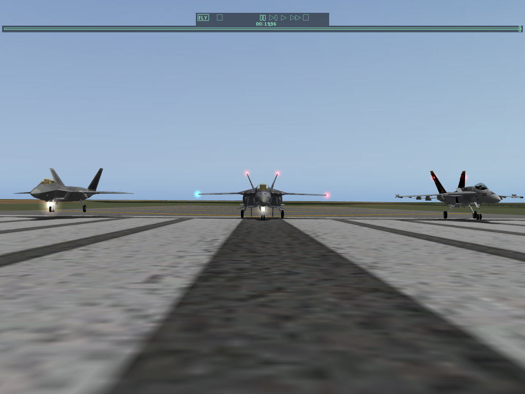

l_e_m Posted July 30, 2007 Author Posted July 30, 2007 (edited) looks like you squished it in that picture. It's according to scale. (The featured fighter on the left is a F-22A; the one on the right is a F/A-18E.) Sub fifty foot fighters often look "squished," at least to me. Maybe, it's the angle. Edited July 30, 2007 by l_e_m Quote
Knight26 Posted July 30, 2007 Posted July 30, 2007 You're visual model looks way off, too fat overall, what did you use for reference and what program are you "flying" this in? Quote
l_e_m Posted July 30, 2007 Author Posted July 30, 2007 That's your opinion. Macross.anime.net X-Plane 8.60 Quote
Lonewolf Posted July 30, 2007 Posted July 30, 2007 That's your opinion. Macross.anime.net X-Plane 8.60 Sorry to rain on your parade mate, but the proportions DO look off. Nice modding nonetheless. Quote
l_e_m Posted July 30, 2007 Author Posted July 30, 2007 Sorry to rain on your parade mate, but the proportions DO look off. Nice modding nonetheless. I don't take constructive criticism personally. Where are the proportions off? Does anyone have a picture of a model of a Hornet and a Valkyrie for a basis of comparison? Quote
Lonewolf Posted July 30, 2007 Posted July 30, 2007 I don't take constructive criticism personally. Where are the proportions off? Does anyone have a picture of a model of a Hornet and a Valkyrie for a basis of comparison? Well I can't provide you with a comparison between a F-18 and a VF-1, but I can supply you with this. I too the pic from here. It's from the model section from the main site. Quote
Mr March Posted July 30, 2007 Posted July 30, 2007 Perhaps, the Macross Mecha Manual can be of some assistance Quote
Lonewolf Posted July 30, 2007 Posted July 30, 2007 Yeah, those could be used as great reference source for your project. Quote
l_e_m Posted July 30, 2007 Author Posted July 30, 2007 Yeah, those could be used as great reference source for your project. Thanks. I'll post some corrections soon. Quote

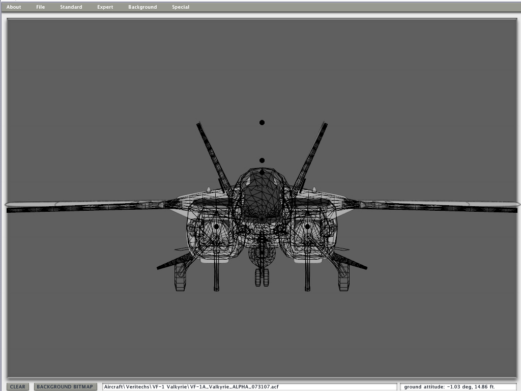

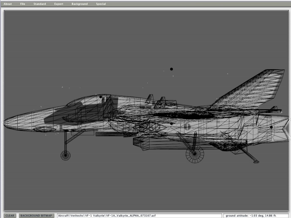

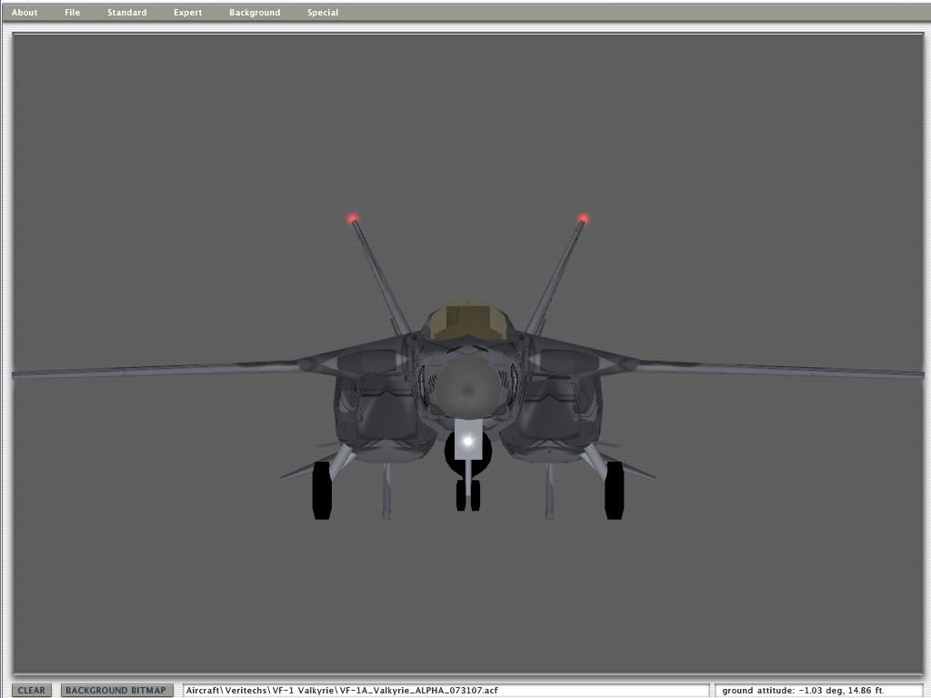

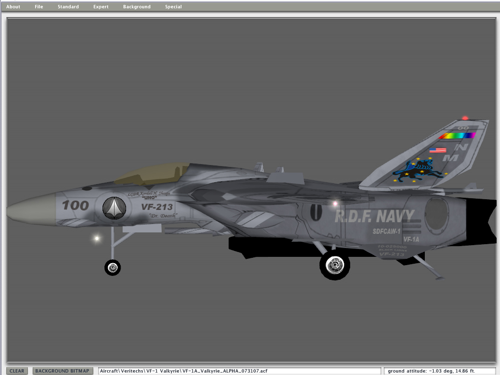

l_e_m Posted July 31, 2007 Author Posted July 31, 2007 I think these are pretty close. There are some things like wing dihedral and twist that I will not change. Quote
Lonewolf Posted July 31, 2007 Posted July 31, 2007 It looks better. Nice modelling skills display. Quote
