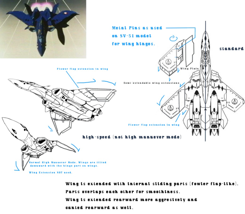

Hayabusa Posted August 7, 2007 Posted August 7, 2007 (edited) Vic Mancini Yes there is a joint as to where the wing has to fold during transformation. My idea was combing a fowler flap-like mechanism to the tip of the wings only. So the wing still has a segment to fold in, but the tip area and the main wing areas are made to slide outward for the high=speed mode. That way you don't have to just bend the wing segment down for a cheap high-speed effect, but rather a more 'morhping-like' feature. Tell you what, I'm gonna just start sketching B&W drawings and an exploded diagram (I don't have scanner like anyone, but I'll do it good. Give me maybe around this week.) Edited August 7, 2007 by Hayabusa

Vic Mancini Posted August 7, 2007 Posted August 7, 2007 Vic Mancini Yes there is a joint as to where the wing has to fold during transformation. My idea was combing a fowler flap-like mechanism to the tip of the wings only. So the wing still has a segment to fold in, but the tip area and the main wing areas are made to slide outward for the high=speed mode. That way you don't have to just bend the wing segment down for a cheap high-speed effect, but rather a more 'morhping-like' feature. Tell you what, I'm gonna just start sketching B&W drawings and an exploded diagram (I don't have scanner like anyone, but I'll do it good. Give me maybe around this week.) A sketch would be helpful because I still don't understand. I was under the impression that the morphing feature had nothing to do with high speed mode. The wings simply angle down about 45 degrees at the regular old non-morphing hinge that connects the wing to the wing root. The "cheap high-speed effect" was what I thought was anime accurate. Am I wrong here?

Hayabusa Posted August 8, 2007 Posted August 8, 2007 Scream Man Posted Today, 03:04 PM Am i the only one who'd bve happy if the thing just has a fighter, Gerwalk and Battroid mode? To me even FAST Packs would be a bonus. All the rest of this stuff just seems an unnecessary extravagance and expense, on what will already be a pricey bird! That's very true too. Yamato is doing us a favor in making the YF-21. Anyways I thought it would take this week to get the idea on paper/computer. Here it is:
Mr March Posted August 8, 2007 Posted August 8, 2007 That's not bad at all Hayabusa! It's low tech, simple and quite workable. That would actually be much more foolproof than removable legs. Interesting. Oh btw, the line art section for the YF-21 on my website has the high-speed pictures of the YF-21. YF-21 page on the Macross Mecha Manual Here's the direct picture:
Hayabusa Posted August 8, 2007 Posted August 8, 2007 Ah someone who understands ! Thank you Mr March! I'm bookmarking that site too! With the idea I had, both High-speed and High-manuever mode can be done too. If I have more time later on I might fine tune the idea a little more. What I really liked about the YF-21 was during the first take off scene where the wings were shaped for that take off. The high-manuever mode I knew it was possible to make because it was just a hinge part that cants the wings downward, but the high-speed mode with the changeing wing shape was difficult at first, but after thinking I knew with some sliding parts like flaps, it was possible to draw on board. That way its hitting two birds with one stone. Both you can do the gull-wing YF-21 and the more aggressive YF-21 with slighltly bigger wings.
eugimon Posted August 8, 2007 Posted August 8, 2007 again, the only problem I have with your design is that the extension will be stored in the wing root, which will also have to store the rear wheel well.The area has to be thin enough for the wing to fold over in battroid as well.

Vic Mancini Posted August 8, 2007 Posted August 8, 2007 AHH! I understand now. I was imagining something completely different, hence my confusion. Thank you for the sketches. See, I always thought that the swept back appearance of the wings in the still frame of the 21 taking off was just an exaggeration that the animators put in for artistic liscenese. I didn't clue in that the wings were actually morphed backwards at that moment even thought you see them morph just seconds before. Stupid me. A very neat idea, Hayabusa, but I doubt we'll see anything like that actually implemented in the design.
