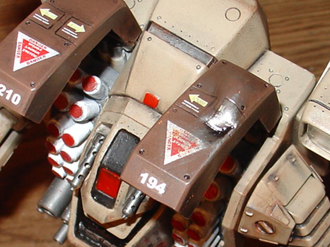

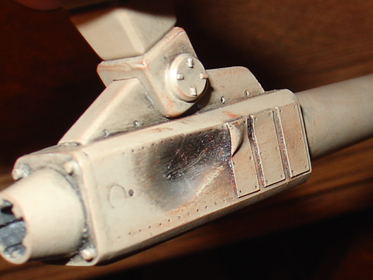

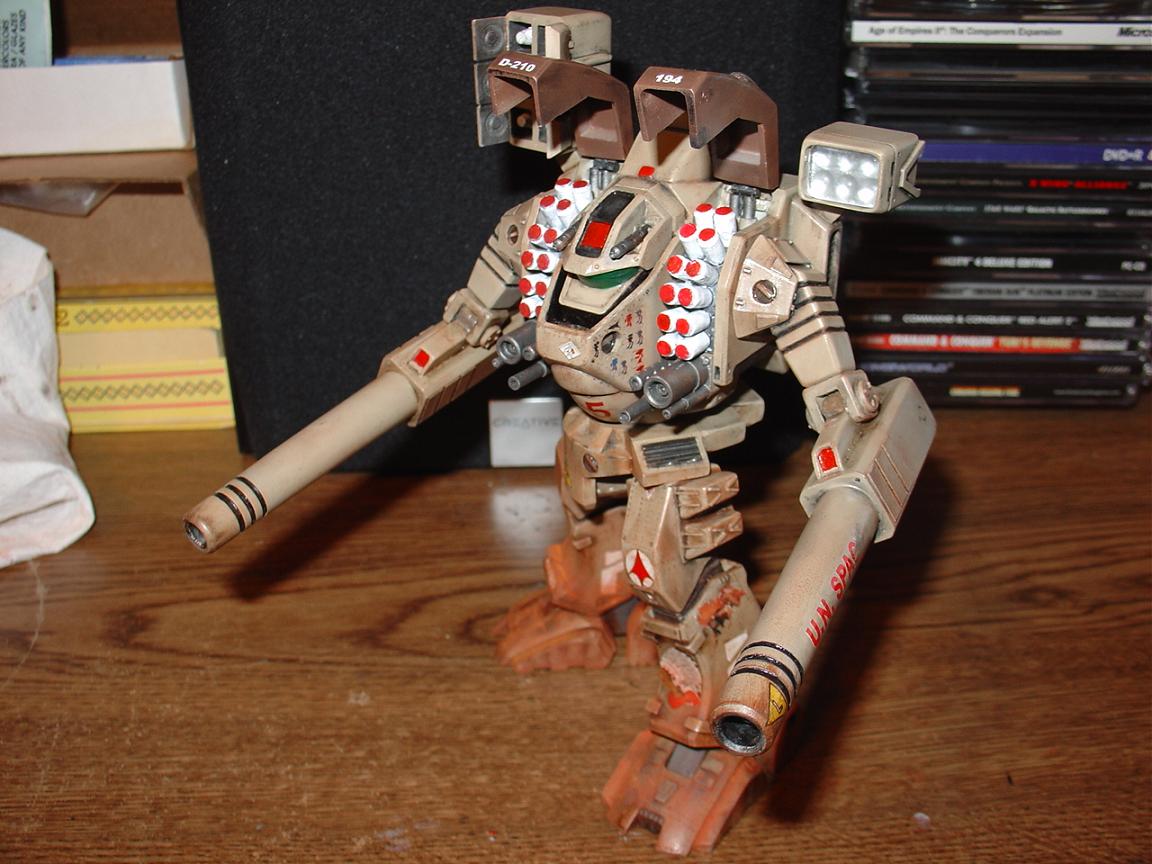

here is an example of my use of the artest oils. I use them to make a kit look dirty at times and fill in pannel lines.
look at the shoulder bicept on my Tomahawk. I used the artest oils on the kit. look for the pannel lines.
Also I used it for the dented blast on the arm. :D
