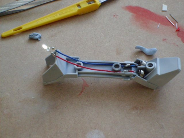

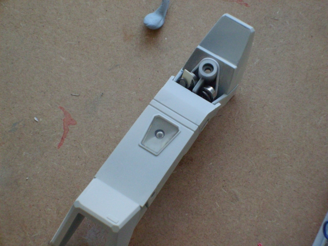

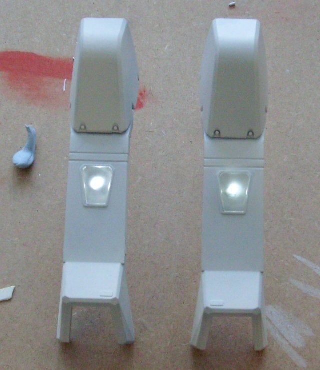

Yay! I've managed to light a leg! I'll take photos step by step for the next one - I've not chromed the back of the lens yet, but it looks very effective! Nice overlapping parts, little light leakage. And with the removable kneecap, it's almost like they designed it with this modification in mind!

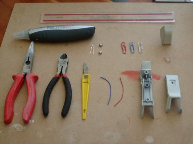

Preparation:
You will need:
Tools:
A dremel / craft drill/grinder (not pictured)
Needlenose pliers
Snippers
A soldering iron and some solder
A knife, scraper or other favorite trimming and poking tool
Parts (for each leg):
1x 4V extra-bright white LED. 3.2cd. 3mm diameter. Nice and bright
2x LR41 (AG3) button cells
3x paperclips - ideally plastic coated and in different colours
2x 3 inch lengths of wire

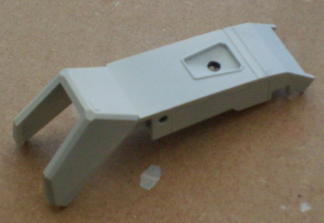

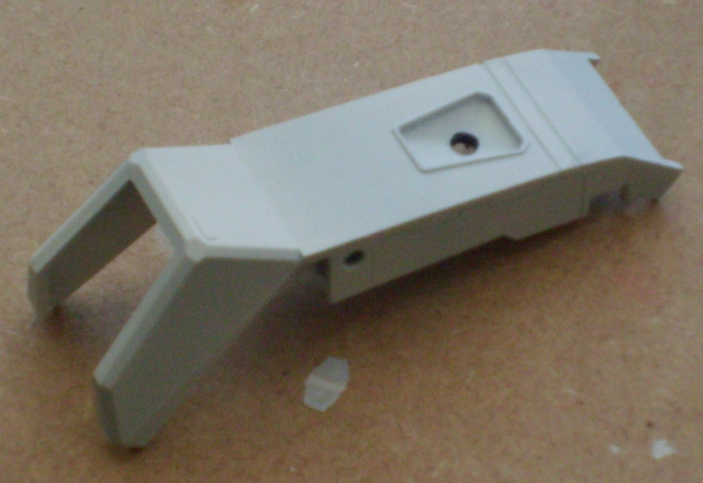

Dremel out a hole in the front of the GBP leg as shown.

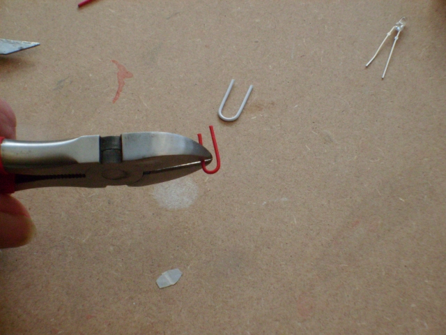

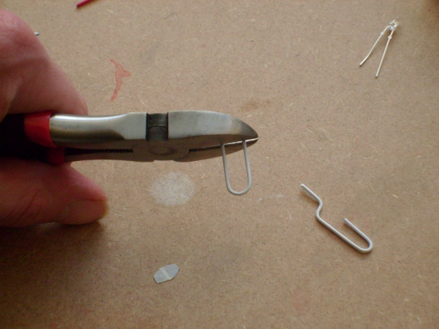

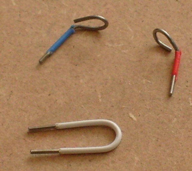

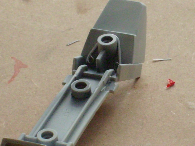

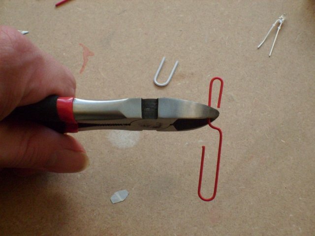

Using the pliers and pincers, straighten out the paperclips, trim to length and rebend as shown - the white one will form the spring for the battery mount, the red and blue the contacts for the LED. Remove the plastic (leaving some to colour code) with your scrapy knife.
Bend the white clip around the locating peg on the inner part of the leg as shown and then curl the ends into springs. CA it to the inner part of the leg.
Step 2:

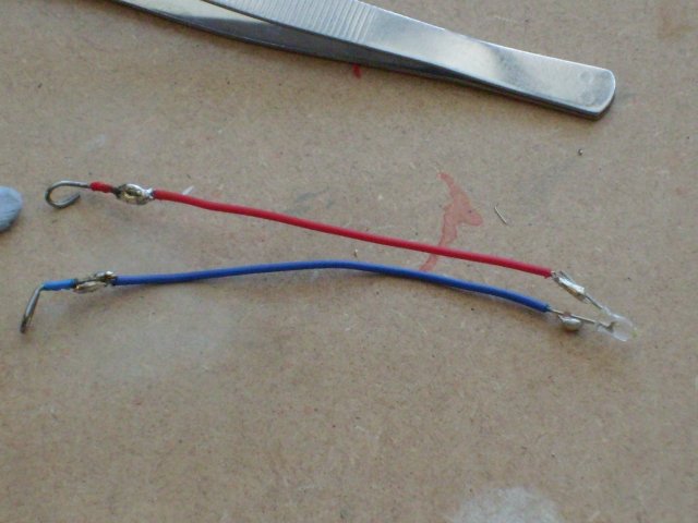

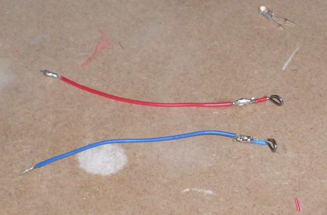

Strip an appropriate length from the ends of your wire. Solder the contact parts onto your lengths of wire as shown. Put a fairly generous blob of solder on the other end. Don't worry about neatness, the wires are quite far apart so there's no real danger of shorting, and nobody should ever see them anyway.

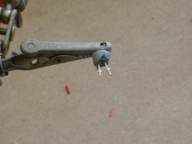

Put a blob of blu-tack or similar around your LED, and put it in a clamp. If you've not already trimmed the pins, trim them now. Remember that the SHORT PIN IS THE ANODE (connects to -ve). Don't trim the pins to the same length!
Solder the blue wire to the anode pin, and the red wire to the cathode. Again, don't worry too much about neatness (although a neater job here helps with pin bending). You should now have:

CA the contacts to the inner part of the leg. CA the wire down to keep it neat. It helps to have the battery in position to do this. Adjust the white paperclip with pliers to improve spring. This will always be easier to adjust. You should now have:
That's pretty much it. Reassembling will give you:
